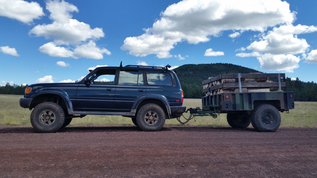

Plugged a recessed hitch into the stock 80 bumper, and braced it in the rear. It is only ever going to tow my M416 or haul a bike rack.
I need to build a swingout next, but until then, the spare will live in the cargo area. I could still use the hoist, but then the 35 looks like a saggy diaper under there. (Pardon some of the bird$h!+ welds, I ran out of gas on the last two passes in the picture above.)
FWIW I think you will be fine, I pull my M1101 around wood cutting with a pintle bolted up there. It's curb weight is 1460lb
^^^Cali-style^^^
Yeah, the tongue weight of the m416 is probably only 110#. I think it will be fine.
