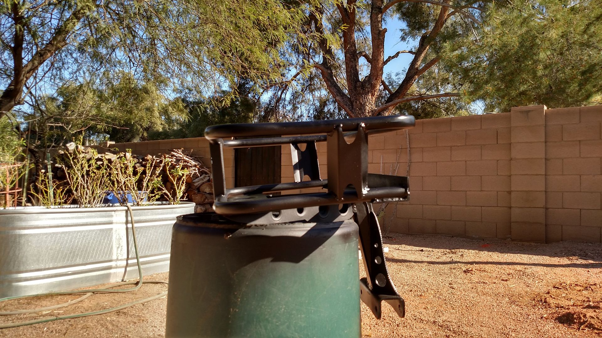

Also, welded in some stronger supports for the 4x4labs can holder. The prior dimple died gussets were VERY thin and I snapped them while on a trip to Colorado. Luke said some kits got out the door with the wrong thickness metal so he sent me some that are out of 1/8" or so material. Much stronger.

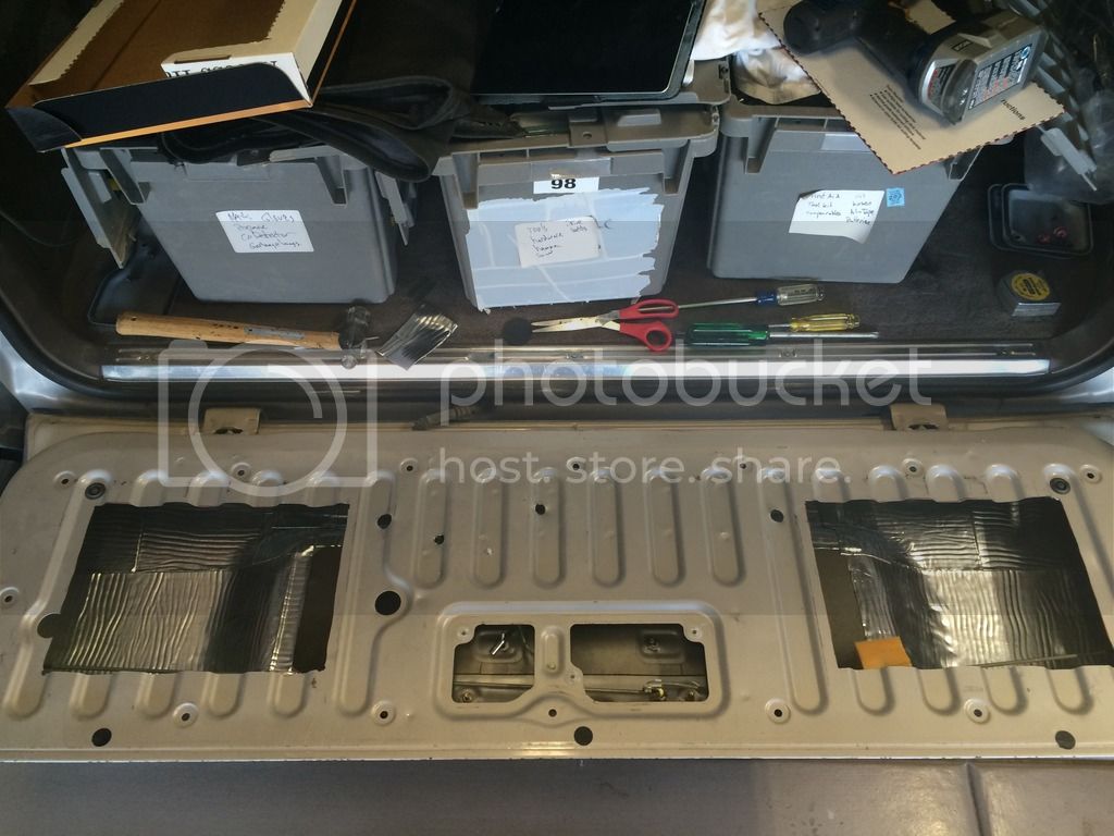

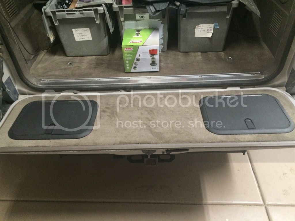

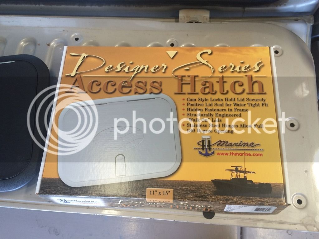

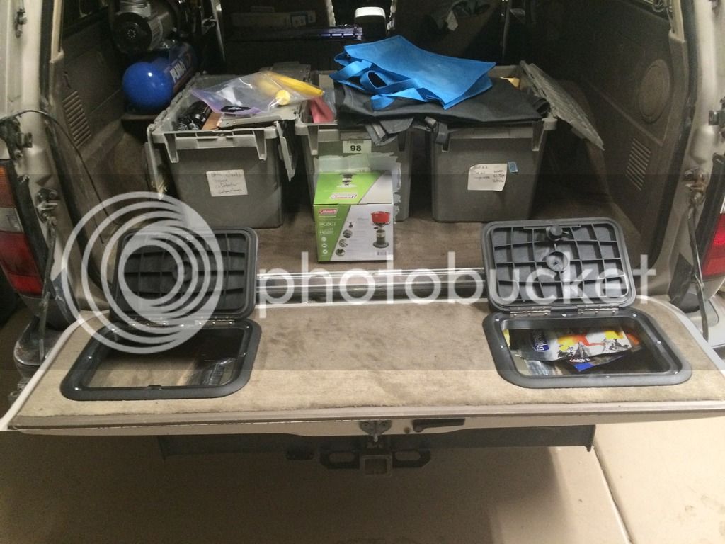

I was hoping to get the Wagongear Tailgate Storage solution but when he last posted a build of them, they sold out in minutes and I missed the boat. So, tired of waiting, I decided to follow the lead of LCP, Aloha Jen and CarterCD and go the boat hatch route. I like how this turned out.
I picked up two of these from www.boatstoreusa.com for $54.92 each. SKU# L-232-HDS1115DP in black. Service from this online merchant was excellent.

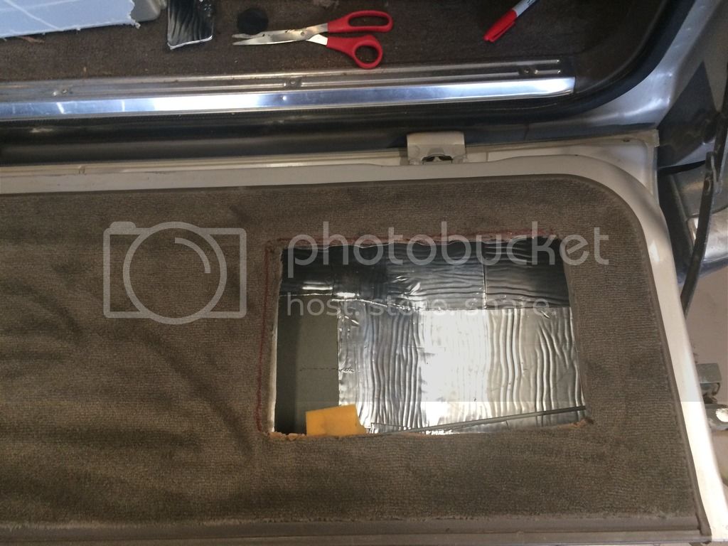

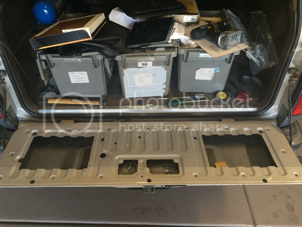

I then removed the carpet and made the cuts once I had everything marked. Using a jig saw with a metal blade, the cutting easy and it came out clean.
I then lined the pockets with sound deadener replacement that I picked up from Lowes

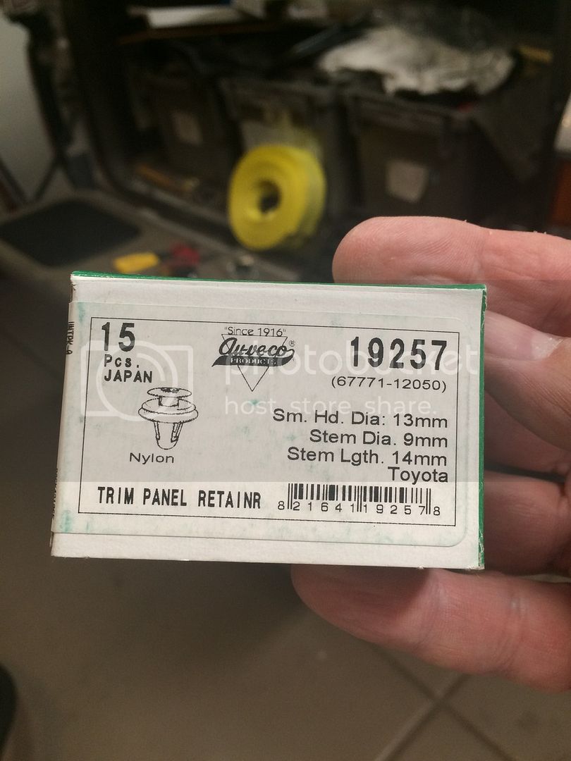

Then I cut the carpet/wood panel and I replaced the clips that I purchased from this store in Mesa. Great store, they have everything and the clips were cheap.
Well done sir!
