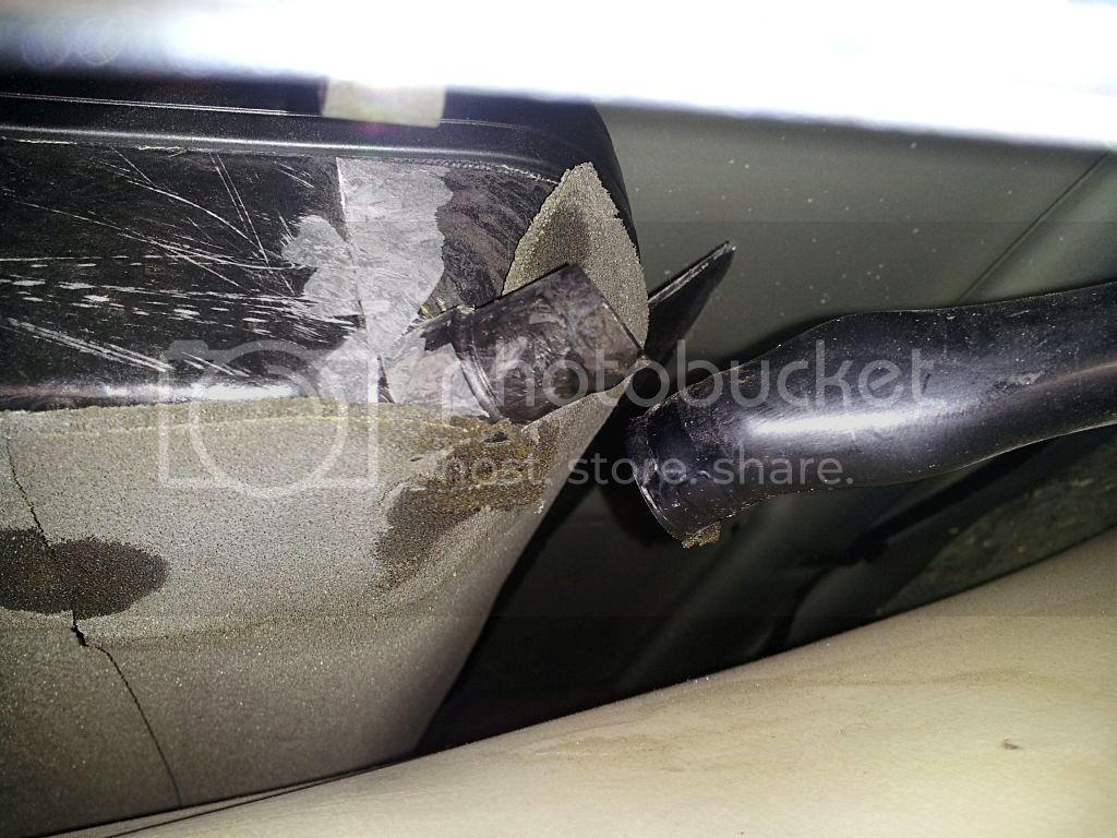

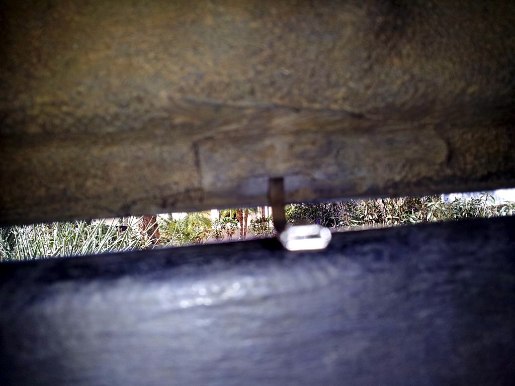

My headliner got wet during last week storm. It turned out that 3 out of the 4 of my sunroof drains were clogged. The 2 front drains were easy to deal with, I ran a wire from the roof drain holes through the hose. I also used a stainless steel cable tie to unclog the drains on the rocker panel without having to remove sliders.

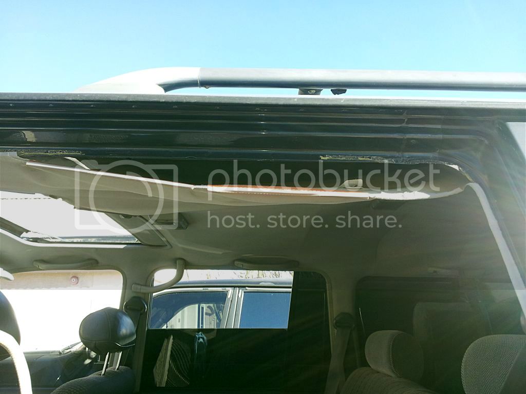

Since the rear roof drain holes are not visible with the roof opened. I ran a wire from the drain hose located at the rear quarter panel up to the sunroof. This didn't solve the problem. I ended up have to open up the headliner to disconnect the hose, then ran a wire to the sunroof drain hole, and through the hose down to the quarter panel. A quick test of pouring water to 4 corners of the sunroof shows that I have good drains now.

Cable tie in rocker panel drain slot.

Headliner partially opened for access to drain hole and hose.
