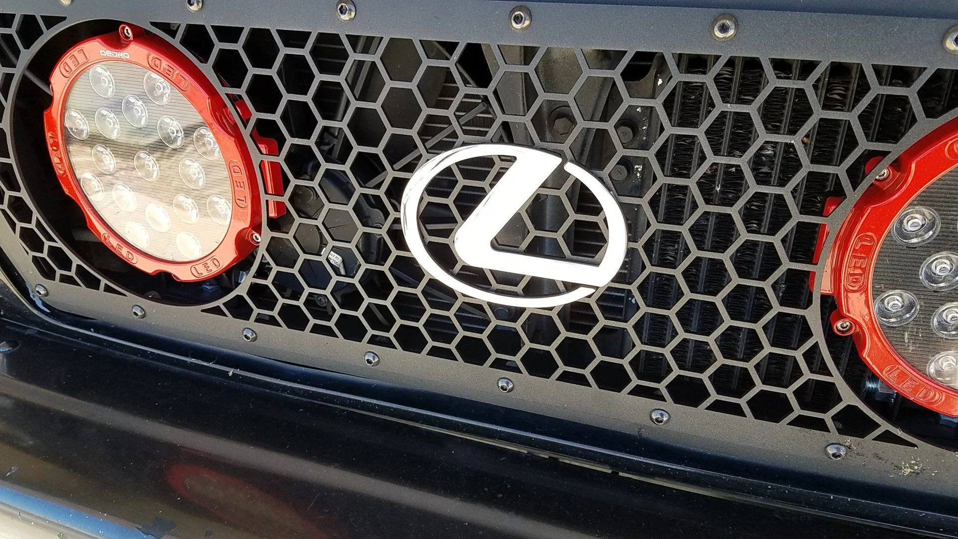

Put the final bling touch on my grille.

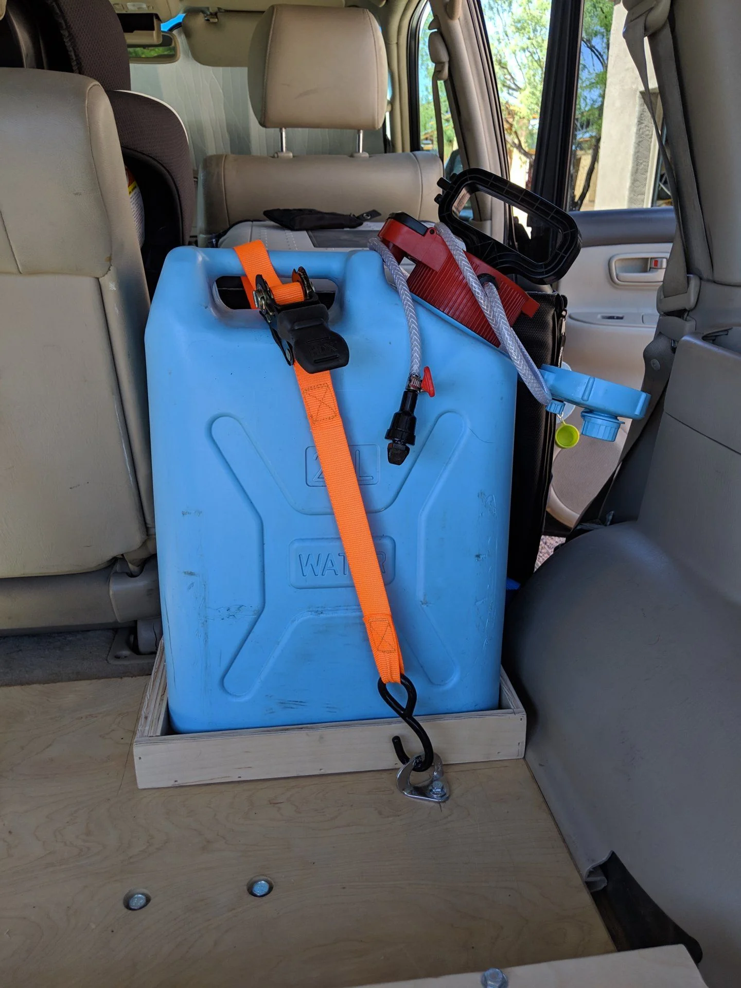

While everything was pulled out, I made an addition to my rear cargo deck. Been trying to figure out a better water dispensing solution than having to pull out water bricks each time. Had an old scepter water can and found an old thread about using a pump sprayer top that fits the scepter lid threads. I made a small box to mount it. Also used one of the car seat mounting points with a climbing anchor to secure it with a ratchet strap.

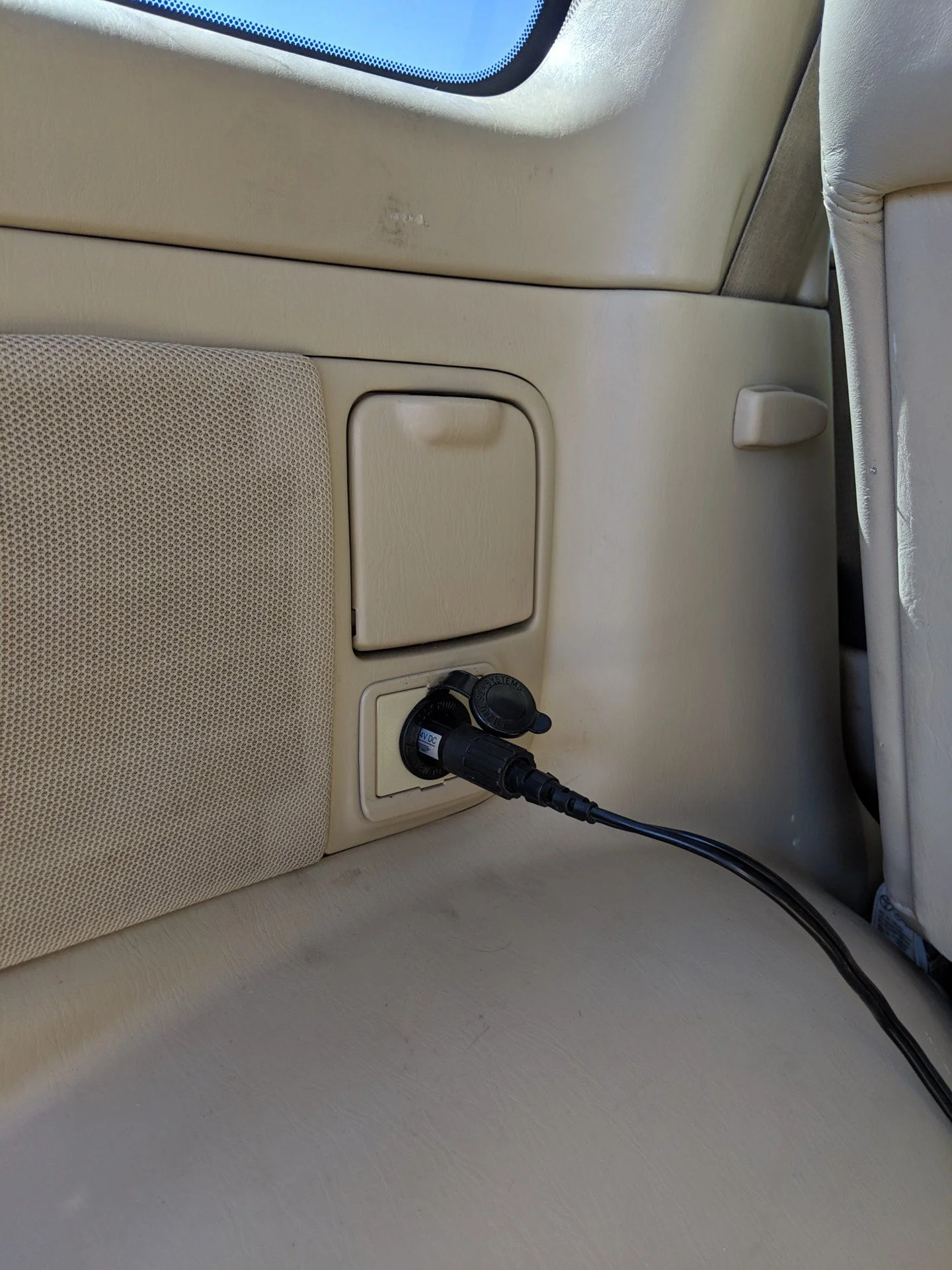

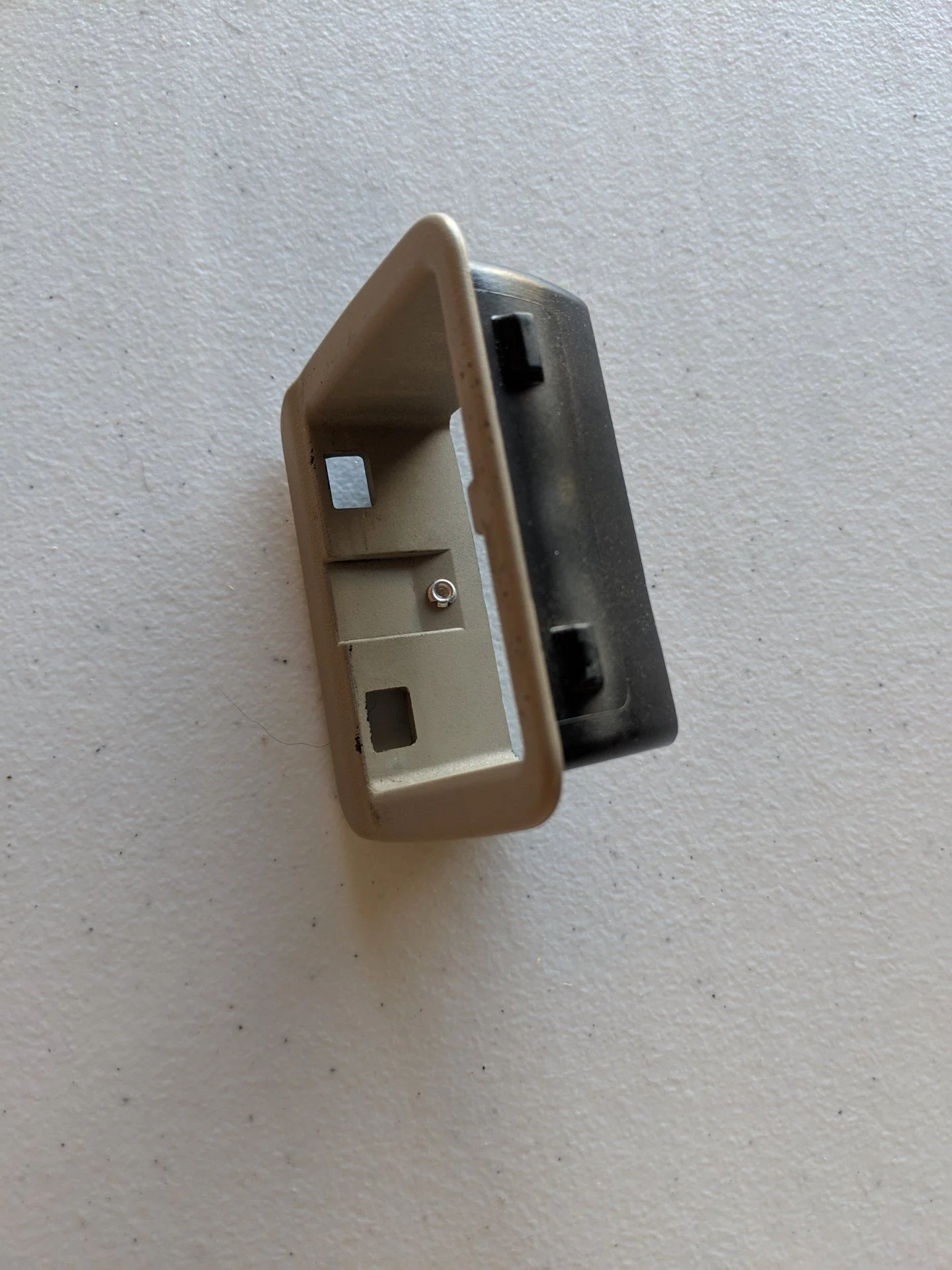

Had an insert made with a 3d printer to mount a Blue Sea 12v outlet in the third row ashtray.

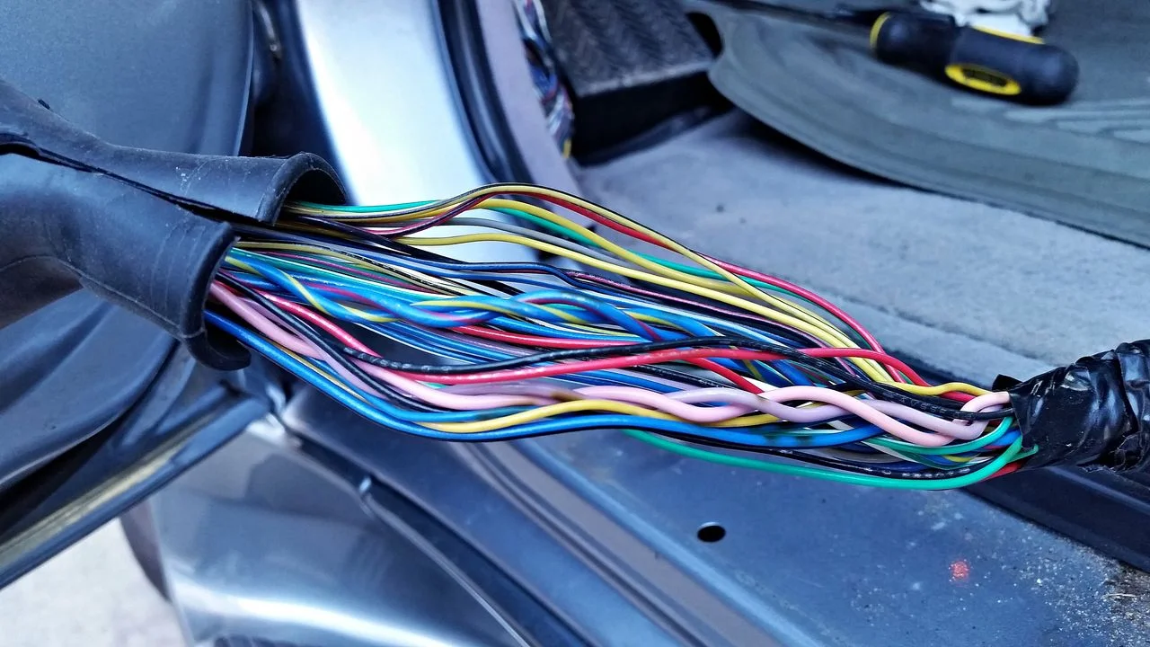

Rear left window not working. Window would not roll down when using driver window master switch or rear window switch. I thought I had broken wires between driver door and kick panel. Very disappointed to find out there was no broken wire in the bundle.
1960679
Removed motor and regulator assembly from rear door. Tested the motor with no window, the motor turned in both directions with no problem. It turned out the window was sticky. I gave the window a hard pull to free it from sticky substance. I reset the motor limit switch, reinstalled everything. The window rolls up/down now.
