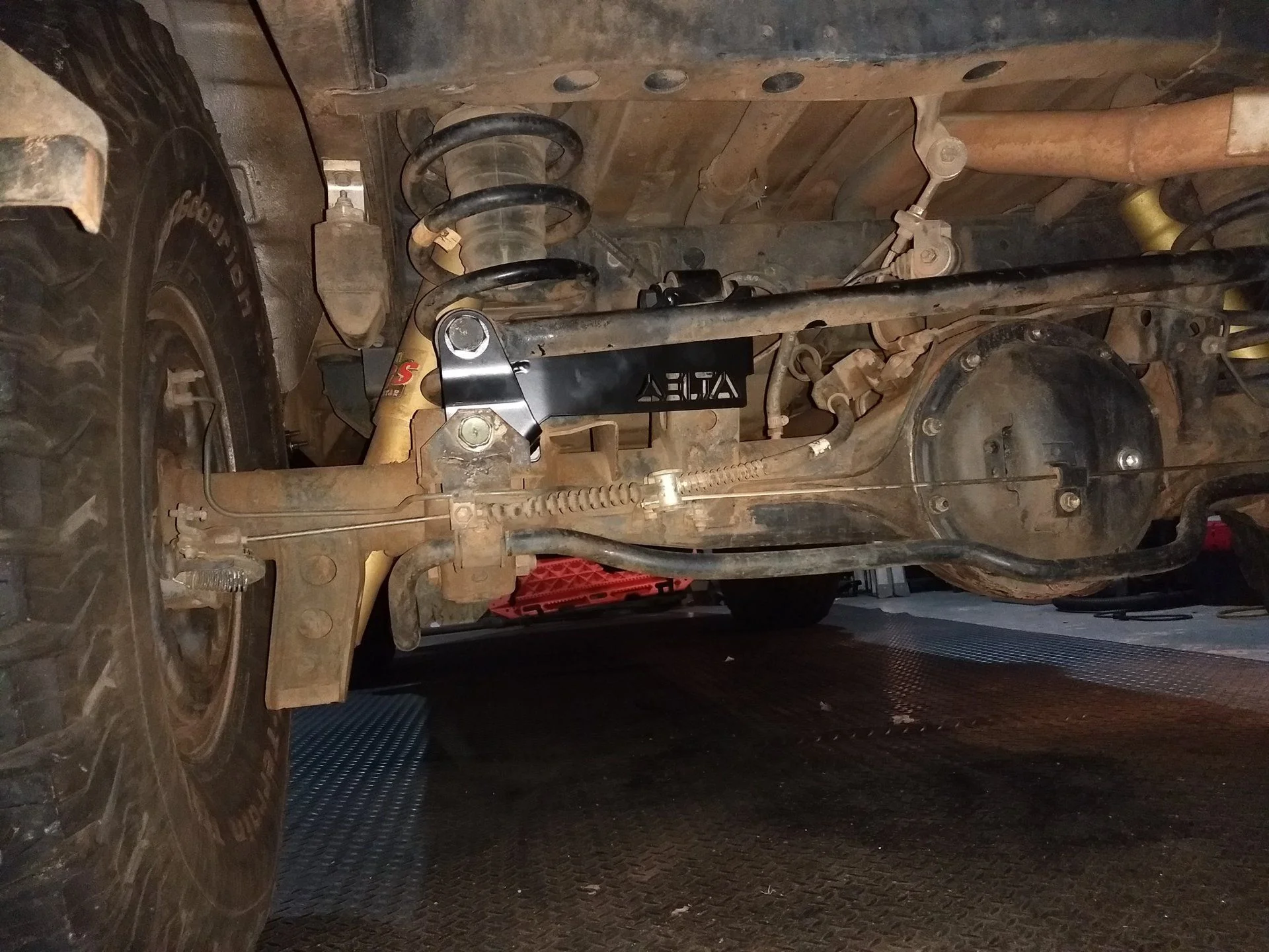

-Delta VS rear panhard bracket installed (not enough miles on it to see if it improves handling yet)
-4x new tie rod ends installed (removed originals with 26 years and 207k)

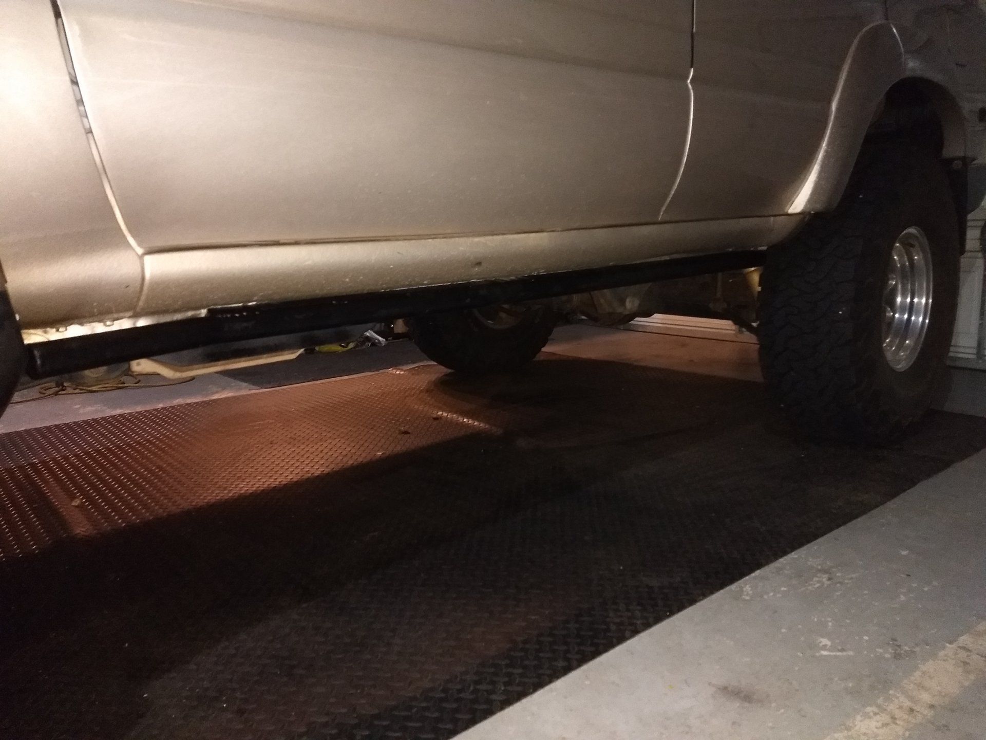

-installed some homemade , low-pro rock rails

What is the Delta panhard bracket supposed to do for the ride?

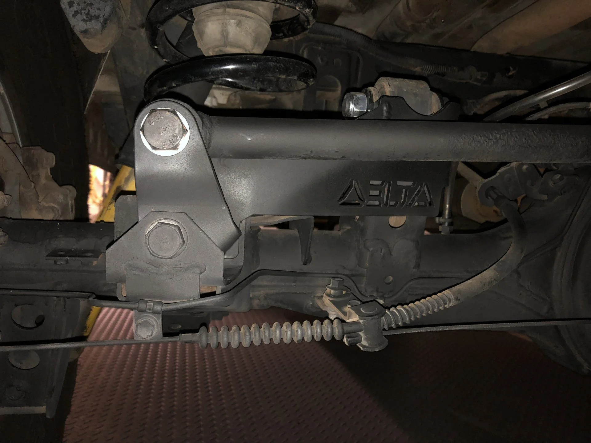

Added a little bling and a Delta bracket. I like how the Delta helped center the axle and the panhard bar is almost flat again which removes that tail end wiggle. Also pitched the rear sway bar a few weeks ago and I can’t even tell it is not there. on the Delta thanks Phil.

Agree! I didn't necessarily appreciate a lot of play in the front previously, but after the TRE's, the Delta bracket, spindles and hub bearings, she's a 2 finger driver again. All it needs is another hundred HP!
@Ken in AZ , did the panhard bolt provided with the Delta VS bracket make contact with your OME spring? Mine does. I wish it was 1/4-1/2" shorter.

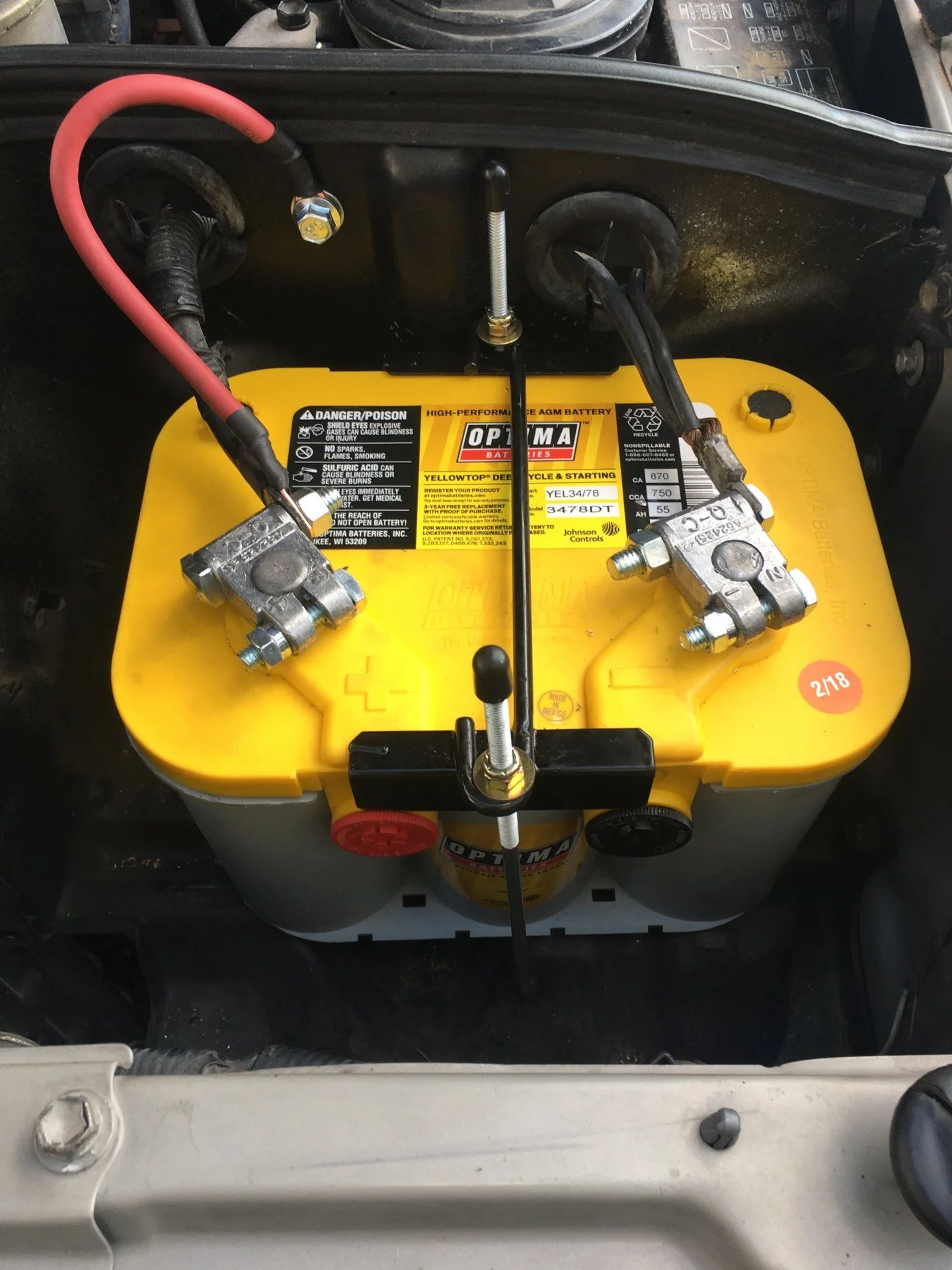

I've gotta ask... what is the red cable powering?
It’s just an extension to the fuseable link, which now resides outsid the battery box. If you look at @LandCruiserPhil post on the battery hold down it’ll make perfect sense.
Mine does not hit the spring. What coil are your using? I have J coils front and back.
