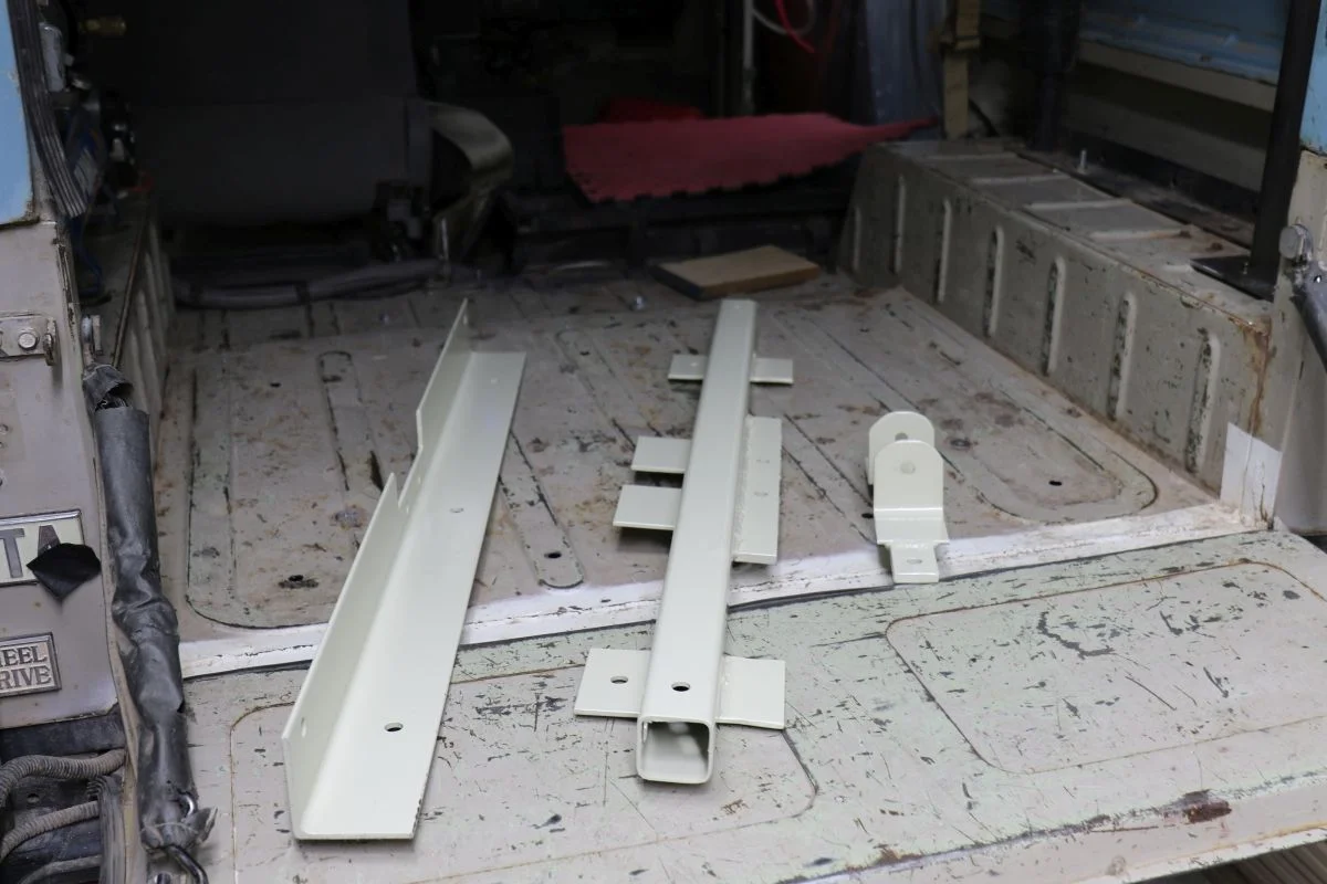

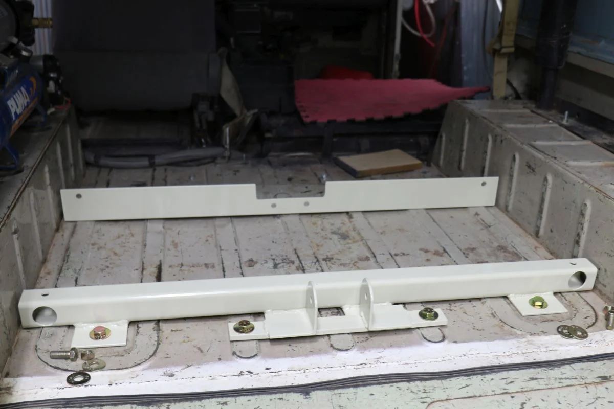

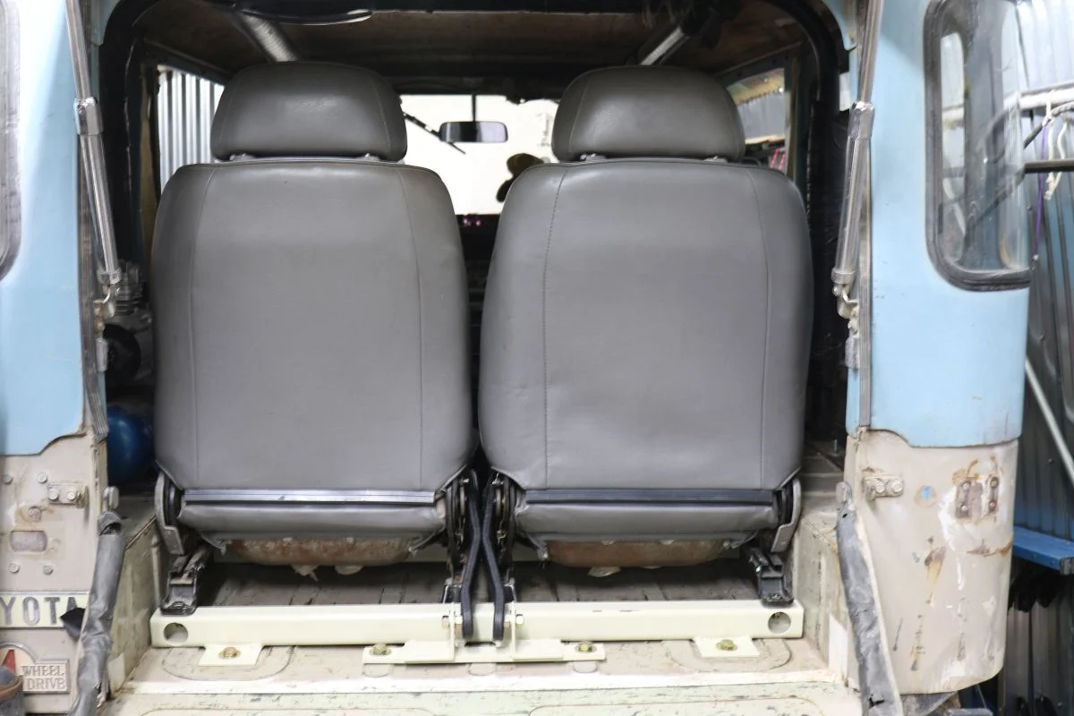

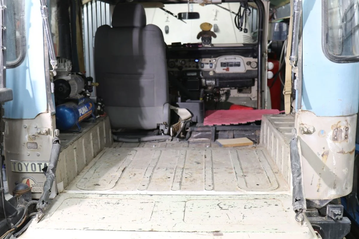

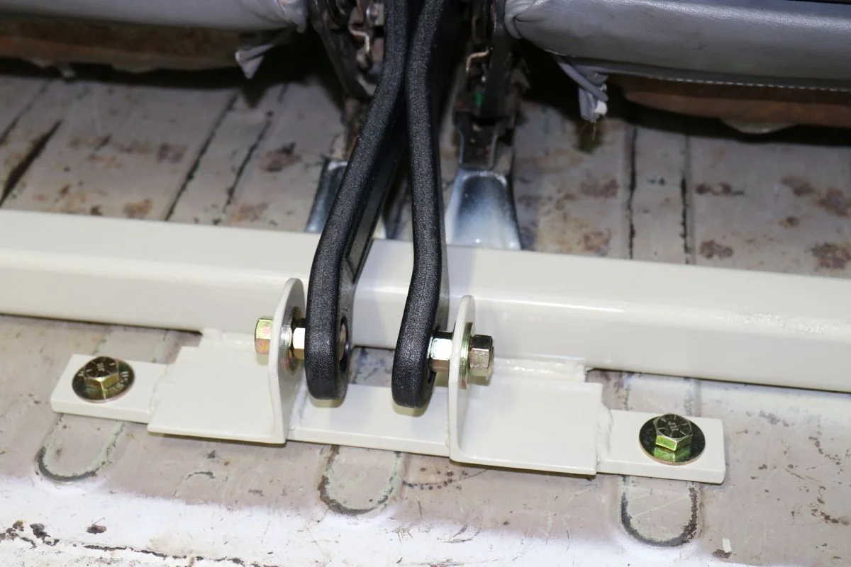

Modified the FJ40 to a four seater.
I have options for a one-seater (normal configuration), two-seater (never used), three-seater (used when I ride with my brother and nephew), and now a four-seater for the upcoming Chile Challenge in New Mexico.
Before (one-seater):
Framework for the rear bucket seats
Rear buckets installed
Seatbelt mounting
View attachment 1800325 View attachment 1800326
Seatbelt mounting
Nice fab work, that looks very cozy. :clap:

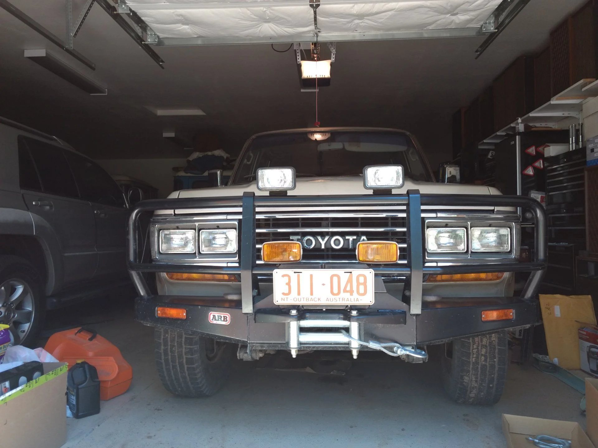

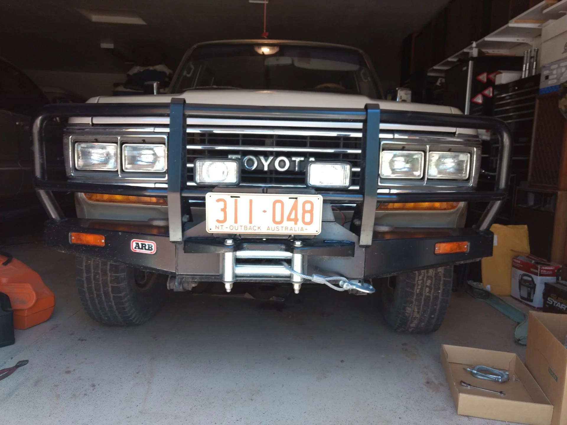

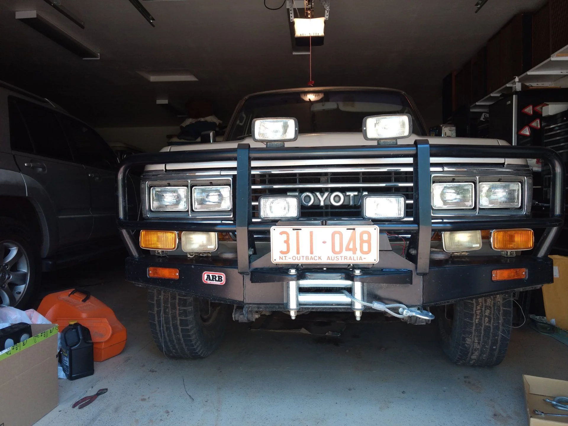

Here is some Rally driving lights SAE-Y-88 which make them approved 1988 and period correct.
If I ran driving and fog lights would mount them like this but not a fan of lights above the hood line. Other options would be on the face of the bumper or drill holes and in front of the turn signals.View attachment 1778549
Or if I really wanted to make a statement do it like this.:rolleyes:
Amber and Rally lights work. Aris (which have covers) and Lexan driving lights would need some work as none of them are currently working. Both date to 1981.
I know you were playing with these rectangle lights and also some round ones in a later post which way did you go? at least for now?
For now kept this on.

does your ARB have light mount tabs in that location? Or did you weld them on?
This is a used ARB I bought around nine years ago. It's ar least a generation earlier than what is sold new today. The tabs upper and middle are stock. The bull bar was like new when I bought. The lights on the main bumper are held on with clamps and would need holes drilled to mount which I have no intention of doing.
