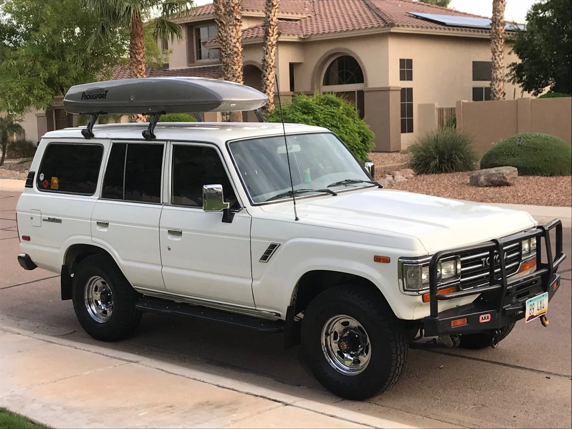

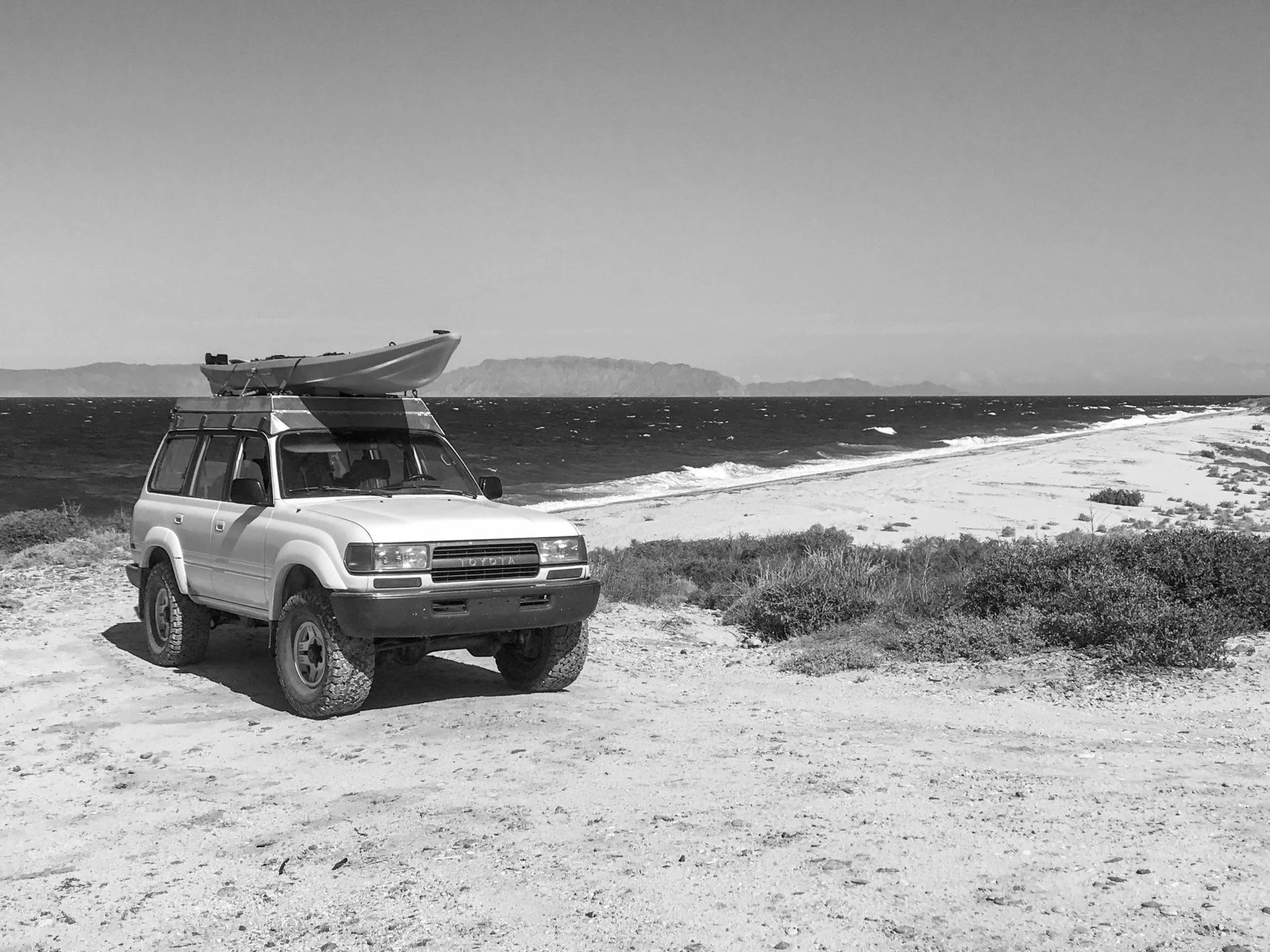

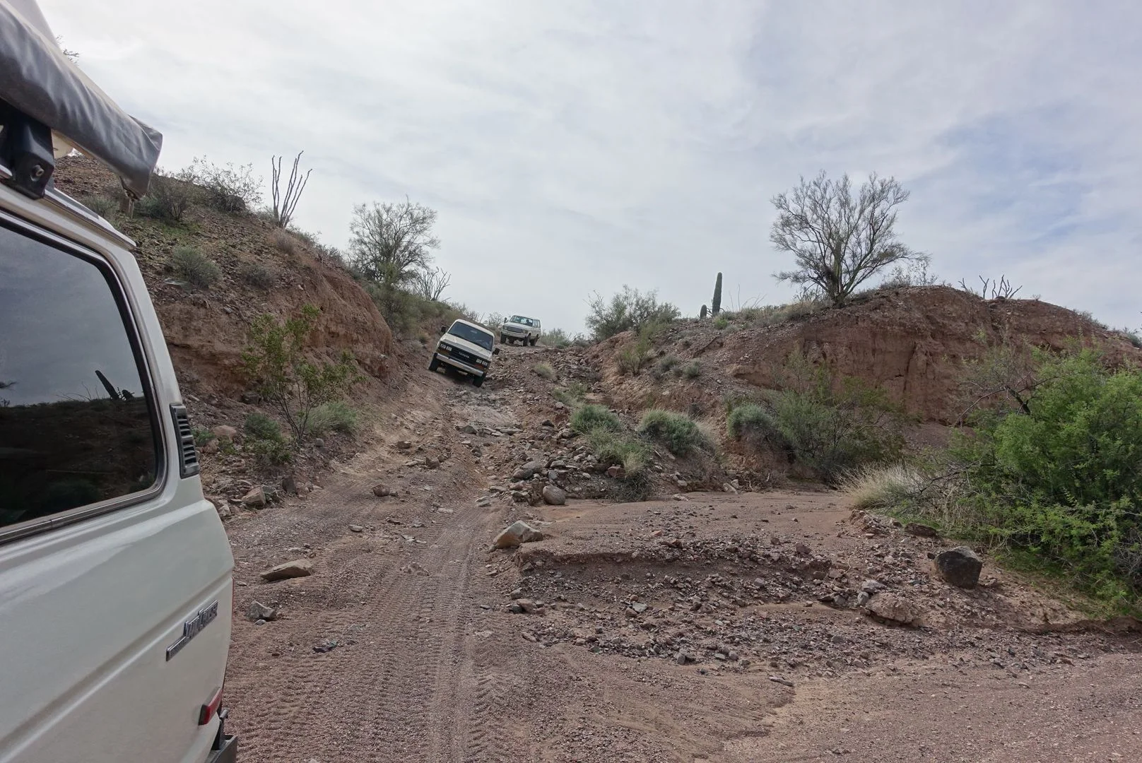

Did some travelling in my 80, taking a week off to see family. Mostly asphalt, totaling 1100 miles looping from Peoria to Prescott, Flagstaff, Holbrook, St Johns, Springerville, Socorro, Las Cruces, Tucson then back home.
My point...I am really pleased with how the new motor is doing. About 8000 miles since putting it back on the road in early February 18. I've done a couple of long trips with the CSC crew (Mojave Road & North Rim) and a few other trips on my own. So far I've done three oil and filter changes and have no leaks, no issues, and no oil consumption at all. Average fuel mileage on this trip...14.76 mpg driving at posted speed limits. I did the math 3 times because I couldn't believe it! It seems that this motor likes to stretch its legs... I average 13.5 mpg running around the valley. Props to CBT on the engine rebuild:clap:

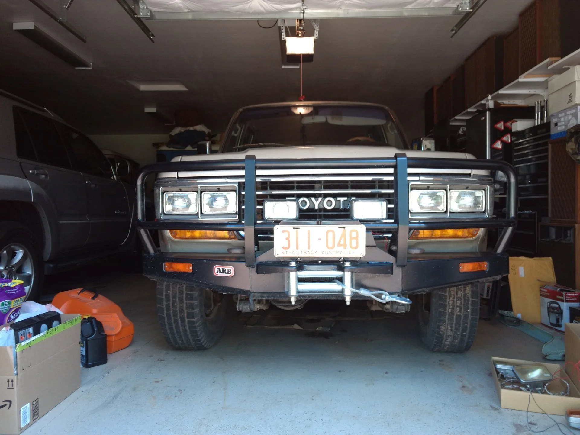

Where you attached D rings to the front bumper are designed for using a jack not a anchor point. My plan is to use the downs from 80 series front and back. Need to source another to have four. On the front will require a spacer with the bull bar. For now using two of the front hooks front original bumper. Mine has hole that match the bolt pattern in the vertical pieces.
I can't see the front hooks in your picture to see where you located them. I have one off of my stock bumper I could use.
Look outside the main vertical beams at the level of the bottom of the license plate. Holes were already there. When I bought my bumper used one of the hooks was already mounted. Used the one off my cruiser for the outer side.

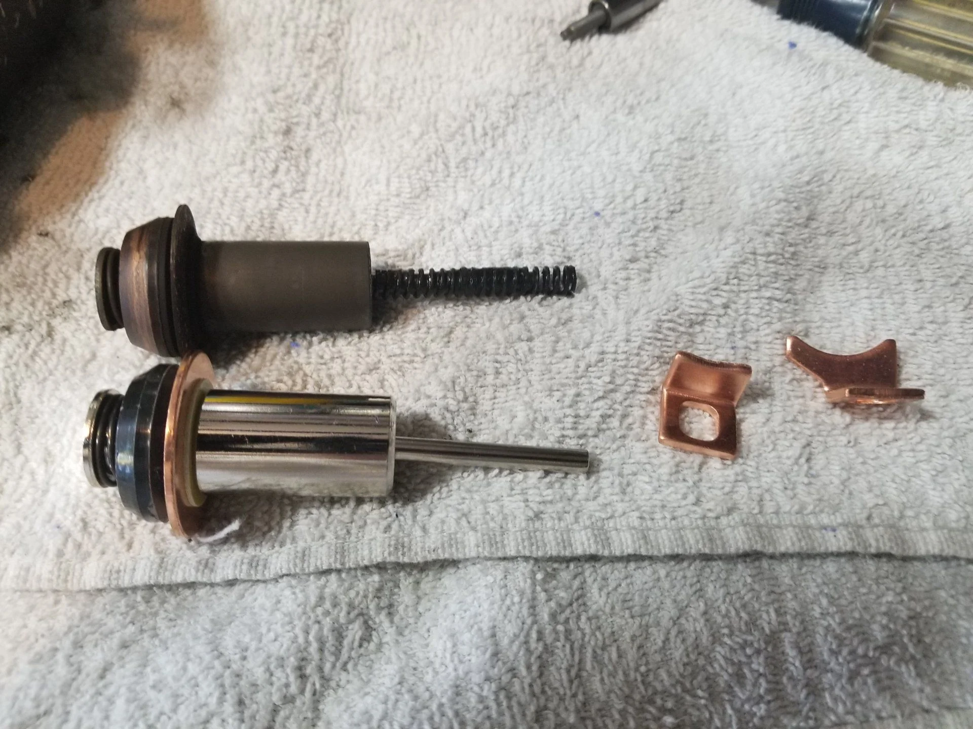

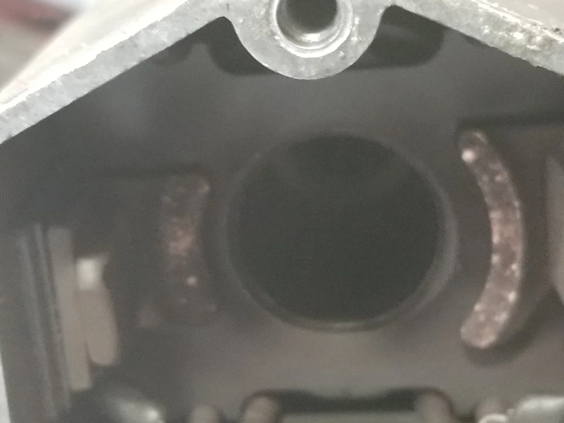

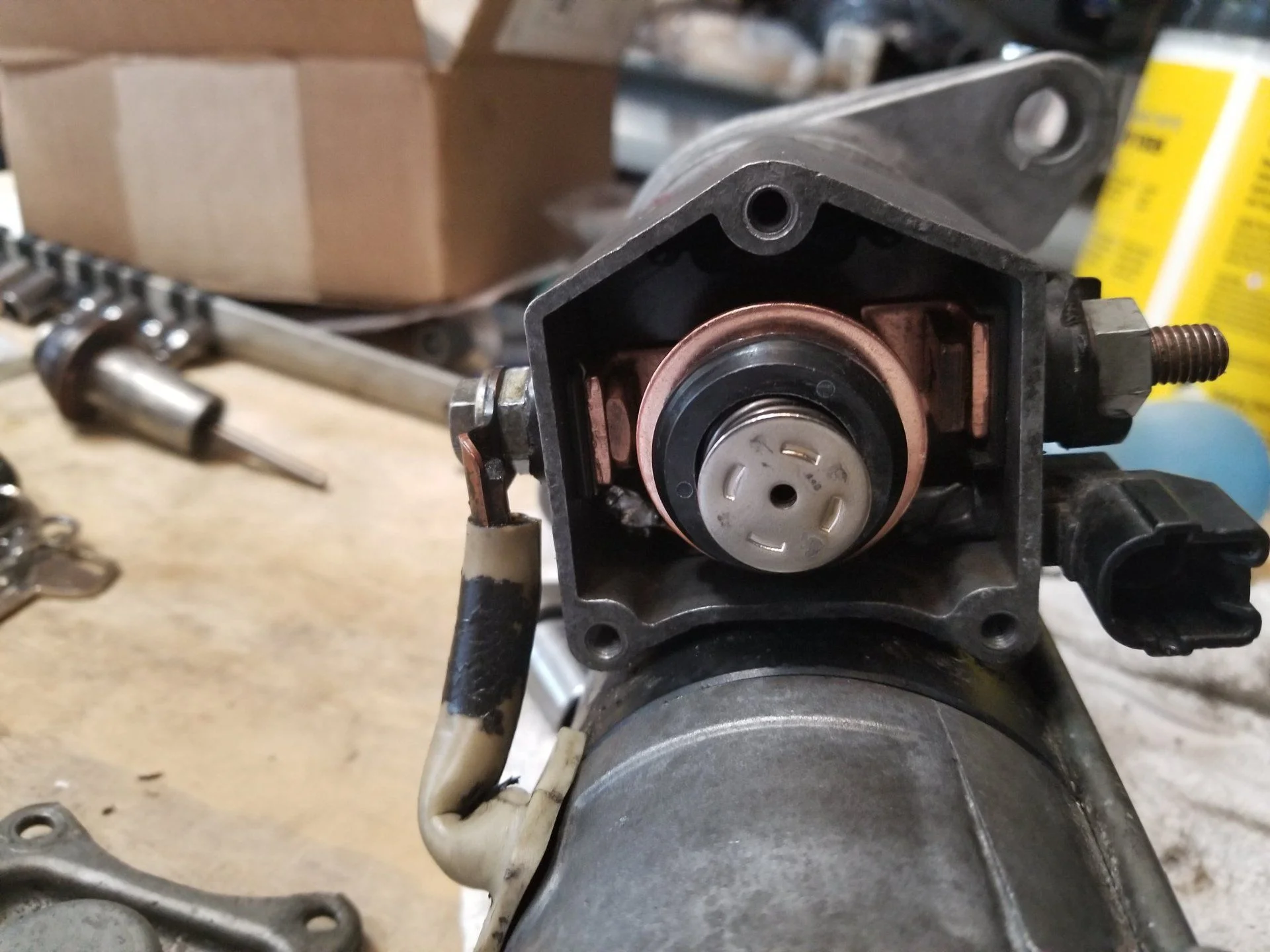

I know this is a proably a repeat post but I purchased an 80 over the summer and I been trying to catch up on the maintenance. Being a 4runner owner I usually just replace the starter contacts. So my usual cheaper fix i just clean the starter and replaced plunger and contacts.
Should of hi jacked it

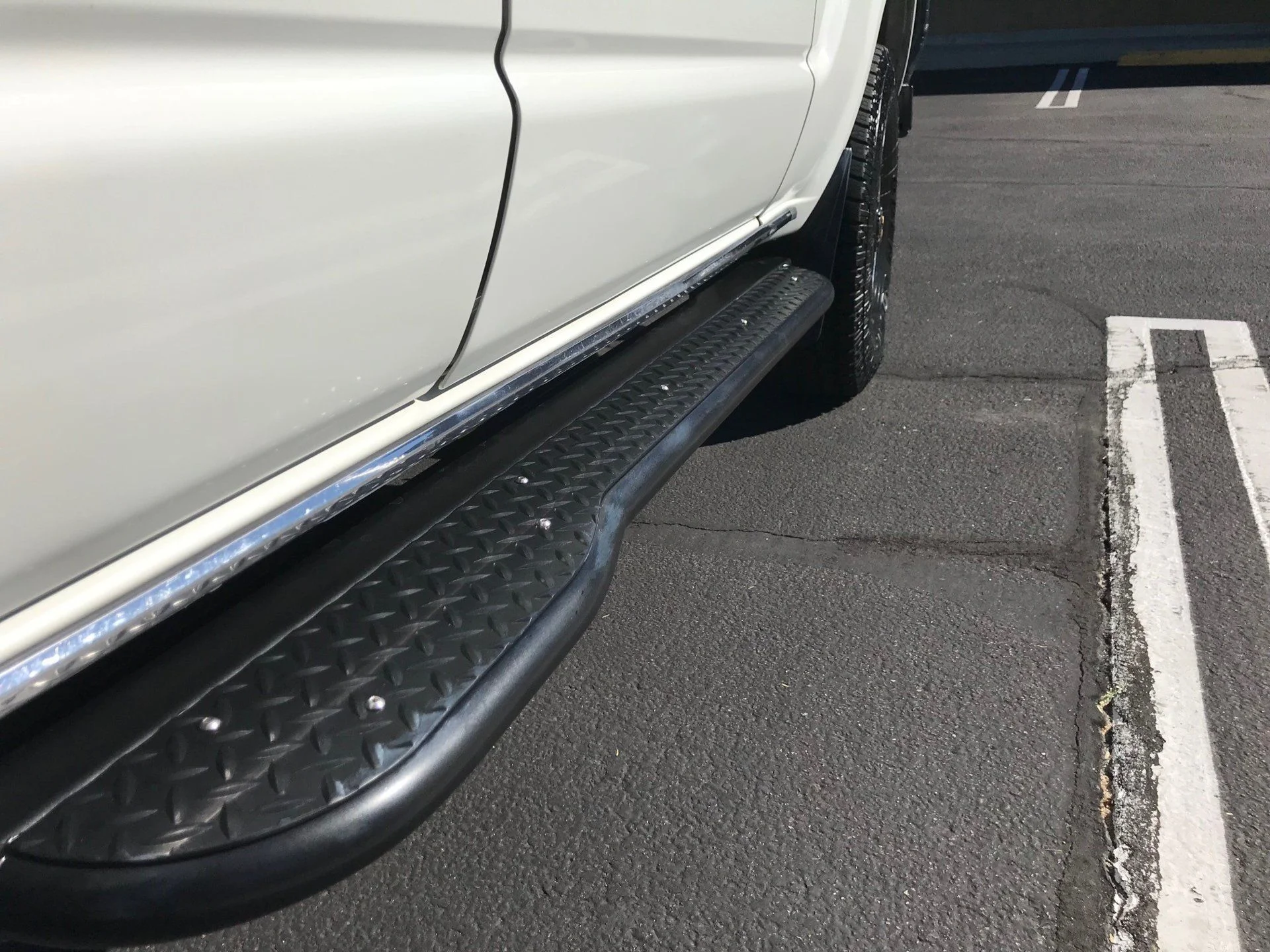

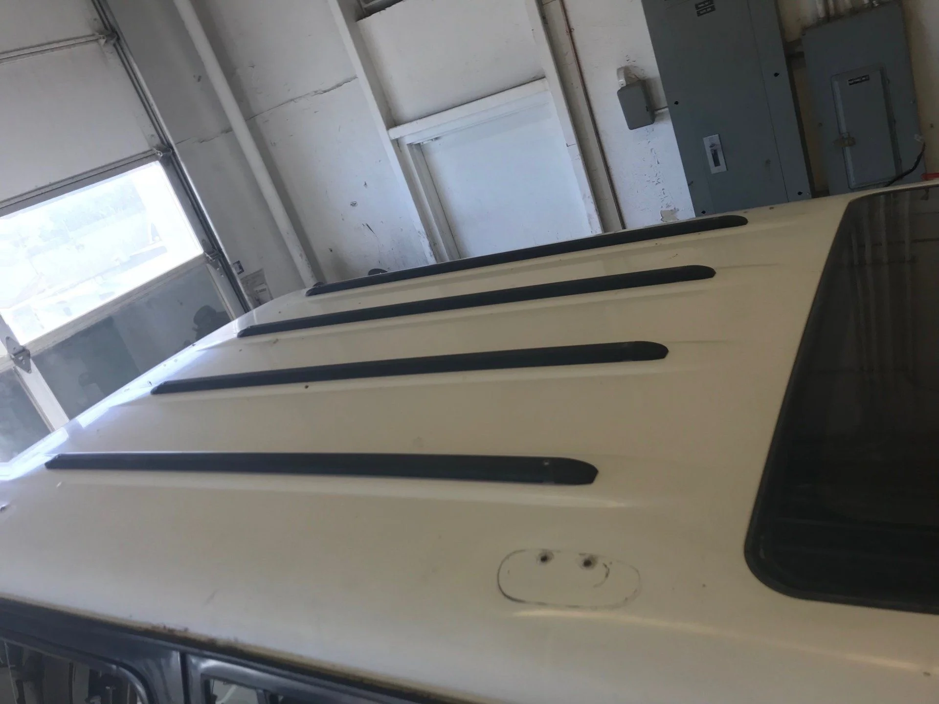

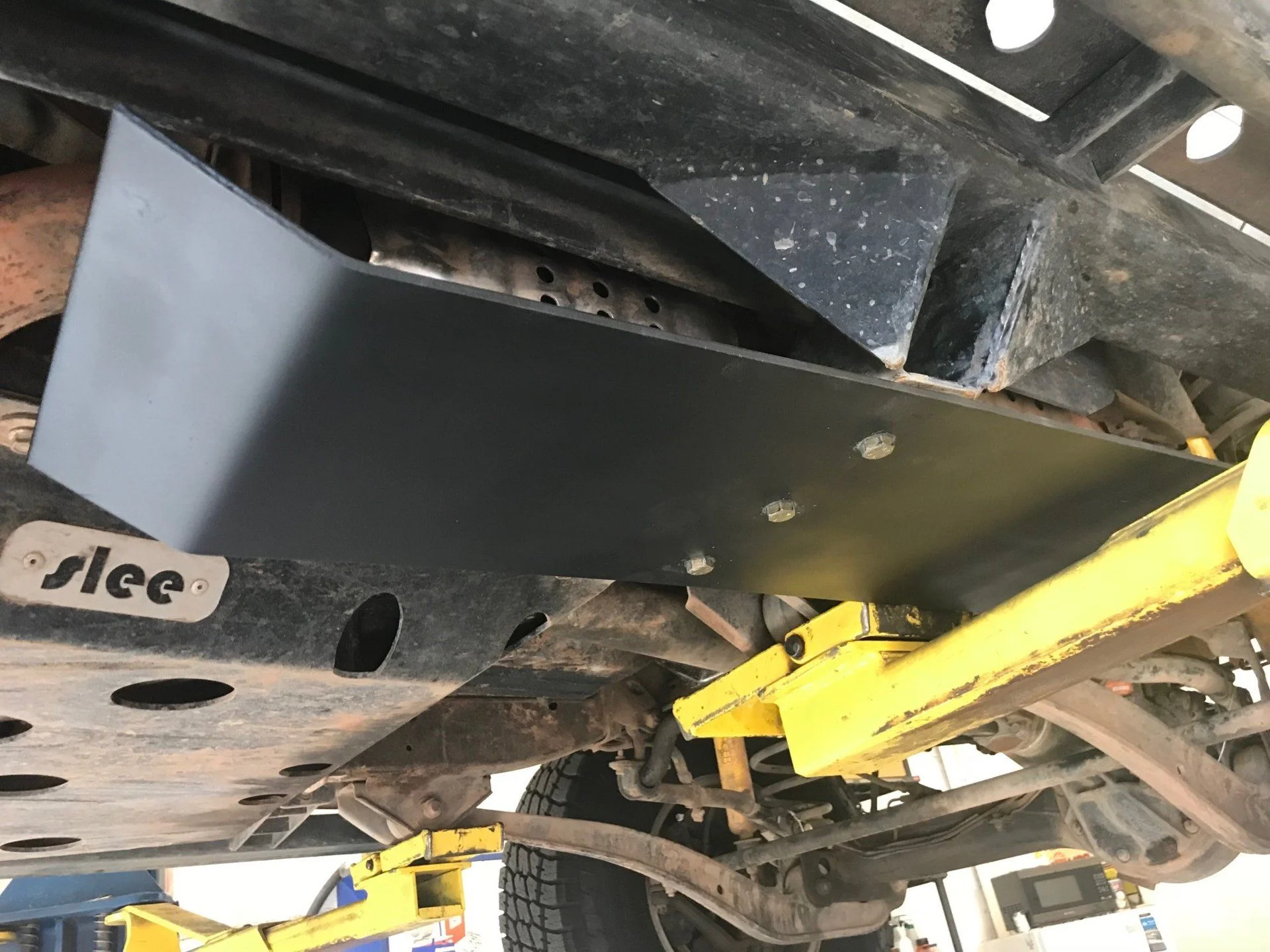

Bolted a skid plate to my Slee sliders to protect the cats after I banged one up in Moab last May. Also removed the OEM luggage rack as I'm replacing my Inti rack with a Bowfin for lower profile. Using the bolts with washers and rubber O-rings method learned on Mud to plug the 8 holes in the roof.
That is not your garage, or your lift . . . :flipoff2:
