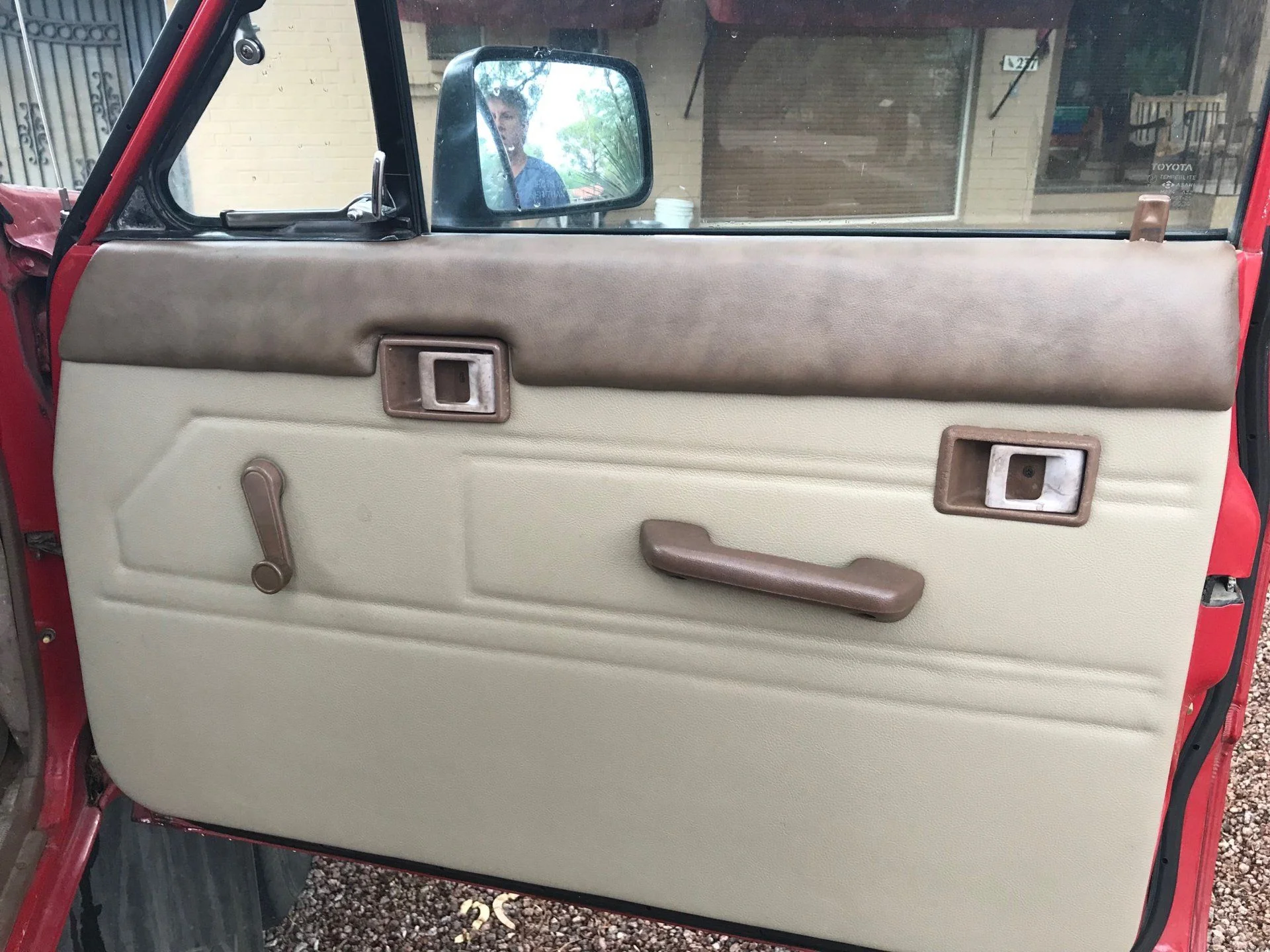

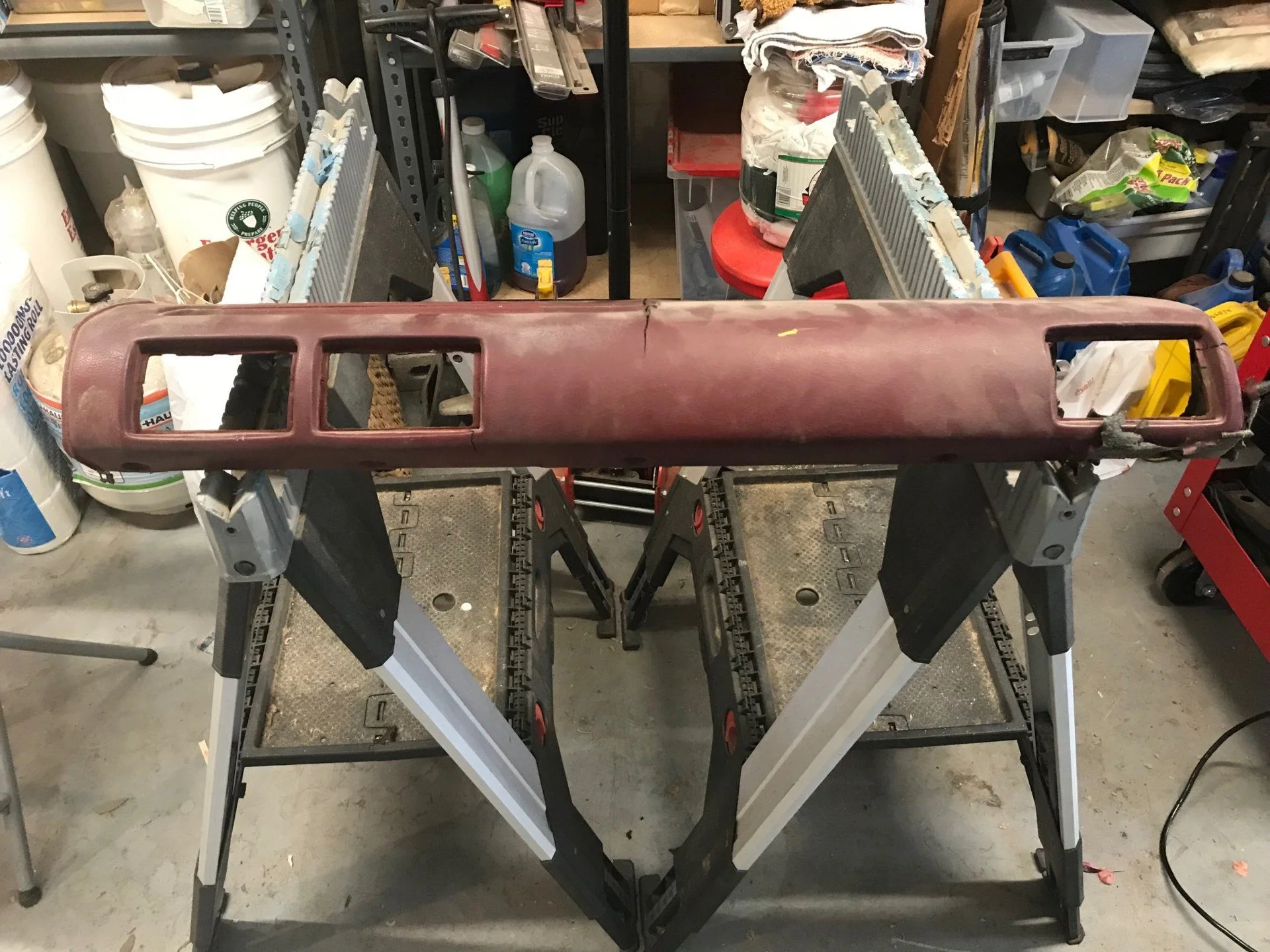

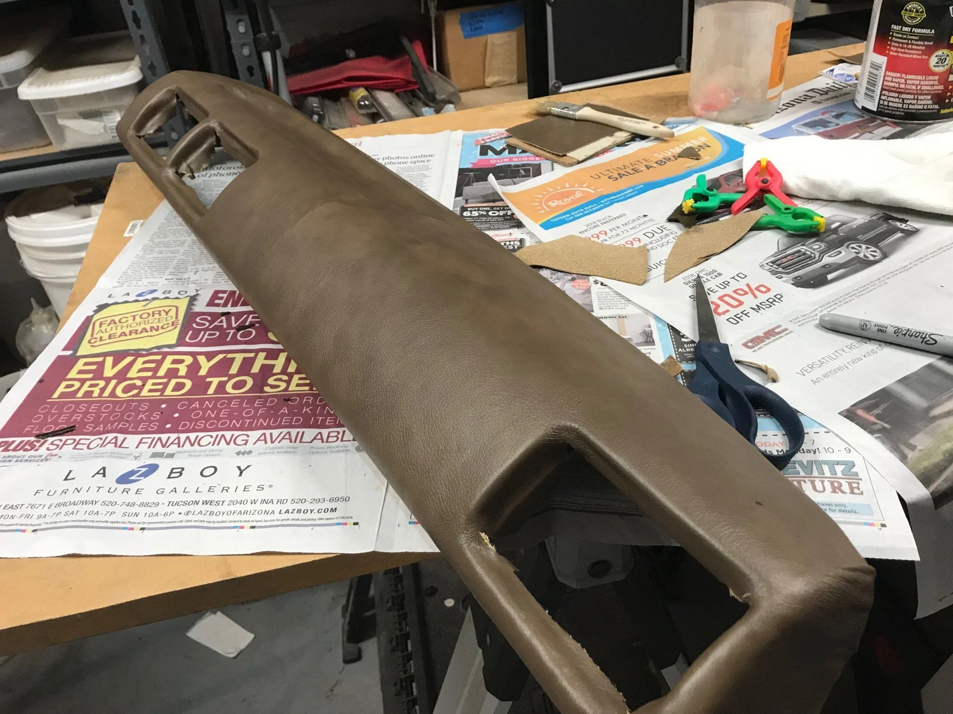

Since I decided to do the body work on the 4Runner myself at some future date, I've decided to do the interior to keep forward momentum.
I made new door cards a few weeks ago. I harvested full panels of an 87/88 SR5 as templates to replace my 3/4 DLX. They turned out pretty good.

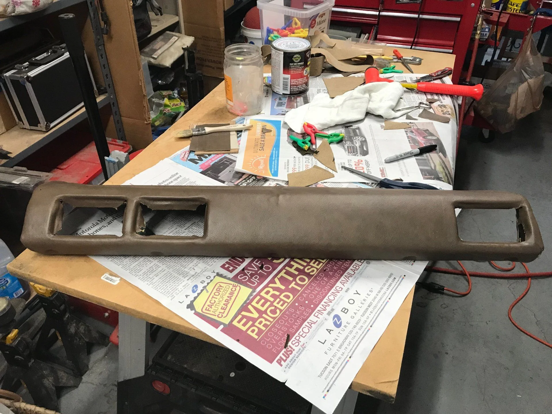

I pulled the dash of that same truck. It was pretty beat, but I thought I'd use it for practice. I learned some stuff as one of my crack repairs is visible. I'll either get another donor dash or figure out some sort of camouflage.
I'll order some vinyl/plastic paint and get started on the interior trim. Then I'll order a new carpet kit. I'll do some sound deadening at that install. Next steps are the interior map lights, inclinometer and maybe some other stuff.

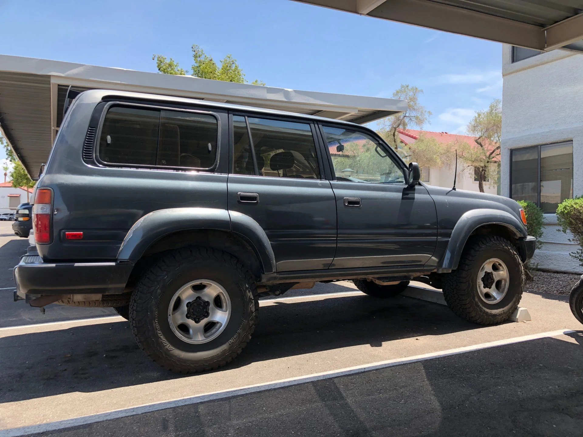

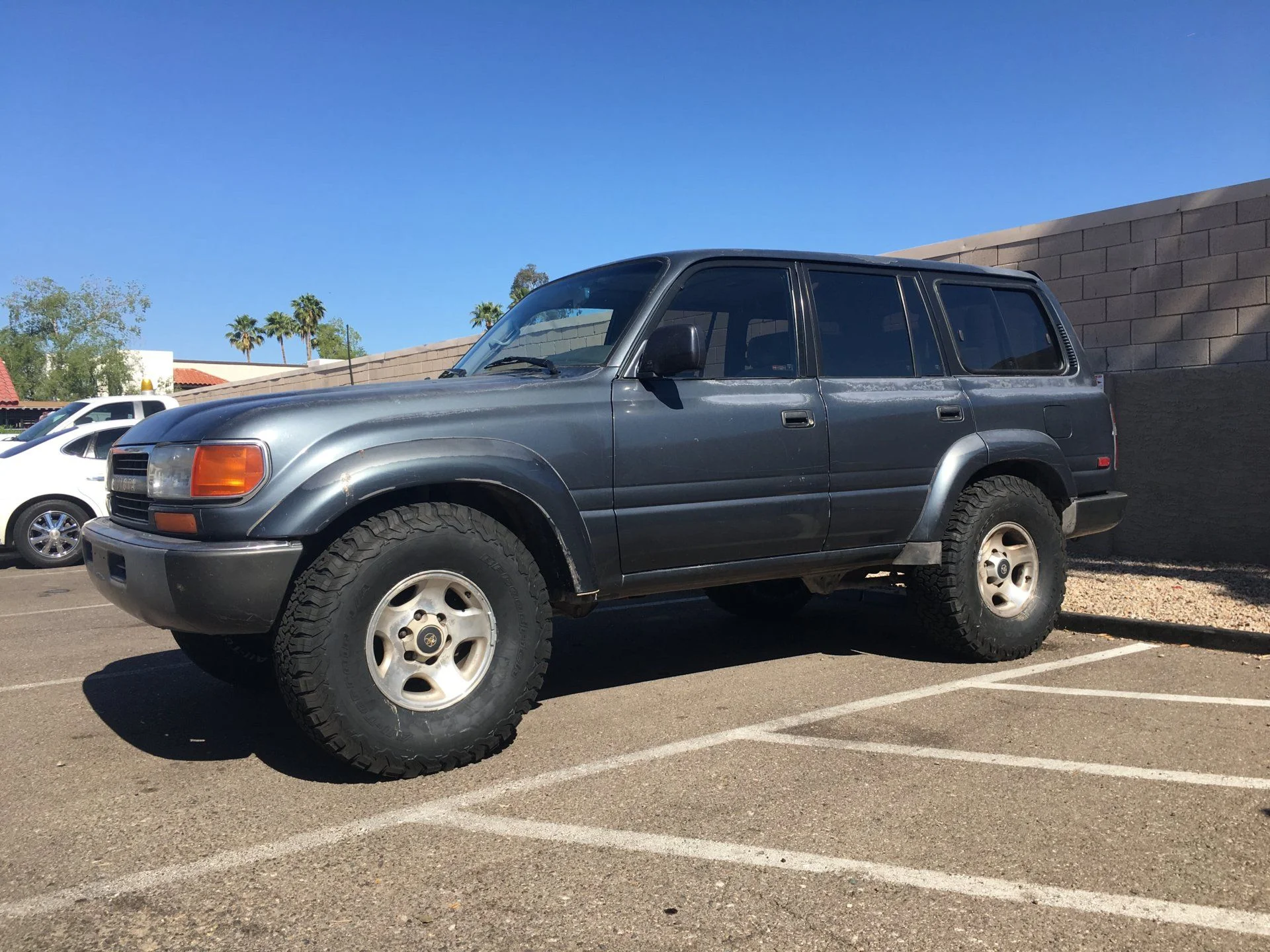

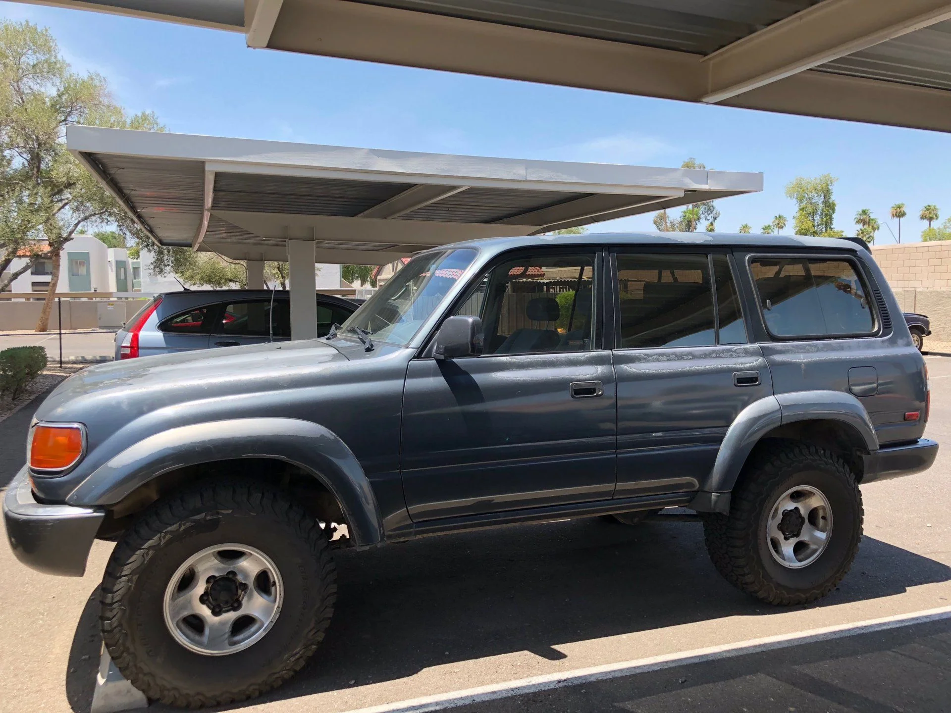

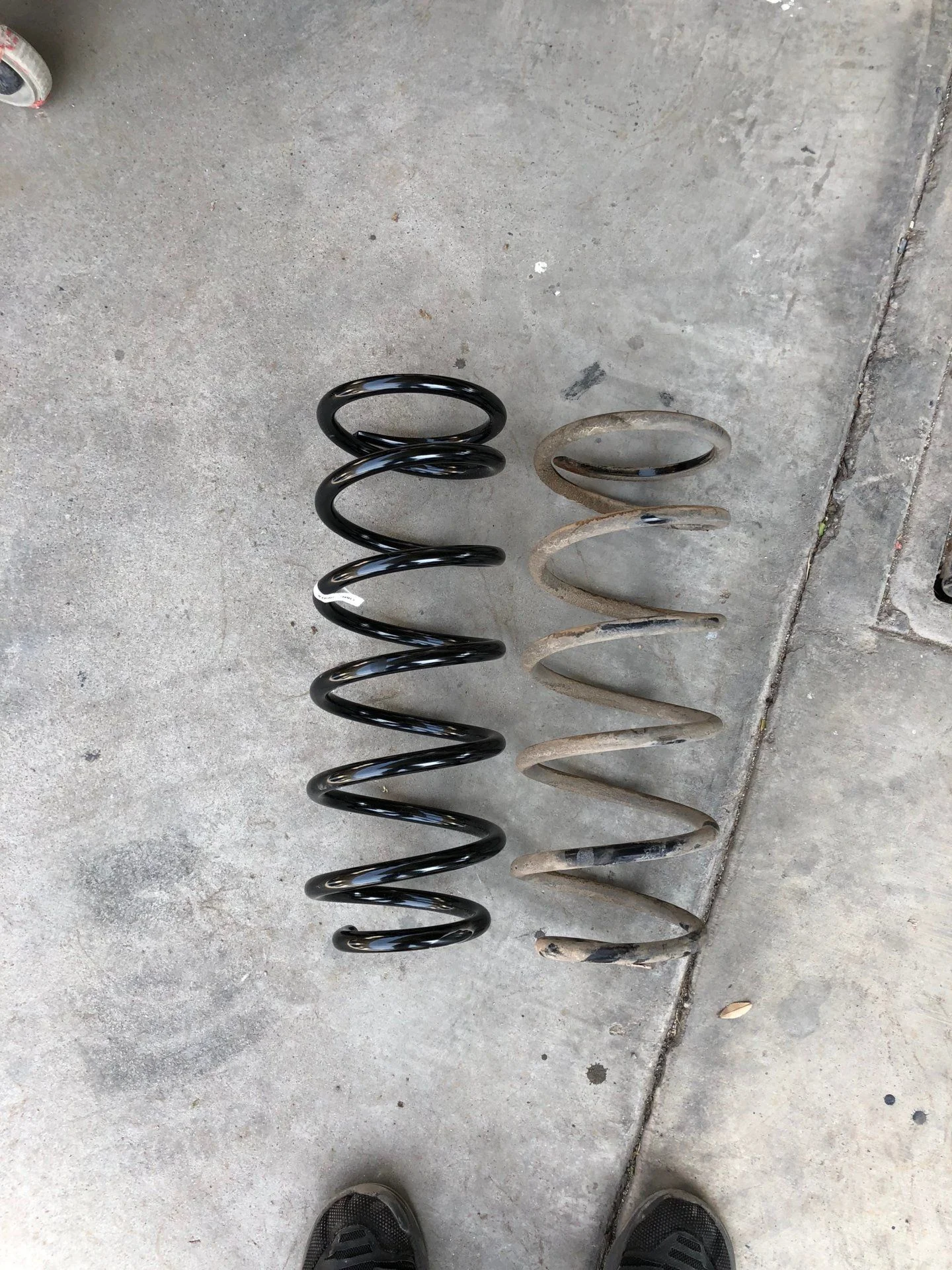

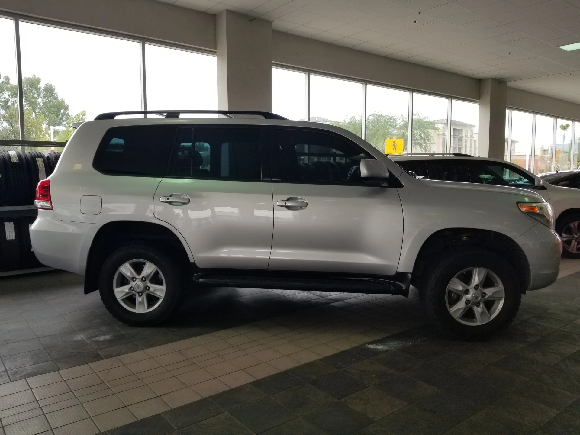

I finally got off my butt and installed my lift. I used a place in PHX off Glenrosa that rents out lifts and other small tools. The prices are higher then I am used to, Navy auto hobby shop (free).
It cost me about 100 total that included the cost of the lift, air tools, air hose and a couple of other tools that I had to borrow/rent.
The install took me about 3 hours from beginning to end. The only issue I ran into was the driver's side front shock. I didn't have the swivel I needed to make removing easy. What I did was put a wrench on the top nut and spin the shock with the use of pipe wrench.
But onto what everyone wants to see, pictures.
The first picture is a comparison of the rear springs. The apparent difference is the thickness of the coils themselves, but overall length is not much. The last picture is a comparison of before the lift with the BFG KO2 315/75-16 that I am still running.

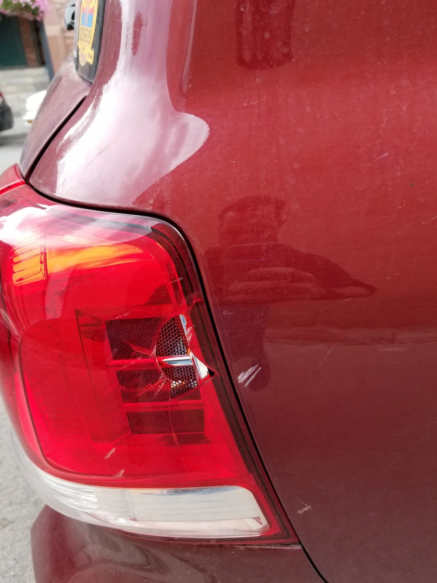

wheeled 3 days in Moab, then 3 more in Telluride. Amazing trip. No major mechanical issues this year! only ran into 2 hiccups.
the primary battery moved in the mount and the hold down bar knocked off one of the caps. Coming back into Ouray from Clear lake a crazy thunderstorm dumped rain and hail on us. as the water poured off the mountain onto the road, it kicked out rocks and one dented the back of the passenger side and cracked the tail light.
other than that, the compressor/on board air set up worked very well, the new gears were great in the mountains and trails, and somehow the rear bumper survived fins n' things, hells revenge, and poison spider.
