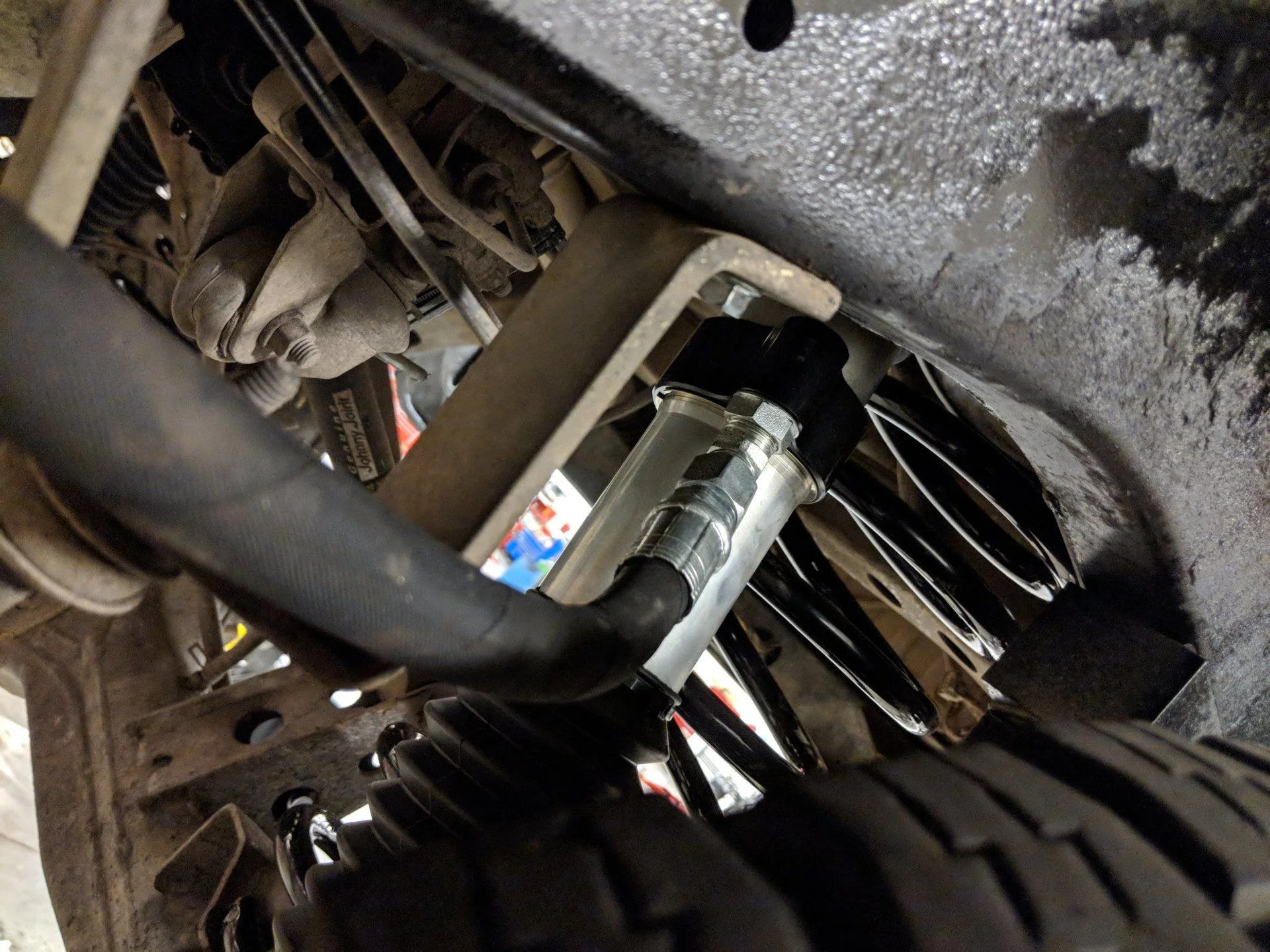

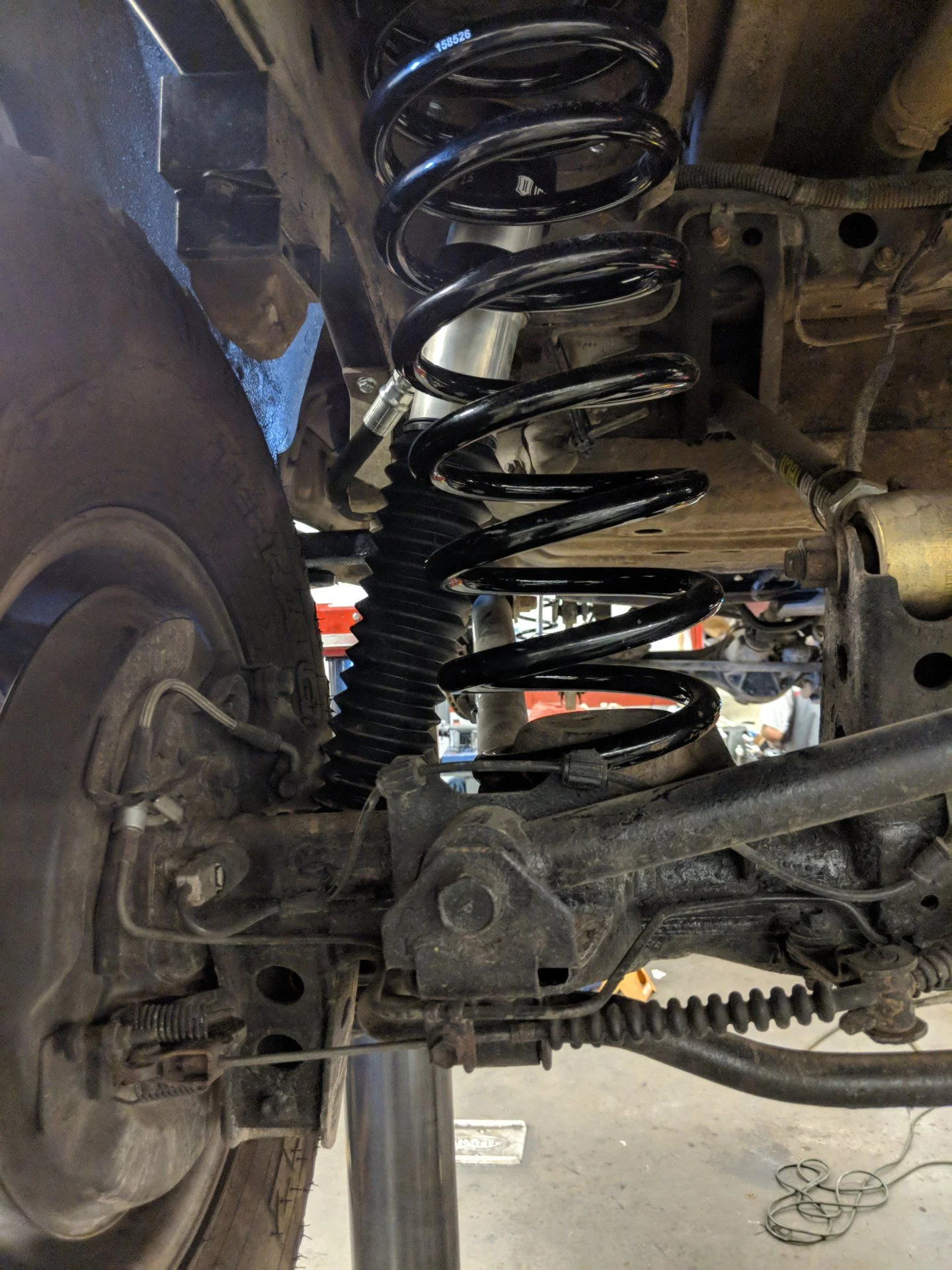

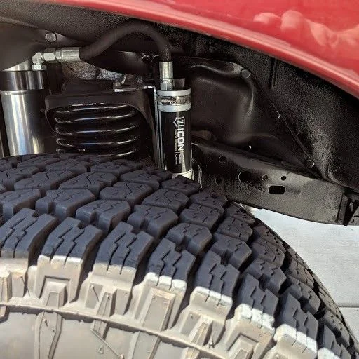

OK...I took off the OME lift and went with them Icon stage 3 with the beefy 2.5 reservoir shocks and the CDC valves to adjust and tune the ride (1-10) for soft to hard depending on terrain. The springs are the dual rate "slinky" springs that ride better on the road yet step up on whoops. I gained just about an additional inch in ride height. Been playing with the different adjustments and really like the true range of difference. LOoking forward to getting out for extended off road driving to continue playing with it.
All the reservoirs were installed where the adjusters are easy to reach and adjust quickly.

View attachment 1736150 View attachment 1736151 View attachment 1736152 View attachment 1736153
Very nice!

Nice change here Murf, just in time for the August ROTM that is being led by @LandCruiserPhil. There should be ample opportunities to test the new suspension and allow most of us to ogle your modifications. Thanks for the details and pictures
