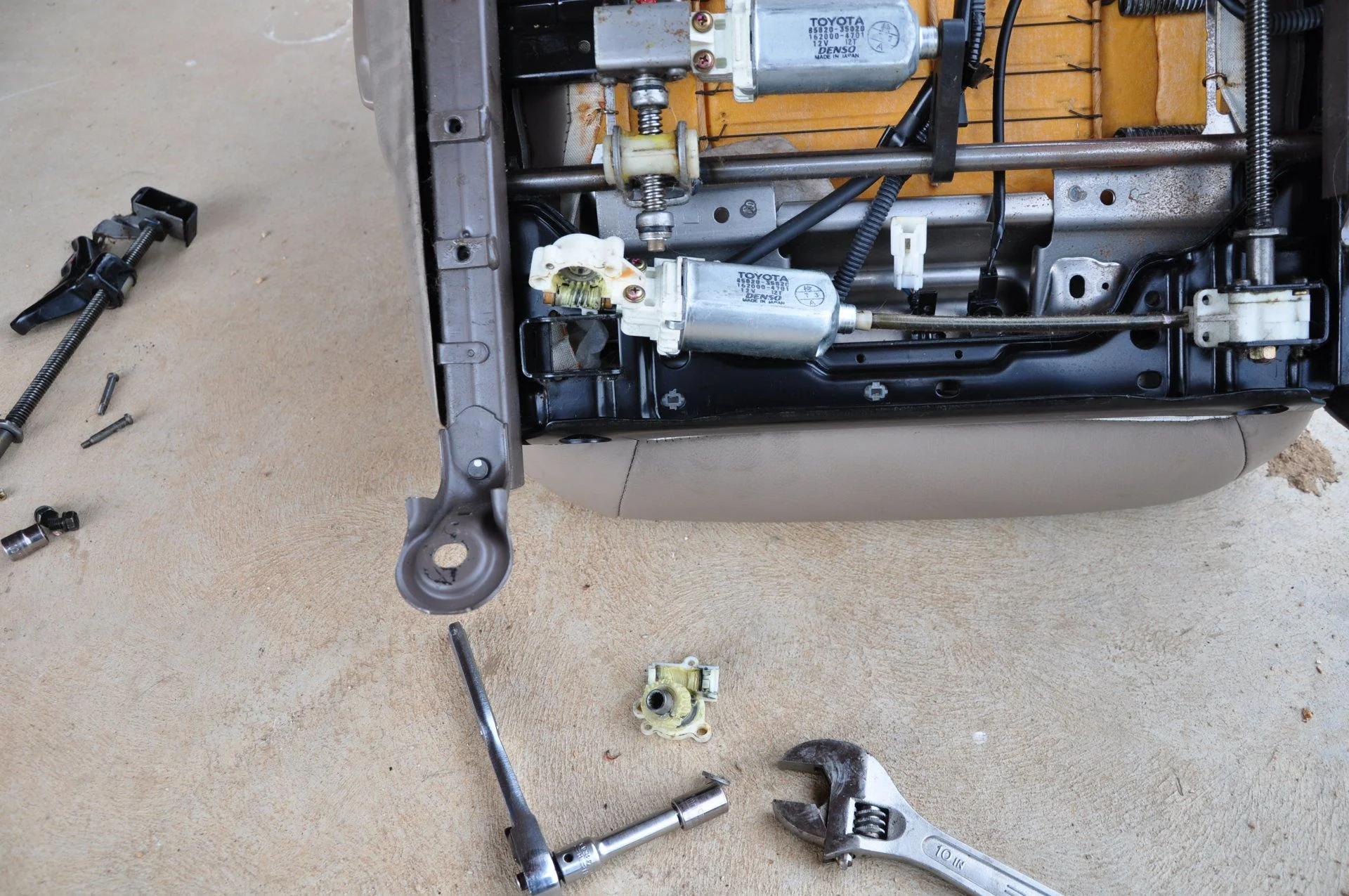

Also felt froggy enough to get my knees out of the dashboard.

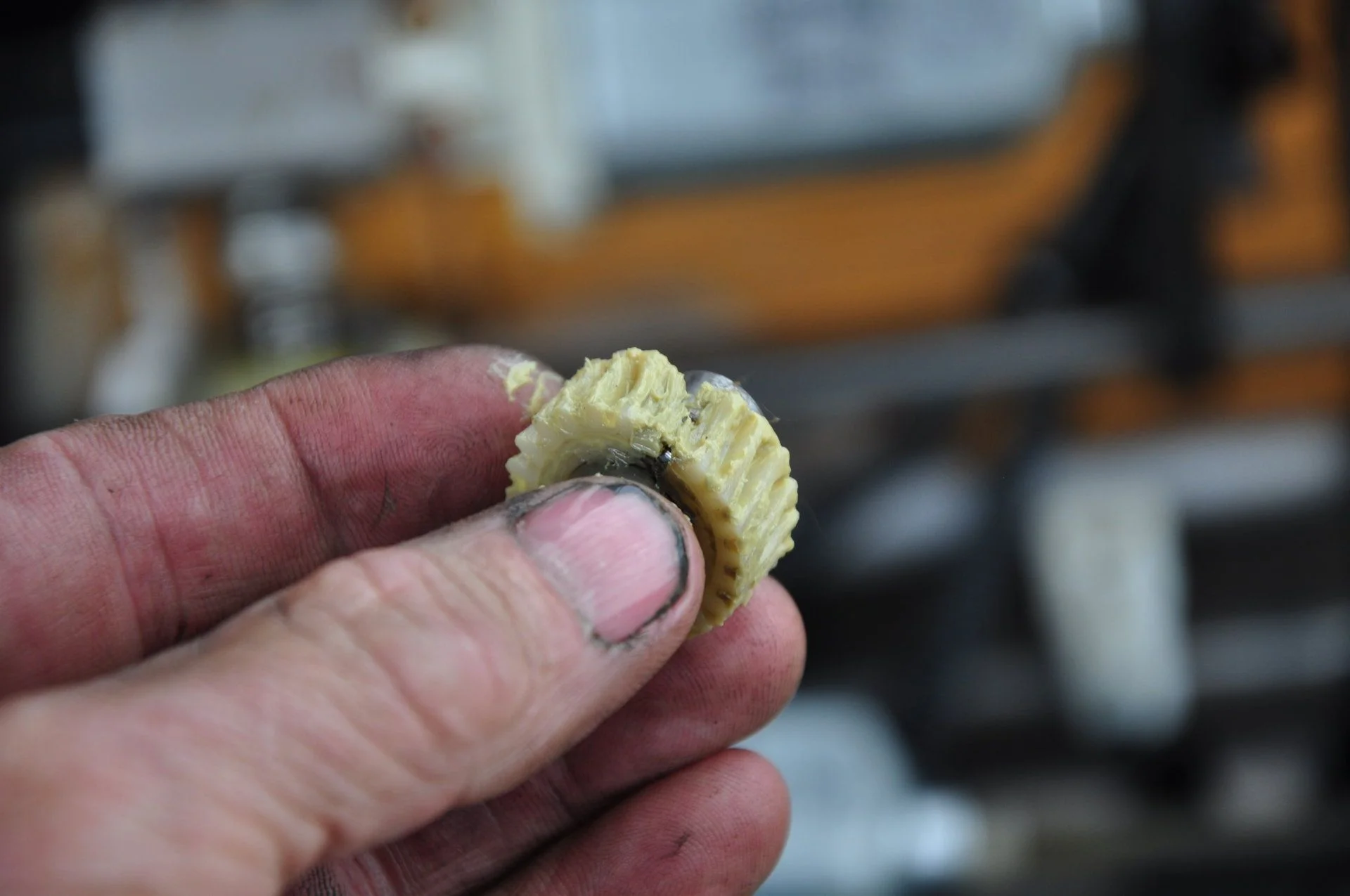

Good one stolen from the passenger side. I need to do some research and see if this is the same nylon gear that goes into an 80 series.
T4R has a decent write-up on this.
Power Seat Repair - Stuck or Barely Moving - DIY - Toyota 4Runner Forum - Largest 4Runner Forum
Also felt froggy enough to get my knees out of the dashboard.View attachment 1744896 View attachment 1744897
I picked up a set of those gears a long time ago. There were.pretty expensive but included more than just the gear.
Mainly the whole seat. Only took me about fourteen years to buy a 4Runner they would fit in.:hillbilly:

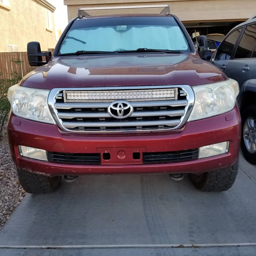

Been hitting the trail prep pretty hard the past couple weeks. Getting ready for moab/Telluride trip kicking off Saturday.
Installed the "bro-truck" light bar.

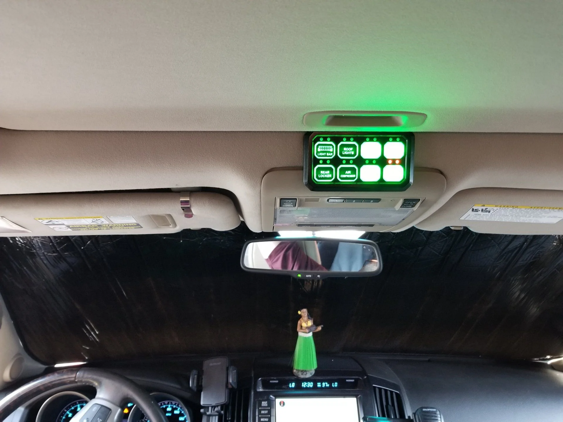

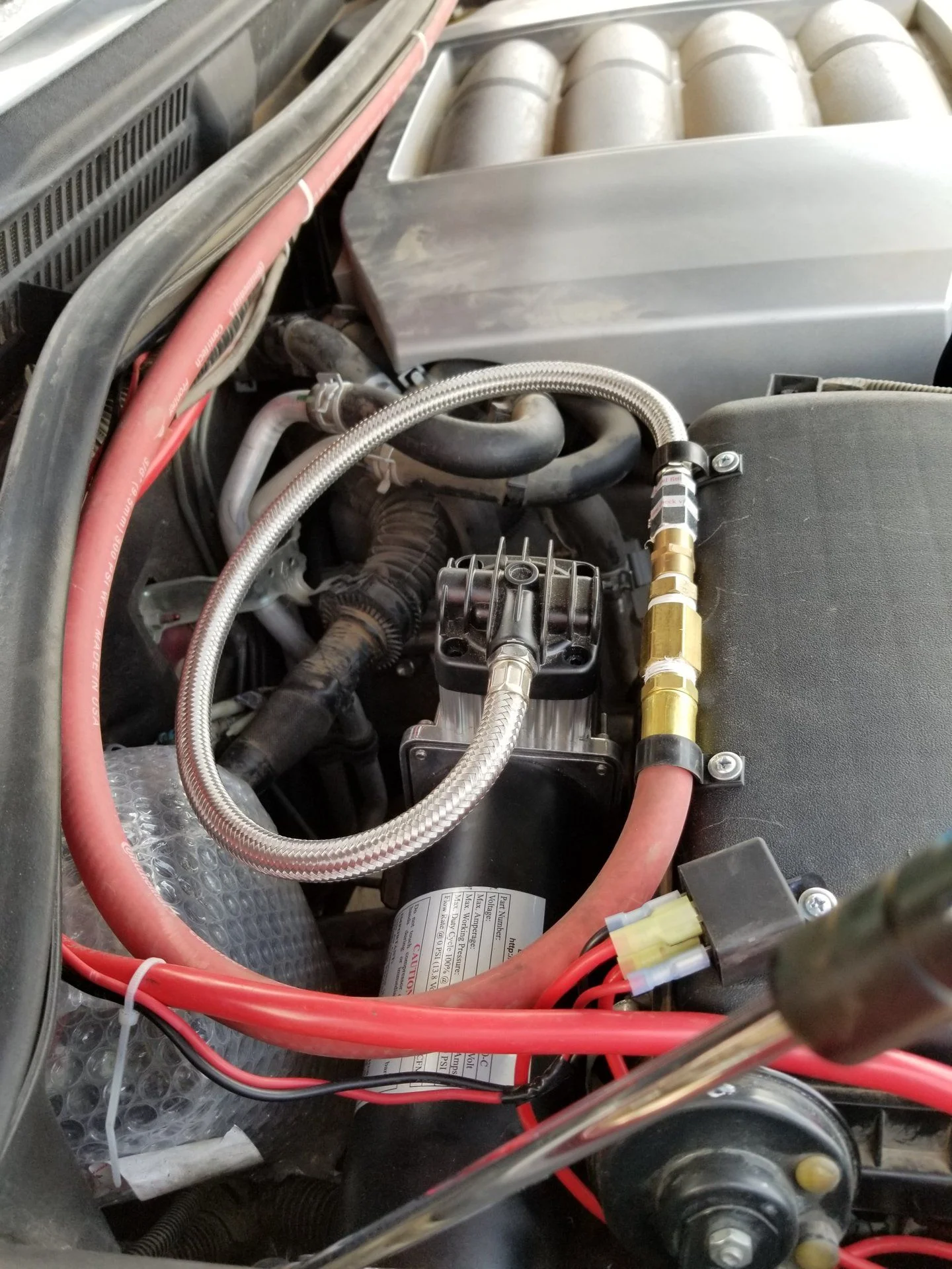

I swapped out the gears and went with 4.30 ratio from a tundra and 99 cruiser. The factory locker wouldn't clear the sway bar, so I started looking for alternatives. Found a thread in the 80 section where guys were using small air actuators. Which led me to install on board air...
To control the compressor and light bar and roof lights and locker I found a Chinese knock off s-pod on amazon.
It's basically 1/3 the price and 1/4 the functionality.
Replacing the rear brakes and serpentine belt tonight. Should be ready for more adventures.

Light bar is discrete and actually looks really good, not too bro'ish at all, imo. Unlike the ones on the roof front, with big, silly brackets, that stick way out over the windshield. :rolleyes:

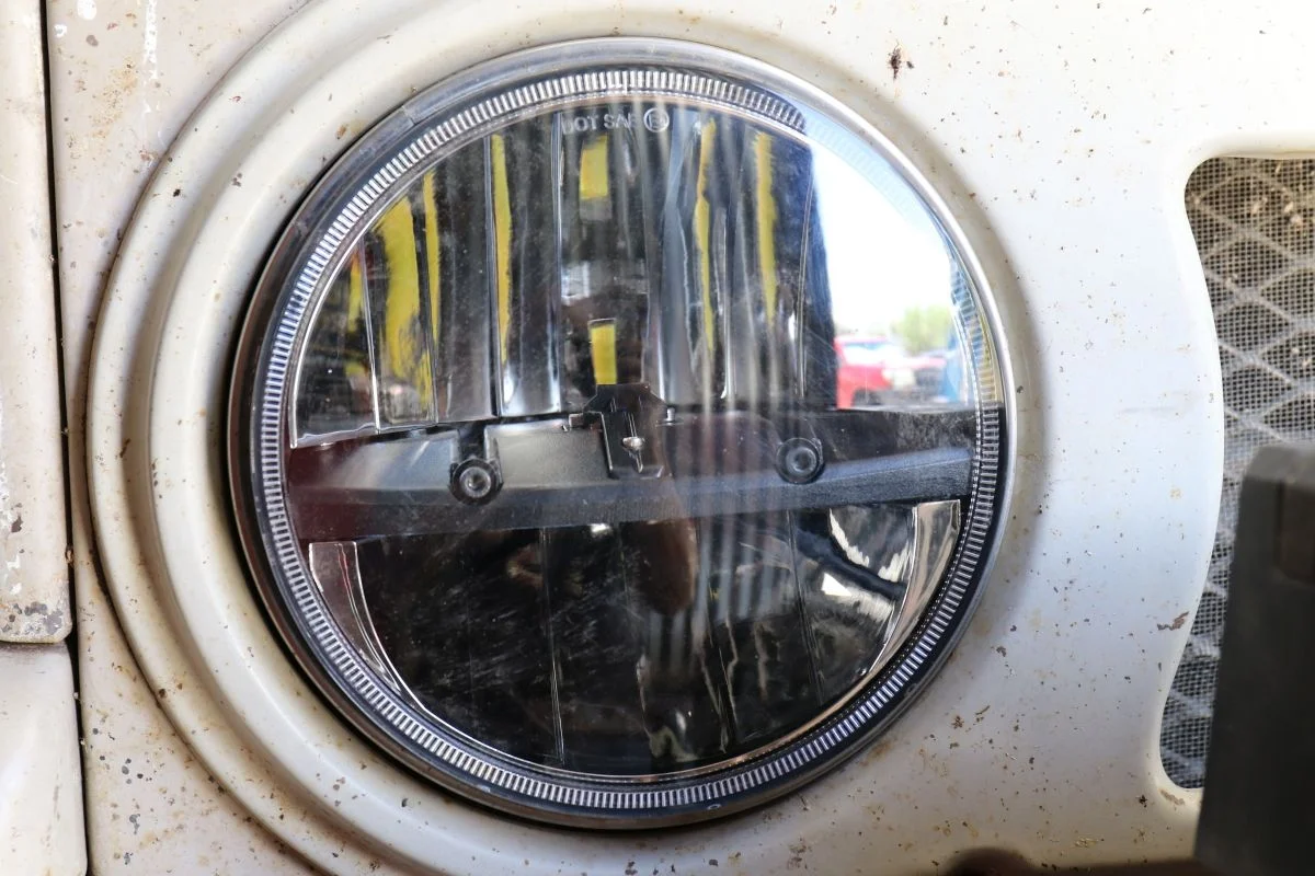

fwiw, give those headlamps a quick polish for the full effect!
Installed the "bro-truck" light bar. View attachment 1747856I swapped out the gears and went with 4.30 ratio from a tundra and 99 cruiser. The factory locker wouldn't clear the sway bar, so I started looking for alternatives. Found a thread in the 80 section where guys were using small air actuators. Which led me to install on board air...
