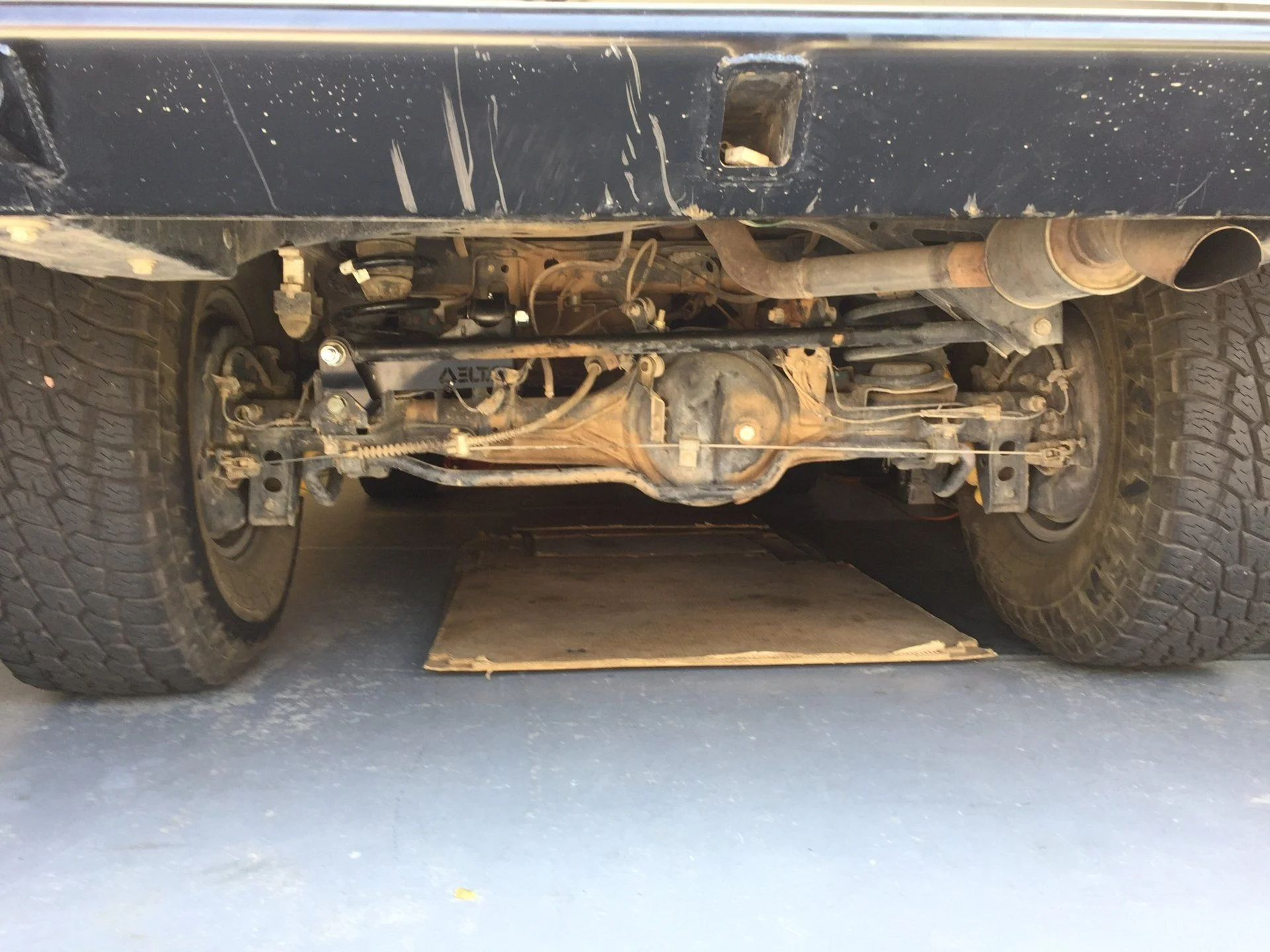

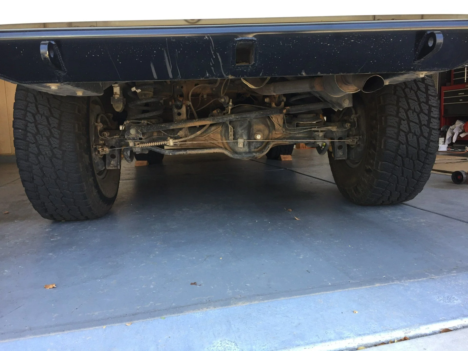

Thanks to @LandCruiserPhil for letting @cruddzand I join the cool kid club. Alvis and I sweated away yesterday before the storm installing our Delta panhard bar brackets. No seat time to share the change but the axle left to right seems to be more centered and the bar is more level. Ready to try out the changes on the August ROTM.

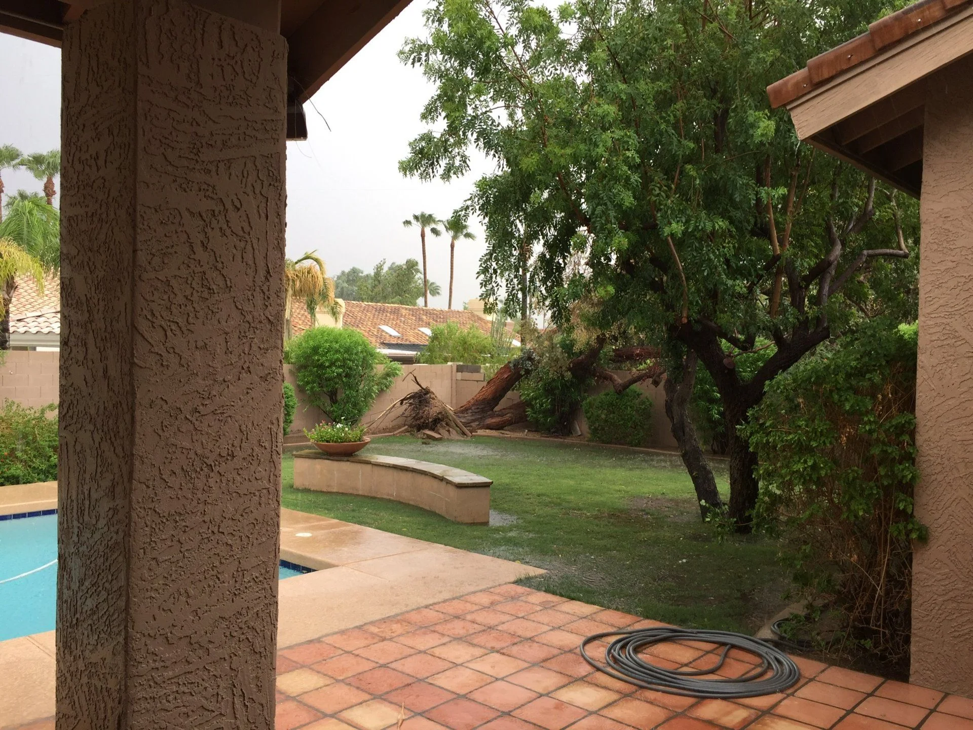

Storm added some extra work today, lost our big 40+ foot tree in the back yard and about 2 sections of block fence. Time for some landscape changes
:eek:
bummer Steve!
Ouch, that sucks, Steve.
I felt like we got every bit of those 60mph wind gusts, but luckily only lost a small mesquite. A couple others came close to toppling over. We were worried about our big Eucalyptus going over.

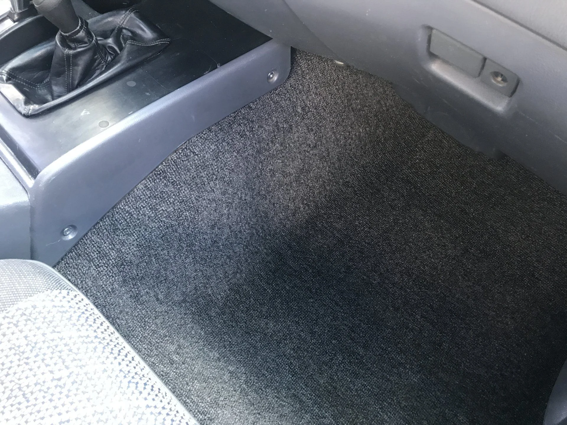

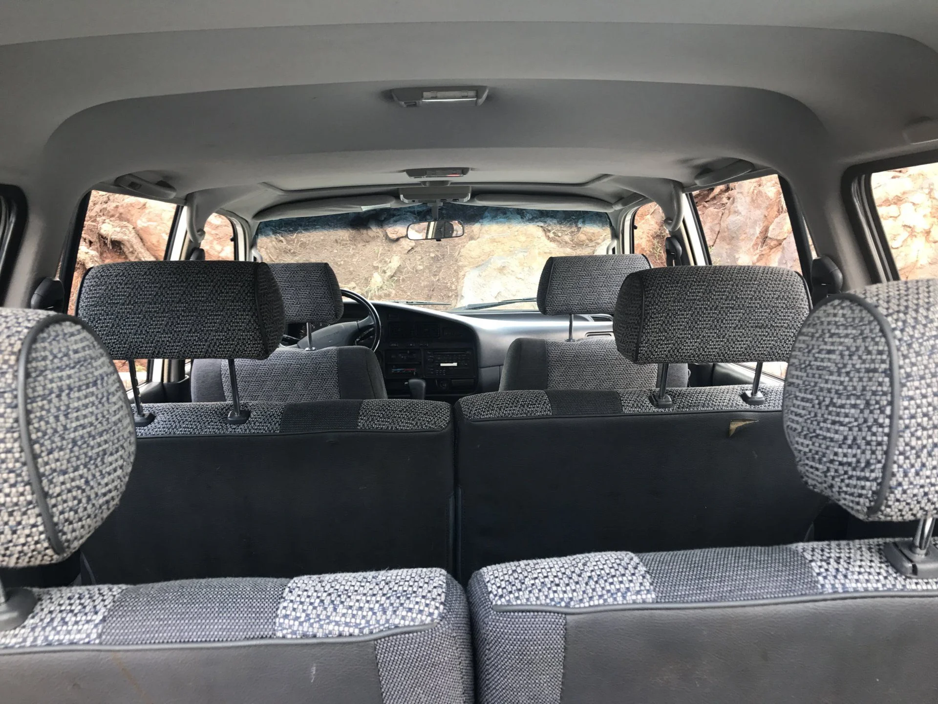

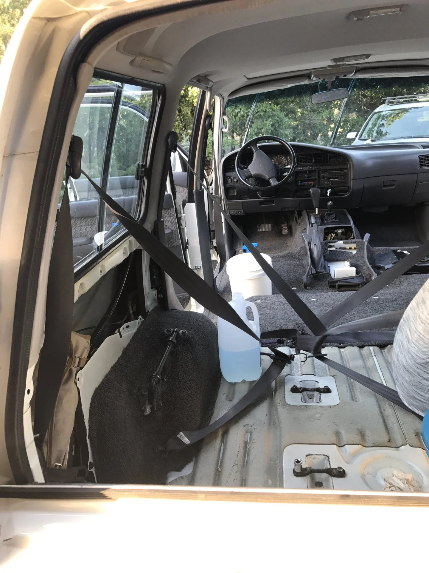

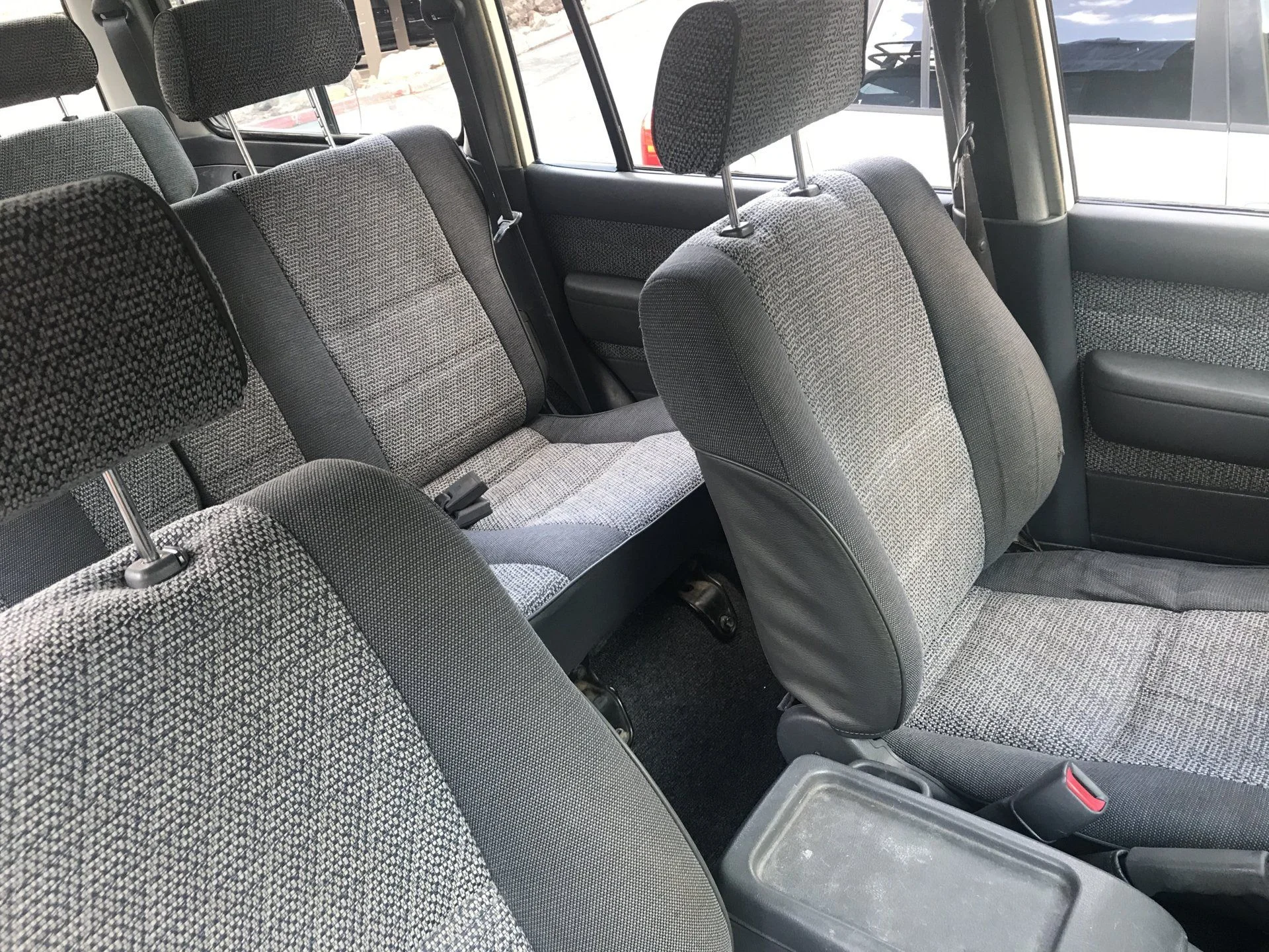

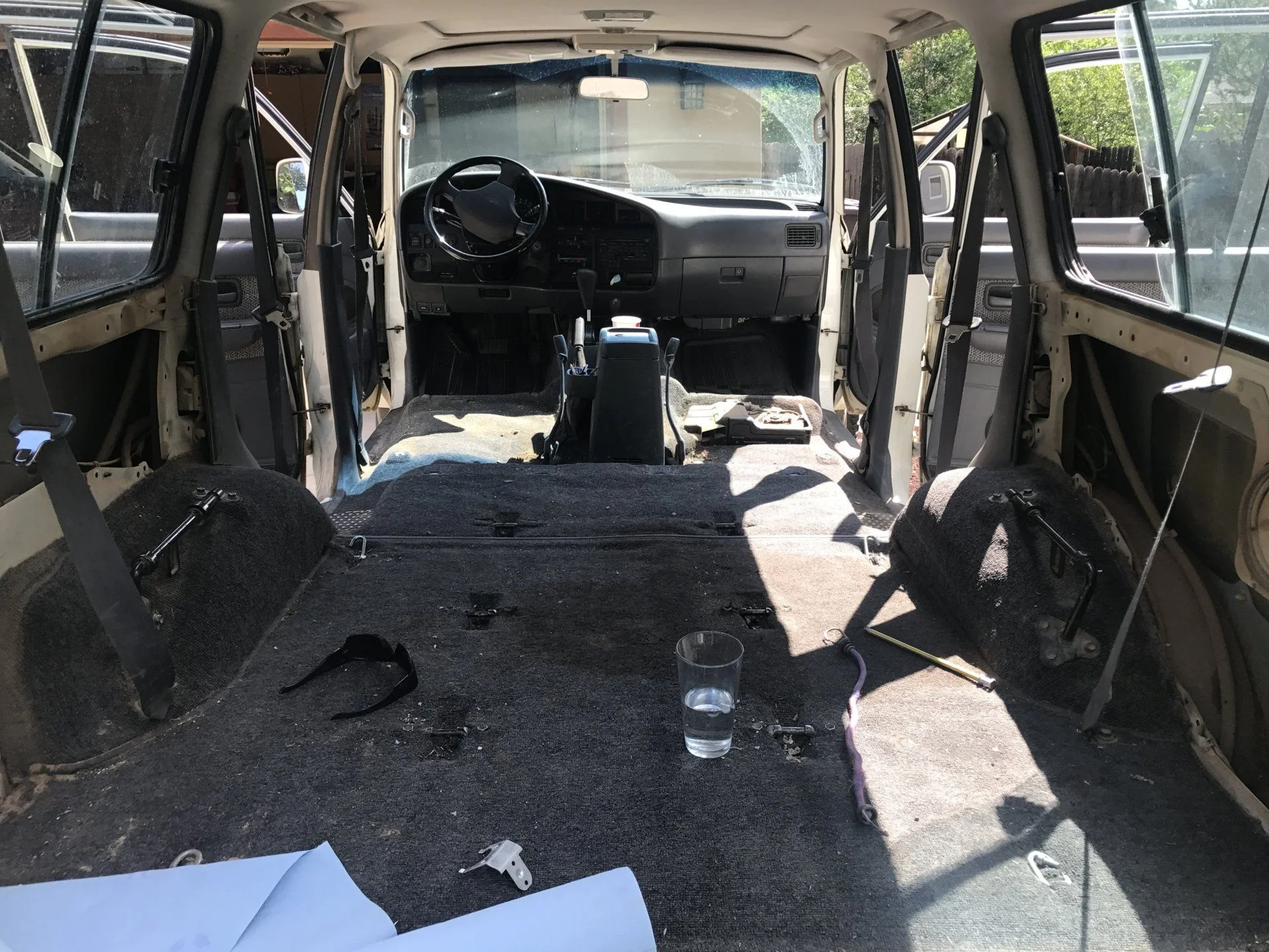

Shampood and vacuumed (thrice) all of the interior fabric - carpet, header, doors and seats, and cleaned the worlds usually hidden by the side panels and center console. A very dusty time capsule.
Amazing how nicely the Toyota fabric cleans up and holds up after 26 years.
What shampoo and other cleaning agents were used to clean the carpet, seats, door panels and headliner?
@medtro - "Shampoo" was shorthand and misleading. Sorry. Here's what we did...
In a one gallon jug, combine:
- 3 tablespoons of isopropyl alcohol (91%)
- 6 tablespoons of Windex "Original w/ammonia"
- 2 tablespoons of Ajax (or any other hand-washing dish liquid) - this cuts oil and grease
- 3 tablespoons of liquid Oxiclean laundry booster "odor blasters" - knocks out old stink, prevents new sink / mold as it dries
- Top off with hot water, and mix it up.
My girlfriend, who is gracefully militant about cleaning, researched this combination of ingredients on car carpet cleaning sites and forums. It worked well. It's very clean. It smells nice.
The method:
Apply cleaning brew to fabrics liberally. Scrub hard, in a circular motion, with a firm brush. Let it sit for a while, then hit it with a wet-dry shop vac to extract dirty liquid. Empty dirty water and clean the vac so that you have a sense of the dirtiness of new incoming liquid. Repeat until liquid extracted into the vacuum is clear (or, not dirty). On the third pass we'd typically get to non-dirty water in the vacuum.

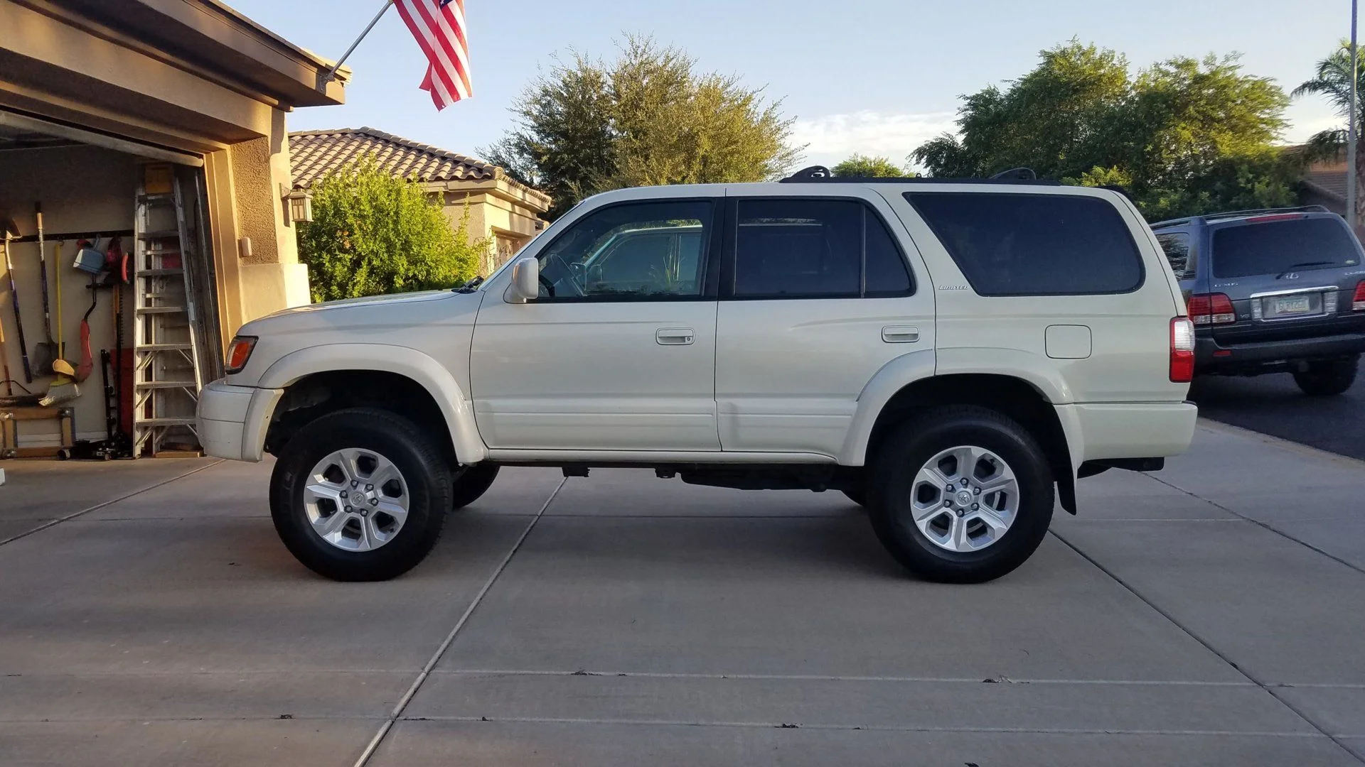

Bought our son a Toy(ota)!!
2002 Limited 2wd. 191.5k miles. Lots of little things to get it where I want it for him. Shocks/struts are shot. I just ordered some Gabriel replacements. Keep it simple at first, may throw in some 1.5" spacers but the shocks will lift it back up to normal at least. Have to fix speed module, charge a/c, tint the windows more, and trace an oil leak. But other than that super clean. Original Az car from Tempe Toyota, owned by a now retired school teacher. The guy I bought it from had it 6 months, didn't do a thing to it. How he drove it bouncing down the road I'll never know. Was in an accident in 2006, hatch and driver rear quarter has no clear coat so maybe she couldn't fix all the way?? Best discovery is all of her service history in the glove box, AND the original window sticker! Quite a find.

Thank you, yes for sure a good find. Weren't quite ready to buy but couldn't pass it up. Needed a few things as I mentioned but ready to go now. Sent back the Gabriels as I found some springs and shocks/struts from a 97 4wd Runner on CL for $60, raised it some so it looks good now. Kept the 1.5" spacer in the rear, the front spacer made the front too high. Sits perfect now.

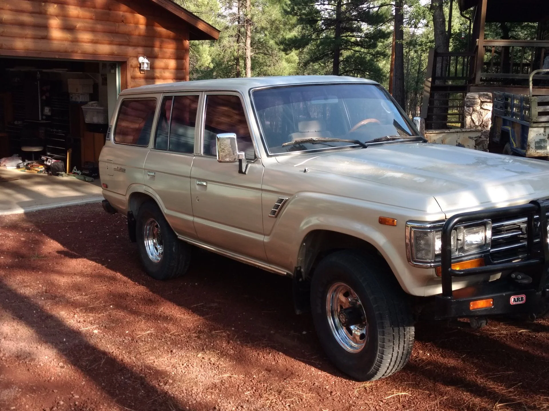

After running flawlessly on the last two run of the month gave my FJ62 a bath when we had a break in the rain yesterday.
Even cleaned the mud from underneath and especially the wheel wells because I hate rust even more than mud.
