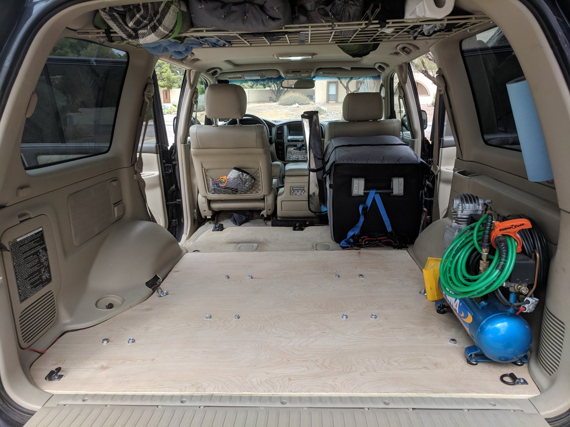

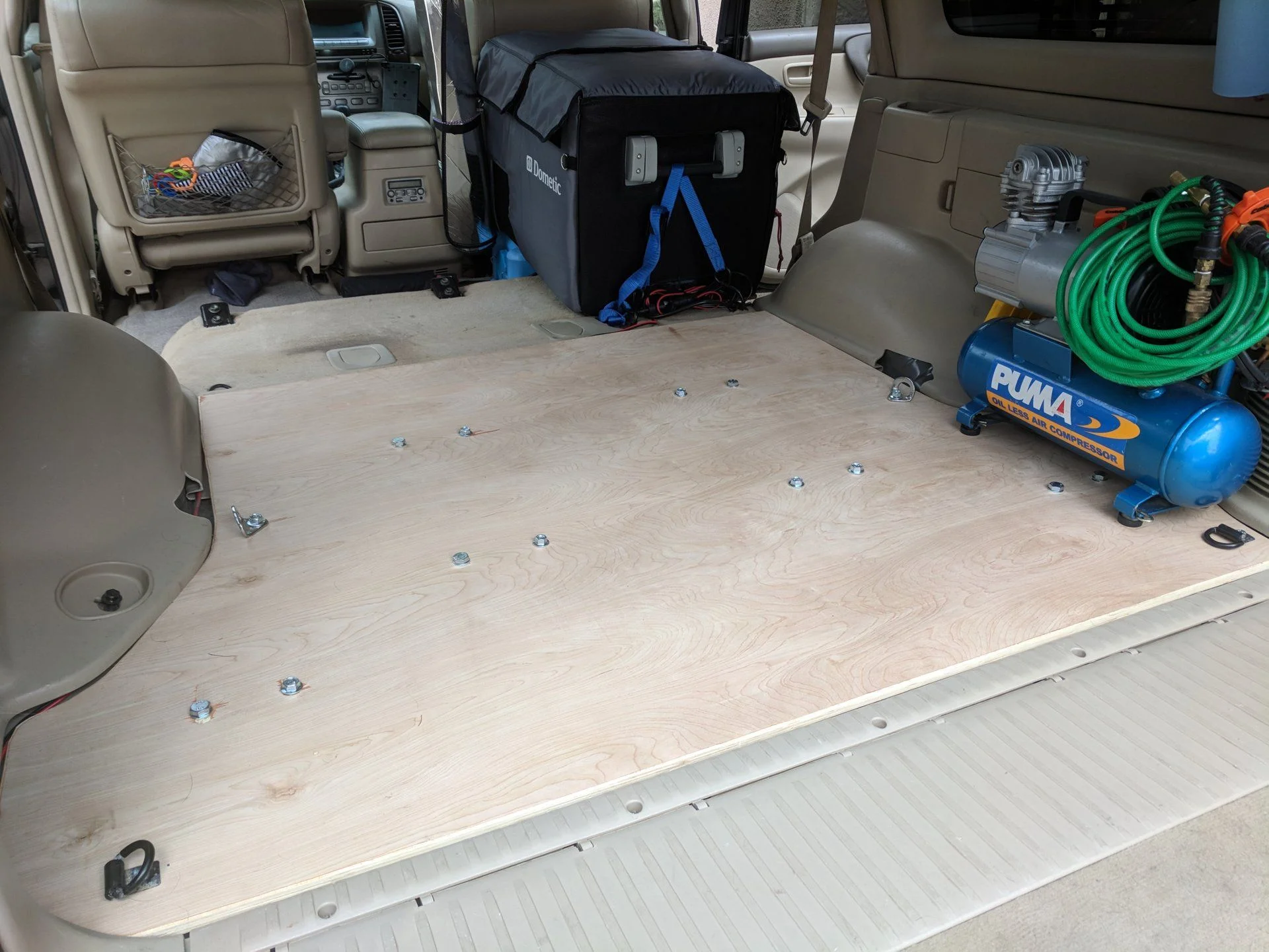

I finished up version 1.0 of mounting plate for the back of my 100 series. I wanted to mount my Puma compressor similar to the way I had it mounted previously in my 80, with quick release clevis pins. I also wanted some additional tie down points.
I used the carpet as a starting template for 1/2 inch Baltic Birch plywood. Made some adjustments, routed the edges, and managed to get the holes lined up for the third row seat mounting points. All of the tie down points are attached through the plywood to the body using existing holes.
Pretty happy with the results so far. Definitely have some plans for future modifications. It worked great on the Mojave road trip, and with the second row removed was able to sleep comfortably in the truck using my Exped mat every night with minimal fuss.

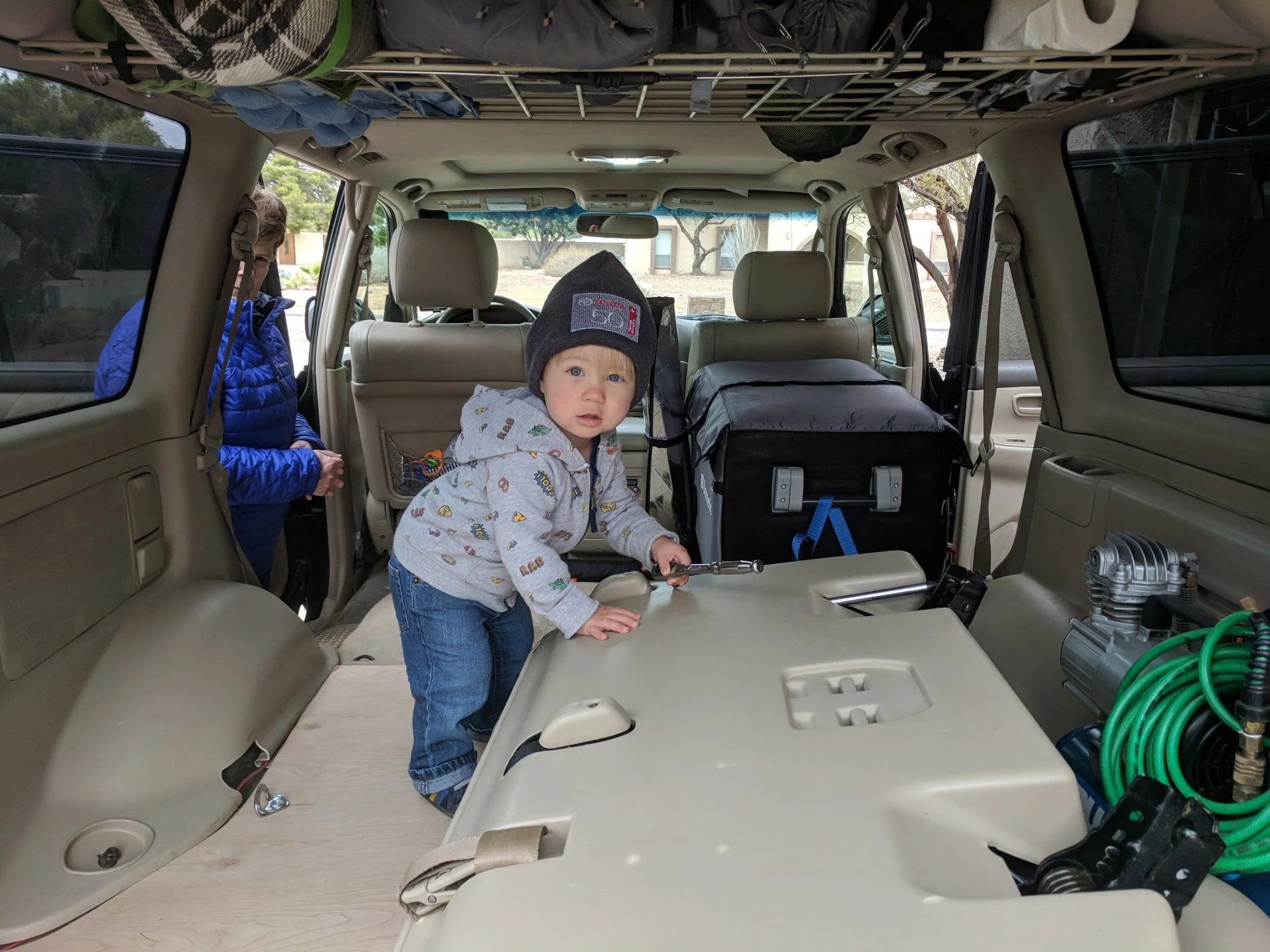

And here's Graham giving me a hand putting the second row back in after I got home from the trip.
I'm looking to do that very plywood floor thing and puma location in my 80. Where'd you pickup non-warped 1/2" Baltic Birch? Home Depot let me down pretty hard last time.

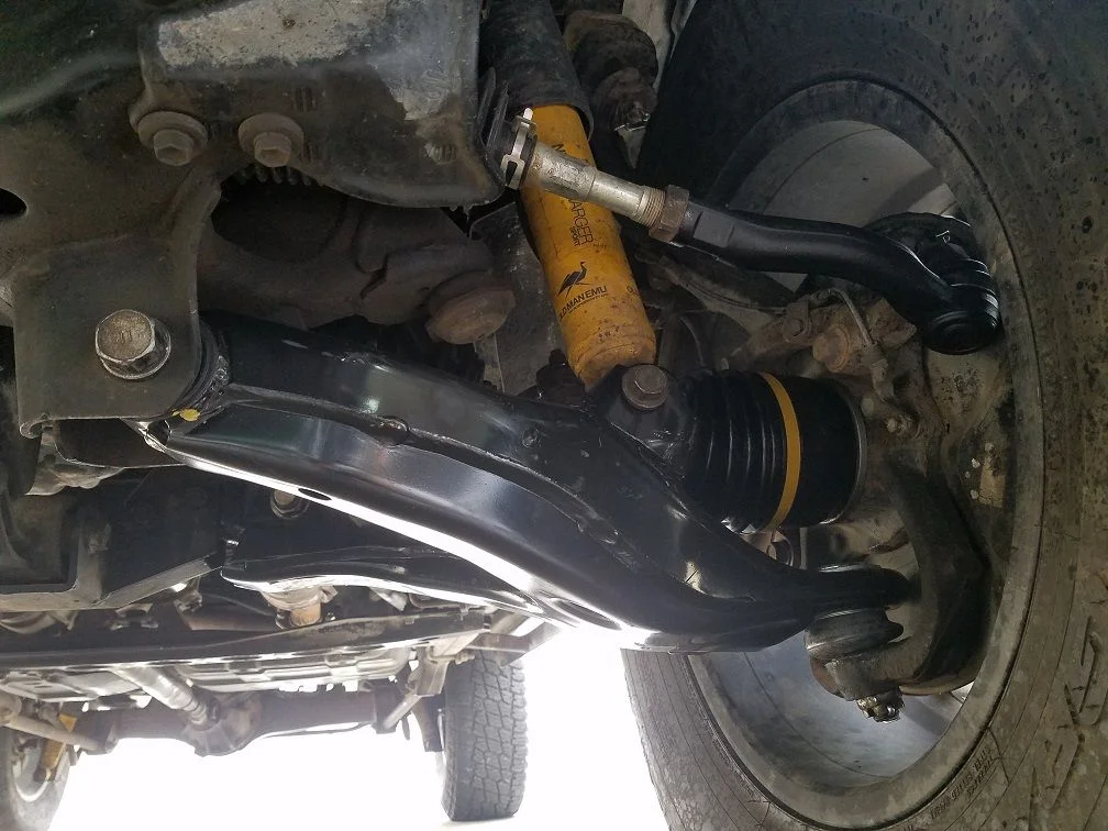

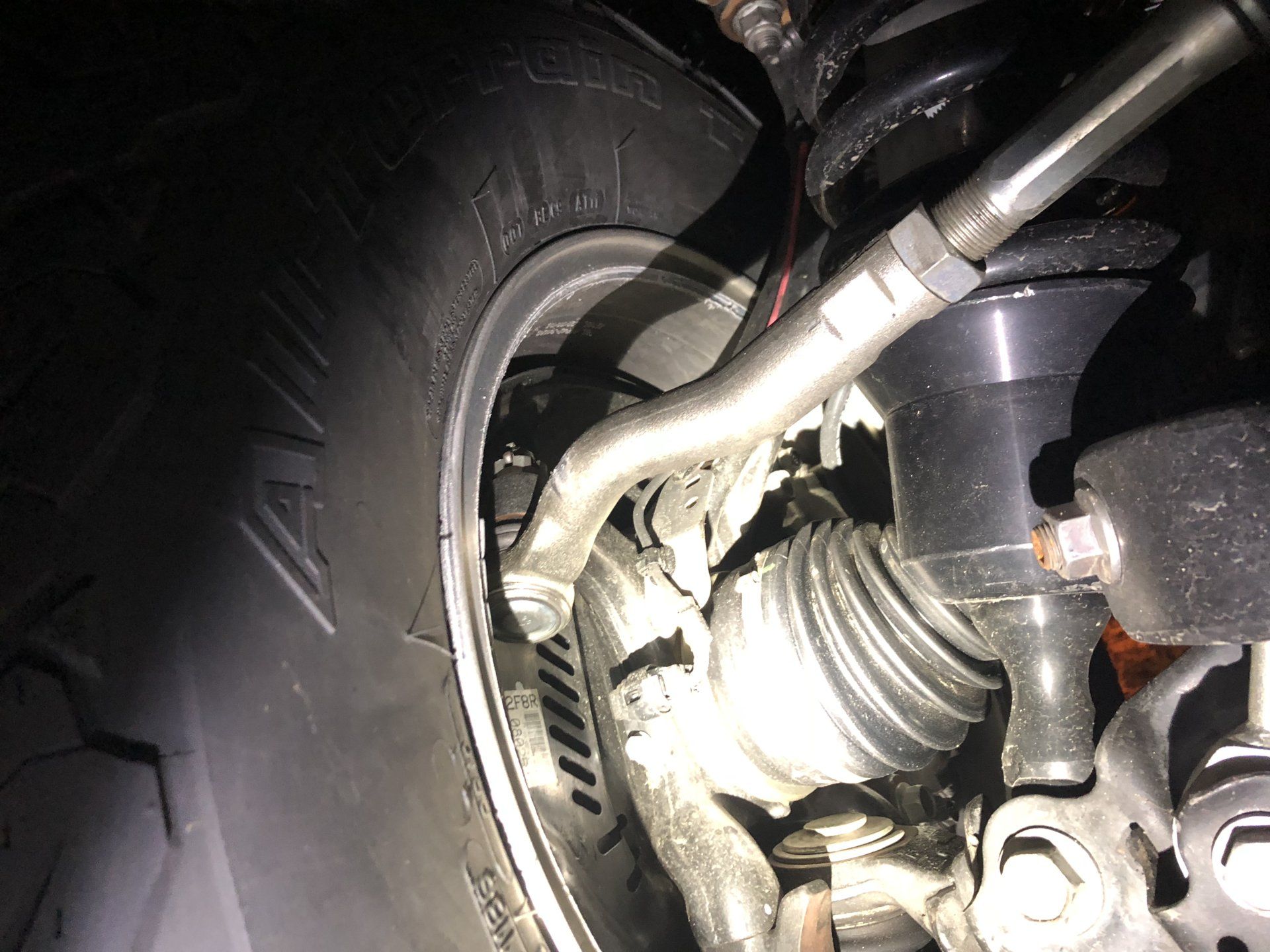

are the tie rod ends new?
do they mount differently between the 100 and 200 series?
there was a 200 series owner that had his done with the bend facing forward and it hit the inside lip of the wheel at full lock.
TexAZ, your correct they were put on the wrong side and therefore the curve is forward not backwards. I just tested clearance and I only have about 1/4 inch between tie rods and the wheels at full lock.
Thanks for pointing that out, bummer that I now have to do the whole dealer thing again.
Sorry man, just saw another set of tie rods that looked suspect.
At least you caught it quick.
YEP, our bad - very sorry this happened! When you get here at 7am, we will attack it immediately and get the ends swapped and realigned while you have a cup of coffee. The tech is already prepped and will be ready for you.
Home Depot. Found a pretty straight piece, and had them cut it at 5ft, so I have a 3ft piece leftover.
