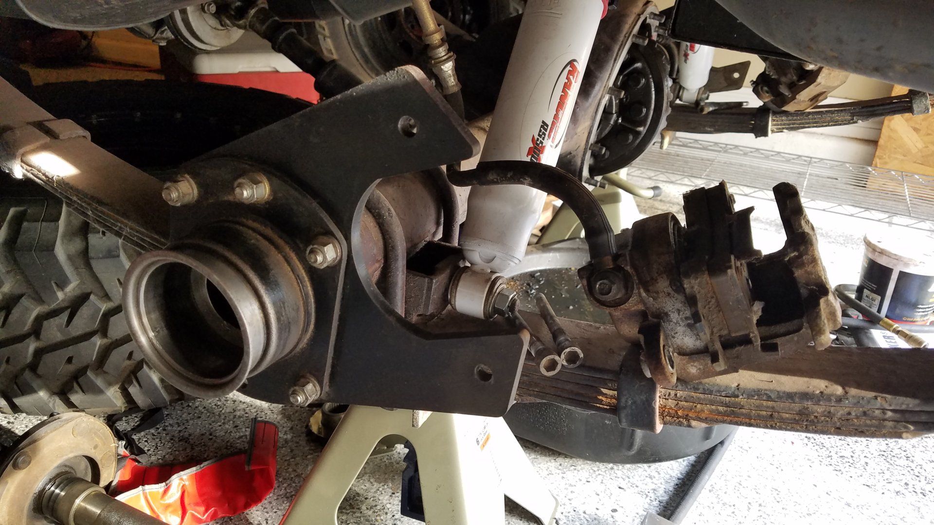

Only one brake line to fab and i will be bleeding and testing the front disc brakes!!!

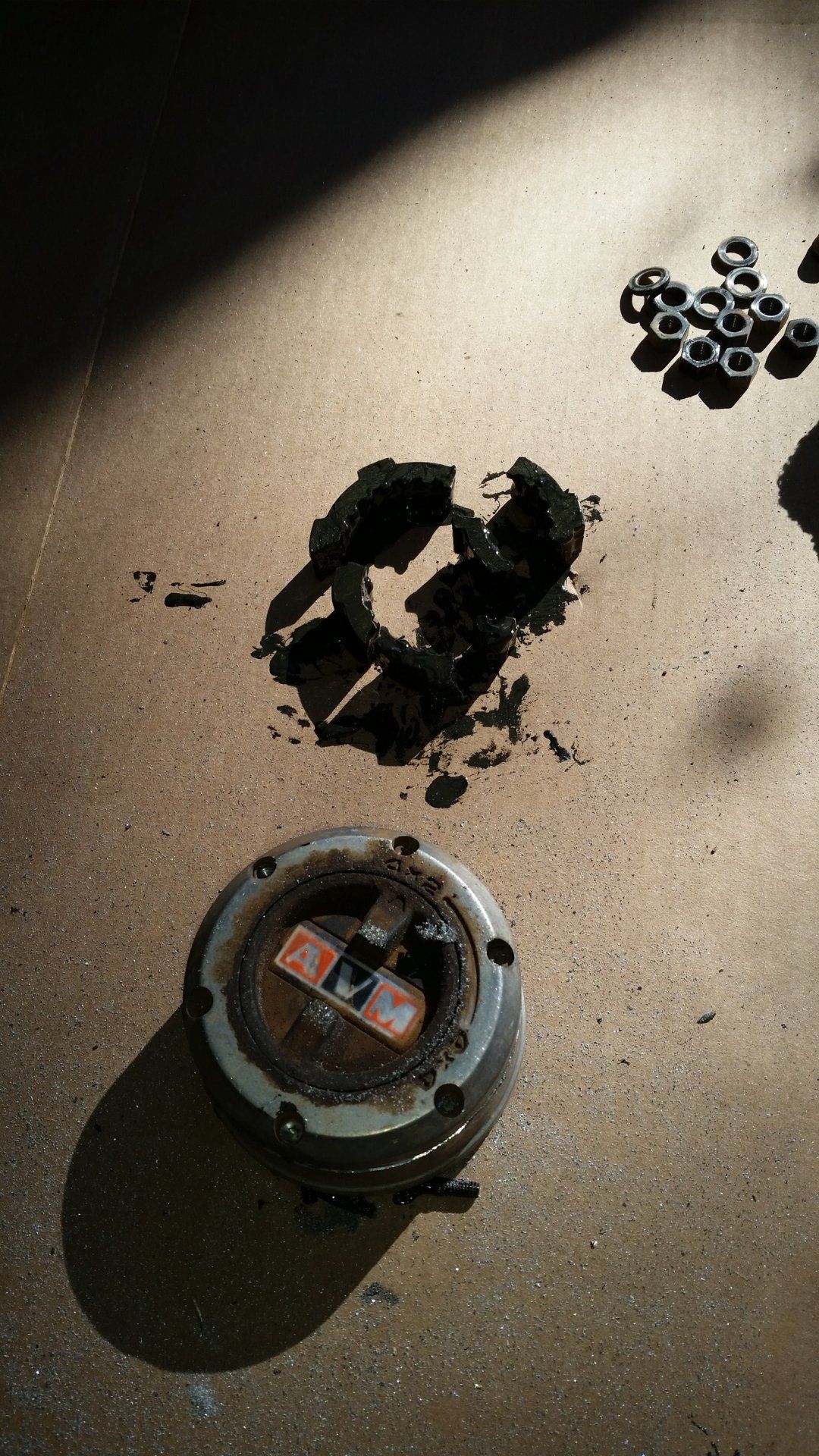

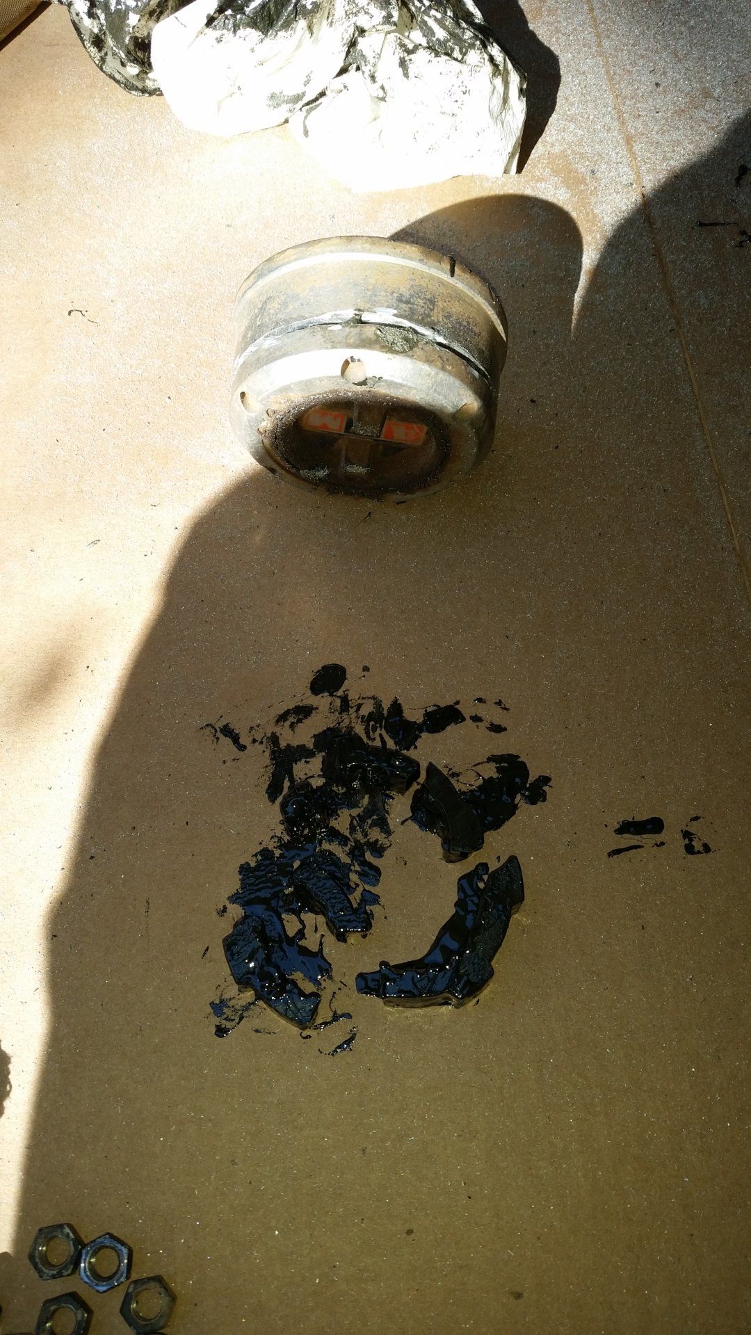

Removed my broken avm hubs with a cut off wheel. Driver side hub gear came out in 6 pieces, passenger was intact. Replaced with Aisin HD.
What vehicle was this on? Watching videos yesterday seen a 80 series in Australia that had sheered the six studs off hub that had Aisin lockouts on it. Interesting watching the lockout spin and the wheel not moving. Besides which vehicle how was it setup, tires, engine, locker?
They were on my 80 series, less than 30k miles on them. It has lockers with 4.10 gears and 37s. I was trying to climb a very steep & loose hill when it failed.
As far as the video you saw most likely the studs were loose and allowed the hub gear to walk back and forth on the birf which sheared the studs. It's often overlooked when servicing the hubs, we just don't see it much here because all 80s are full time 4wd.

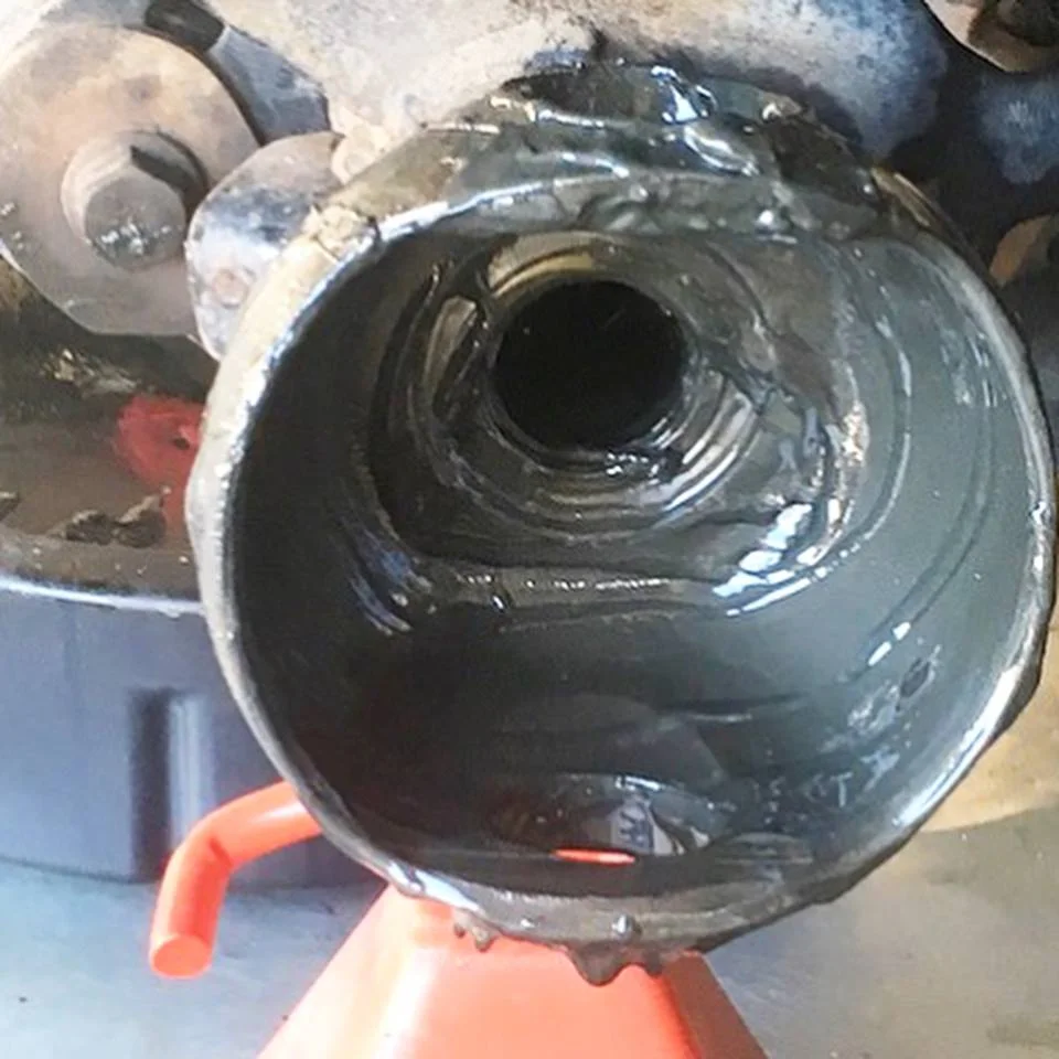

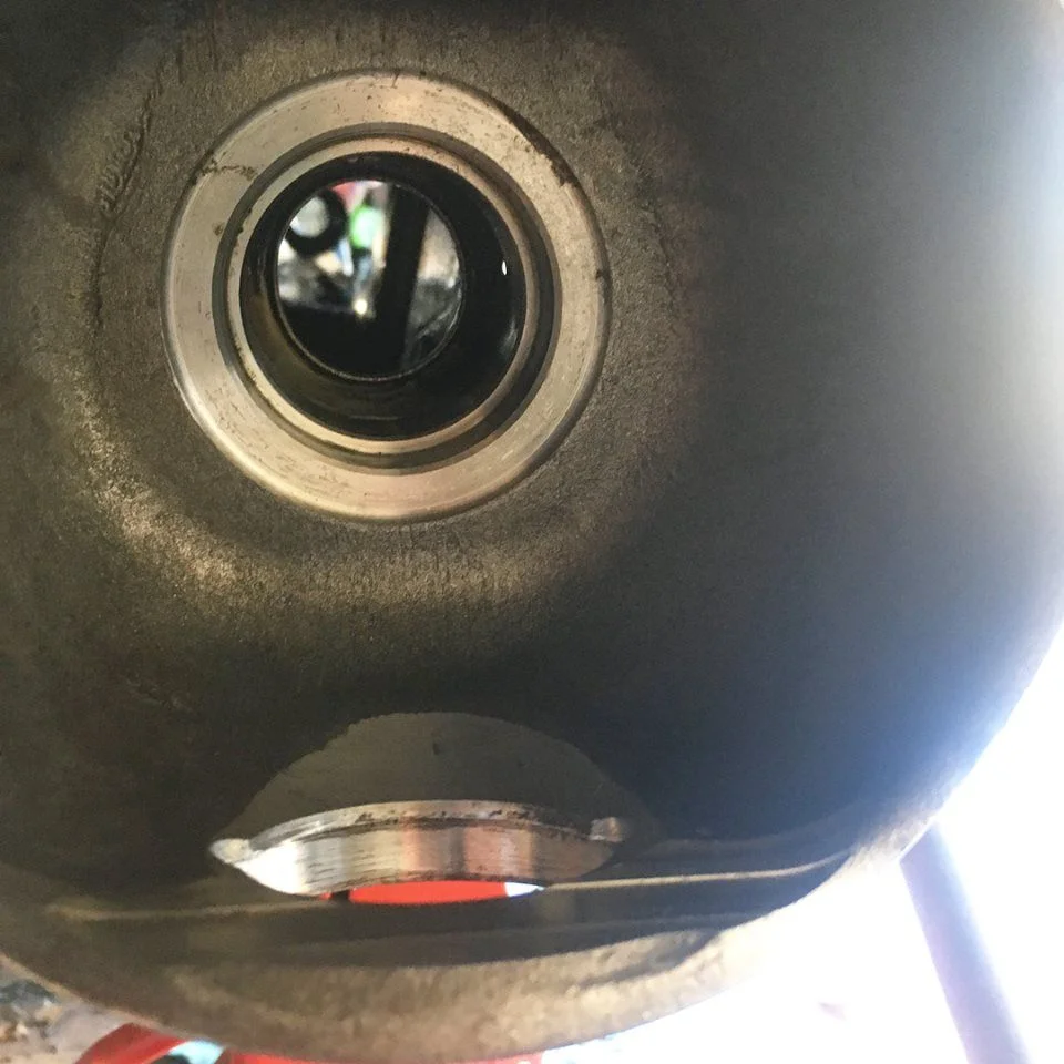

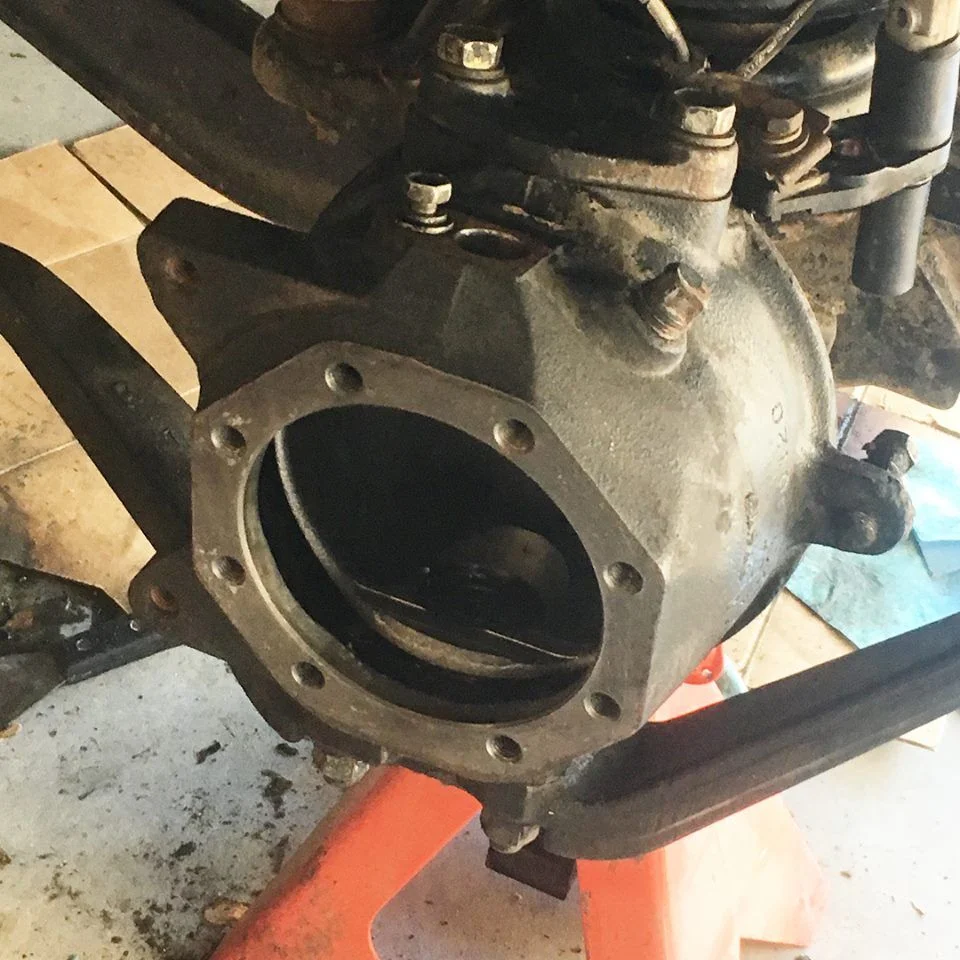

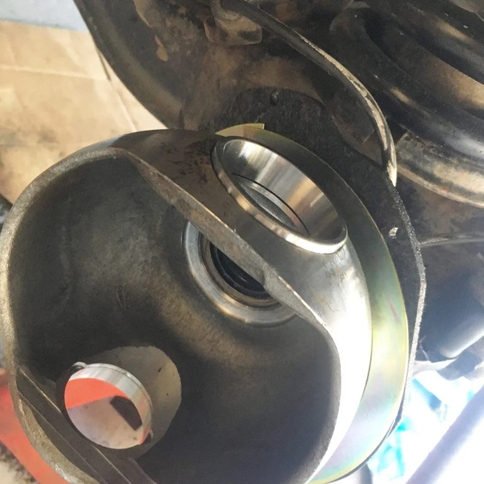

And about a month ago, @richardlillard1 and I rebuilt the knuckles on my 80 (95% Rich, I just did the cleaning).. after 340K they decided to let loose!

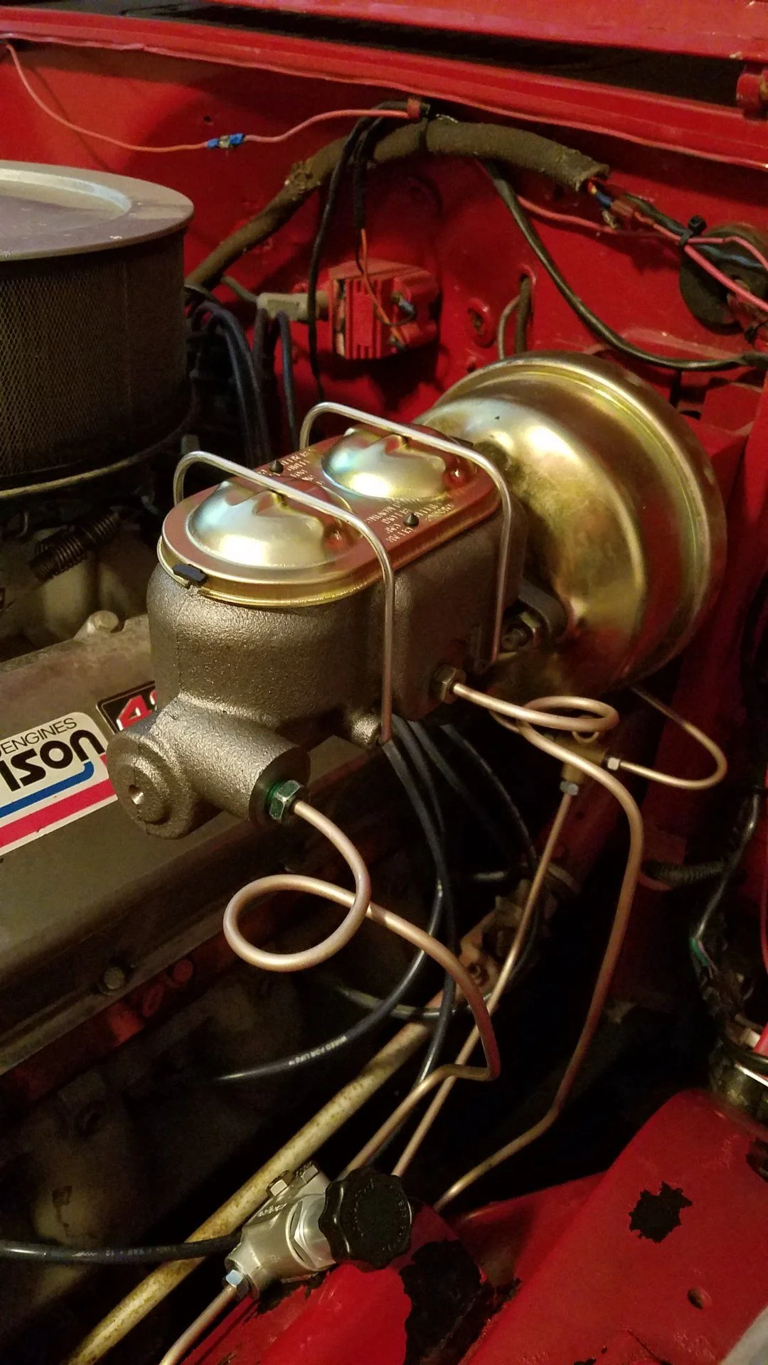

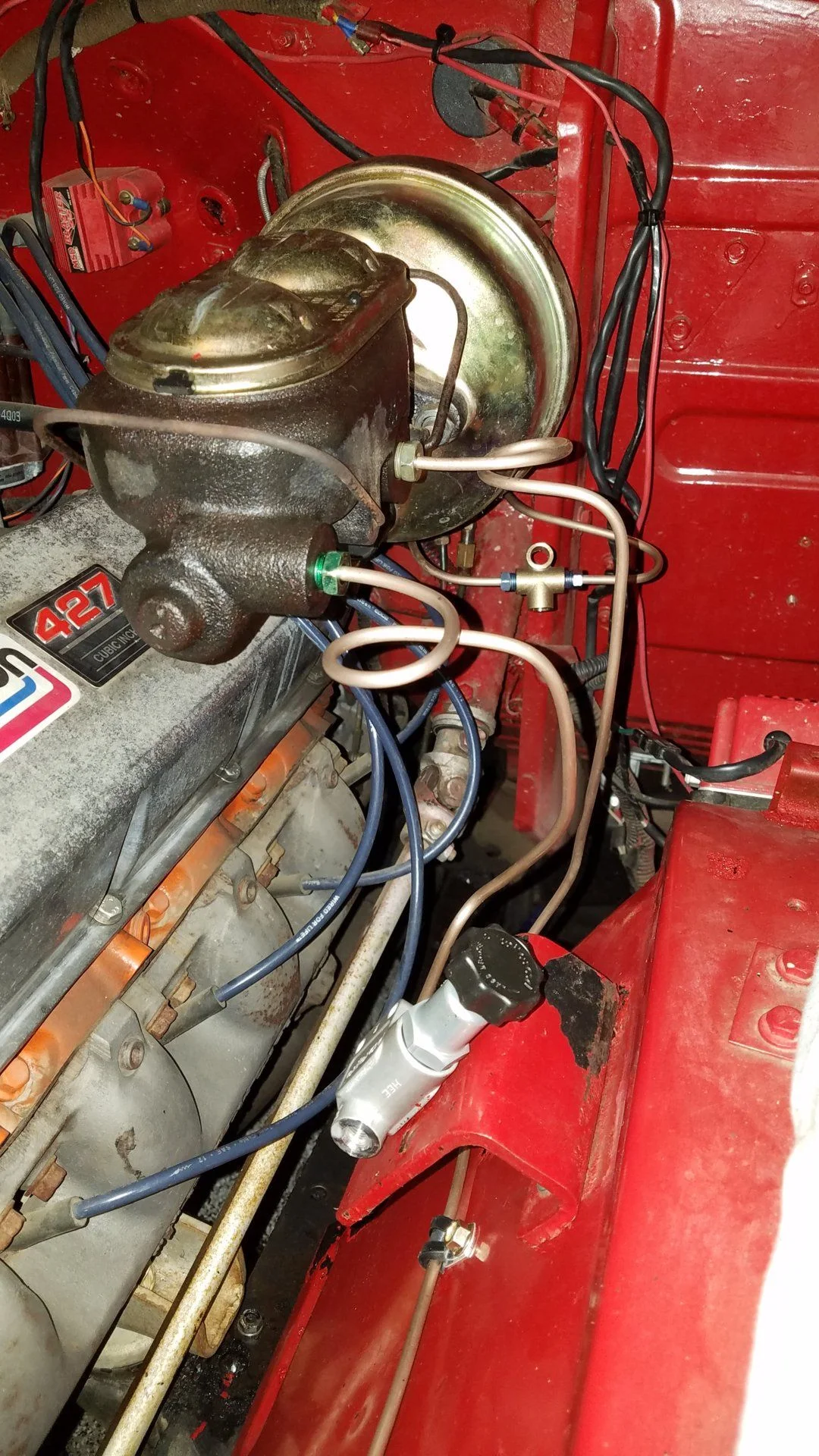

Amazing things happened today. So I have been working on my brakes for some months now. Replaced the front axle drum brakes with 1987 fj40 disc brakes... Got some help from my wife's uncle from Canada who used to sell all sorts of auto parts. When I was trying to bleed the final setup of disc brakes all around, he mentioned that the brake peddle was still soft and went to the floor with little resistance . Then he listened to the master cylinder when I pushed on the brake peddle and said he knows what is happening... He said that brake fluid was passing by the first seal inside the mc. Turns out that after removing the mc and taking it apart it had some bad pitting where the seals made contact with the inner bore surface. Realizing the age and condition of the gm corvette master cylinder I got ahold of a new one, installed, blessed the brakes again and voila!!! SOLID BRAKE PEDDLE!
