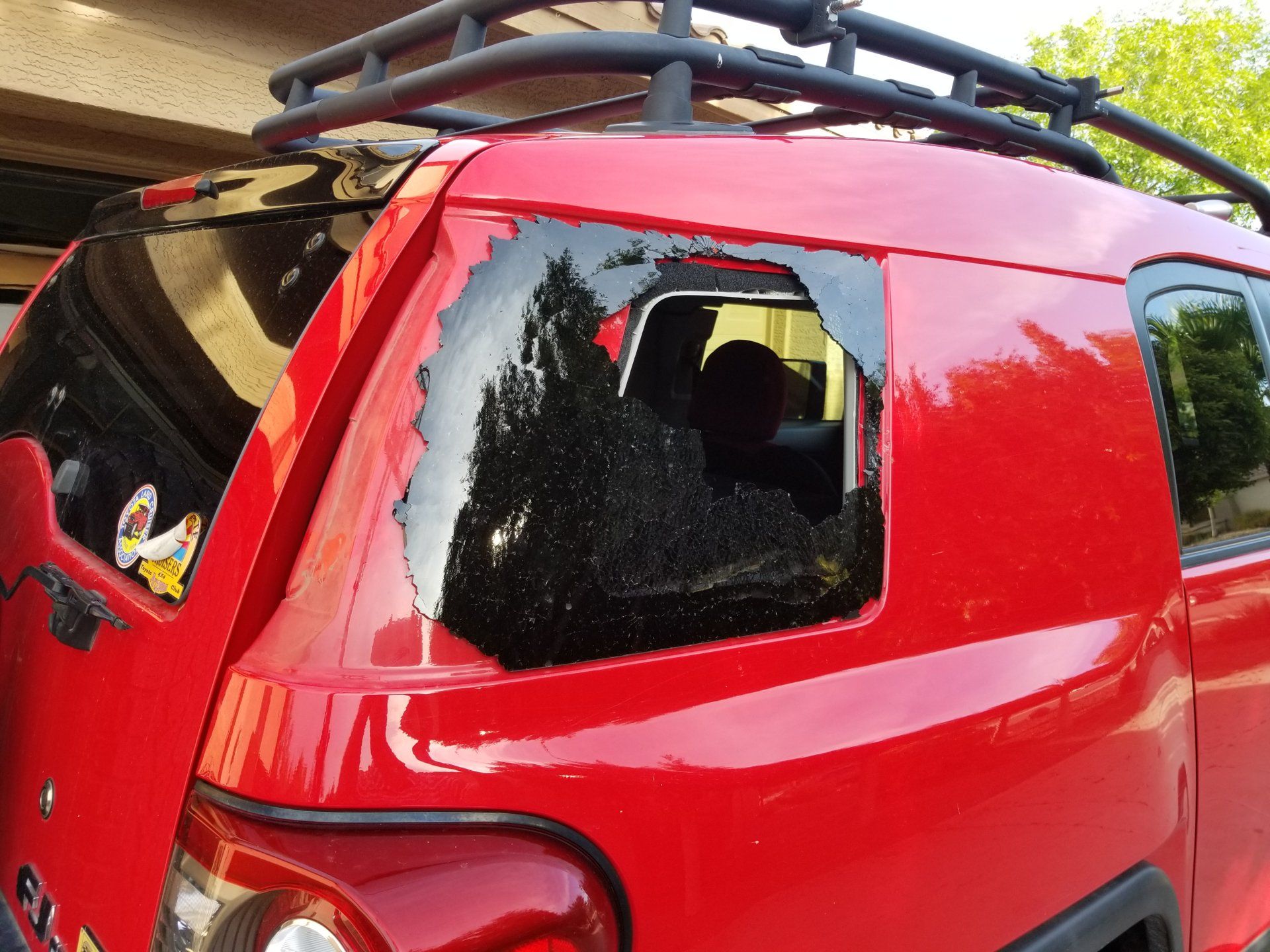

Now might be the time to get some of the flip out back windows for that fj.
With more storms on the way and the fact I park it outside I went with turn around time over a cool mod. Murph came through as usual and sent me to his crew at Lone Cactus Auto Glass. Next day installed, $50 deductible, and was able to wait on it. Can't get much better than that!!! Thanks Eric!

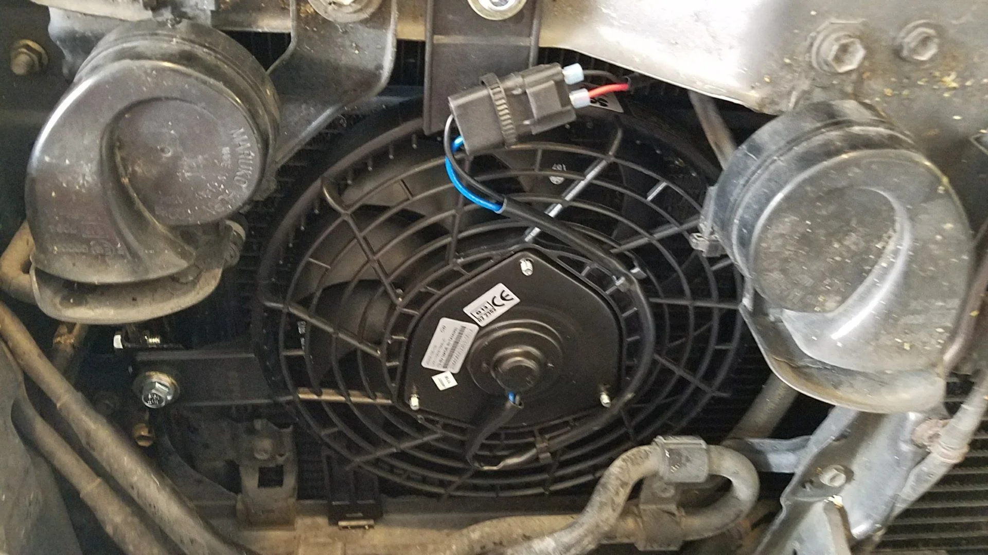

Have to get this on the local forum as well... @LandCruiserPhil aux fan installed. Not that you all don't know what a great dude he is already but...personally delivered and installation help provided.
