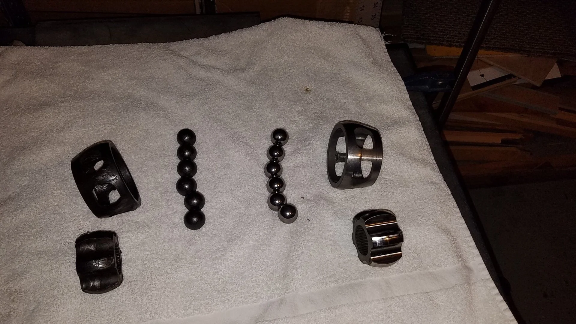

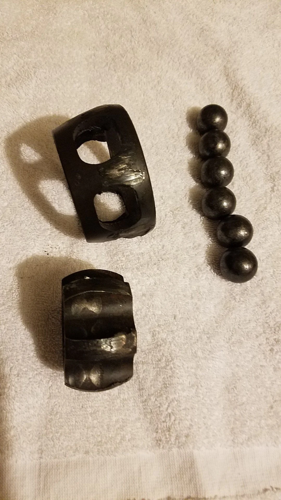

So this happened.
20170704_175506-jpg.1491520
As a result of this
20170705_233857-jpg.1491521
the drivers side inner CV ate itself.
20170705_233910-jpg.1491522
ALL the pertinent geometry: I have 1" diff drop. 4" suspension lift. Tundra conversion that extends track width 1 1/2" per side.
35K miles since lift.
It was an aftermarket boot. The original was torn in shipping. I tend to keep an eye on that one as it was thinner material than OEM, so I'm pretty sure it didn't fail and cause the grease to come out and cause the metallic catastrophe.
Also, there wasn't much grease in the wheel well or suspension components. I think it cooked in the boot. There is a solid layer of Coke built up in the cup.
I told the tow truck driver what a rarity it must be to have a cruiser on a flat bed. He said he never towed on before, but has a 97 he'd like to sell......

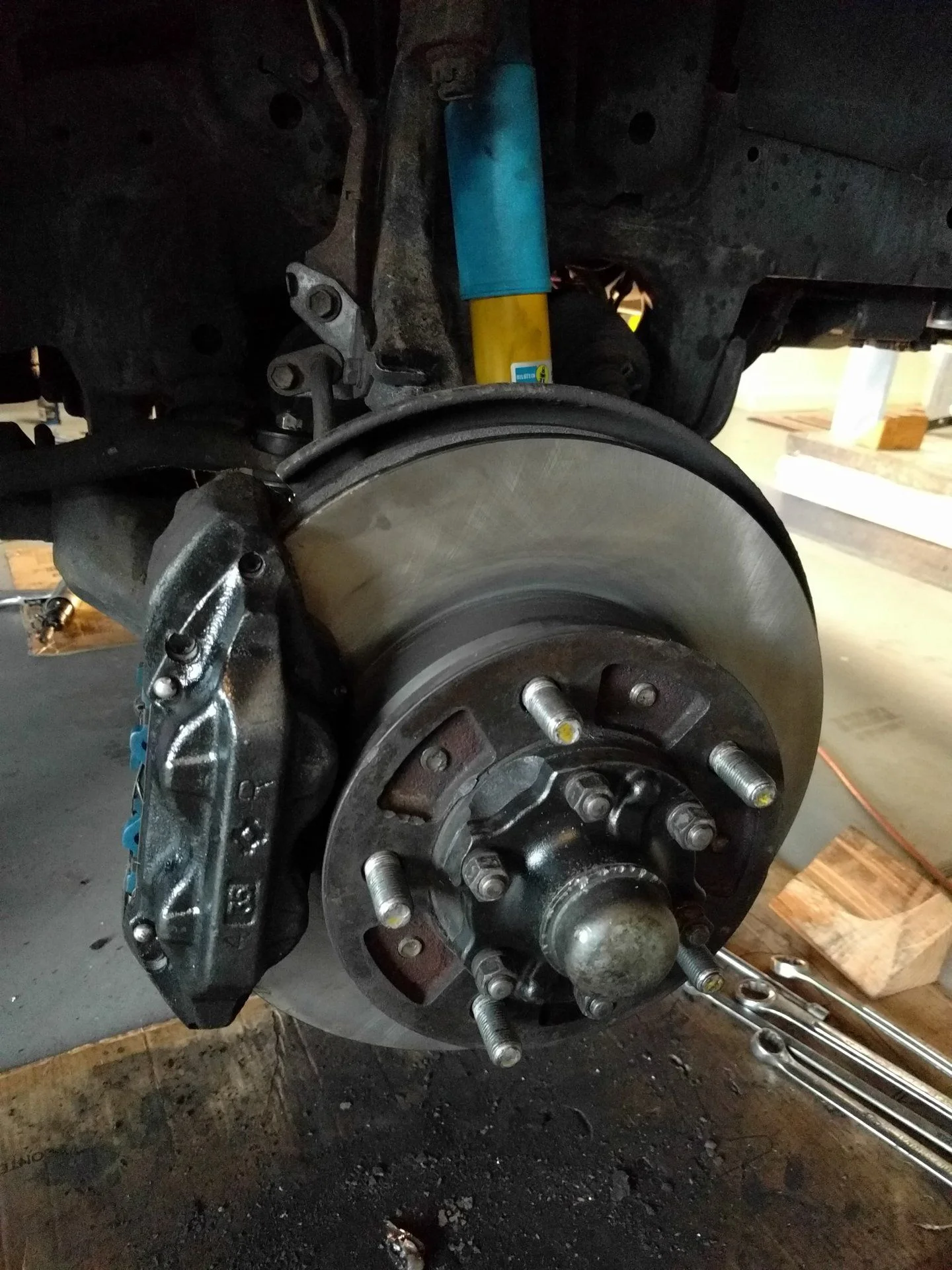

In the last week, @medtro and @Saddletramp both helped me install all new rotors and pads, new Bilstein front shocks, grease spindle bearings, and replace the sway bar links and bushings (one link was broken in half).

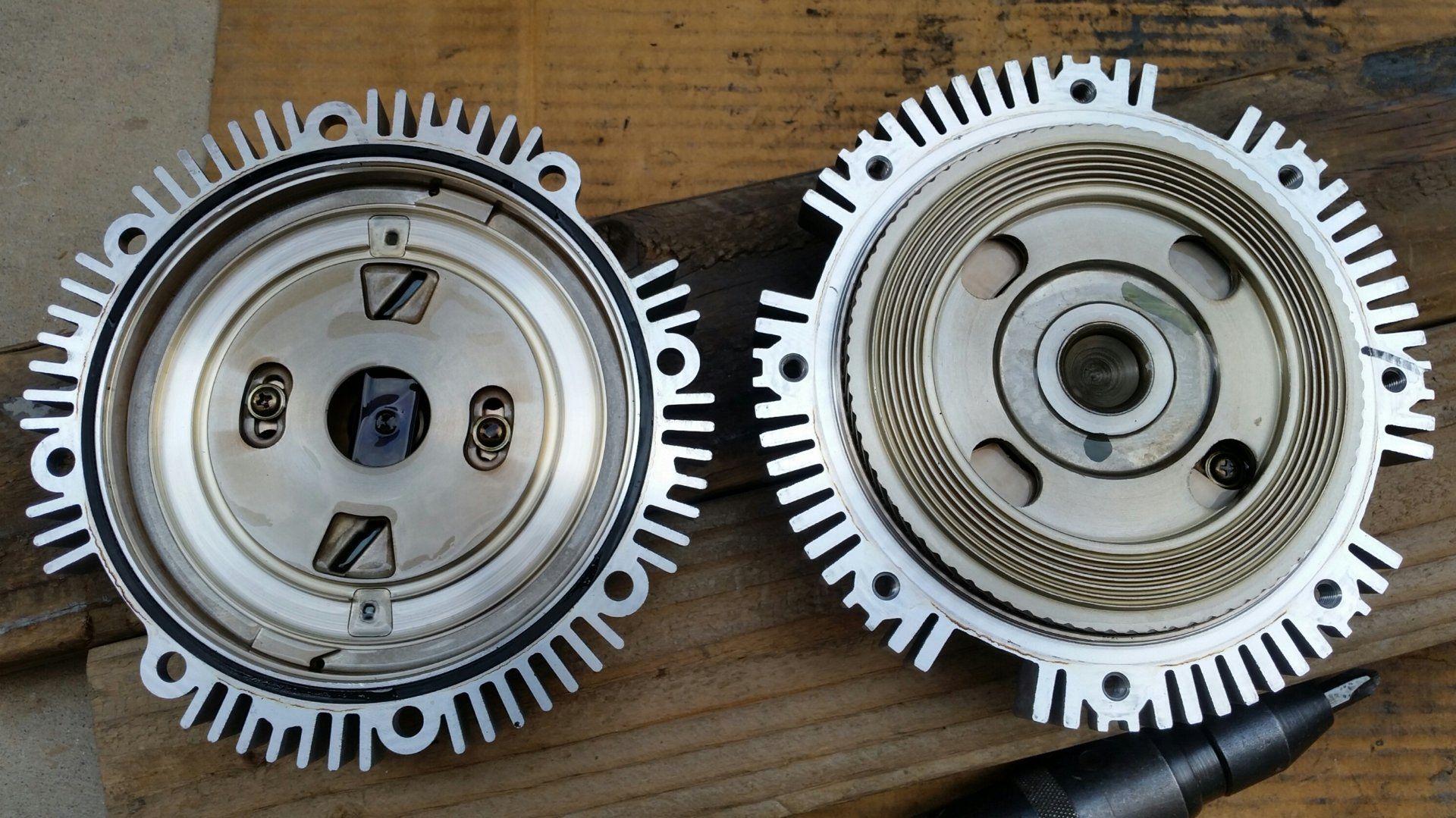

Did you tune it? Tuning and swapping out the 25K oil for 15K oil made a HUGE difference in my A.C.
No, I didn't tune it. What temperature did you tune yours to? Did you use hot water or heat gun for tuning?
How much fluid did you put in? What is your summer coolant temperature?
Tuned it to 95*, tried the oven method but it cools so fast so I stuck it on the garage workbench at 10:30 one night when it was 95*. :cool:
I put in 45ml (using a syringe) of 15K Losi fluid.
Scangauge reports 185-193, about 10* lower than pre-mod. :D
Excellent job on 10* improvement. I like 185-193F. I will need to borrow your garage if I need to tune it down the road :rolleyes:.

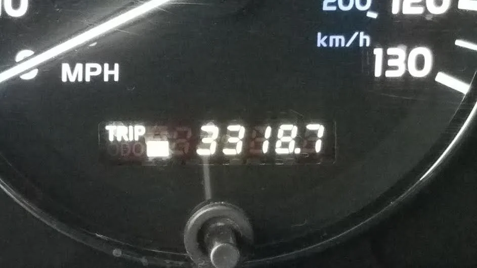

Total mileage round trip...
