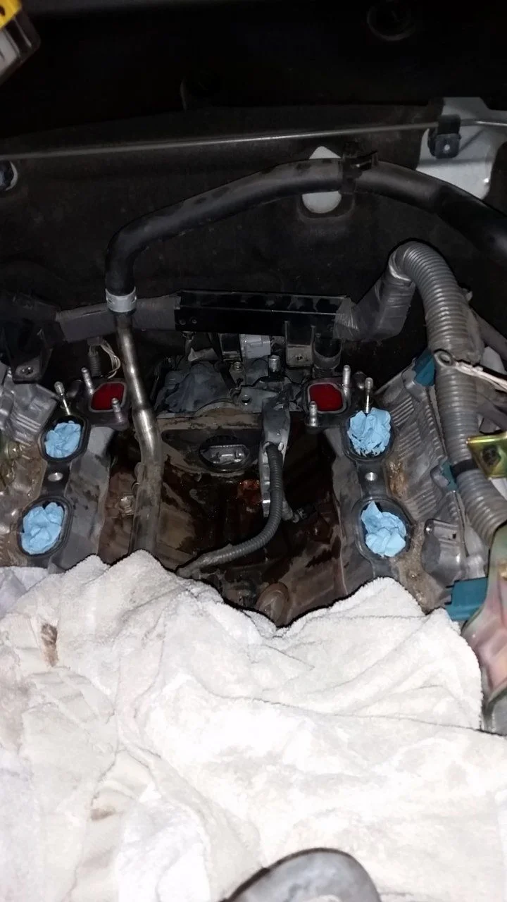

That would be great! I have the HF one that goes to 300ft/lbs, but I'd like to see how it compares to a higher quality torque wrench. I'll be buttoning up over the next several days. I just had the injectors serviced locally and put them back in yesterday. Same day service I broke two injector wire harness connectors, luckily Precision had them. I have a ton of hoses to replace as well as the EGR VSV. I'm replacing the low pressure PS hoses and hopefully that will solve my PS leaks.

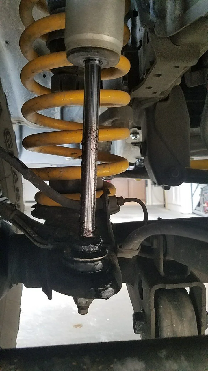

Didn't "do" anything but just discovered this this morning. Fox 2.0 shocks, 22k miles on them. Bummer. Not sure if I should rebuild or try a new setup. Anyone local rebuild these?
We had a set rebuilt by SDHQ in Gilbert several months back and they did a good job for us.
Ahh yes, I know of them. Didn't know they did that however. I will give them a shout. Thanks much for the info Eric.

Replaced the EGR VSV and all the hoses under the upper manifold.
Replaced all heater hoses and the mixer.
Replaced the valve cover gasket and resealed the leaky half moons
Had the injectors cleaned locally
Replaced the leaking crankshaft seal and oil pump gasket
Replaced the leaking o-ring for the distributor. A little oil in there, I cleaned and will monitor.
New spark plugs, wires, rotor and cap.
Replaced the leaking low pressure power steering hoses. I'm not sure this will be enough.
Rehabbed my blue fan clutch with ~17.5K oil.
Changed the oil.
I'll check the timing tomorrow and hopefully it will pass smog test tomorrow and then be ready for Prescott on Monday. It has taken me a month of puttering to get this done and a big shout out to Rudster and GBinAZ! Oil pressure looks good.

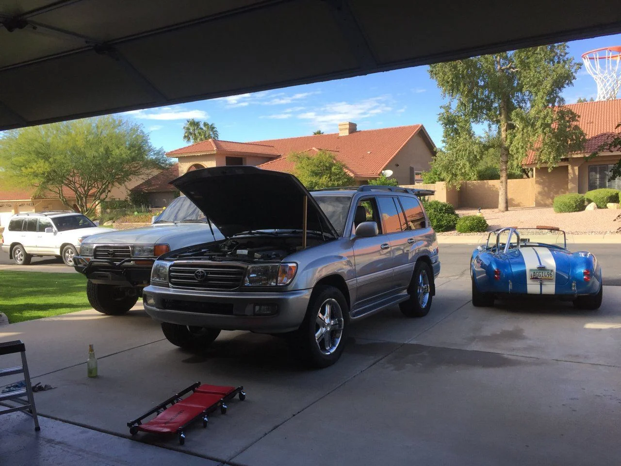

Have been busy in the garage for most of the week, Landcruiser maintenance and got the blue car out of mothballs after a 4 year rest. Many thanks to @LandCruiserPhil for the use of his electric pump, which I kept in my garage for almost 6 months before using it. I appreciate you patience. Jackson was on hand multiple days to lend a hand as he worked on his newest 100, baselining. Without Jackson, I might still be poking along on the oil change for the 80.

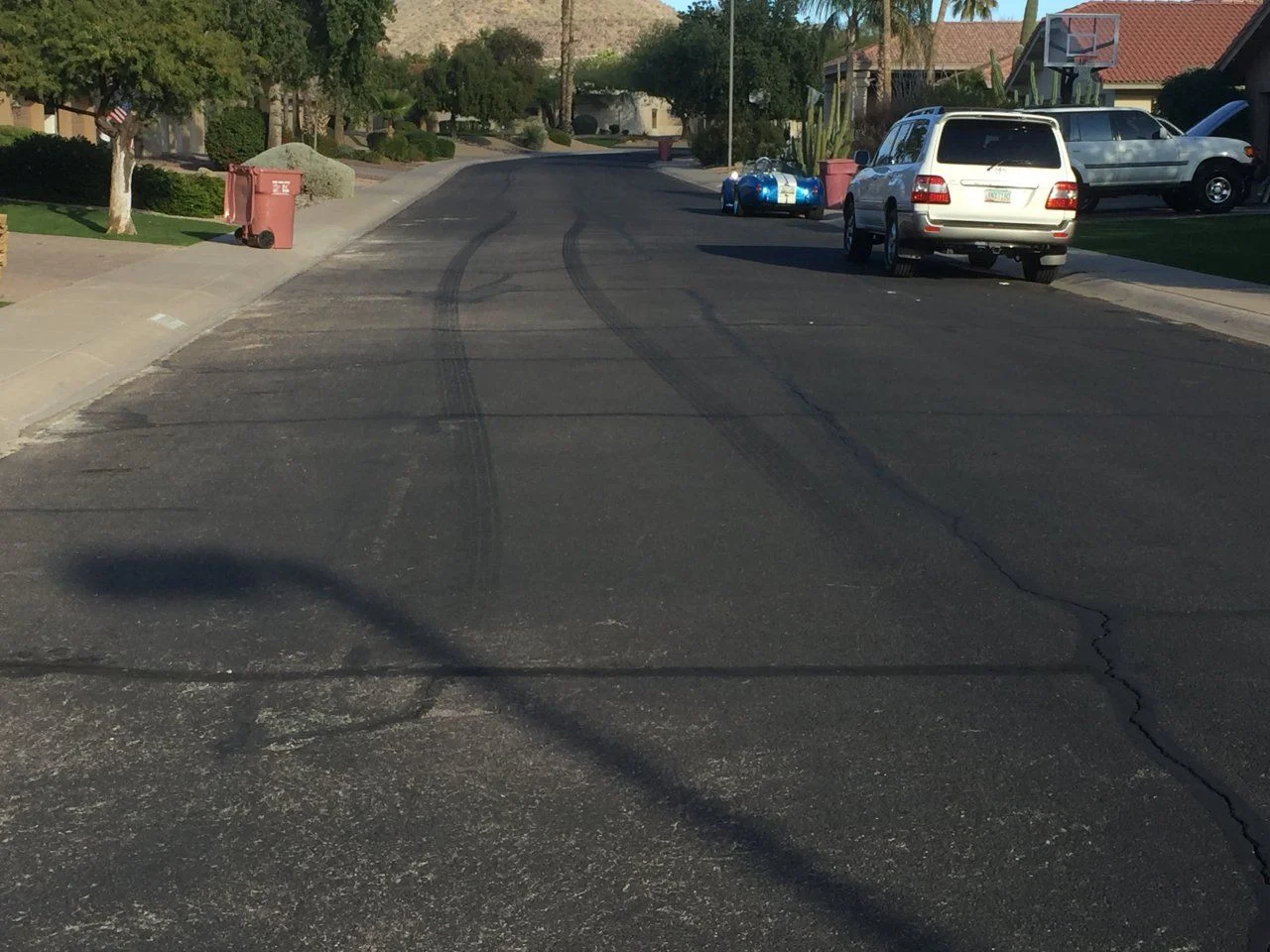

Tested the locker on the blue ride, the 315-35-17's went about 175 feet before my foot came off the gas. Locker works well. Tires will need to be replaced next.
@brices123 , we need to go for a ride.

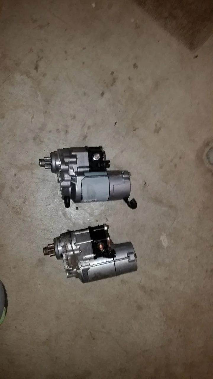

Had to do Nanas starter in the gx after doing the TB, WP, and associated goodies. I have to say I was proud of myself. Only 4 hrs from start to finish on the 4.7 starter replacement. It's at 177k miles so it's still just getting broken in.
