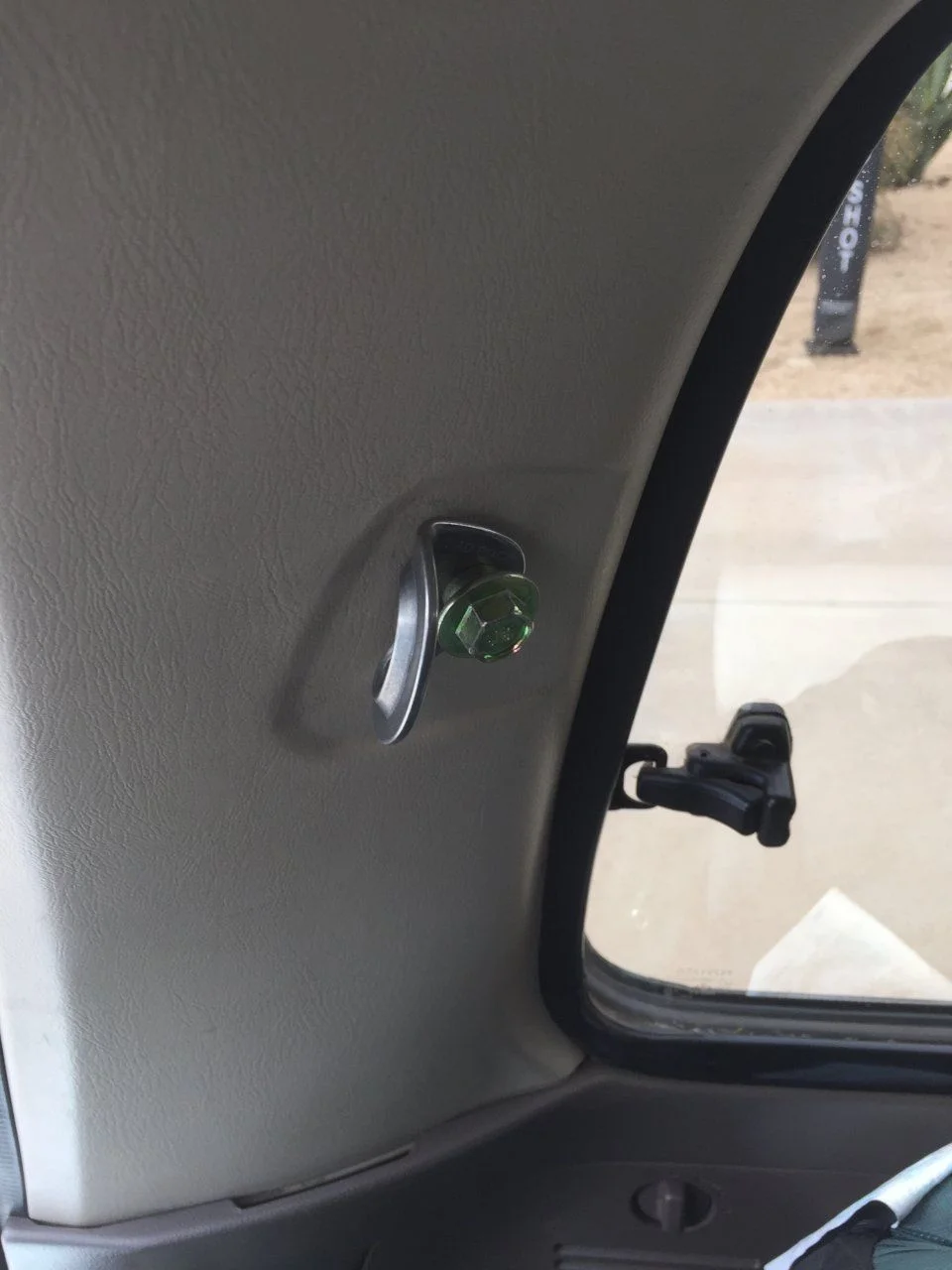

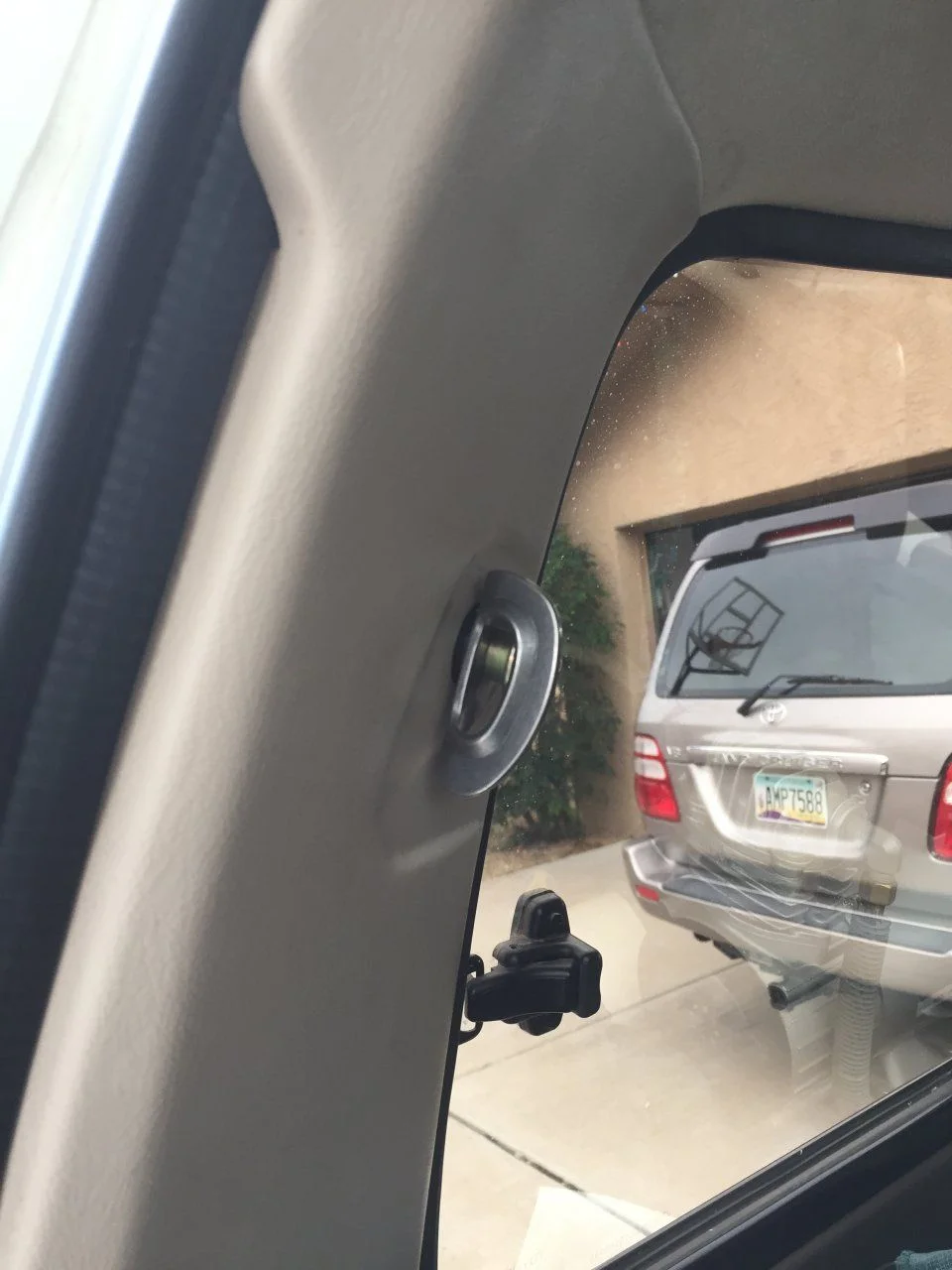

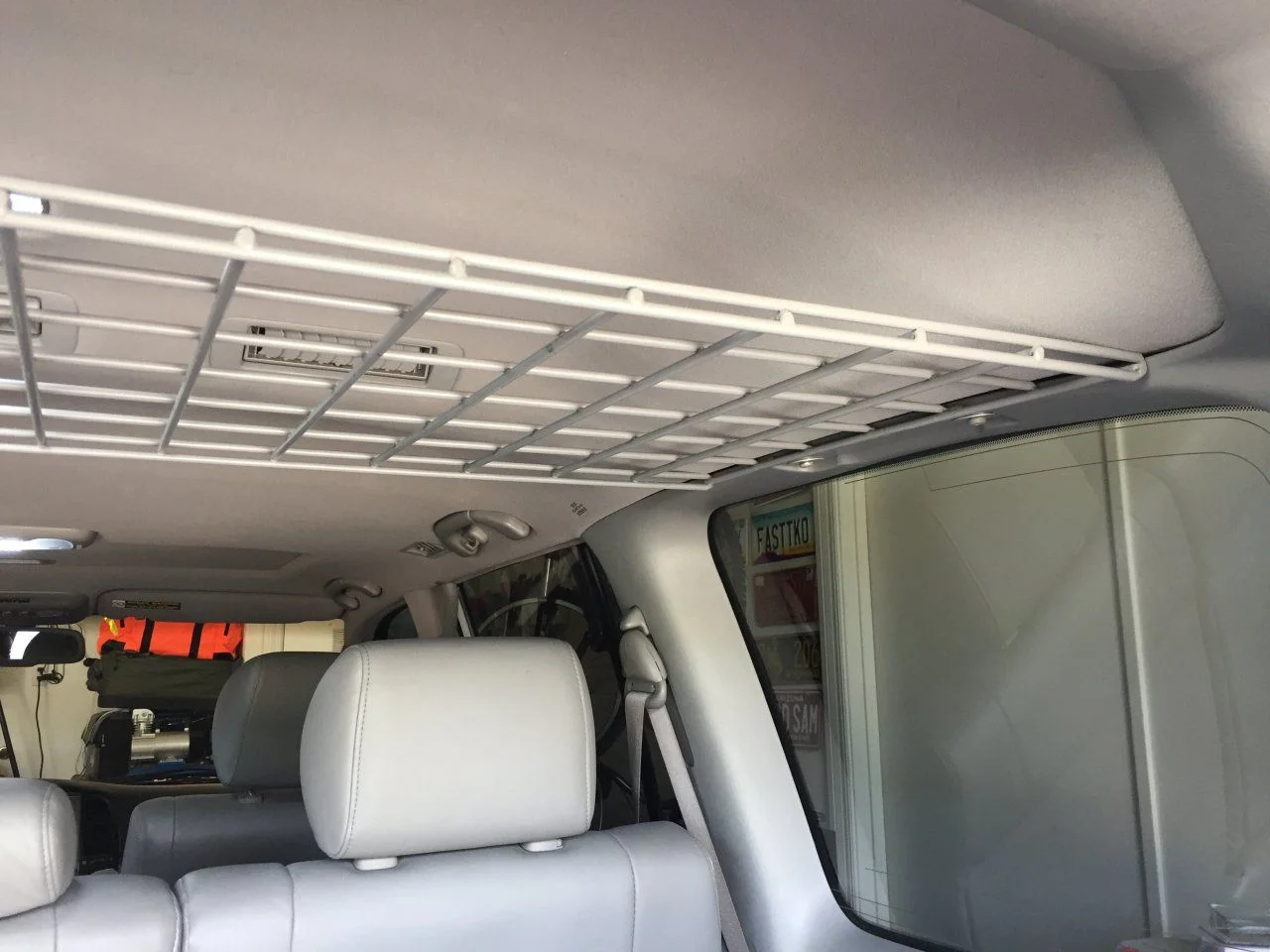

Added the @Pitch mod, handy place for these very strong anchor points. Thanks Eric for the hammock rated product, tested and proven.View attachment 1375911View attachment 1375912
I found a seat belt bolt with eye loop at Loper's Performance, it's the standard seat belt thread of 7/16-20 and has a 1/2" eye loop large enough to take a full size carabiner. Replaced all my upper and lower seatbelt mounts, great tie down and hammock anchor points! Found the long one I used on Summit Racing: G-FORCE Seat Belt Eye Bolts 109L. Amazon carries them too in 4x and 6x packs a bit shorter. Floor bolts are waaay too long but the wall bolts work great in that length.

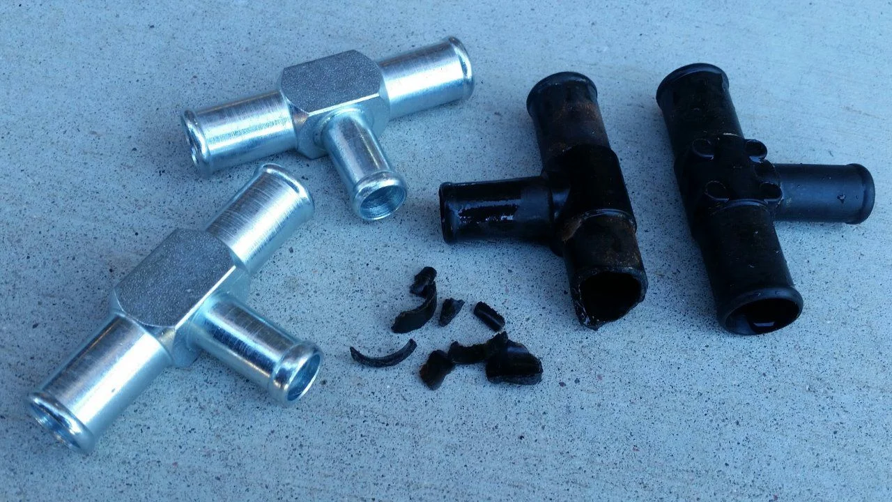

Well the PHH heater T's busted on me :bang: Luckily it happened in my work's parking garage and not on the trail! Rivers of coolant flowing out of the truck wasn't a great start to my Wednesday, to say the least. Murf's guys had me back on the road the very next day! Thanks @murf!

Are you sure it wasnt the heater T's that broke? I only ask because the 100 series does not have a PHH.;)
LOL you're right, that's what my bill says. I thought I had been told heater hose. :p I don't claim to be an expert (yet)
the darn heater T's let go - thankfully in town and not out in the boonies... By the way - those bumpers look even better in person!
