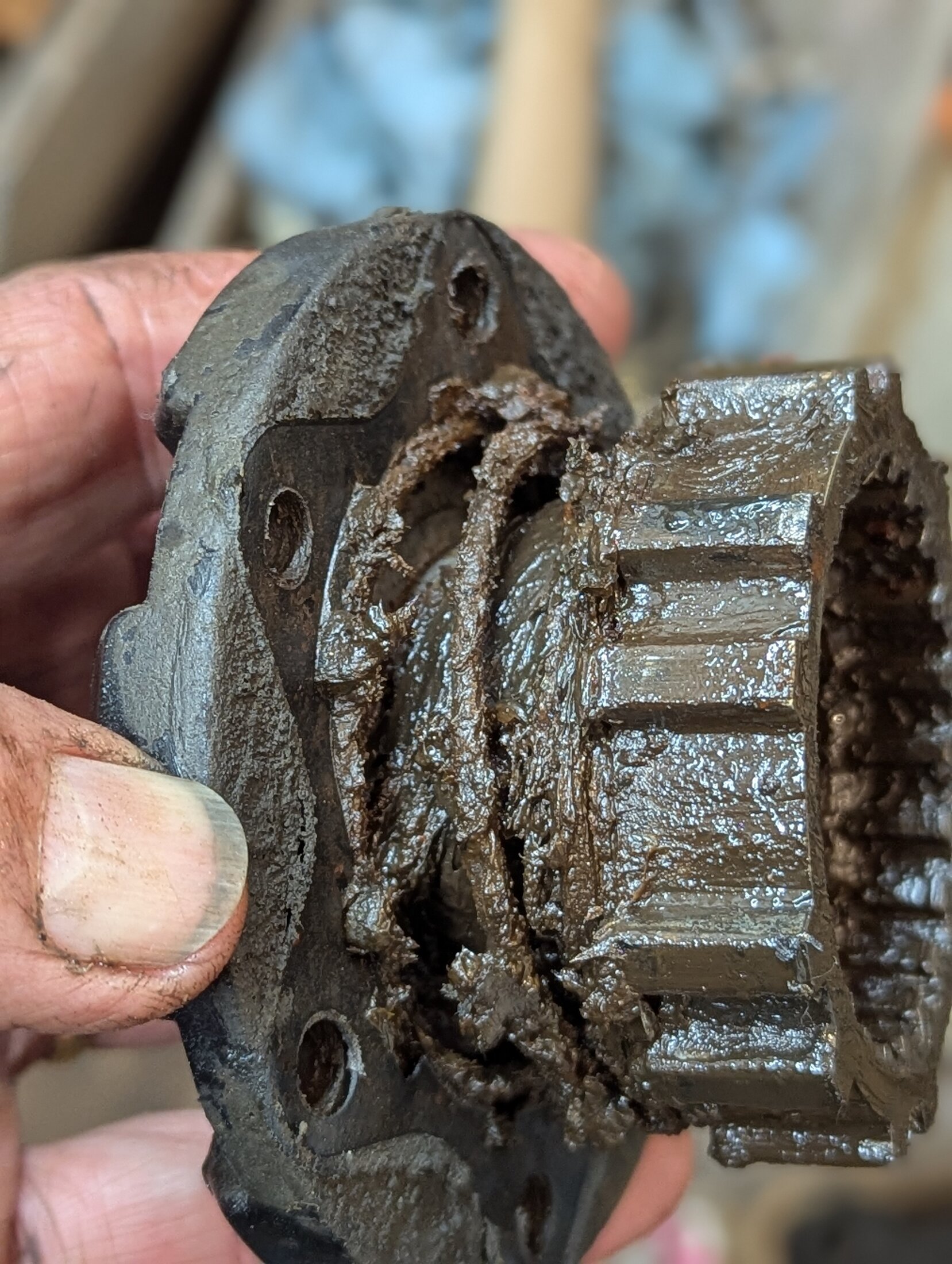

what the hell is with that abortion... looks deliberate too, none of them overlap so it wasnt debis getting slammed up into the head by the piston
just....why
:confused:

Perhaps your engine ran for too long using tap water instead of coolant.
Juan

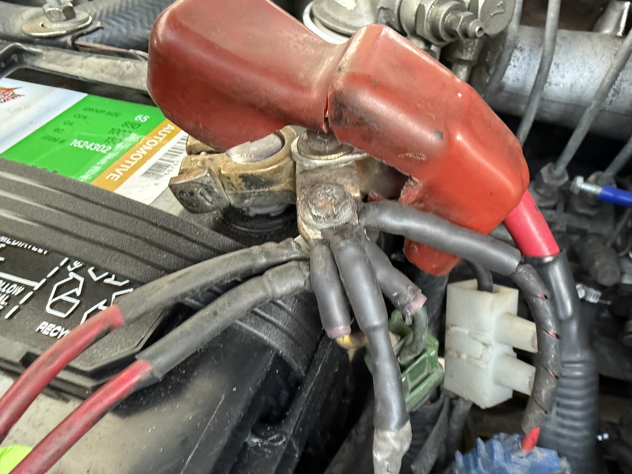

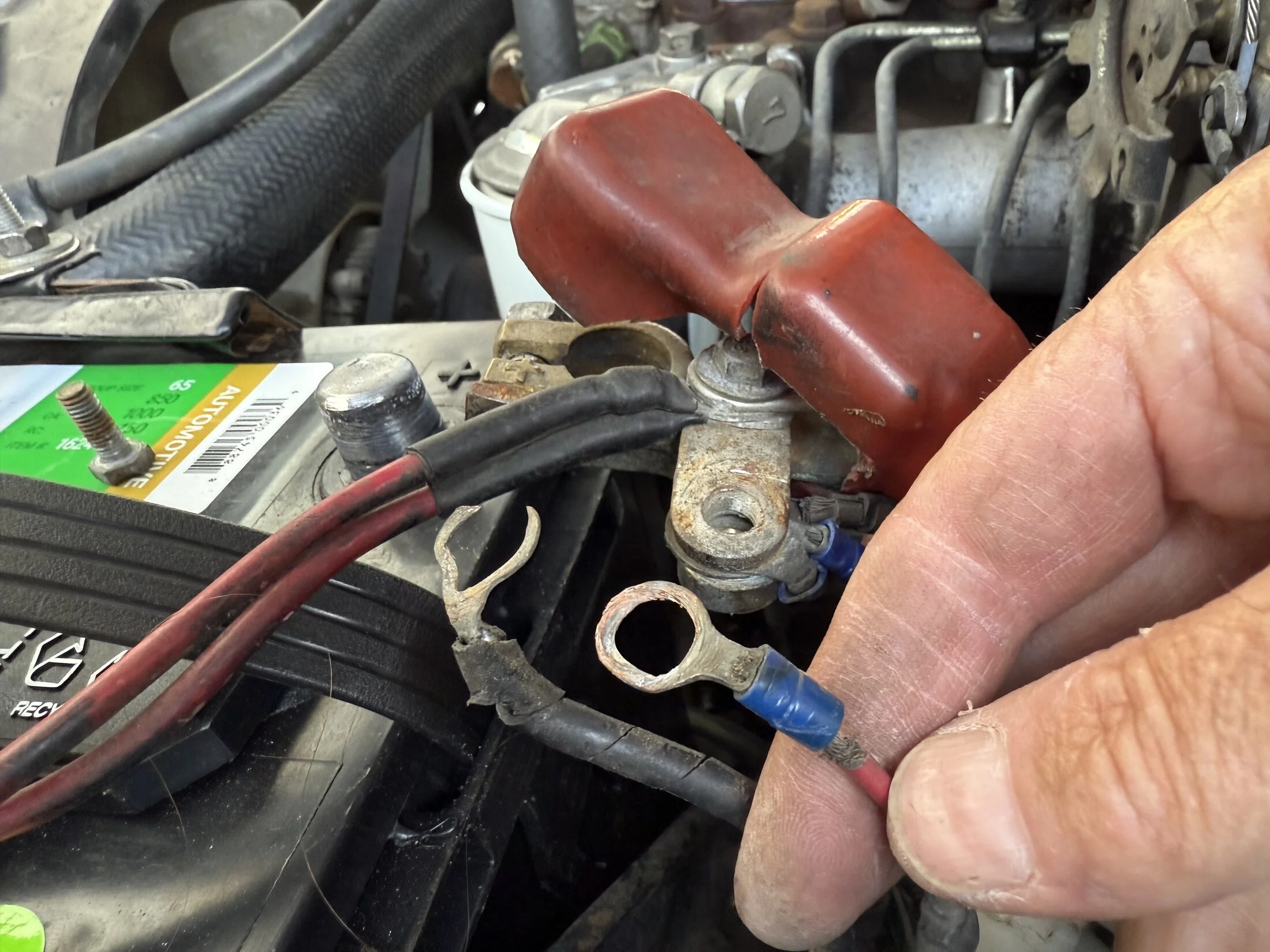

New Batteries and cleans up some battery connectors. Then went for a drive. Nice sunset today.

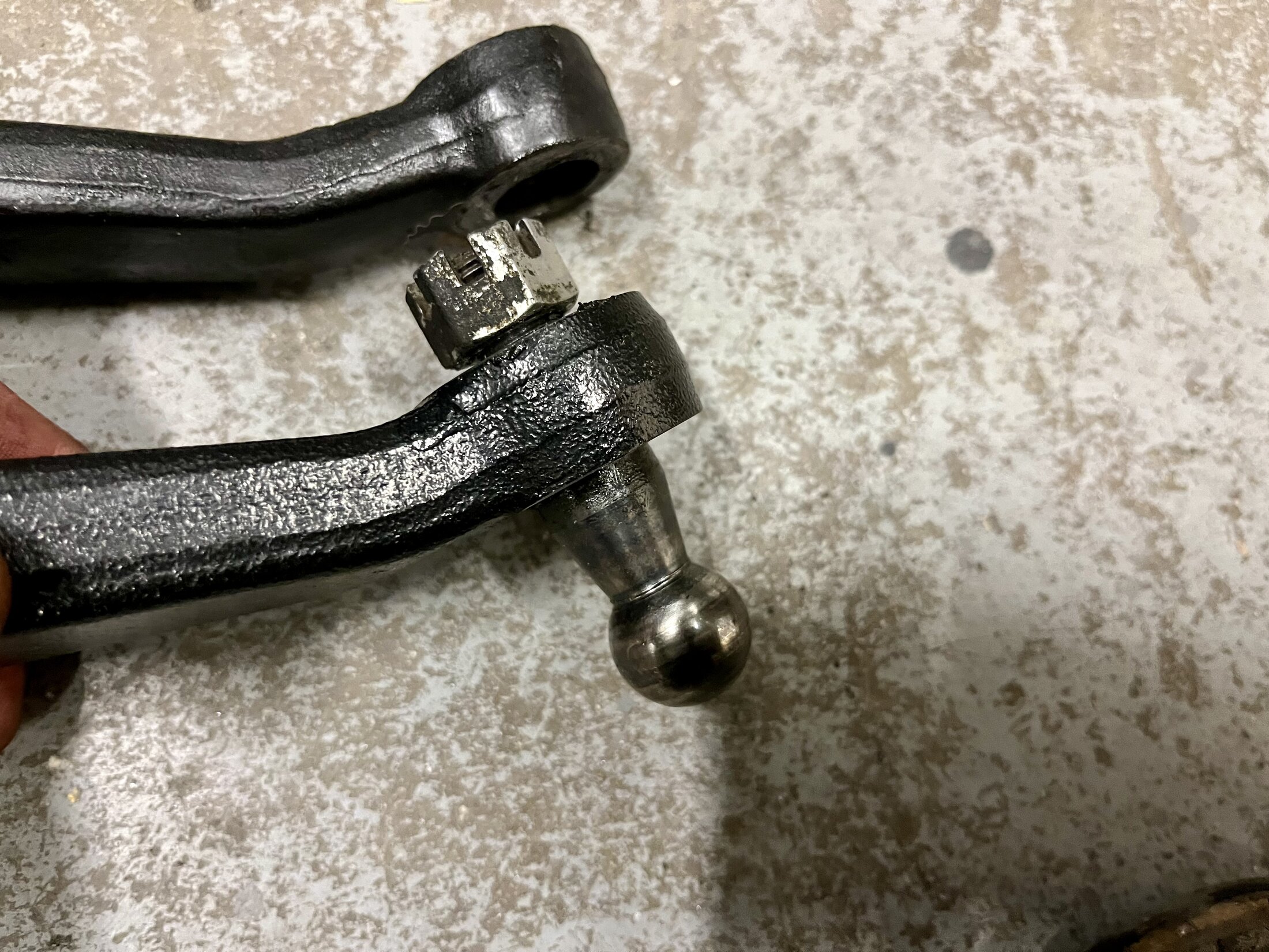

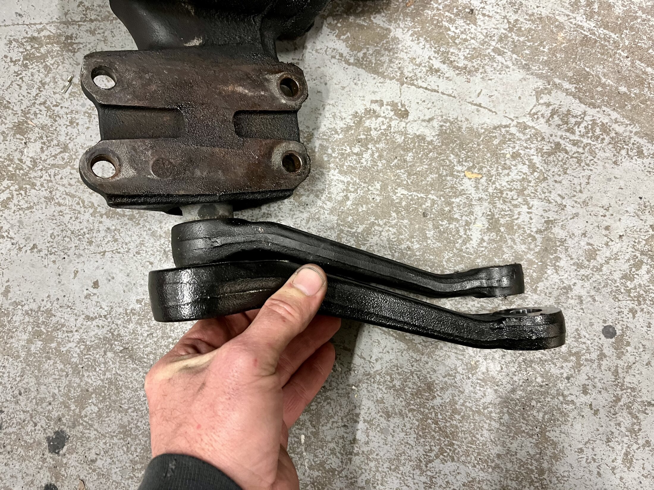

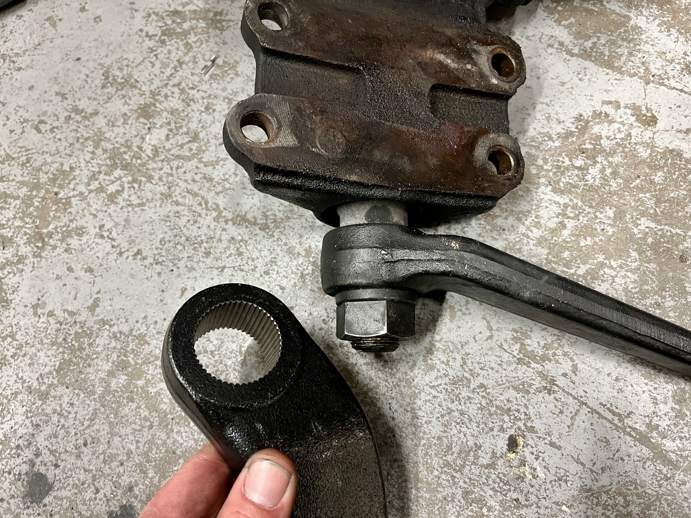

There are two pitman arms available for the 79 box, you want the drop pitman arm. It matches the older style perfectly.
I don’t think the 79 uses the old style of tie rod drag link ends but the pin/ball for the pitman arm fits the new 79 pitman arm perfectly.
Massive increase in sector shaft size, beefy compared to stock.

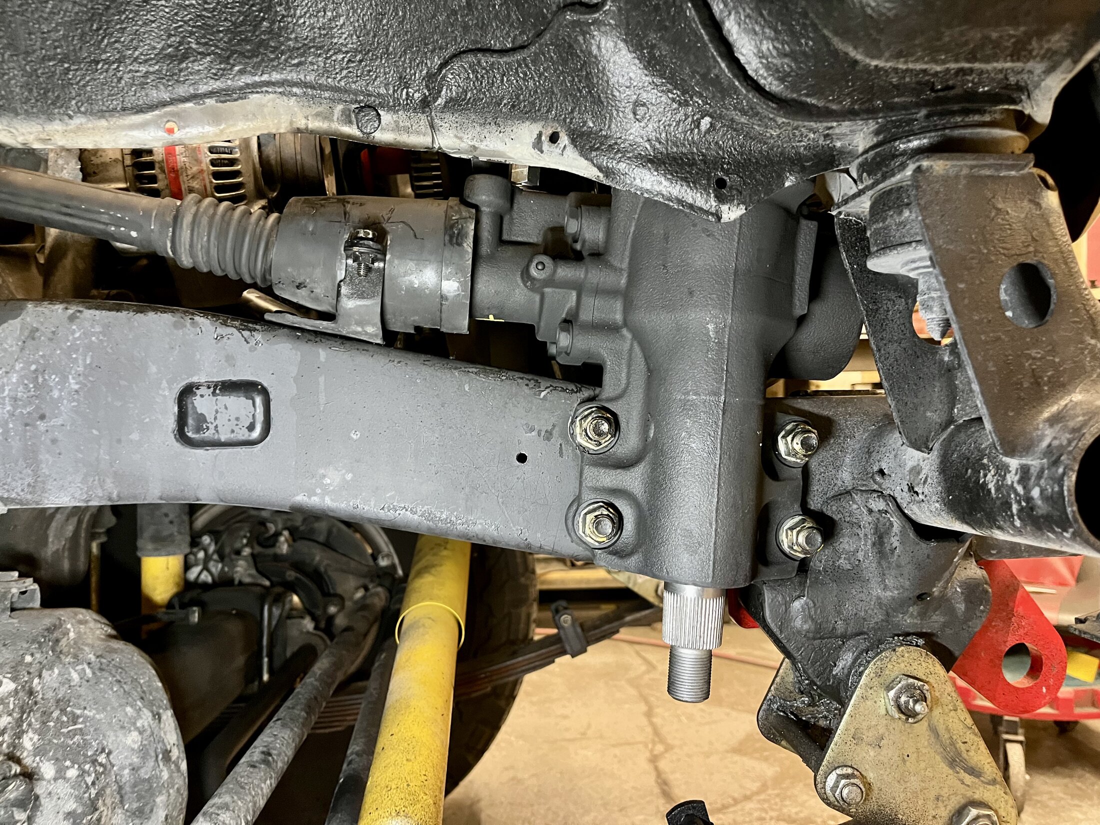

79 box mounted.
Cheers

79 box mounted.
just....why
:confused:
It definitely looks like it was done with a drift/punch or a drill bit.
Hello,
Juan
Juan, it’s definitely not pitting. I can’t wait to hear what the machine shop says tomorrow. (:

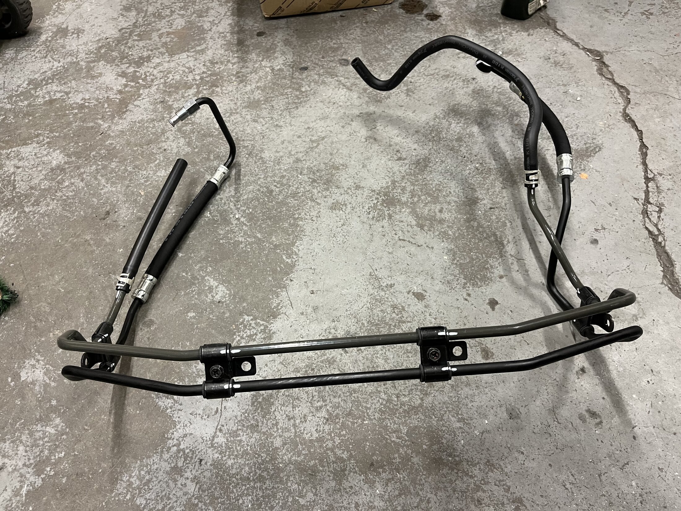

Here is some more info for you 70-series guys.
I am doing a full steering system rebuild on an early 90’s JDM 77-series. The owner is taking the Cruiser this winter to Central America and we had originally planned to simply rebuild his stock box, the high/low pressure lines and replace the pump with a new unit. That was before he told me he was taking it to CA. We have used RedHead a fair amount for steering box rebuilds, however we have had a few fail. I am not wanting to get into those details in this post, rather just state that a new OEM box simply cannot be beat and the older style 70-series boxes don’t seem to be available to me anymore after extensive searching.
Once the owner told me he was going to CA in the 77, I felt only a new box will do! I have done that trip multiple times and zero vehicle issues makes it most enjoyable.
I have a 2018 GR79 box here and a 1991 PZJ70 box as well. I took both out some time ago and verified mounting hole spread was the same. I hadn’t checked anything else other than comparing sector shafts. I knew we could do this swap I just didn’t know if we would need to modify the lower column shaft or something else.
Anyways, here is a tip for any of you with a RHD and changing out your high/low pressure line assembly. Separate the two lines in this picture for both removal and install, it makes it 100x easier! Trying to fish it in/out without doing this will give you much grief, it’s easy cheesy if you separate them. LHD is a bit different in that it is the standard Toyota “paper clip” “cooler” and not separable like RHD.
So there you go guys, you can do basically the same swap 80-series guys are doing to their steering boxes. IE, upgrading to a newer model that is still available, gaining the benefits Toyota did to the boxes and it is bolt in job.
ALL parts are still available from p/s pump to high/low pressure lines to the upgraded box and pitman arm. You can even still get everything to rebuild the upper and lower column and let me tell you, rebuilding all these parts give excellent results that you can actually feel the difference every time you drive it. Not to mention you will be good to go for the next 20-30yrs!

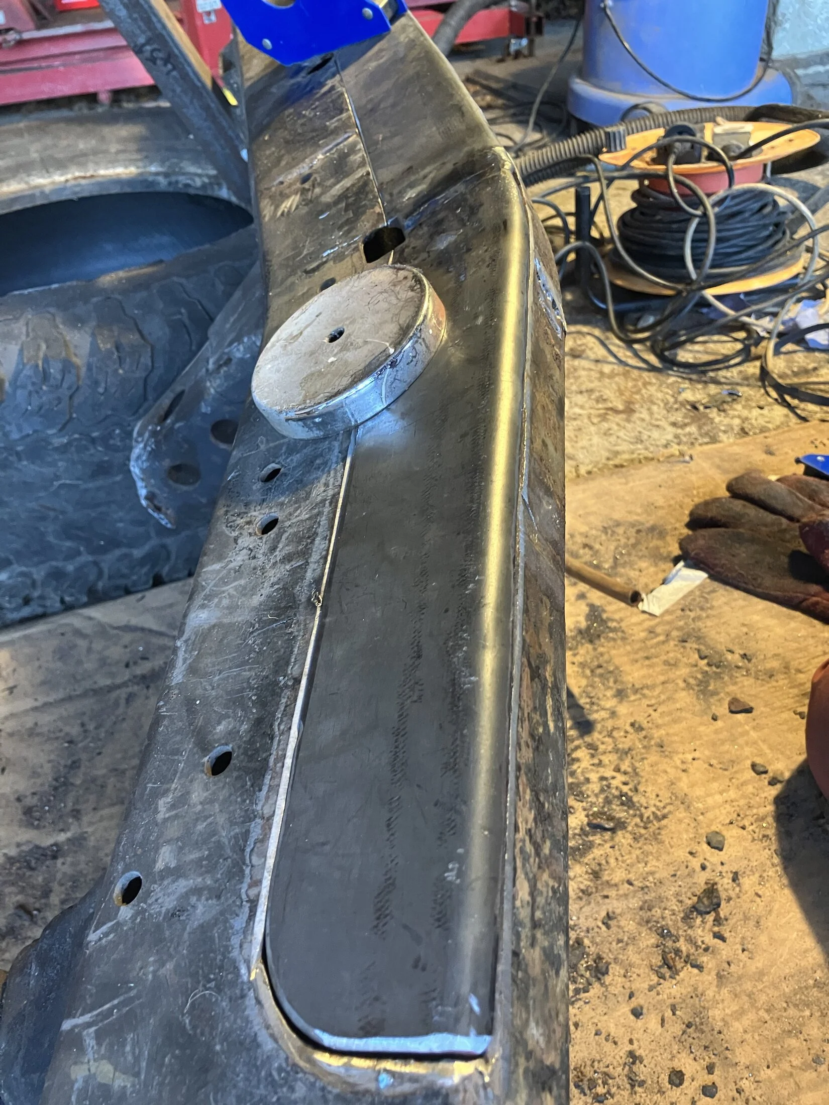

Renew steering UJ and make up chassis plate to fill the “hole”…….oh and vacuuming the inner chassis of rust and mud.
I’m not sure at what point the chassis needs new plates, but in view that the original metal is 3.5mm thick I’m thinking if it’s less than 2 mm it gets cut out. Thankfully there is only one more dodgy area to do.
New plate steel is 4 mm.

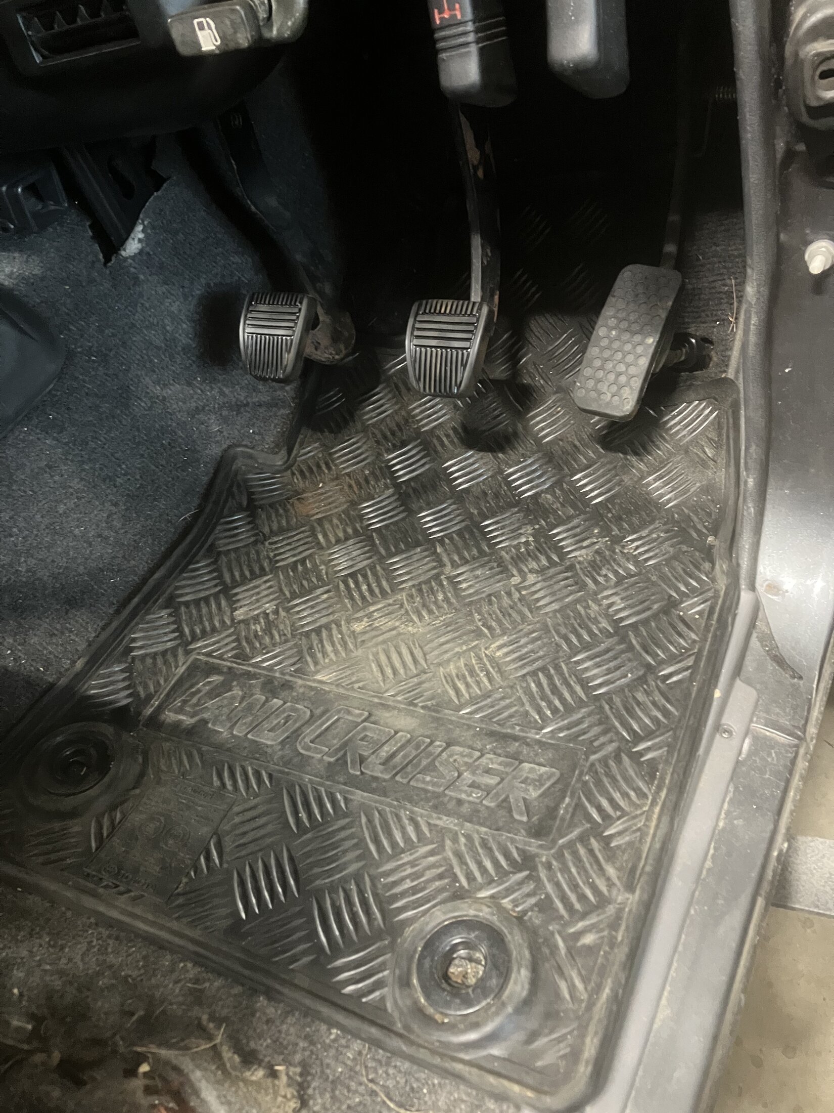

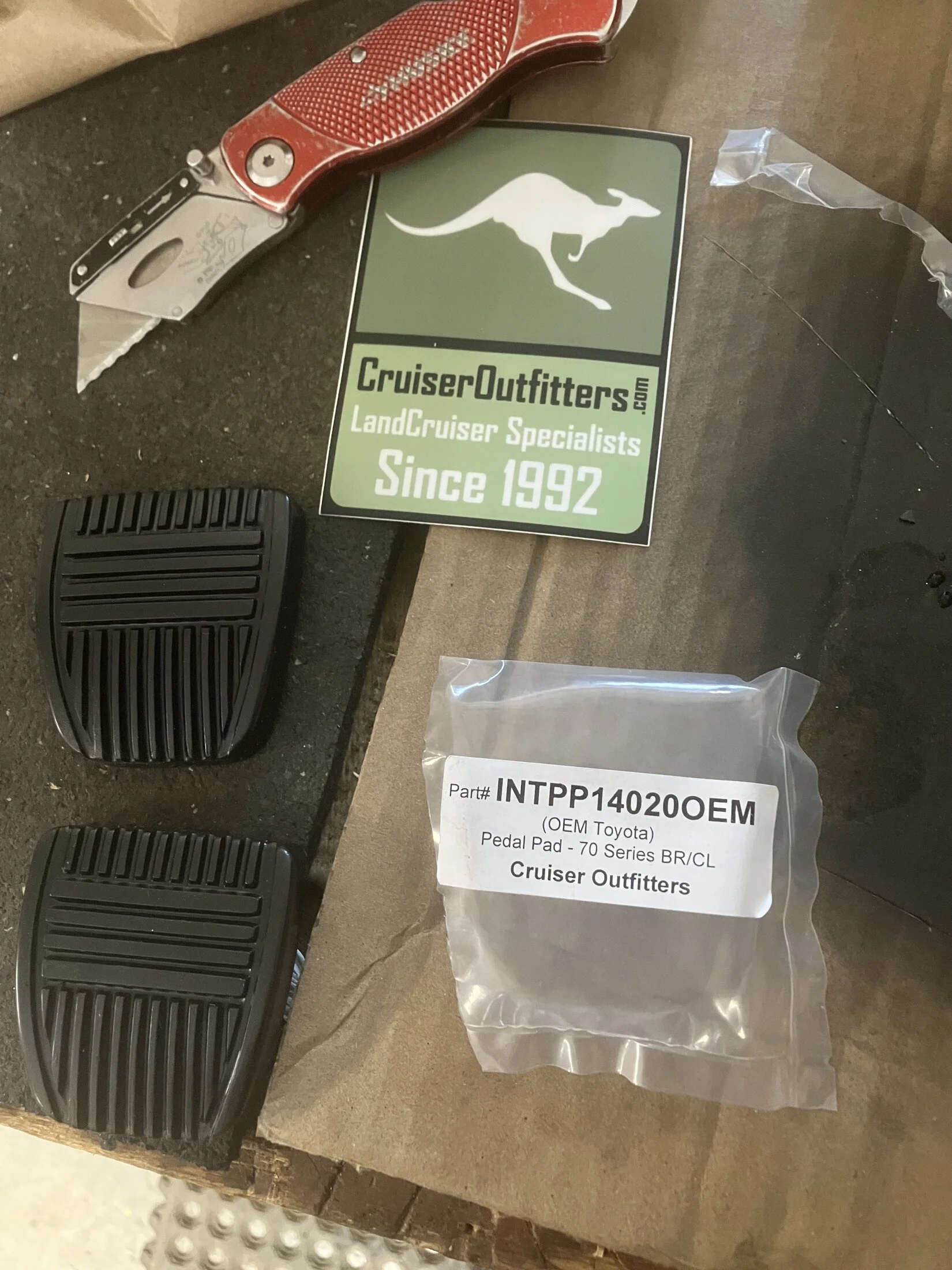

Rolled up my sleeves and tackled the clutch and brakes at the same time! :)flipoff2:)
If you stick your nose down in the footwell and close your eyes it smells like new tires day (but its WAY cheaper)

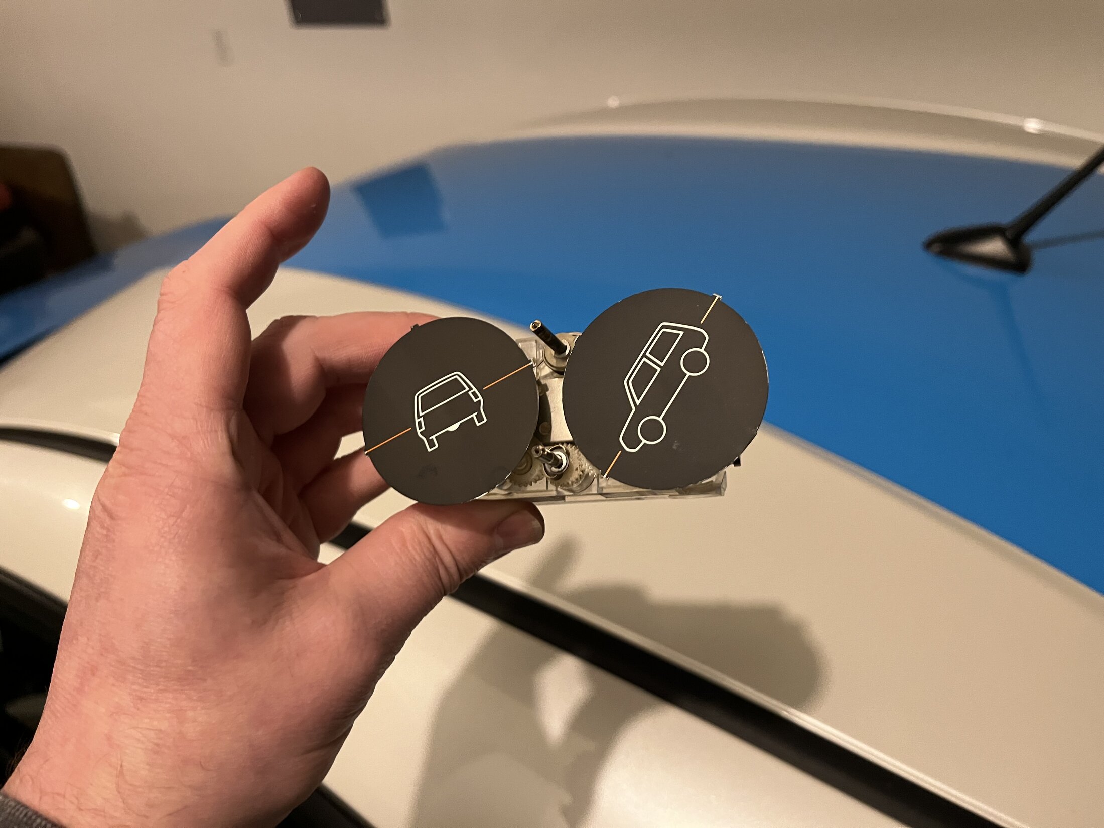

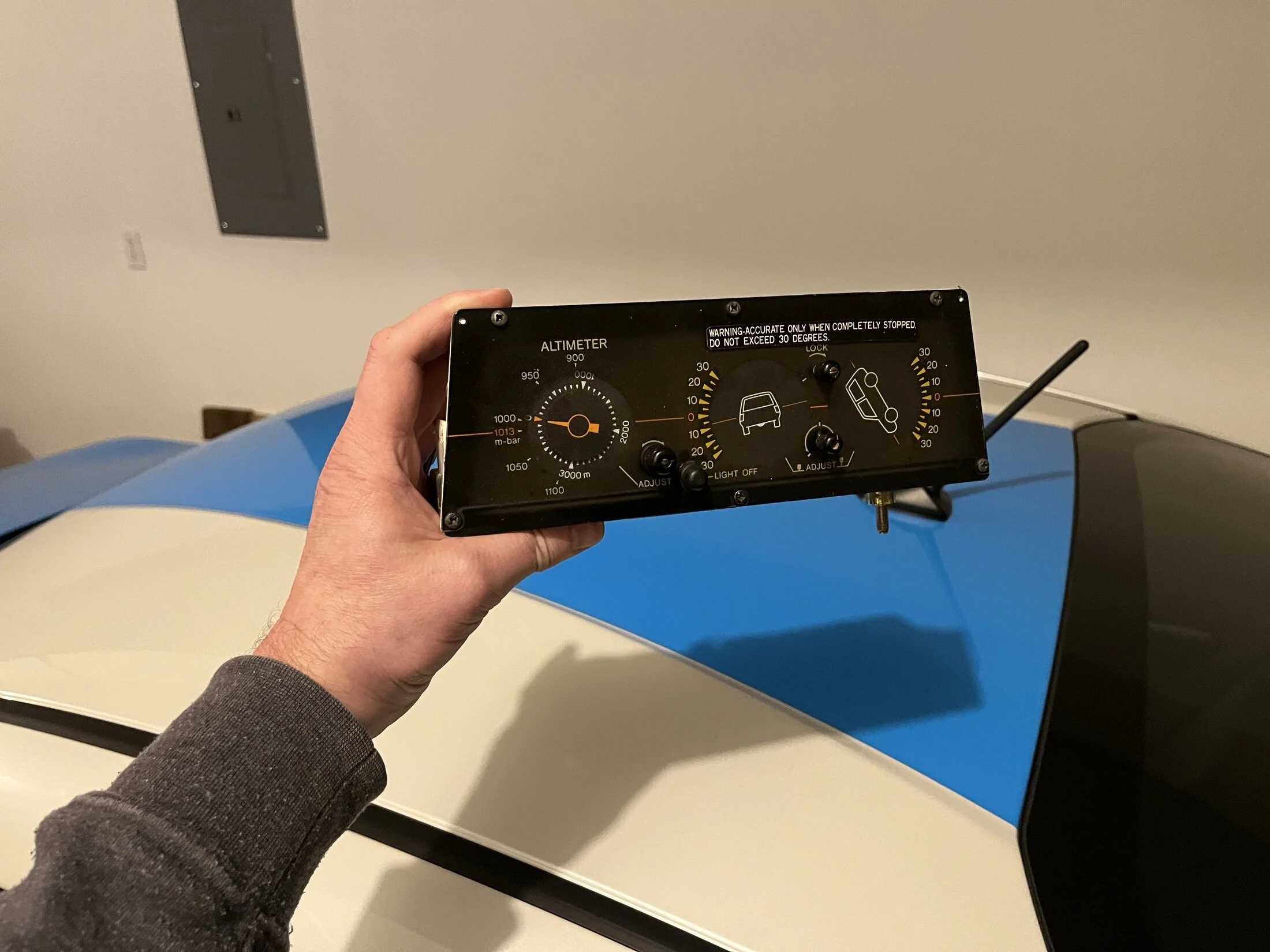

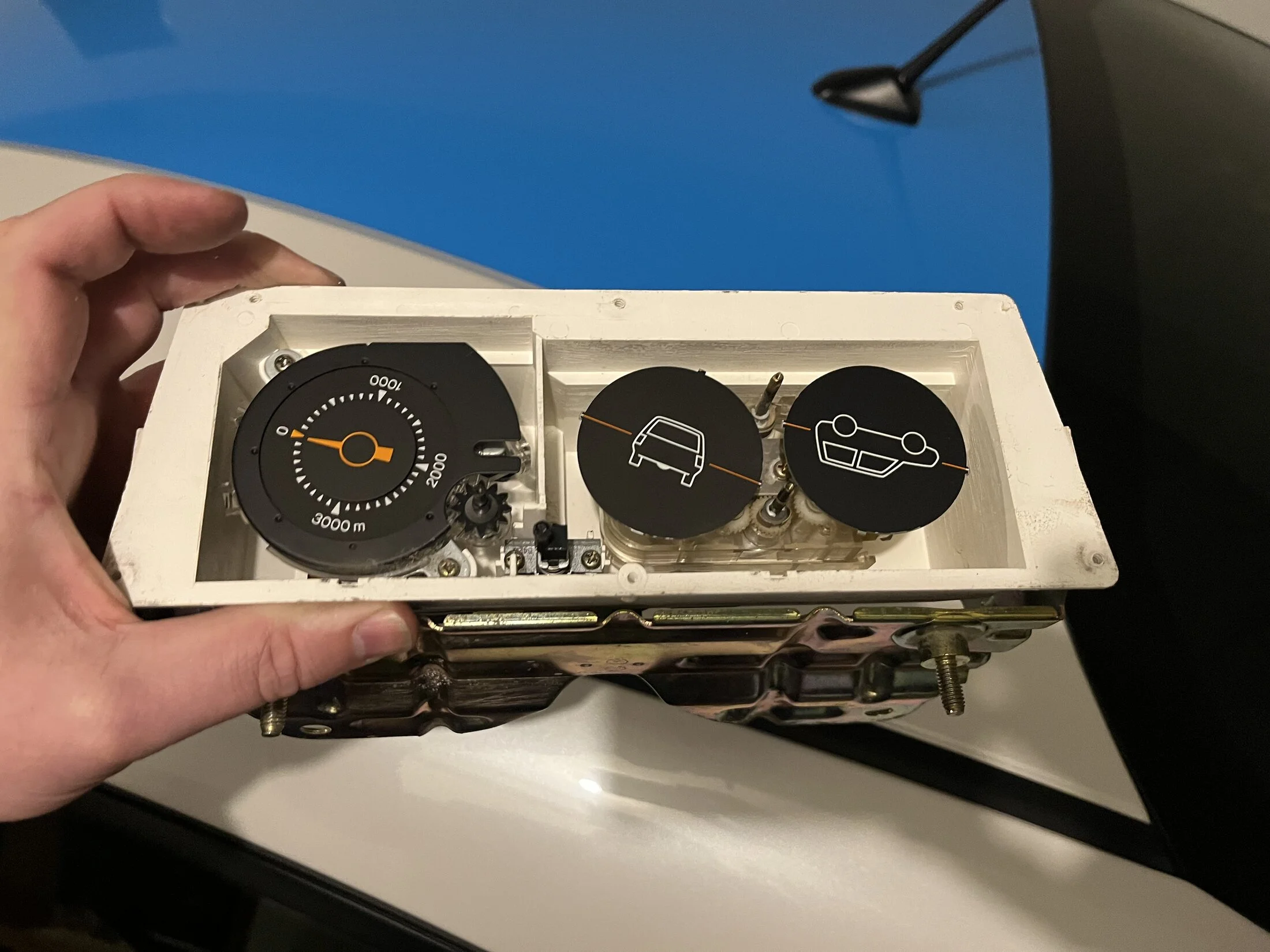

My truck was a really basic version, so it didn’t have much from the factory, but I scored an altimeter/incinometer off eBay, and it recently arrived slightly out of whack, which I kind of expected to be honest.

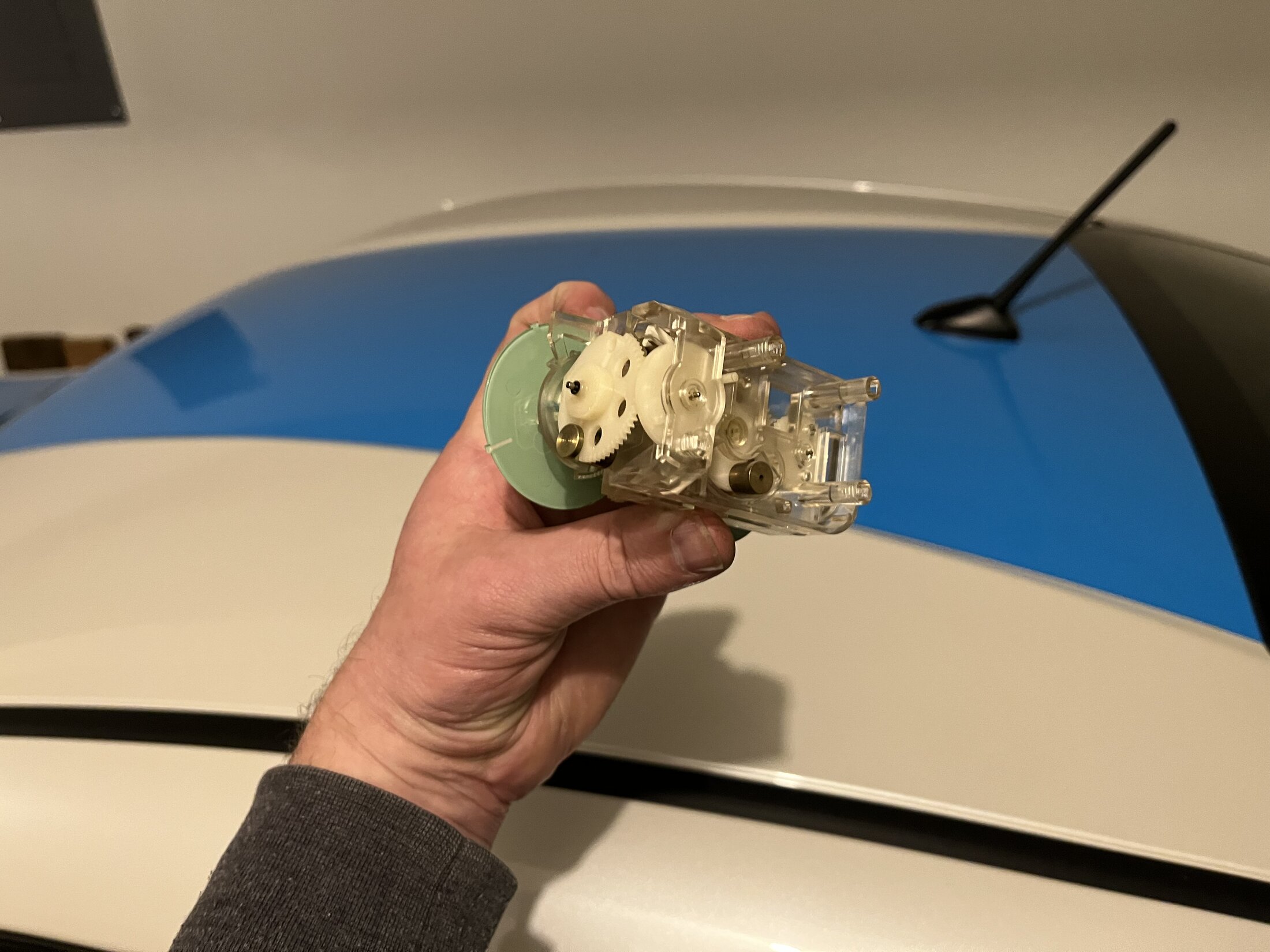

A little bit like working on a watch! Gears, clock springs, weights, and little machine screws.
It has adjusters on the face, but they have a limited range, and even with the adjuster maxed, the longitudinal one was obviously not right. When moving it manually against the built in weight, it would snap all the way to the stop really quickly at one end of the adjustment range, and snap all the way to the same stop slightly-less quickly at the other end of the range of adjustment. Meanwhile the indicator on the face was upside down. 😂
The longitudinal indicator was one full turn out of adjustment on the clock spring. I have no idea how it got that way unless someone was in there before. There's a stop I just cannot fathom the wheel slipping past. I partially disassembled it, moved it past the stop, and got it back together. The stop was a long clear plastic arm that looked potentially brittle but I flexed it gently with breath held, and 40-year-old plastic was kind to me and didn't break. One of the knobs was missing hardware; it was glued on, thankfully not very well so I got it off easily…off to McMaster-Carr to shop M1.6x0.3 machine screws! I’m not sure how well I will fare at getting the cigarette smoke (?) or other mystery yellowish-grey residue off everything, though. 🤢
