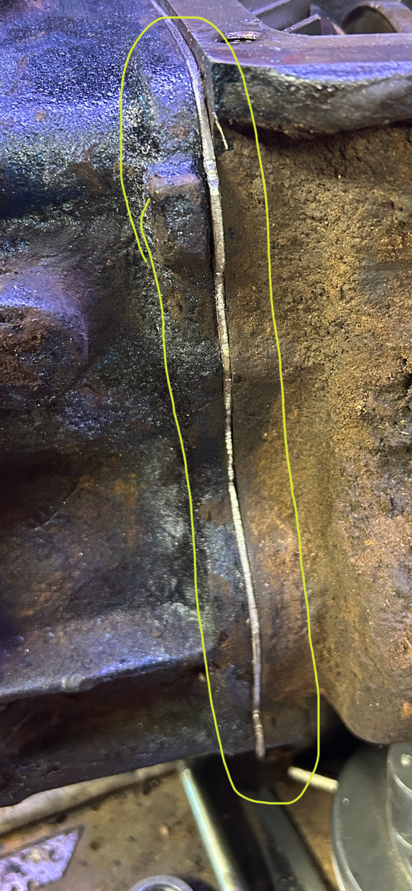

I ended up making a 1mm~ spacer, I read a few posts on this forum about bending the shift fork slightly which I tried and found that it doesn’t really work. It causes the fork to bind and offers only slightly better engagement. I read a comment in one of the threads about using a thicker gasket which gave me the idea for this.
How does this improve the engagement of the cltuch?
By shifting the whole housing back 1mm~ it shifts the linkages in the housing back 1mm~ also, therefore the clutch moves back too.
Now the clutch sits 1mm closer to the gear (still fully disengaged) in its neutral position but fully engages when in gear
very nice!
i have 5th gear ready to replace mine and was going to attempt the fork bend, but this seems much better.

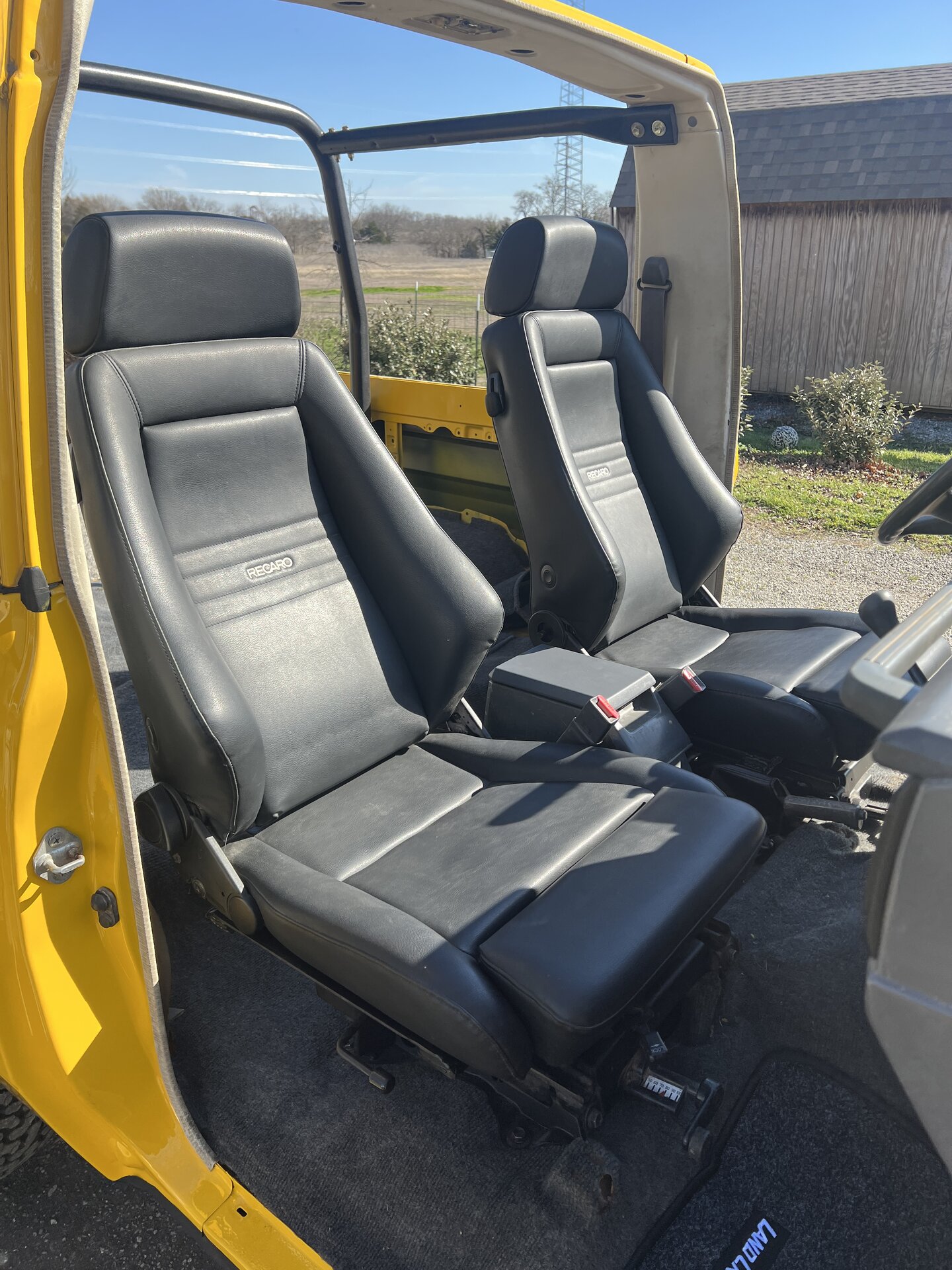

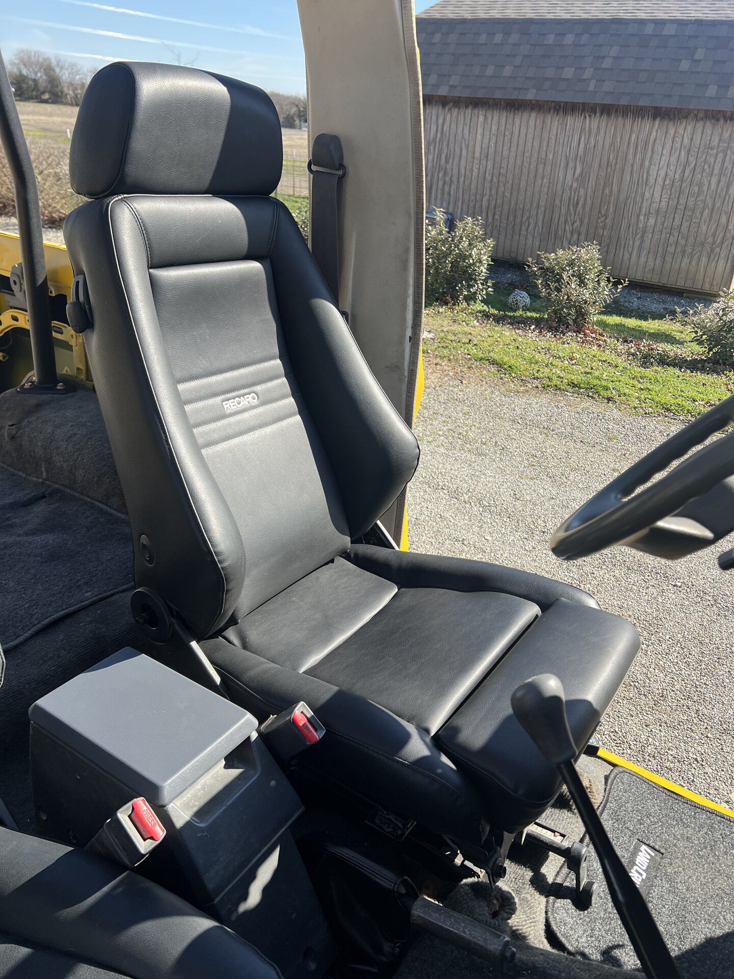

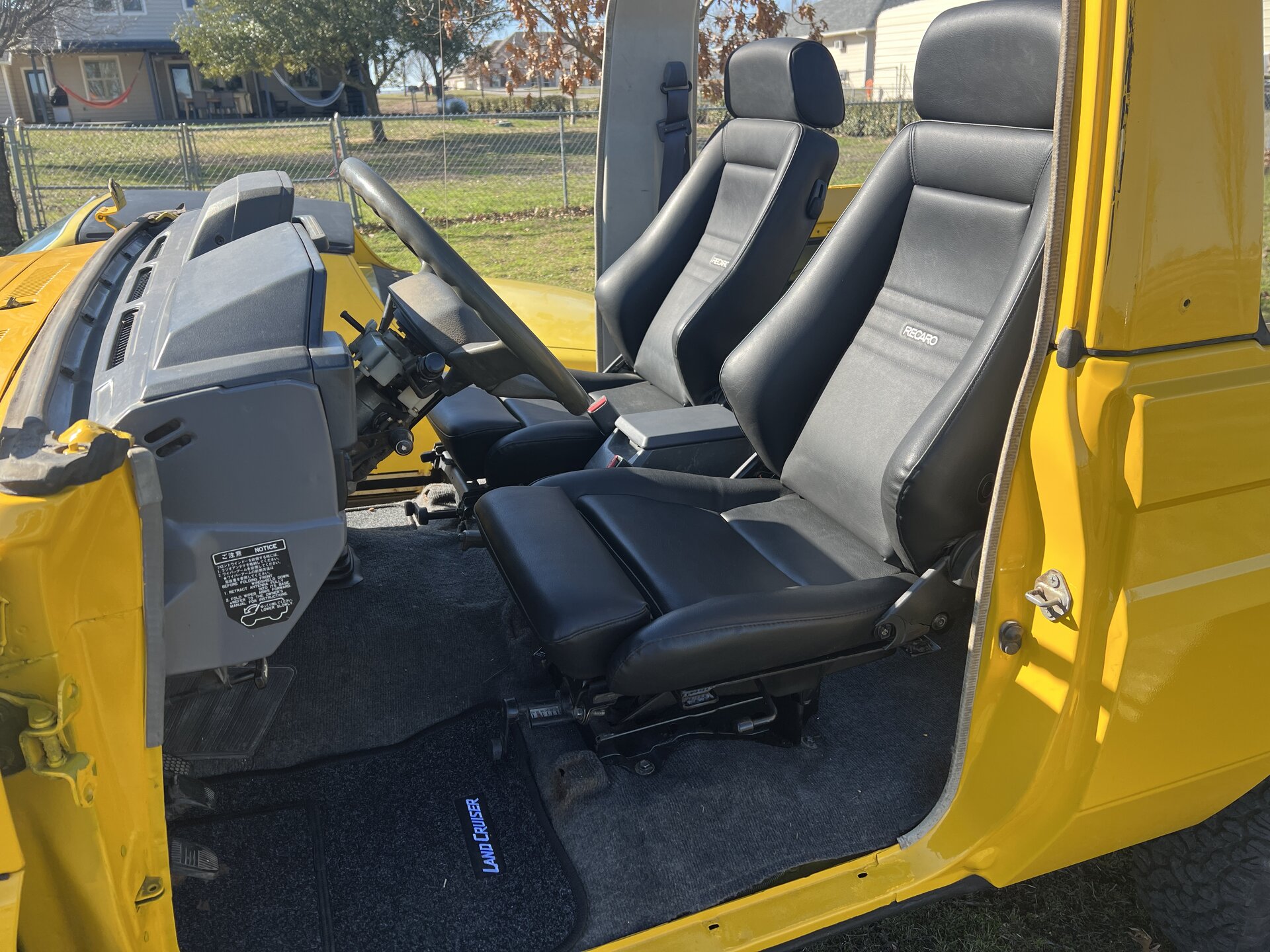

Slowly turning my BJ70 into an HZJ70. Relocated a seat bracket and added a seat belt anchor so I could fit 2 buckets and a center console while doing away with the 60/40 seats. Also fitted a second hand dog platform that happens to have drawers!

They are a very good fit , I might import some grey cloth ones from Europe in my next container
Did those suspension bases come with them? Or are the Toyota suspension bases just mounted to the floor differently than non-suspension seats?
