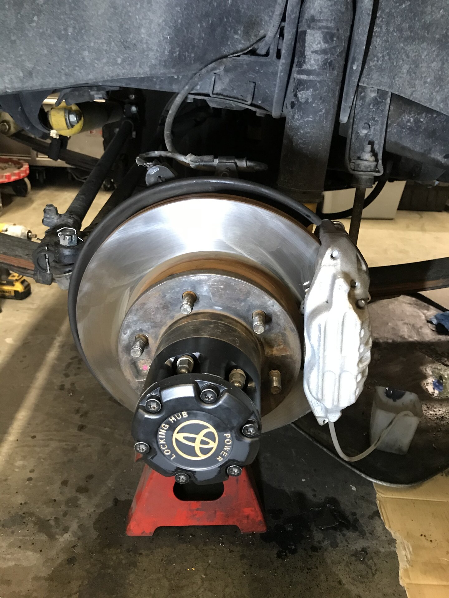

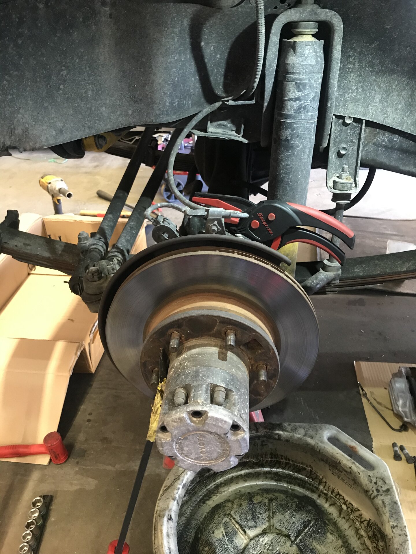

Rebuilding the front axle on the 78. Those little axle nut retaining screws on the power locking ring were a bear. Broke almost every T20 bit I had.
And what design engineer decided on hard brake lines going to the calipers, good thing I was already replacing all the soft lines anyways.
View attachment 3446108View attachment 3446109
What soft lines did you go with?
got a part number? I'd rather have soft lines as well.
My bad, I didn’t replace the hard lines with soft hoses. Just replaced all the old original ones. To get retrofit the stock setup you could make some elbows to go into the calipers and source some longer soft lines. It really is a crappy design with the joint attached to the dust cover.
I'm also thinking of replacing my hard caliper lines with soft braided ones. I guess it's as simple as matching the fittings and giving them an acceptable length. I've been told that soft brake lines can degrade and clog on the interior, so I guess there's a good reason but still.
Nice work!
Yeah these T20 little screws can be a pain. When I did mine, I used a manual impact screwdriver (the kind you whack with a hammer) and it worked like magic with no damage to anything.
The reason this happens is that people torque the bejesus out of them when they install them. IIRC, the FSM specifies a very low torque spec.
Cheers!
