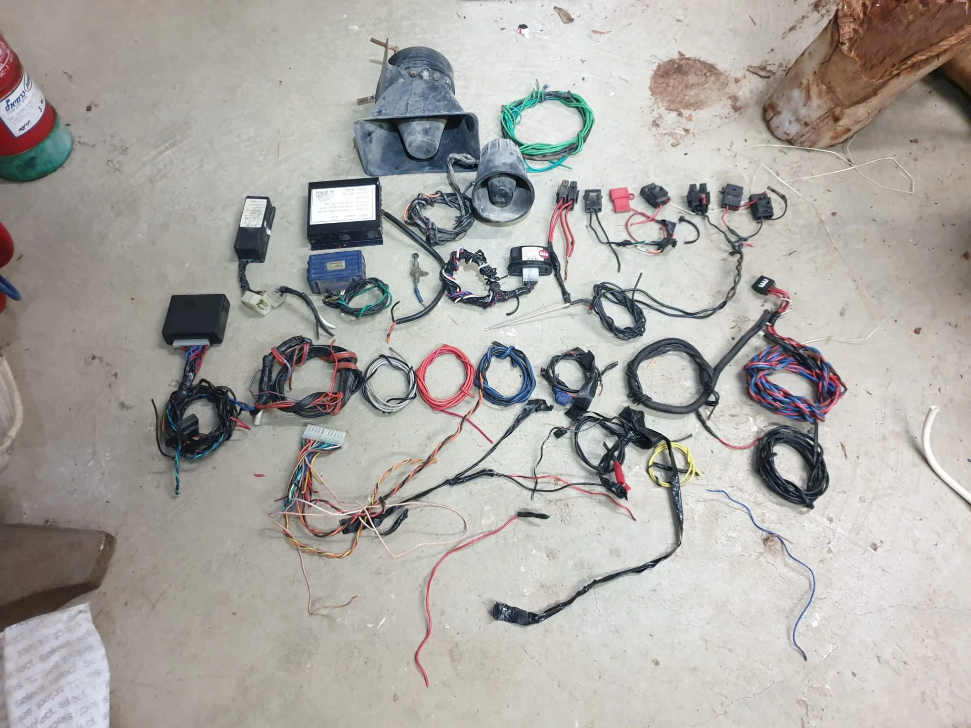

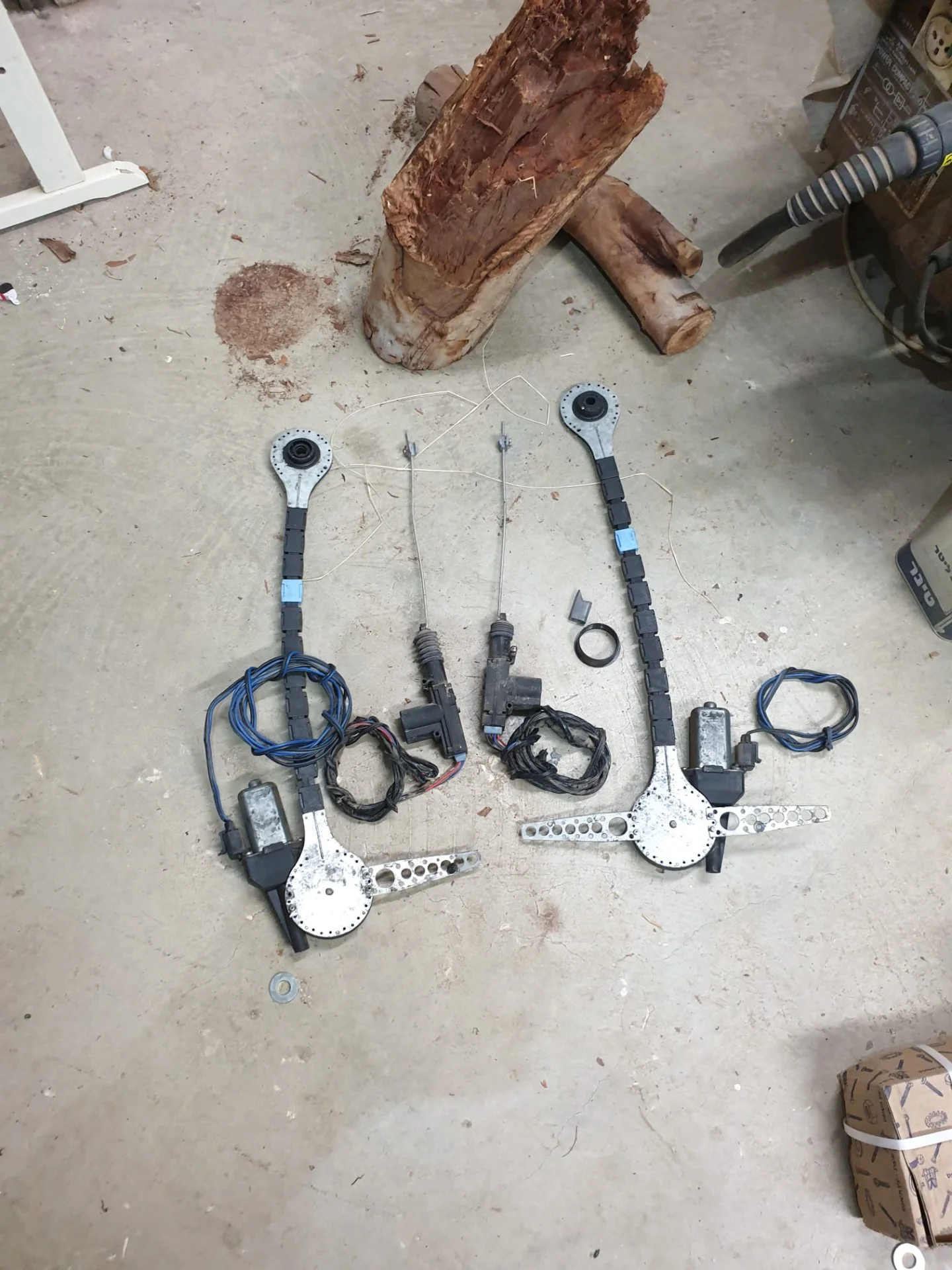

I have just finished removing all "cancer type" 12V aftermarket accessories from the vehicle.
That includes (but not limited to):
Central locking
Power windows
Automatic window close
Alarm system
Fuel auto pay system
Maglite charger
PAS (I think the horn itself weighed at almost 2 kg)
GPS locator (never fun when you are actually the fugitive...)
Automatic light shut-off
Code activated safety shut-off
Left, only the radio and trailer light socket.

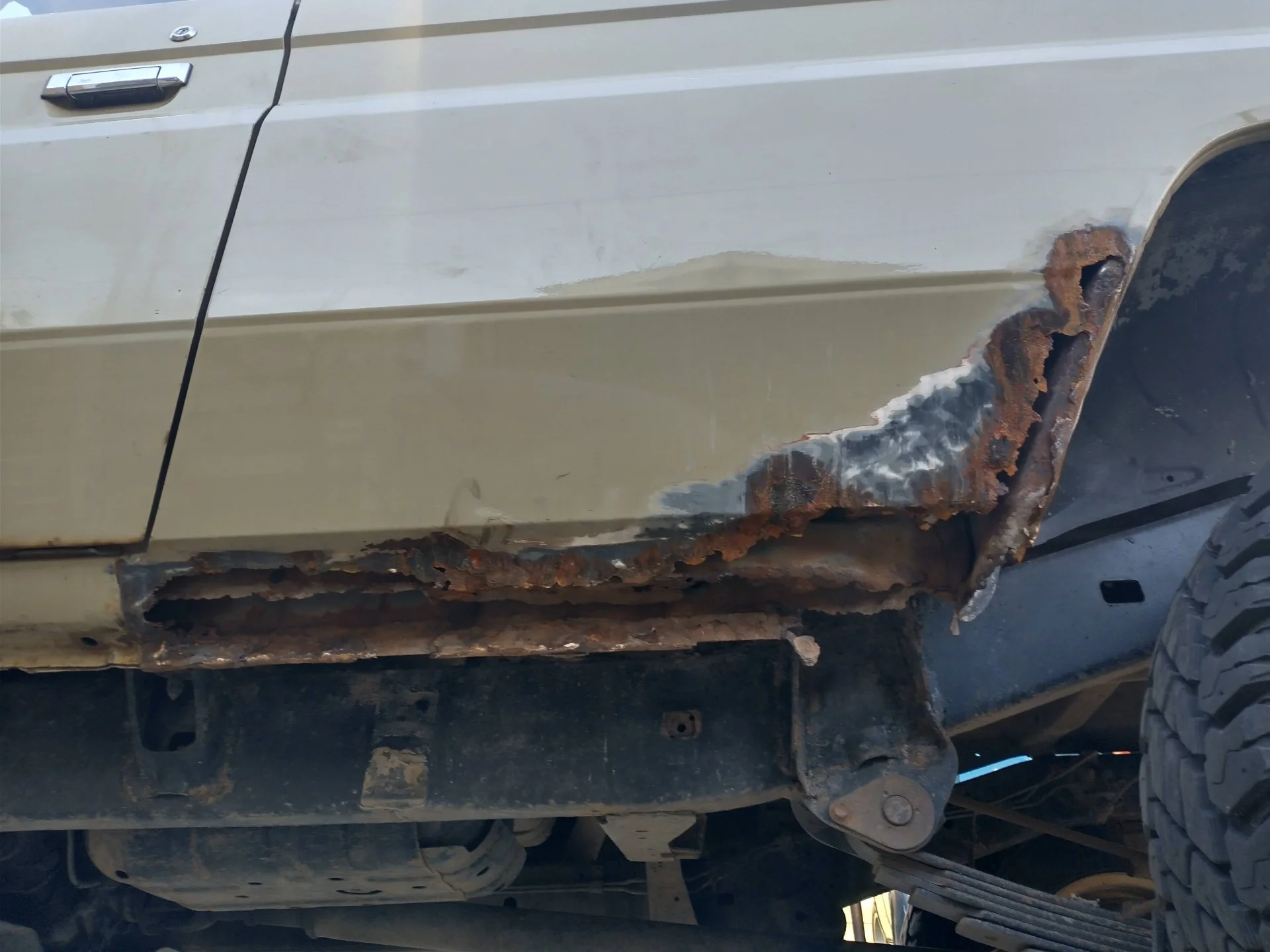

More rust repair. Debating on continuing with my current process on the driver's side rocker, or waiting for a rocker to come available...kind of sick of this project. Need to spray what I've done with some primer and start spreading some filler.
About 3-weeks ago:
and last night:
About 3-weeks ago:View attachment 3045797
and last night:
Looks great
I wish I had the patience to do mine
Same problems different wheelbase....
Are those 315's?

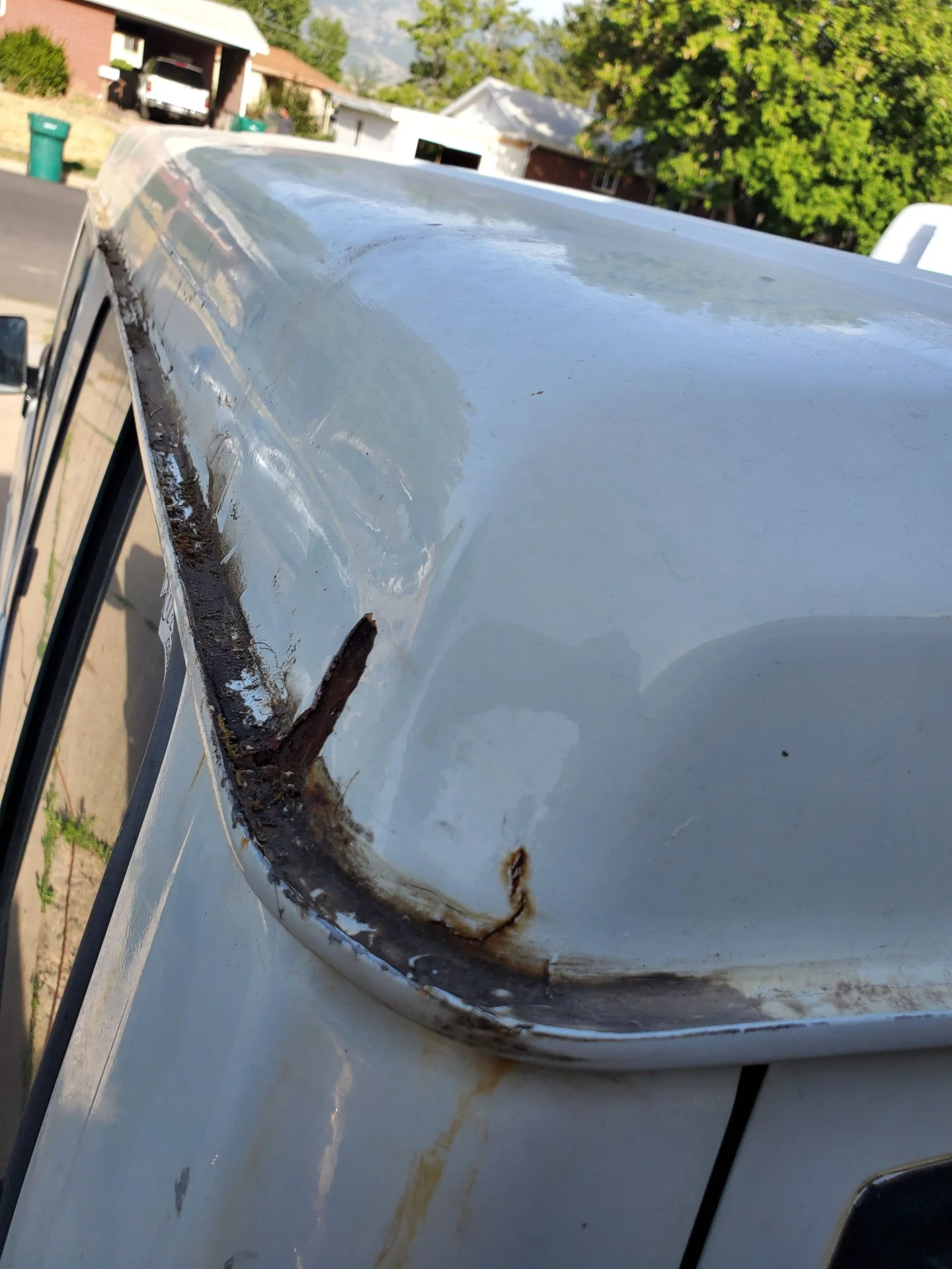

Started digging into the rain gutters. Not as bad as I was expecting. There's a couple holes here and there. Mostly from installing the 3rd door I believe. Really glad there seems to be all good metal.
I'll seal the holes up with fiberglass and then a coat of rattlecan 045 paint. To reseal the seams I'll use Sikaflex 221. I have a bunch in white left over from another project.

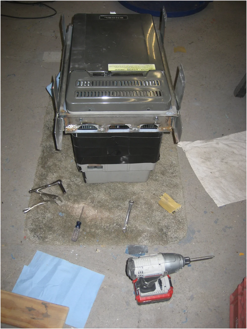

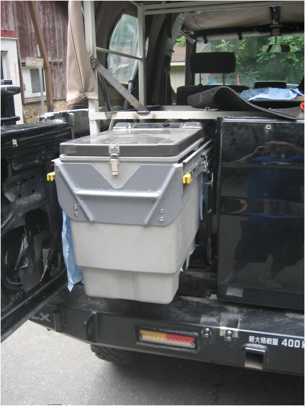

Made some progress on pull-out fridge . Taped paper towels to fridge and sprayed them heavily with H2O during welding. Totally forgot it should work with just the left door open. Lucked out... it does.
In an earlier iteration, I just had it bolted to the shelves and I placed something like a sleeping bag on the lid...removed for food grabs.
I will soon discover if the Amazon drawer slides can handle the punishment offroad.
