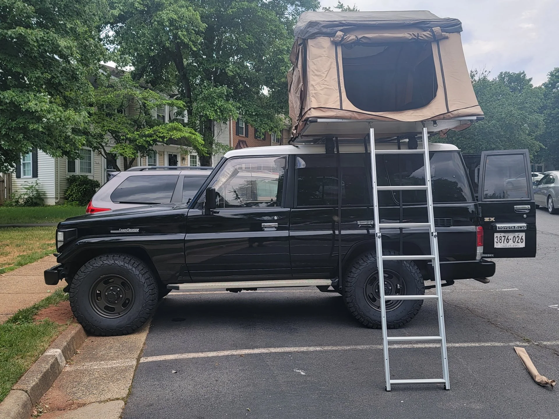

Looks so good, I'd like to get a Kaymar as well. Tell me about the GXL mudflaps, where did you find those?
Thanks
I managed to get them off ebay using part numbers 76607-60271(right) and 76608-60271(left). They are on partsouq as well I believe.
These mudflaps definitely look good with the kaymar as they extend out more than the original HZJ77 mudflaps. I got my kaymar from @joekatana I am not sure if he will continue to bring them in or not.

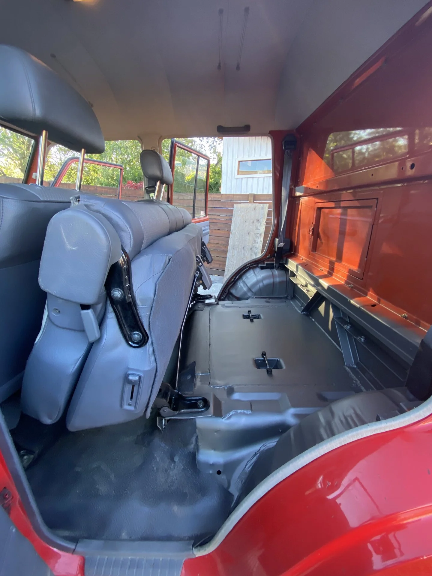

95% complete! Awaiting headrests and deciding on sound dampening material.

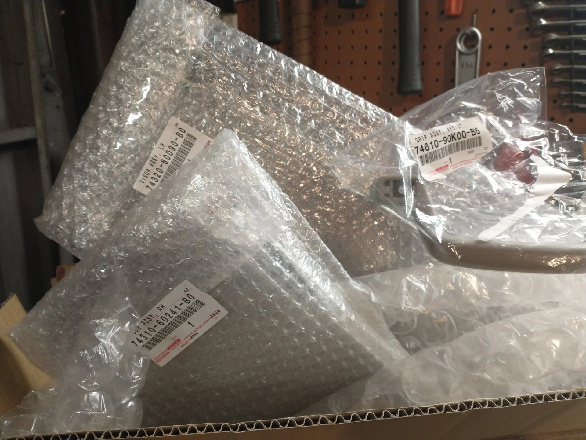

Got some new sunvisors and a driver's side 'oh-$hit handle'. Mine are tan (with stains), these are gray...not sure it matters as my seats are gray, headliner is tan though. My trim code is LC011 (I think).
Anyone here ever try painting visors? SEM makes some interior paints.

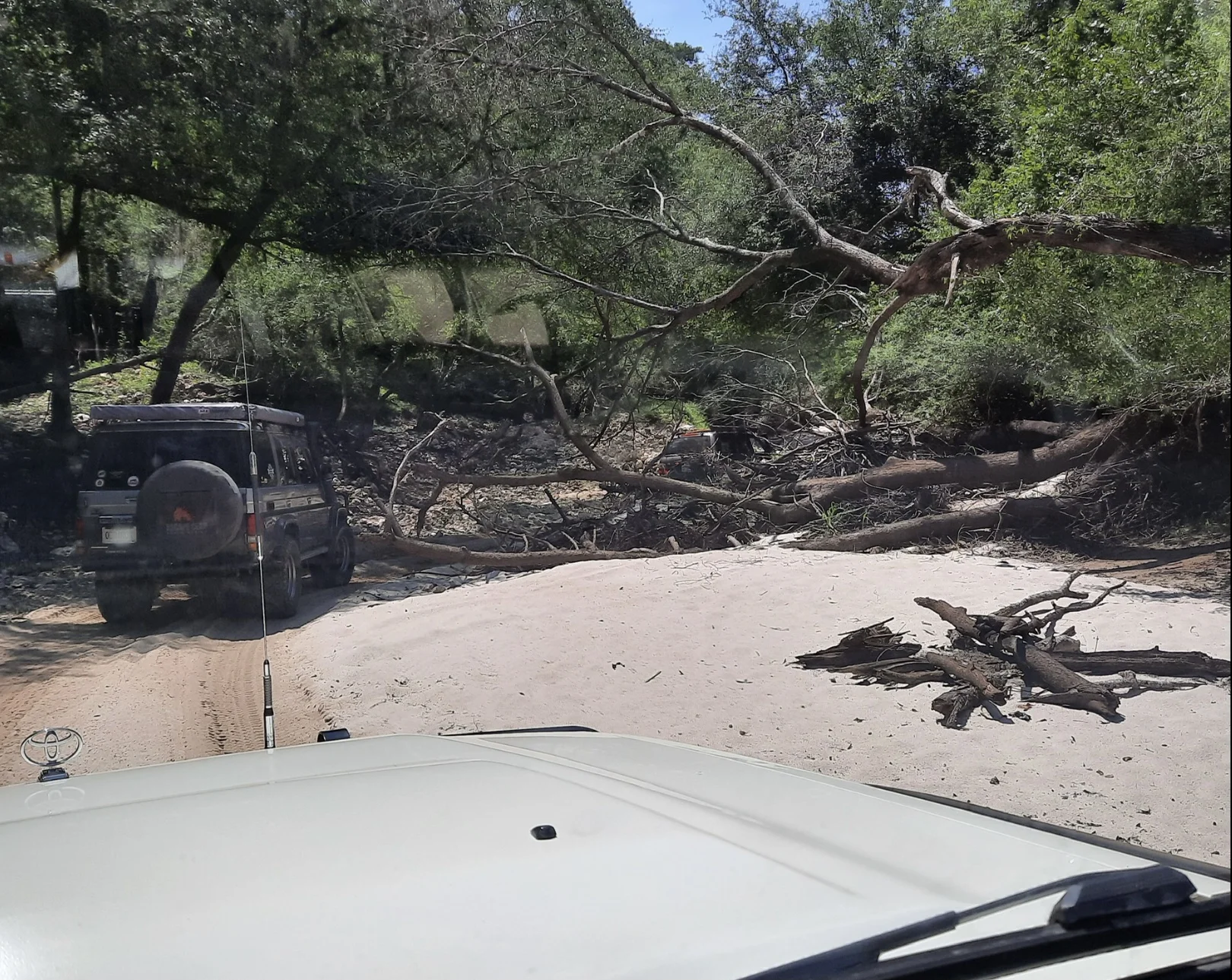

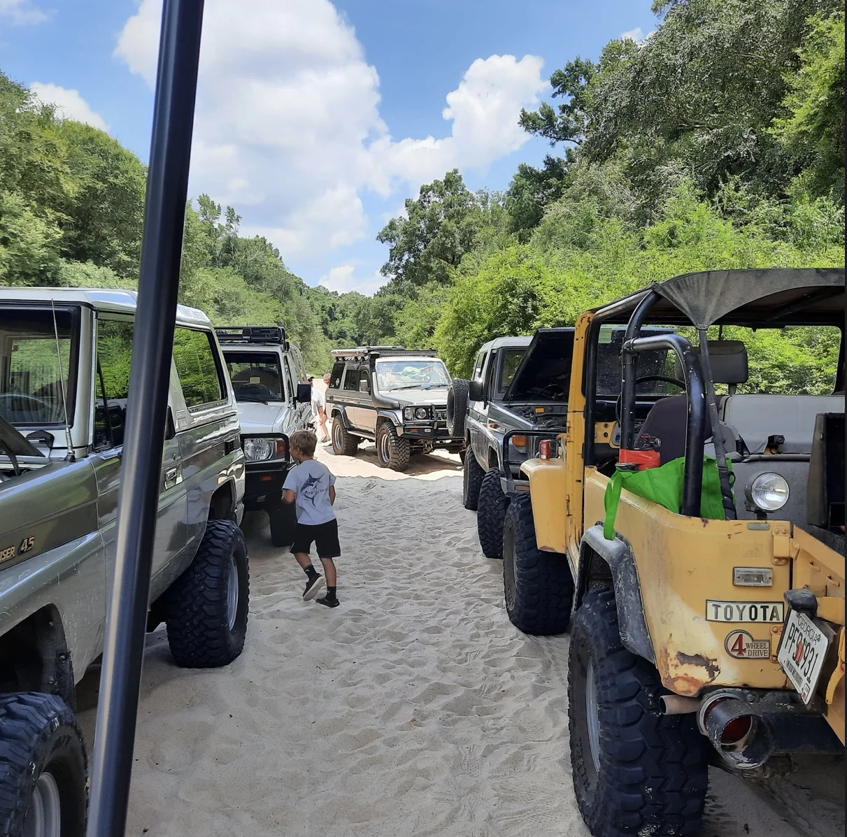

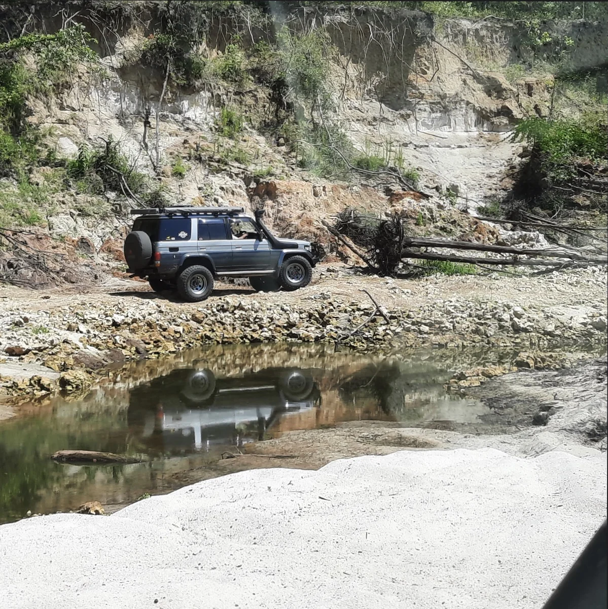

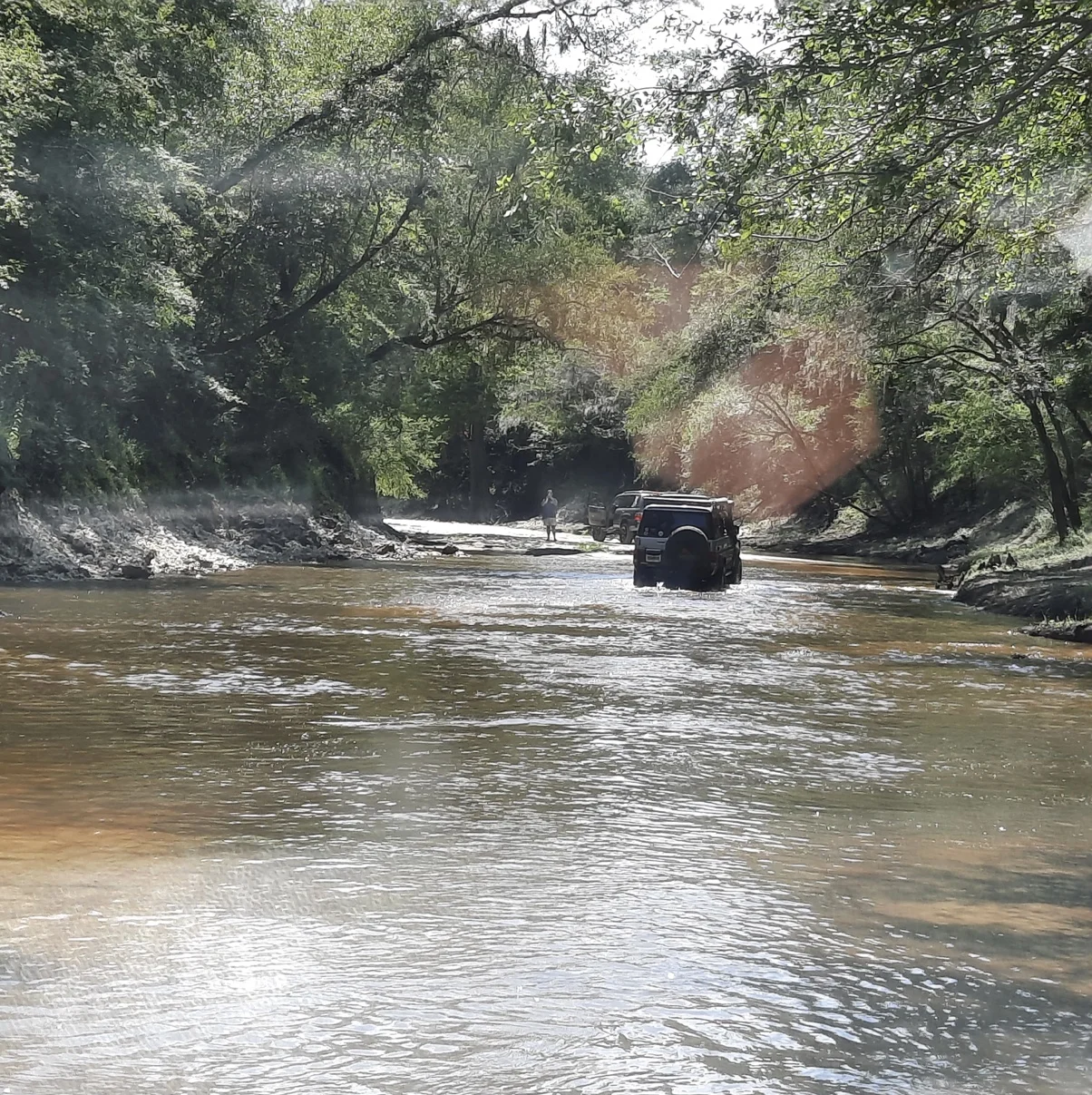

Spent the day following a bunch of 70 Series down the Alapaha River bed.

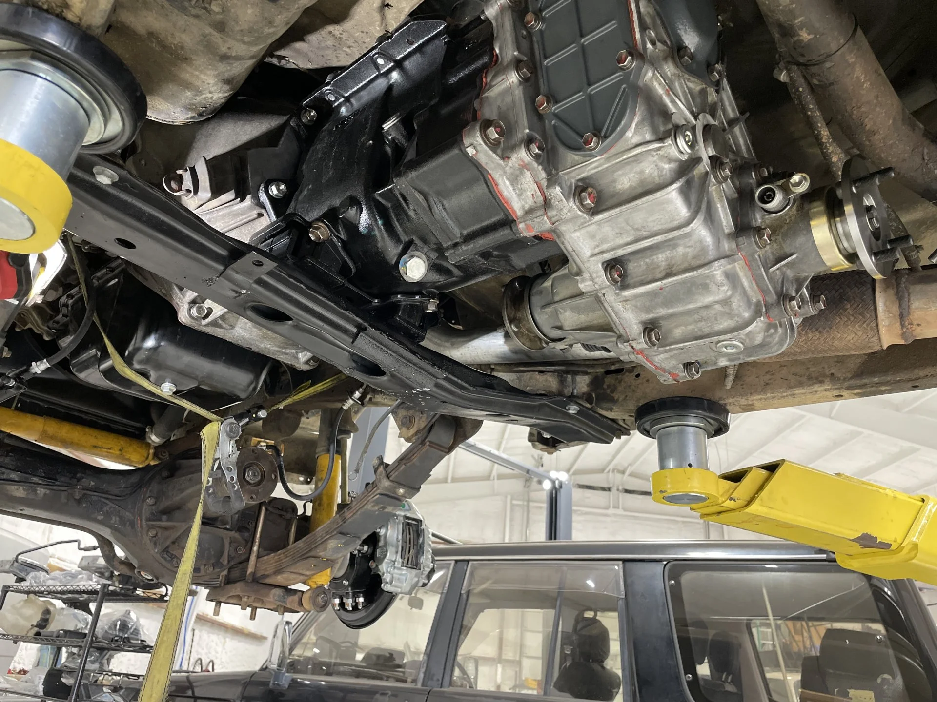

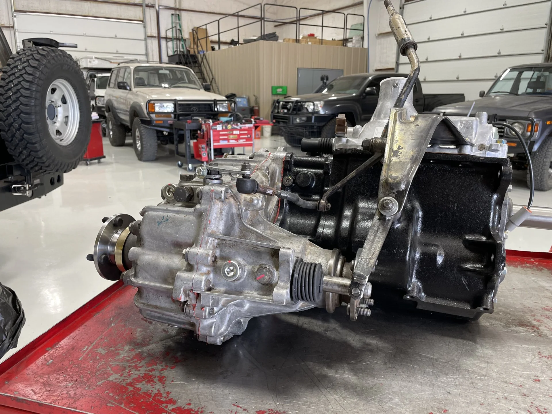

Got my 74 back from transmission experts.
Ended up spending about $3,000 for gearbox and transfer case rebuild kits, labor, replacement input shaft and machine shop work.

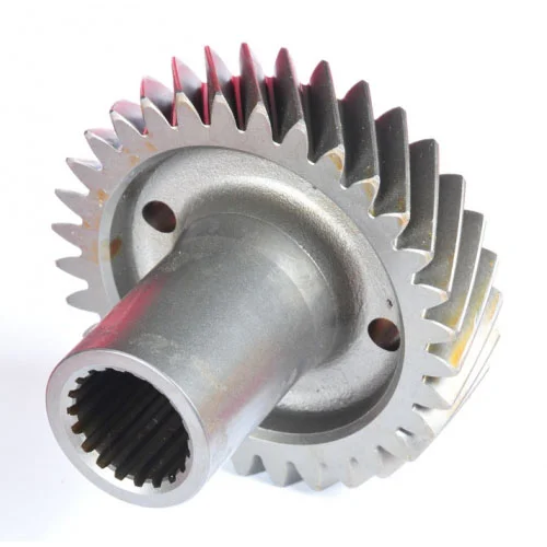

Upgrade t-fer case input gear had to have its tail shortened to allow pto gear to fit nearby.
At least one roller bearing assembly had worn out.. individual rollers lying around.
Truck went into reverse first try, which is an improvement.

If they cut the extension off the long spline input gear for use with a PTO gear, unfortunately it's just the length of the standard input gear fwiw. There was a manufacturer doing the long-spline gear with PTO provisions but they've been super hard to find for quite some time. How did the output shaft of your trans look? Generally if TC input splines are worn, the shaft is worn too.

I drove the 40 minutes to their shop and the guy showed me the original input gear, spacer that goes on the same shaft, and the shaft itself. The spacer was about 1.5 inches long. The new improved gear’s tail was longer still. Yes the shaft was worn noticeably. I ran the new gear to a machine shop I use quite a bit. They cut off the tail so its length matched that of the old gear+spacer. So at least some of the new gear is making contact with unworn splines.

Ah yes, that is true there is a short spacer between the input gear and the PTO gear, so every little bit will help. Did you consider swapping them trans output shaft while there were rebuilding? If you find yourself back in there, we stock the shaft.
I was desperate to get the truck back. Also, I was thinking a replacement shaft would be NLA.
I will probably get one from you and get it put in in the Fall.
