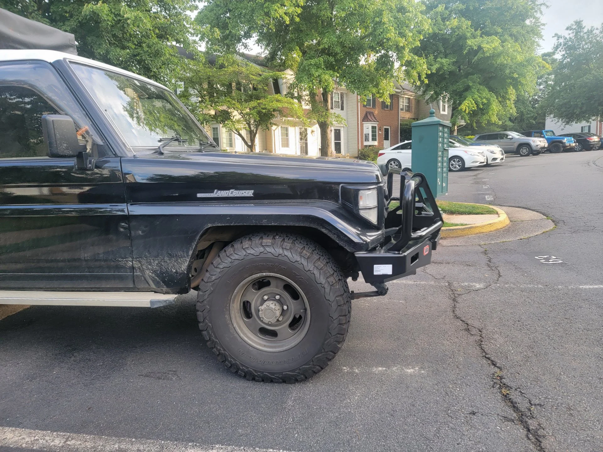

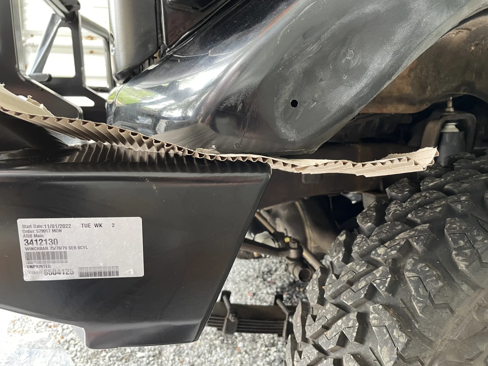

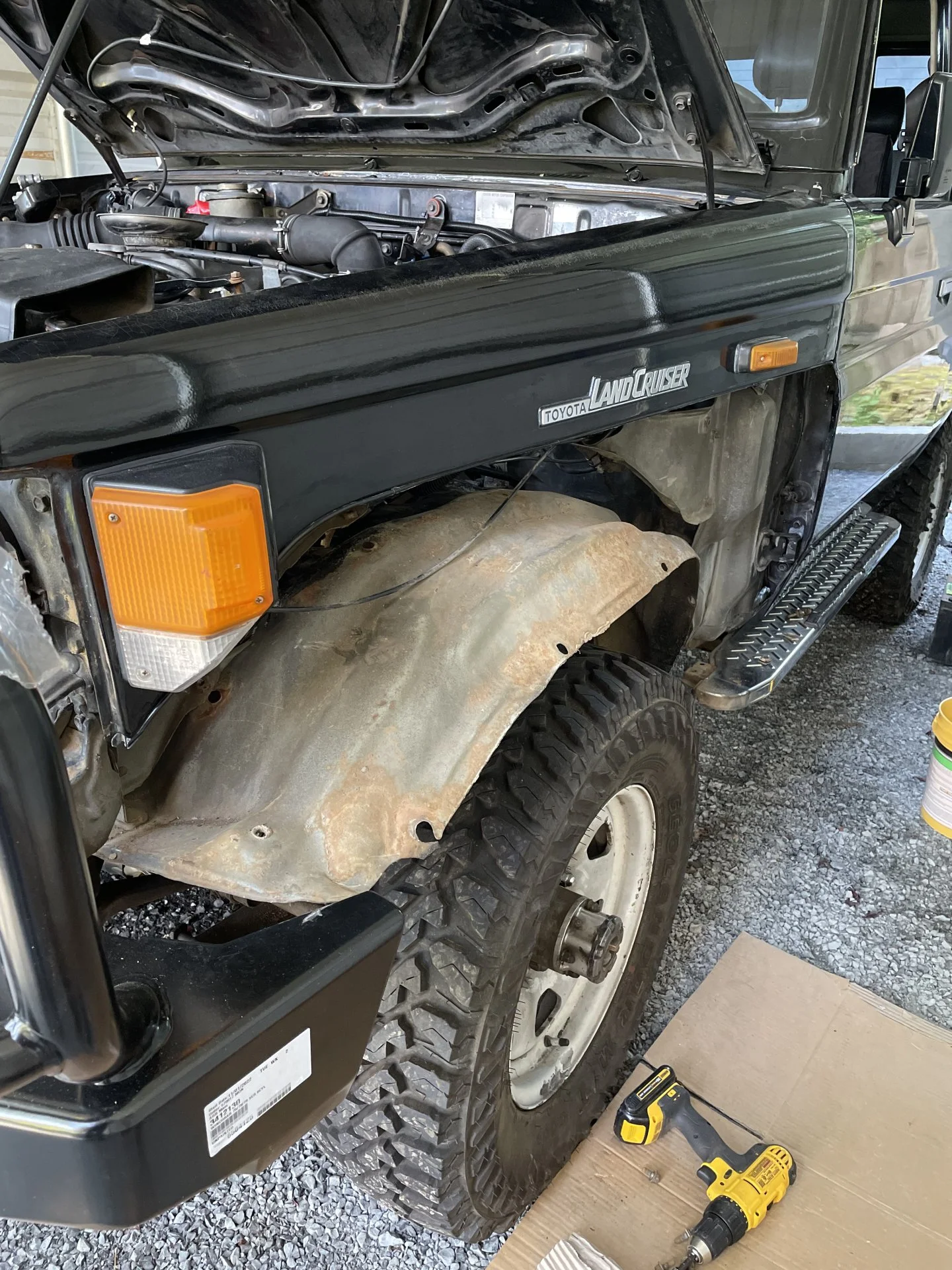

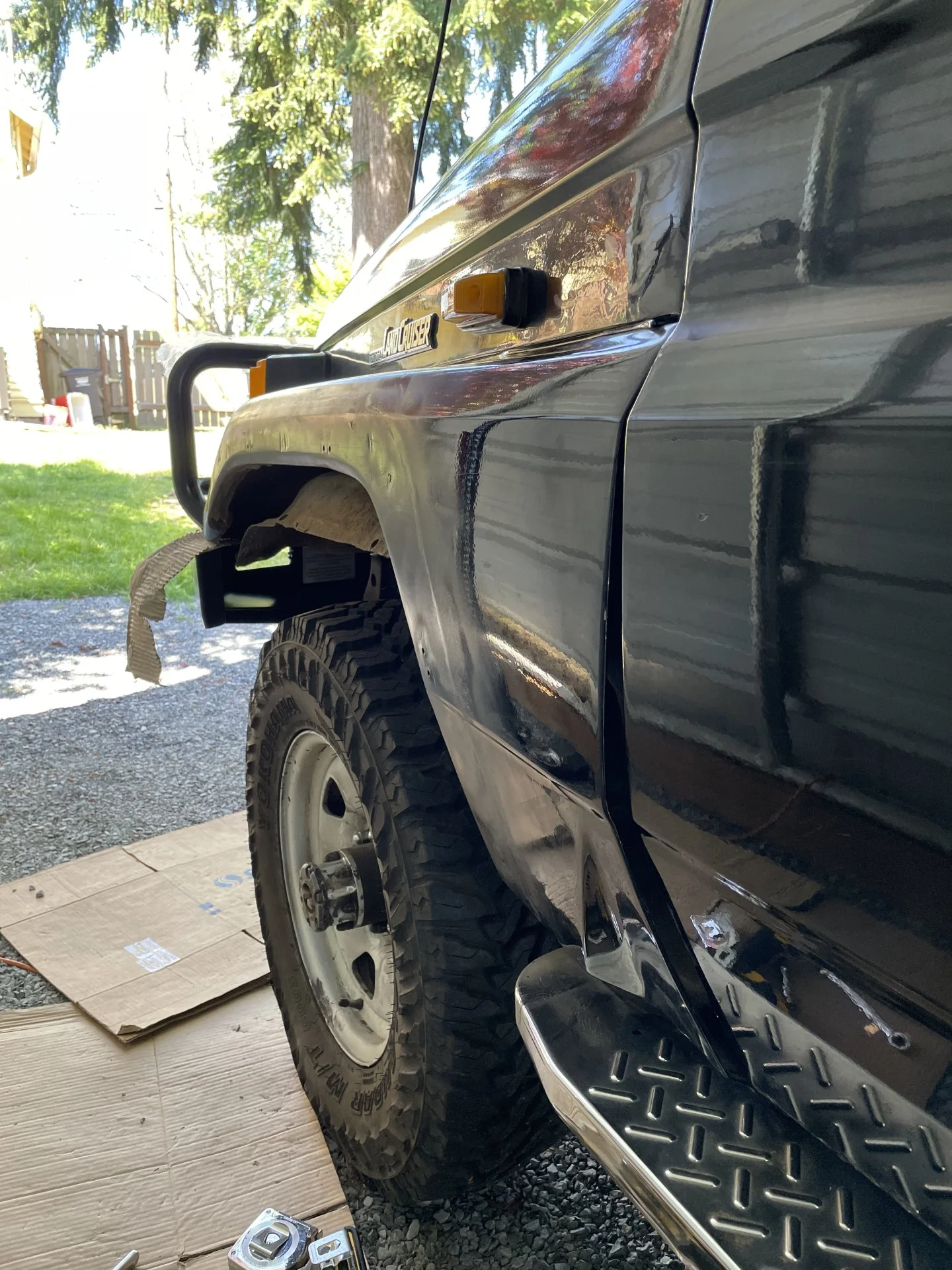

I got mine last week after a long search for a used one. But have run into a slight snag with the way my fender was lining up so now I have opened a new can of worms haha.
No gap on the Driver's side:
After adjusting the front gap on the fender:
And now what I have going on. Turns out the fenders dont rub if you dont have one.

do you think it's because the ARB was used? or were your fenders just uneven?

Bj73. I’m beginning to think it’s not square. The upper fender where the land cruiser badge is doesn’t have the same gap between the edge and windshield frame on the drivers side as it does on the passenger as well. Lots of little body gap problems it looks like.

had a similar issue with mine when i installed an ARB. truck looked like it had had a stroke. body mounts were collapsed on the LH side up front. to check it, i installed a few spacers then cranked it back down. no more lopsided grille. i have some fresh mounts to install. now, just need some time to slide those in.
