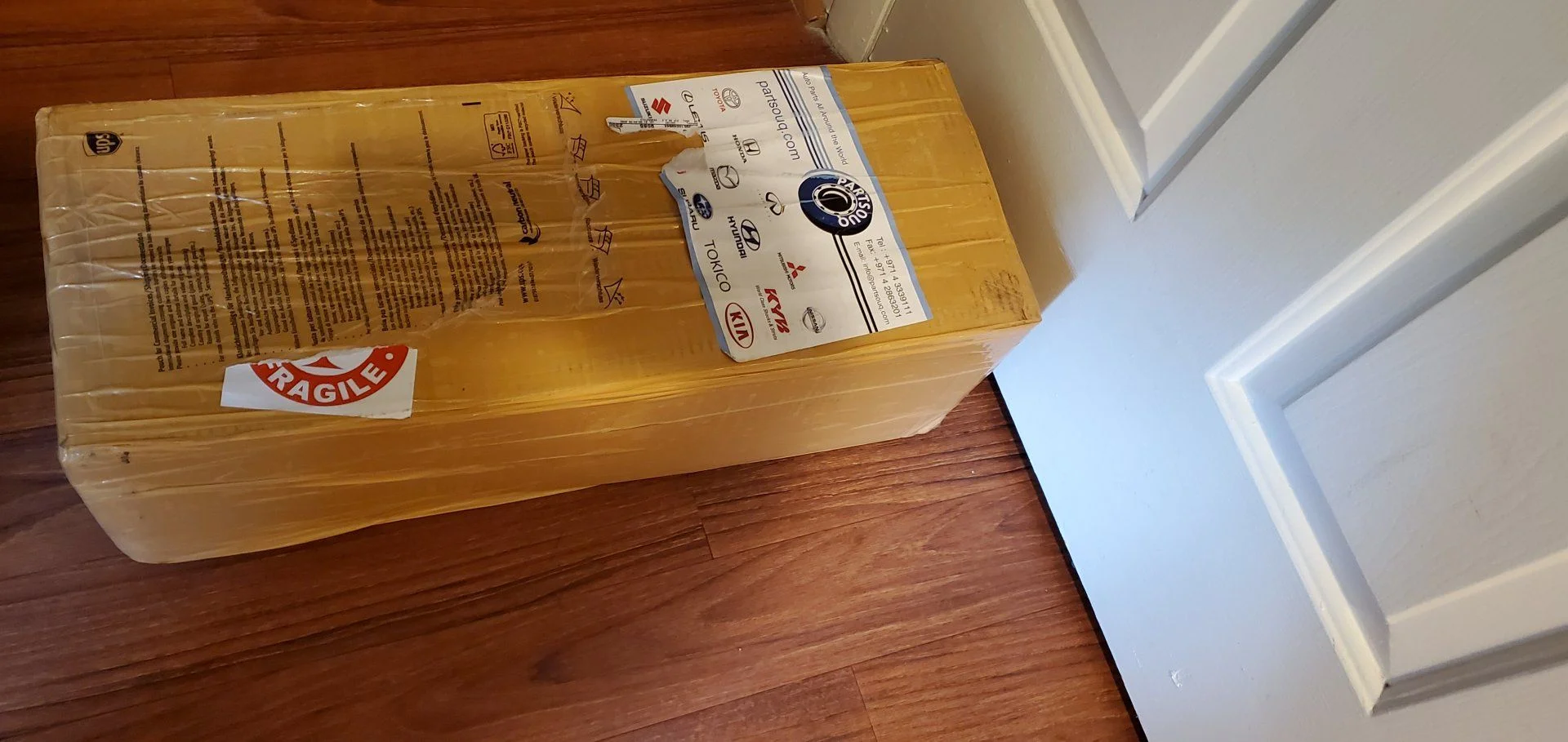

Finally got my Partsouq order in. Most excited about the door hinges! Well... the hub bolts as well, I sheared one off breaking torque on the rear wheels.
Some how, I ordered the wrong bulbs, the pins aren't offset. 🤔???

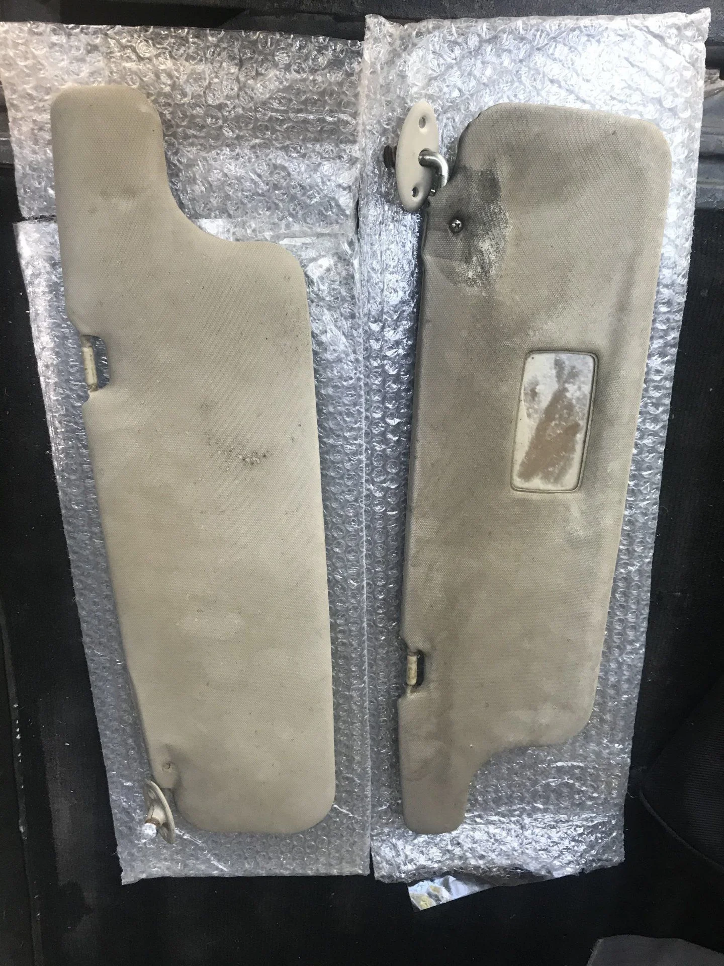

I replaced these today....

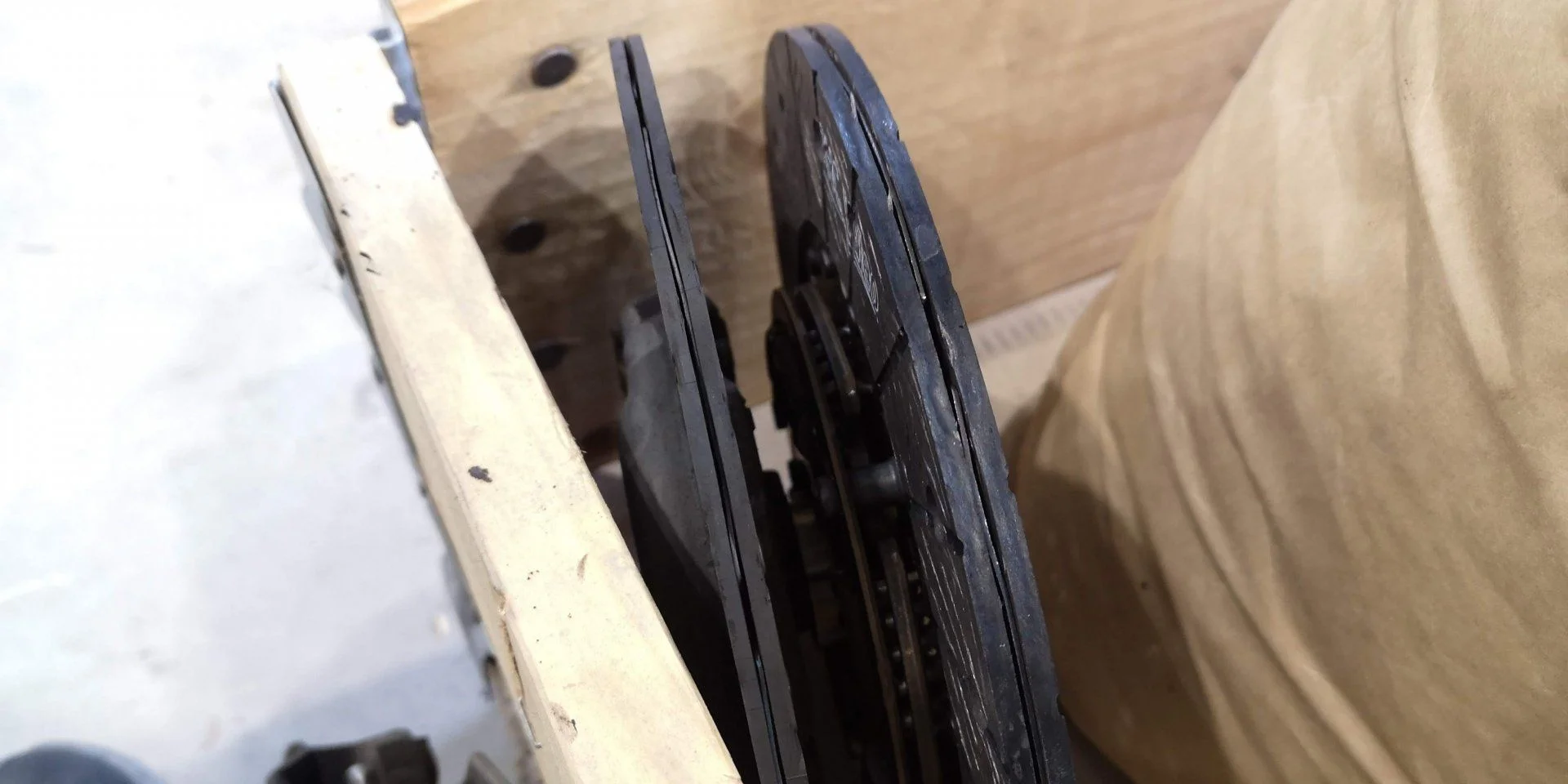

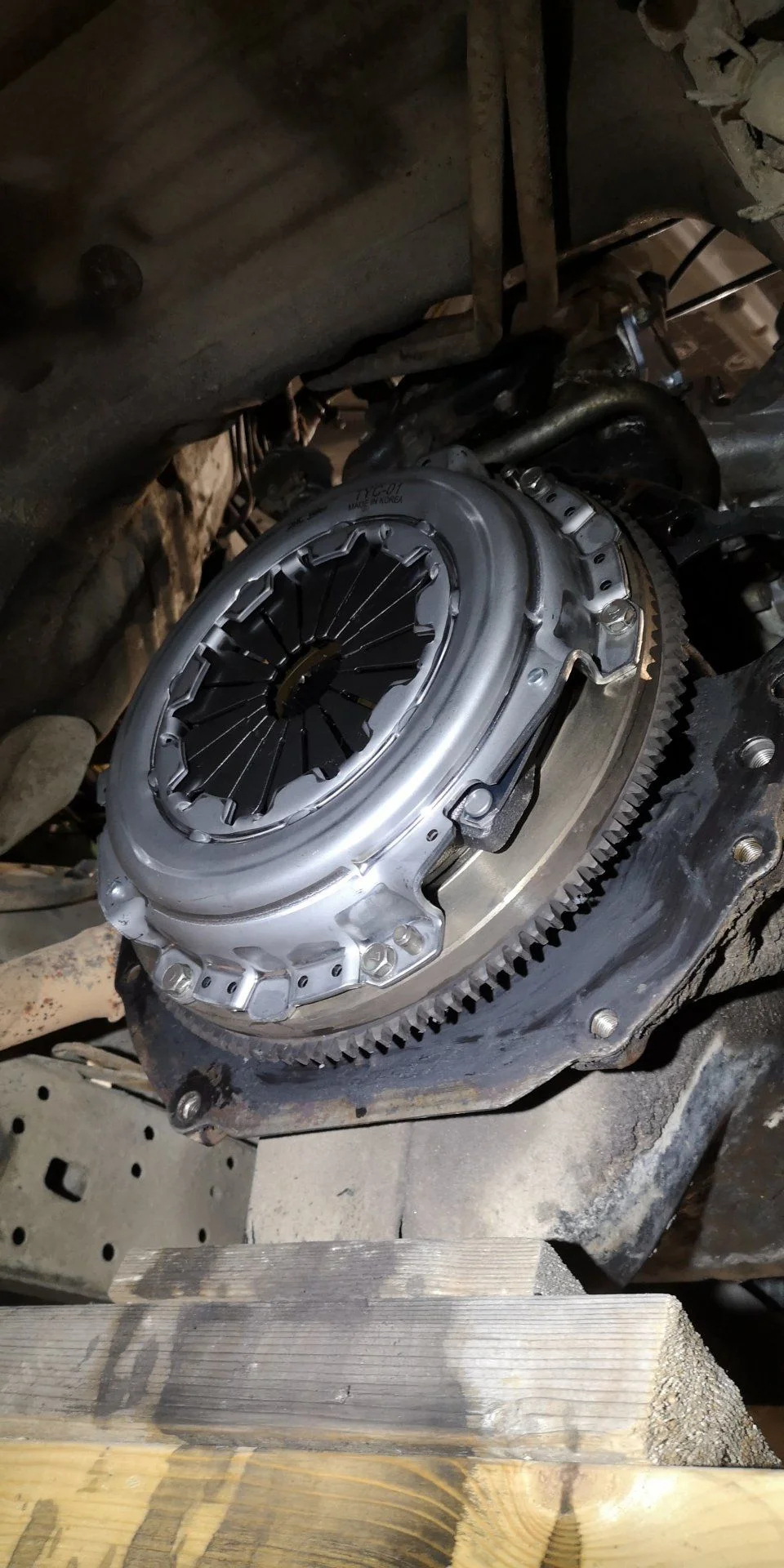

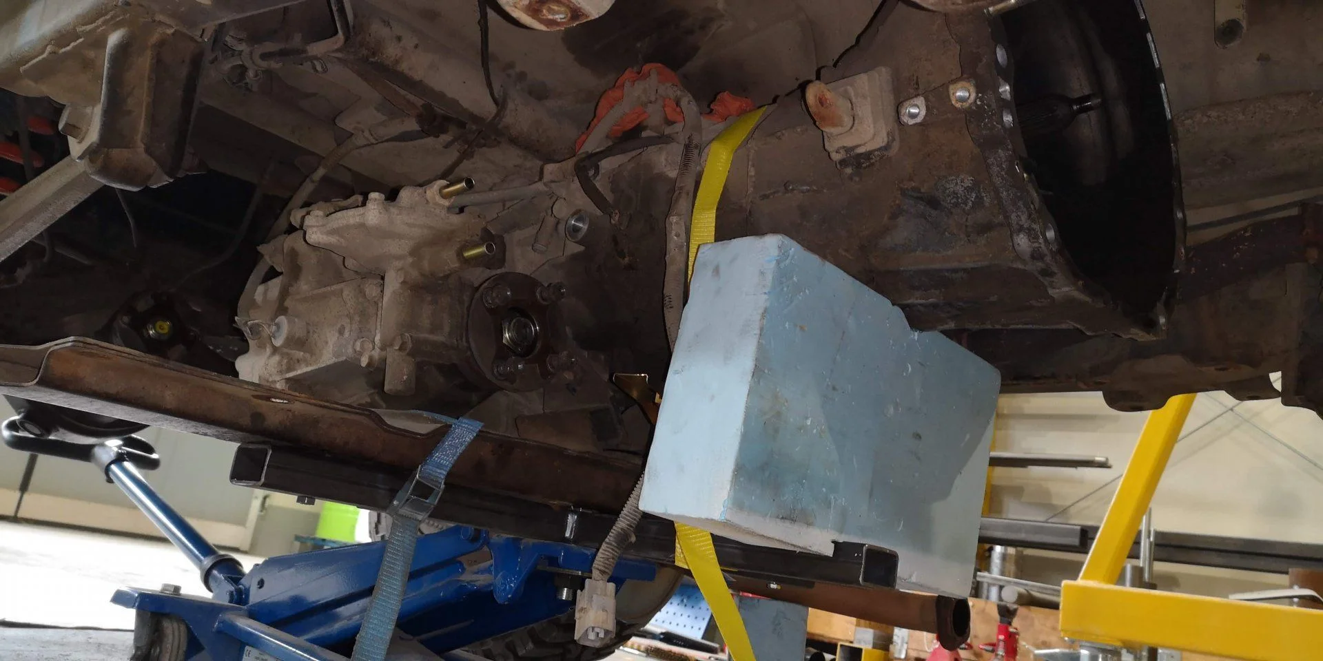

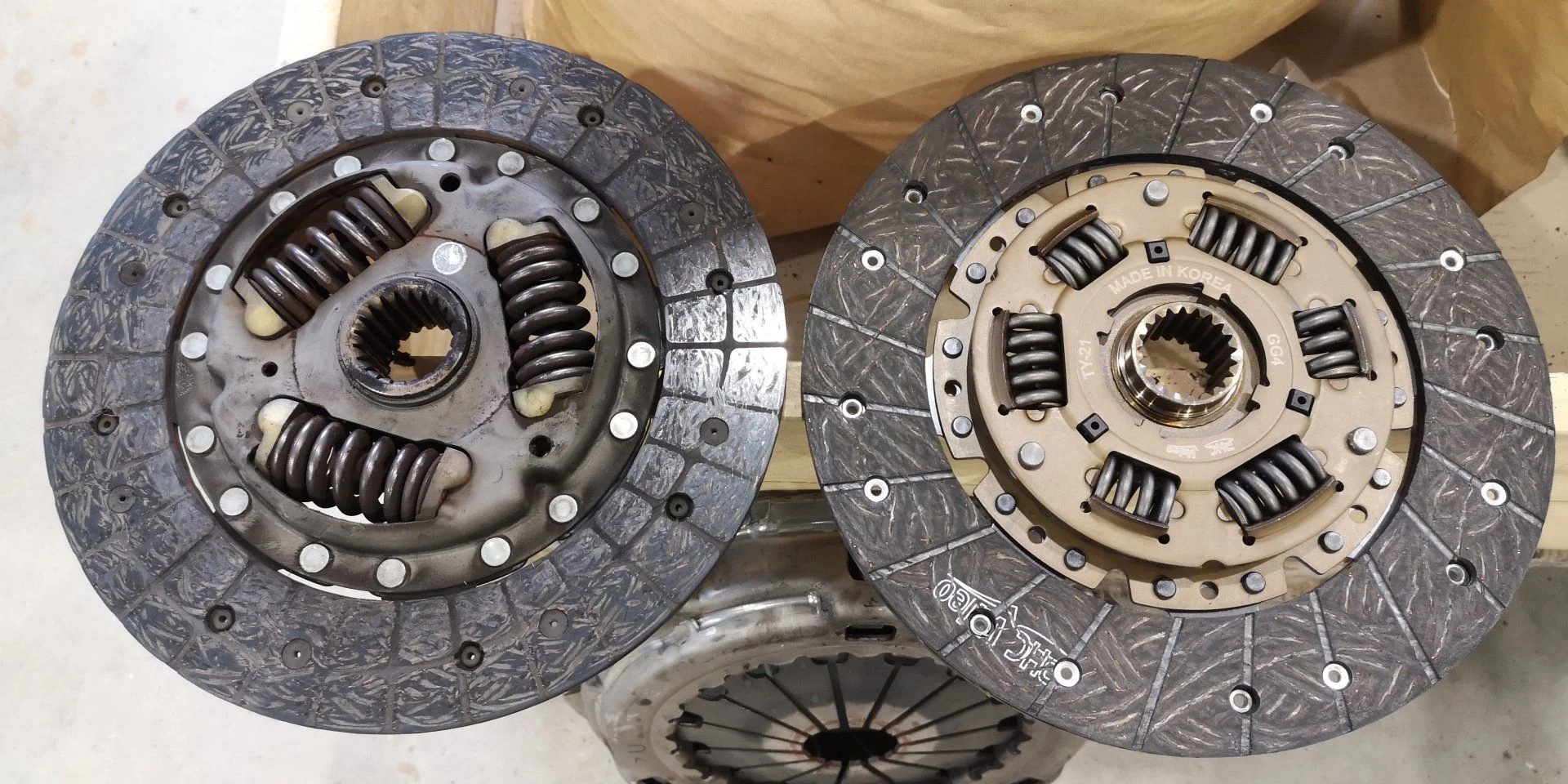

Last week, I noticed the clutch slipping when accelerating in 4th gear. I had the clutch pack ready on the shelf so now at the beginning of the summer vacation it was a good time to replace the clutch.
I made a simple support for the jack to move the transmission and it worked fine. The clutch pedal is now much lighter to use and catches lower. So much better to drive now.

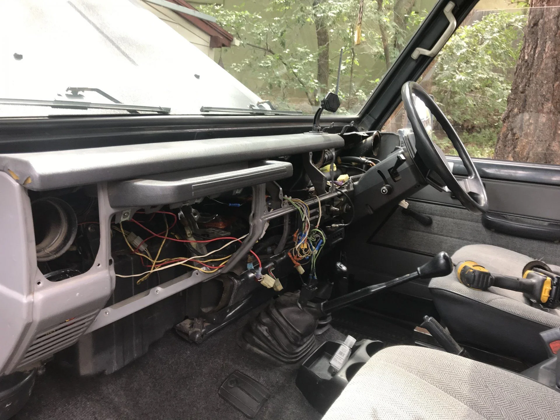

Spent the afternoon doing one of these:
Trying to run down multiple issues behind the dash.
  1. Heating/cooling switch was stuck on cool.
  2. Stereo wiring is trash. The stereo worked and then one day driving it just stopped. :bang: Will be rewiring the whole kit but looking for a good 24v-12v stepdown converter.
  3. Put everything back together and the right side of the gauge cluster stopped working. Like, no signal but plugged in. Everything on the left side plug (tach, signals, brights indicator, parking brake indicator) works. I'm so confused. Back of the gauge cluster shows no damage. It literally worked and then I took it out put it in and it didn't. 15A Engine fuse wasn't blown. Please help if you have any ideas.

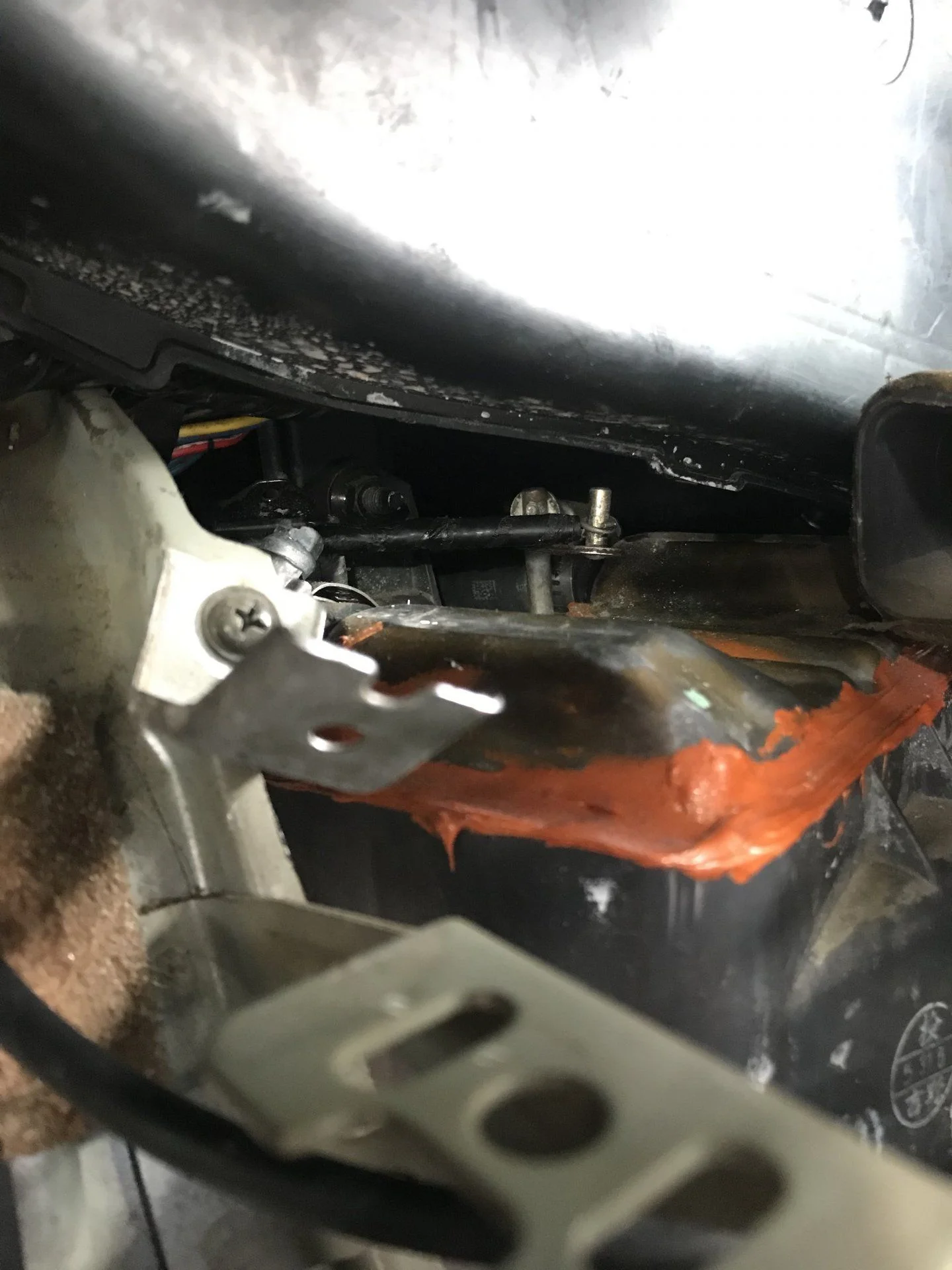

For issue #1, I followed the actuator cable back to the heating core opener thing, and it seemed a bit bent. I straightened it out and was able to open the hot/cold mixture to about halfway. Looking at the cable, it was bottomed out on the cable housing so it couldn't go any further. Pics below:

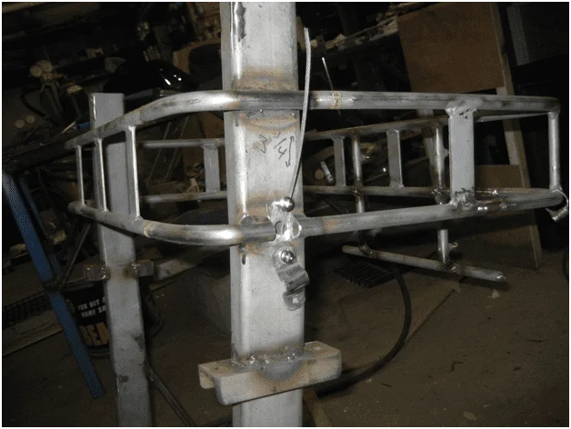

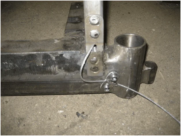

Fooled around some more with a storage basket rack that will be on the left side rear bumper swing-out.
Drilled holes and cut in a wiring access port and strain relief for the electrics that will serve the illuminated rear license plate.
Ran a steel cable to make sure the path was clear.

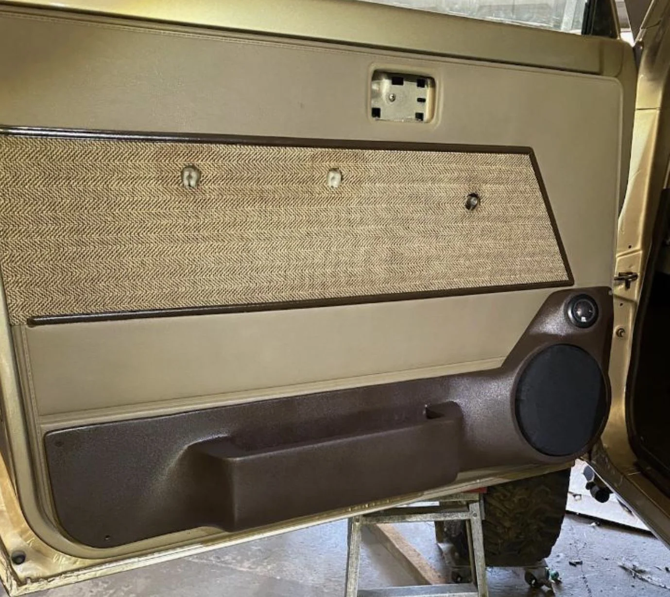

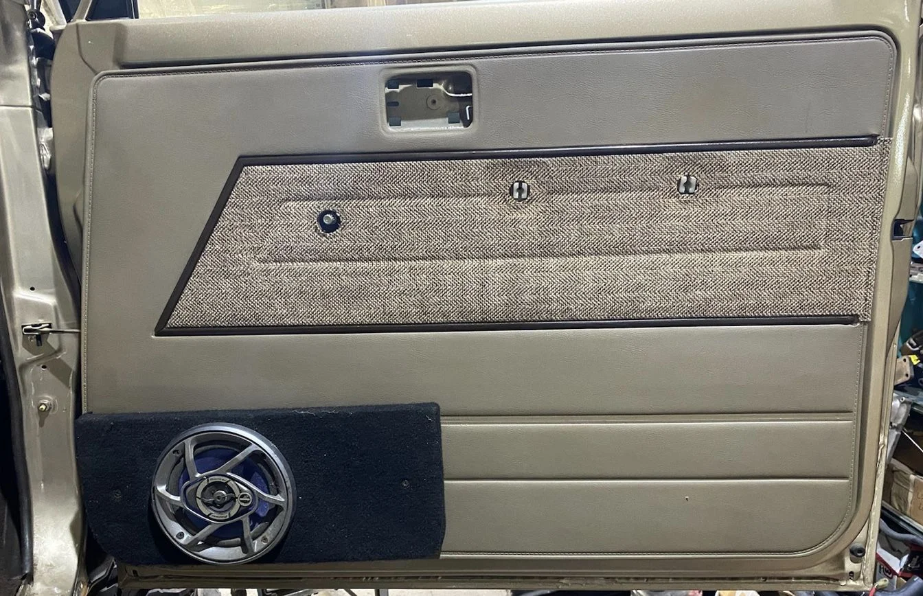

Updating the door cards and adding speaker pods and storage. (BJ71)
..... Before Shot .....
..... After Shot .....

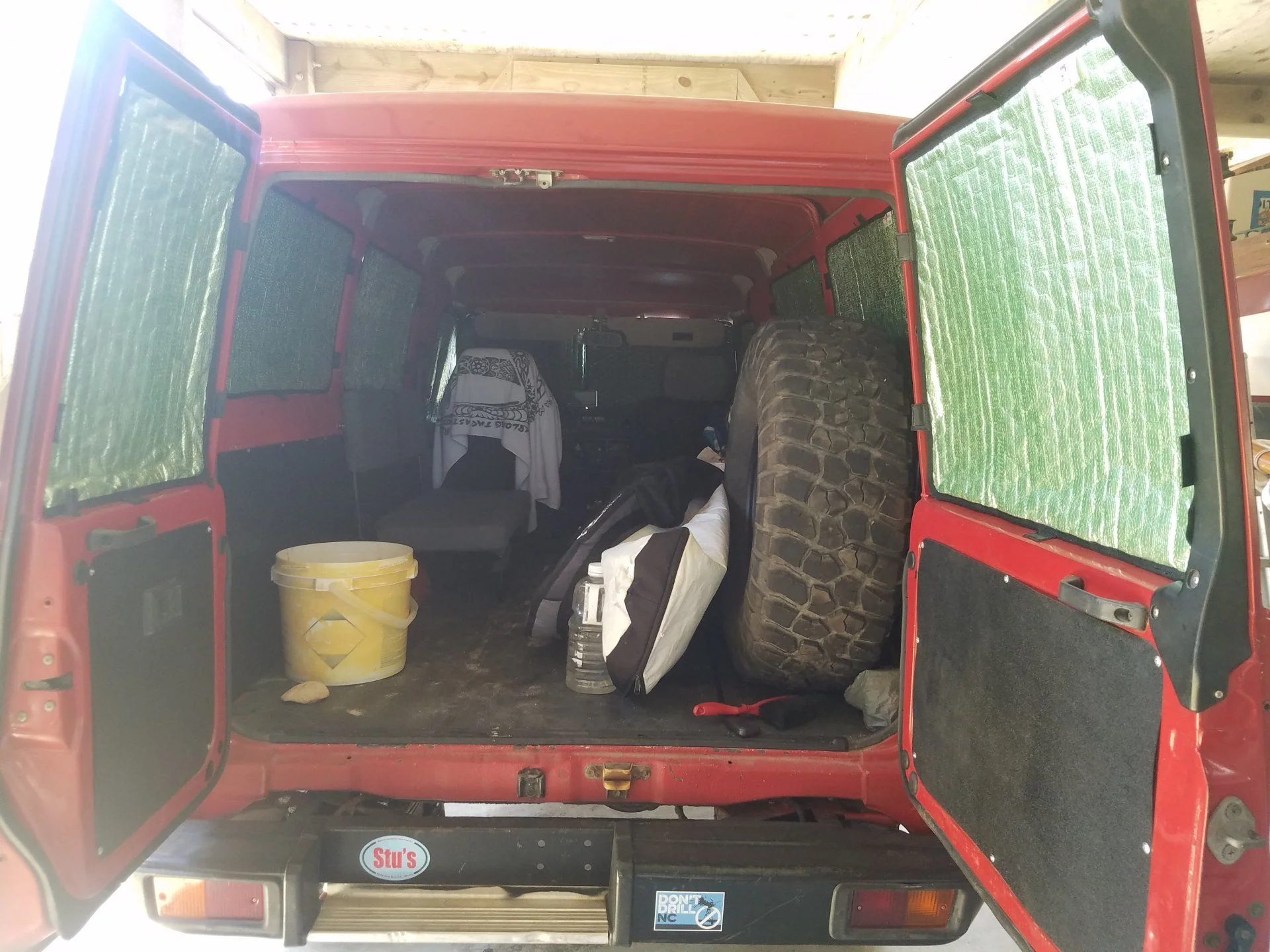

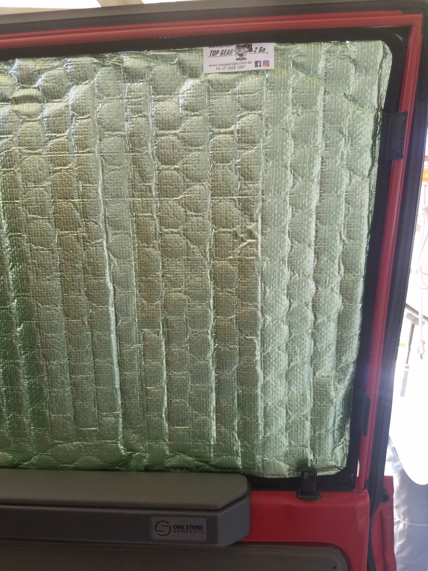

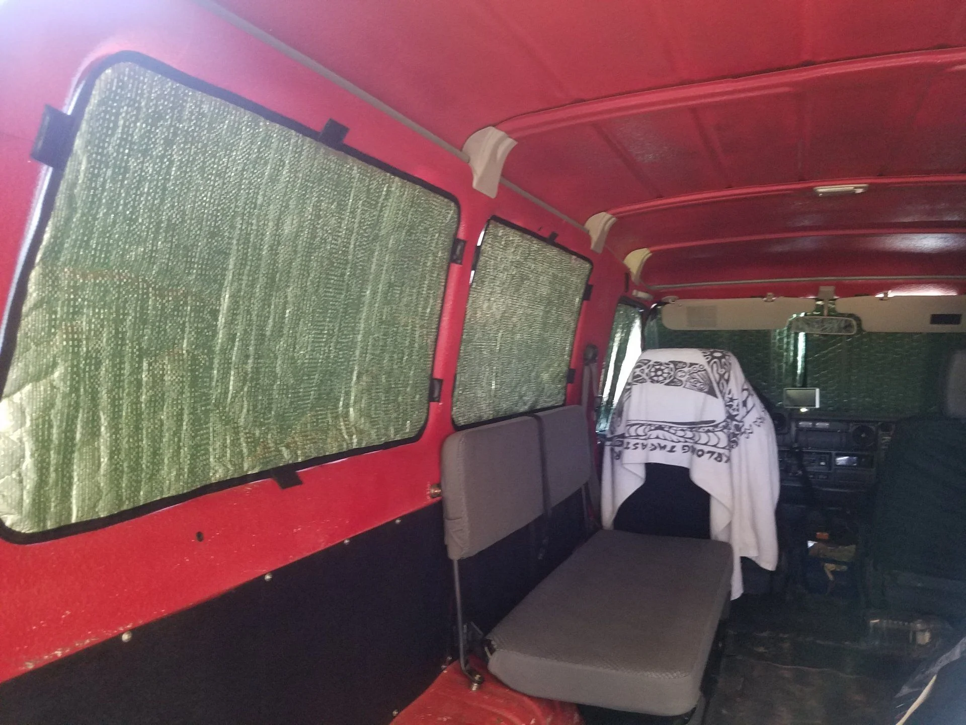

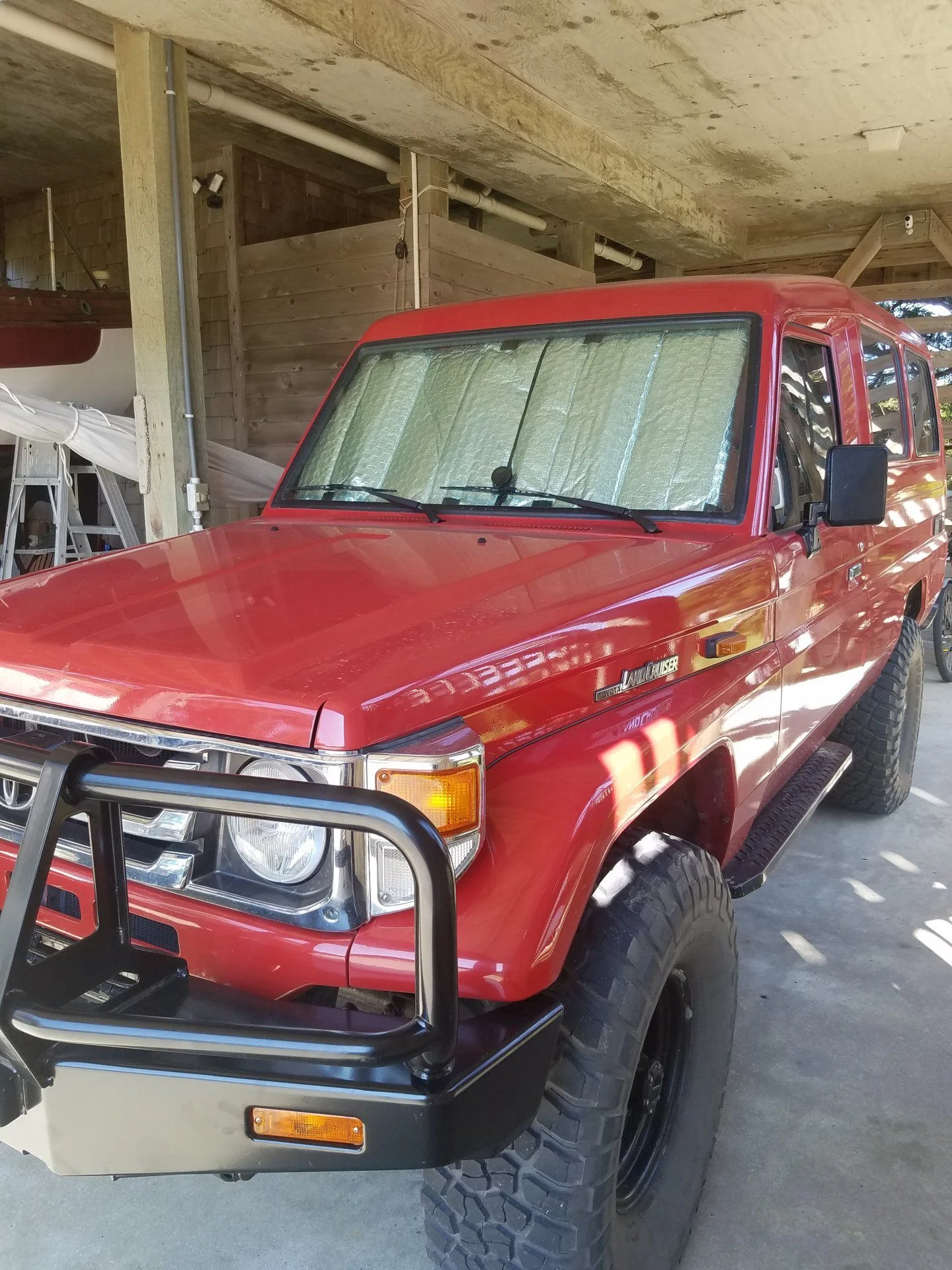

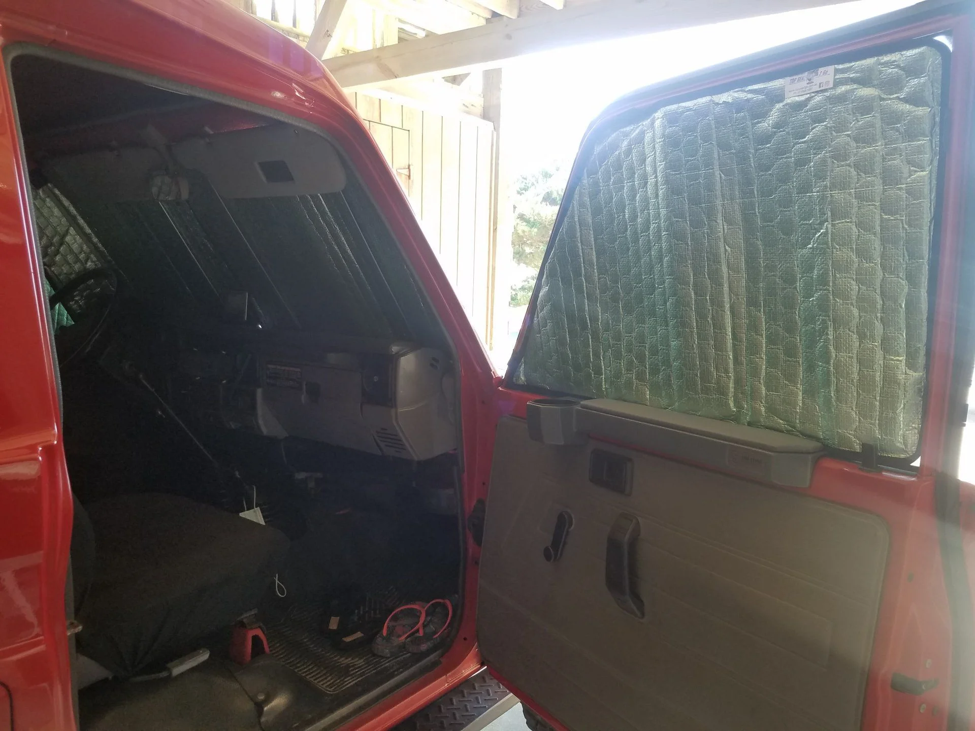

Some time ago @umpqua made a post about a nice set of sun shades he had received from Topgear2go in Australia. He spoke highly of them and I placed an order for a full set of sun shades, magnetic bug screens for all opening windows, and a 3 piece bug curtain for the back. Doug at topgear2go.com.au was a pleasure to work with and I'm really liking the sun shades. They are held in place with magnets and are very quick to install or remove. Thanks Rodney for pointing me in that direction. You might also see the nice One Stone armrests brought in by @divemedic- Thanks Nic, they are pretty sweet too.
When I was looking around for sunshades for my 77, I looked at their website but they didn't seem to offer anything for the 76 which is the same glass-wise.
Maybe because there is no way for magnets to work on the rear quarter glass sections, (no exposed metal). He seems to make killer sunshades though, love the way they look on your troopy.
Top gear does make a nice product and Doug is super easy to work with. Glad you like them!

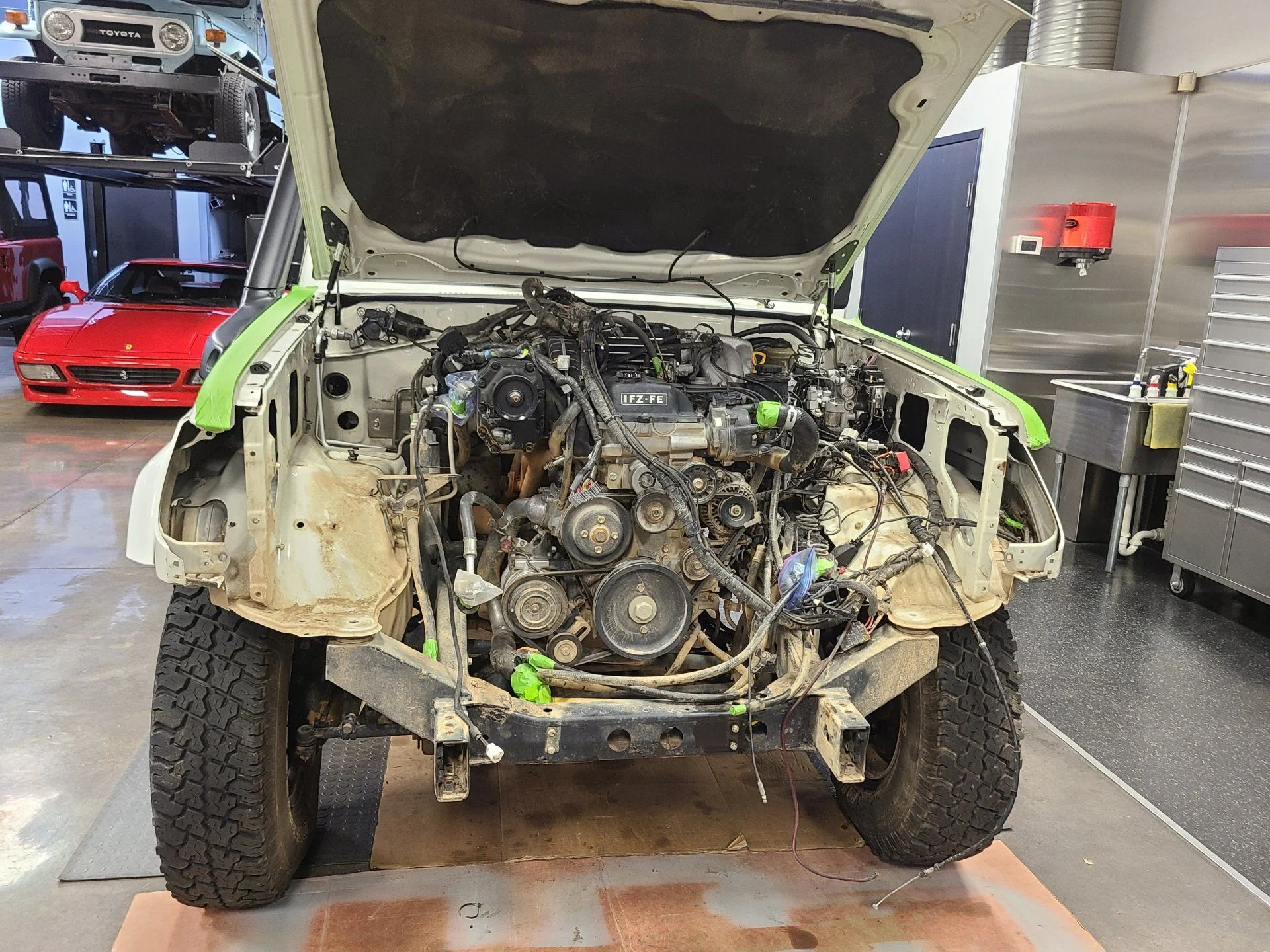

Probably will resurrect my #1 build thread as we take the truck into a new phase of it's life
