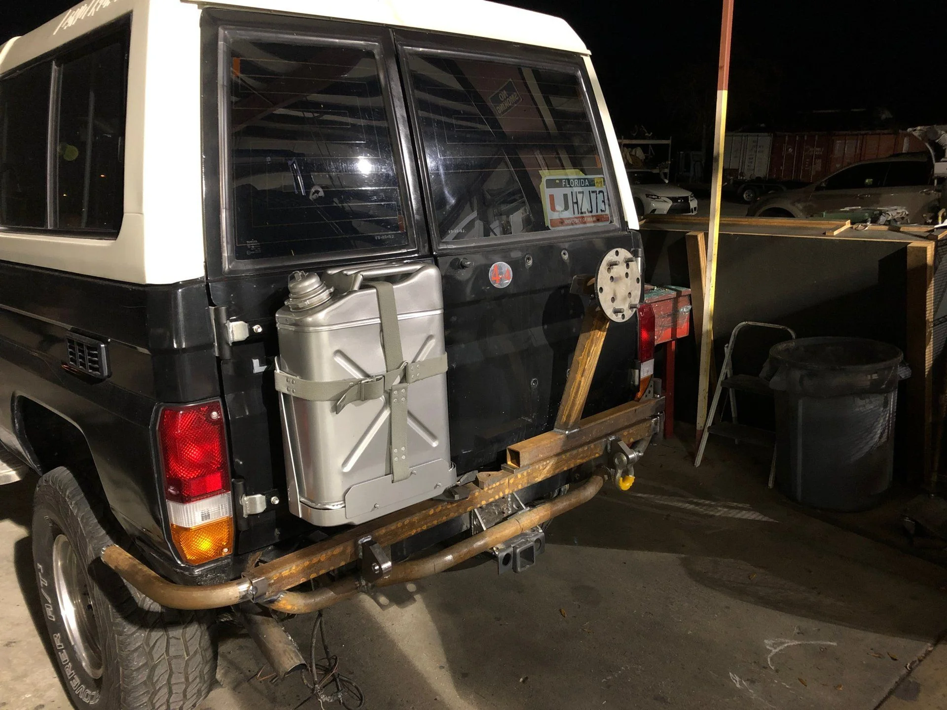

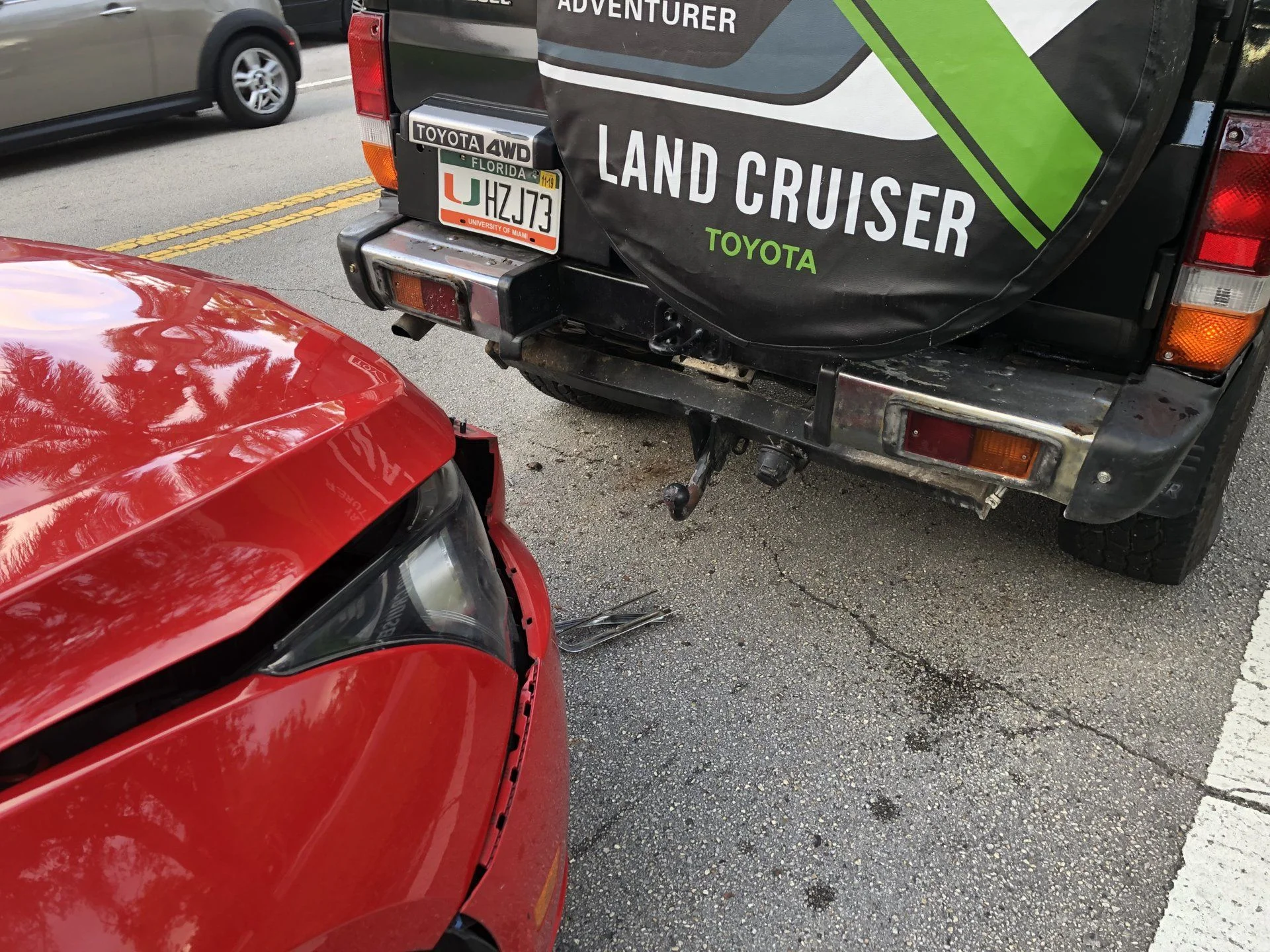

Someone Rear- Ended me and damaged my Tow ball + broke a break line - so of course, it is the perfect excuse to throw some money on the truck.
img_0984-jpeg.1937246

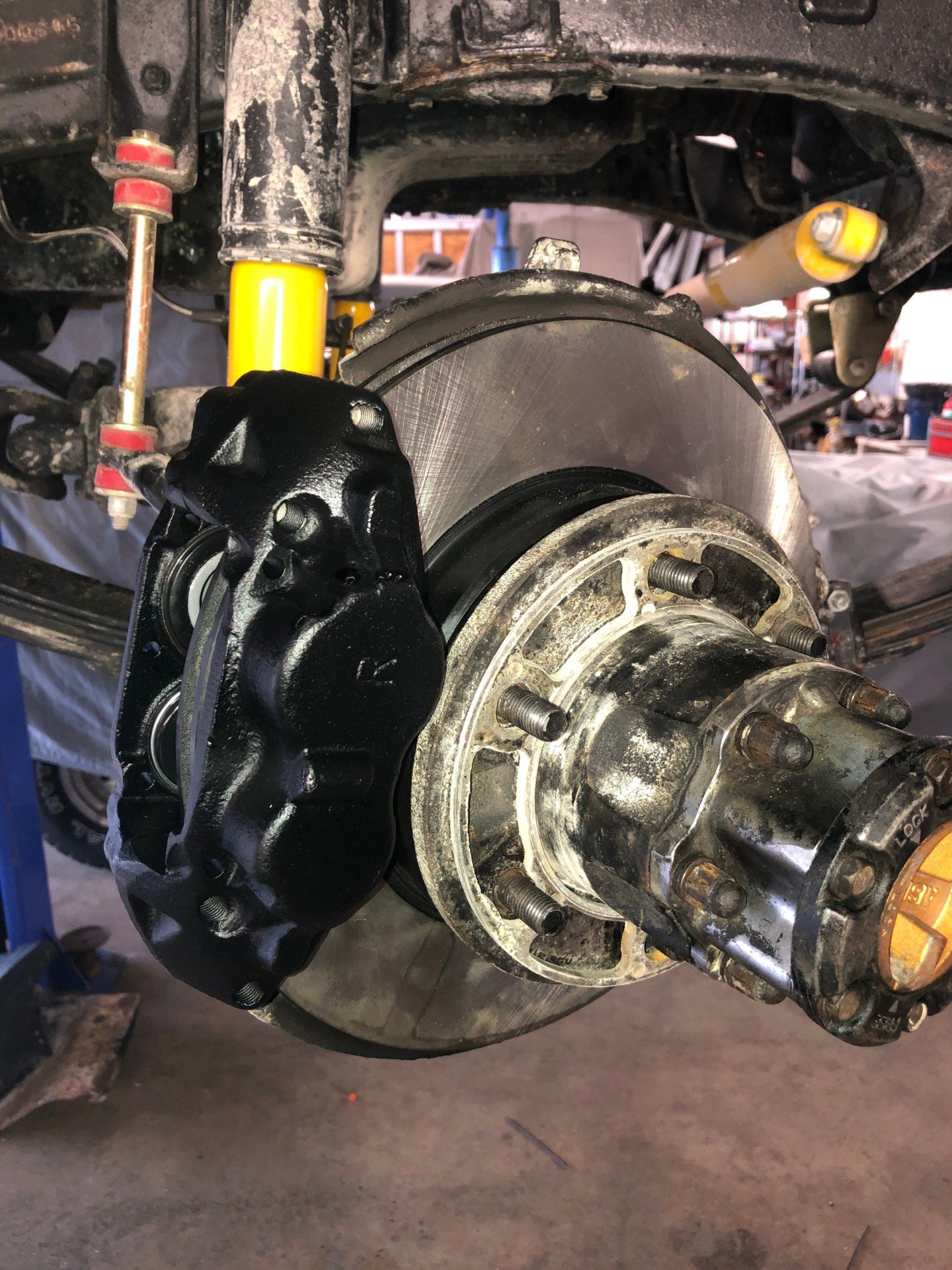

new breaks:

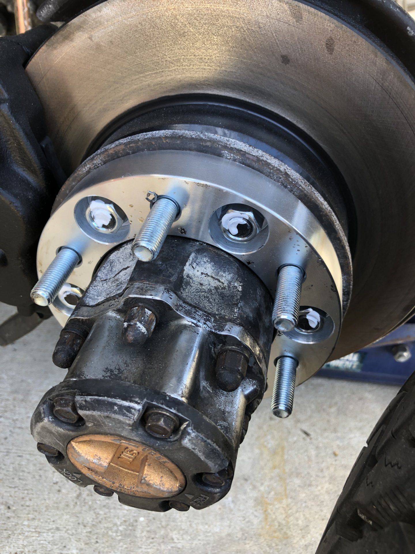

New Spacers:

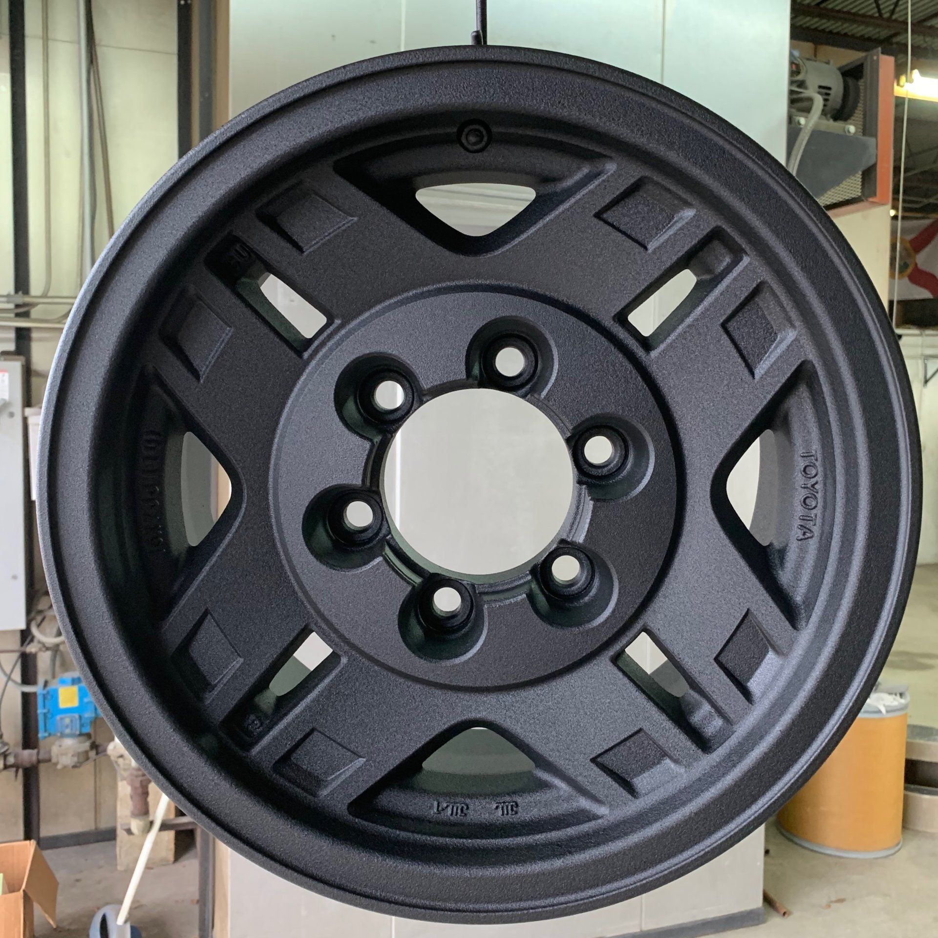

New Rims:

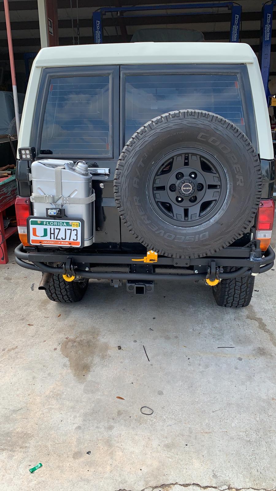

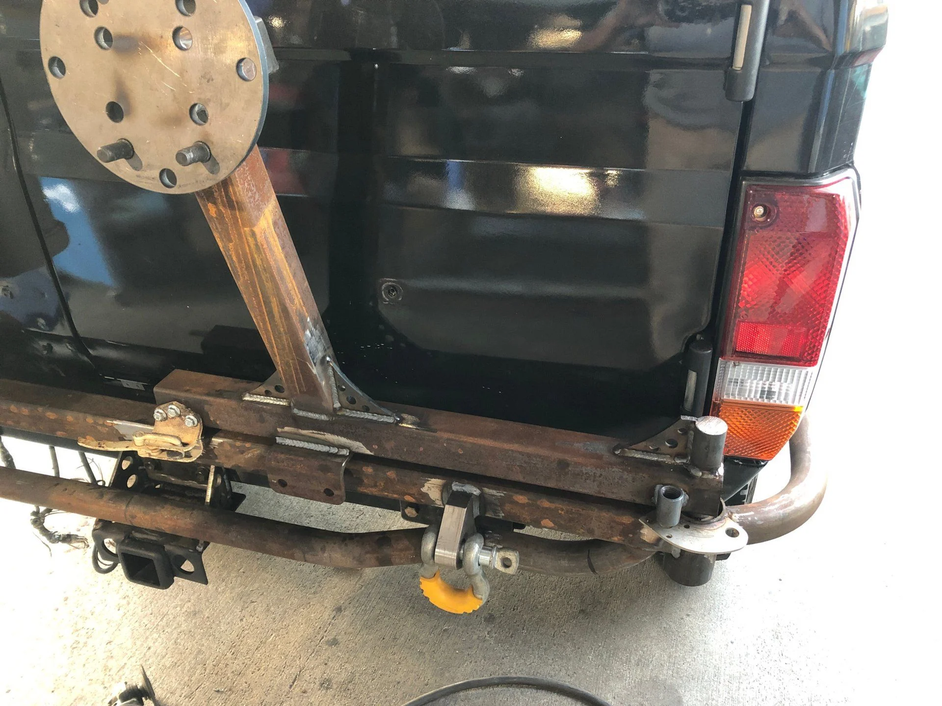

and a complete Butt Lift with a custom bumper and swivel tire bracket + OEM Jerry can holder.
now need to look for an excuse to throw money to the front and get that ARB bumper with the side bullbars. :)
What rear bumper is that?
the OEM European Spec bumper - ity was missing a couple of parts.

I meant the one you replaced it with.
its a custom one_ i really wanted the weight of the tire to rest on the chassis, trying not to cover the updated tail lights and making sure the tow hitch was in a good position_ trying to keep it simple with tubular design_ the shop did a great job.

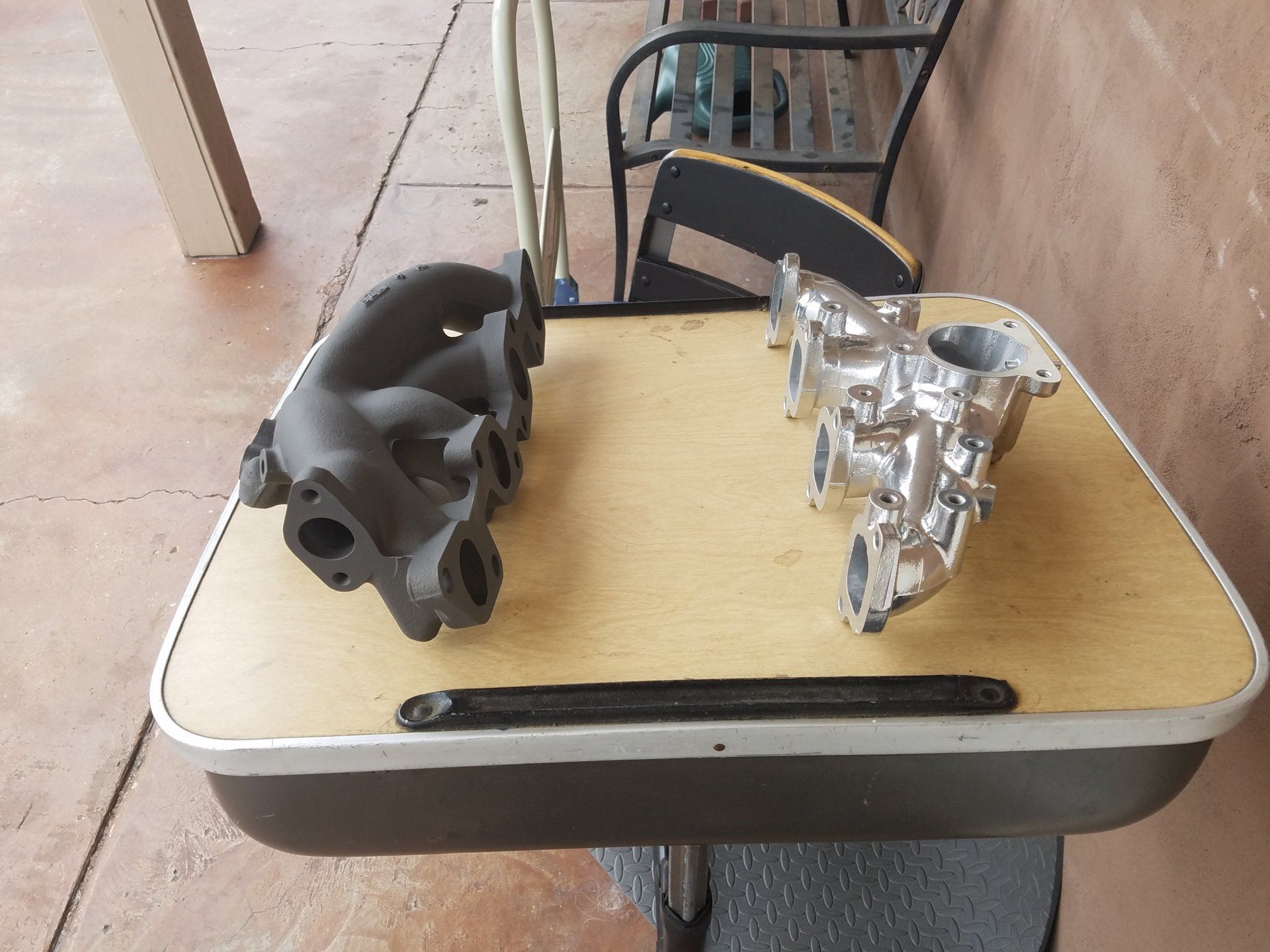

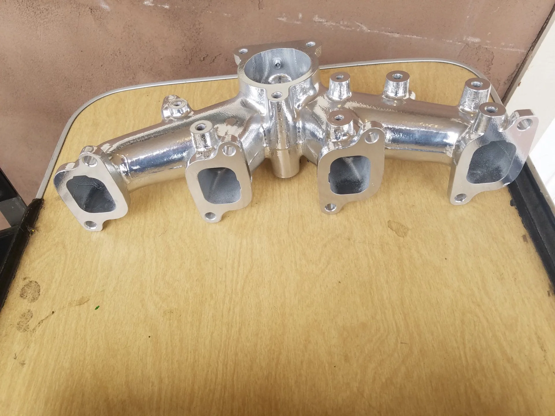

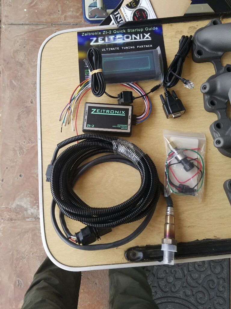

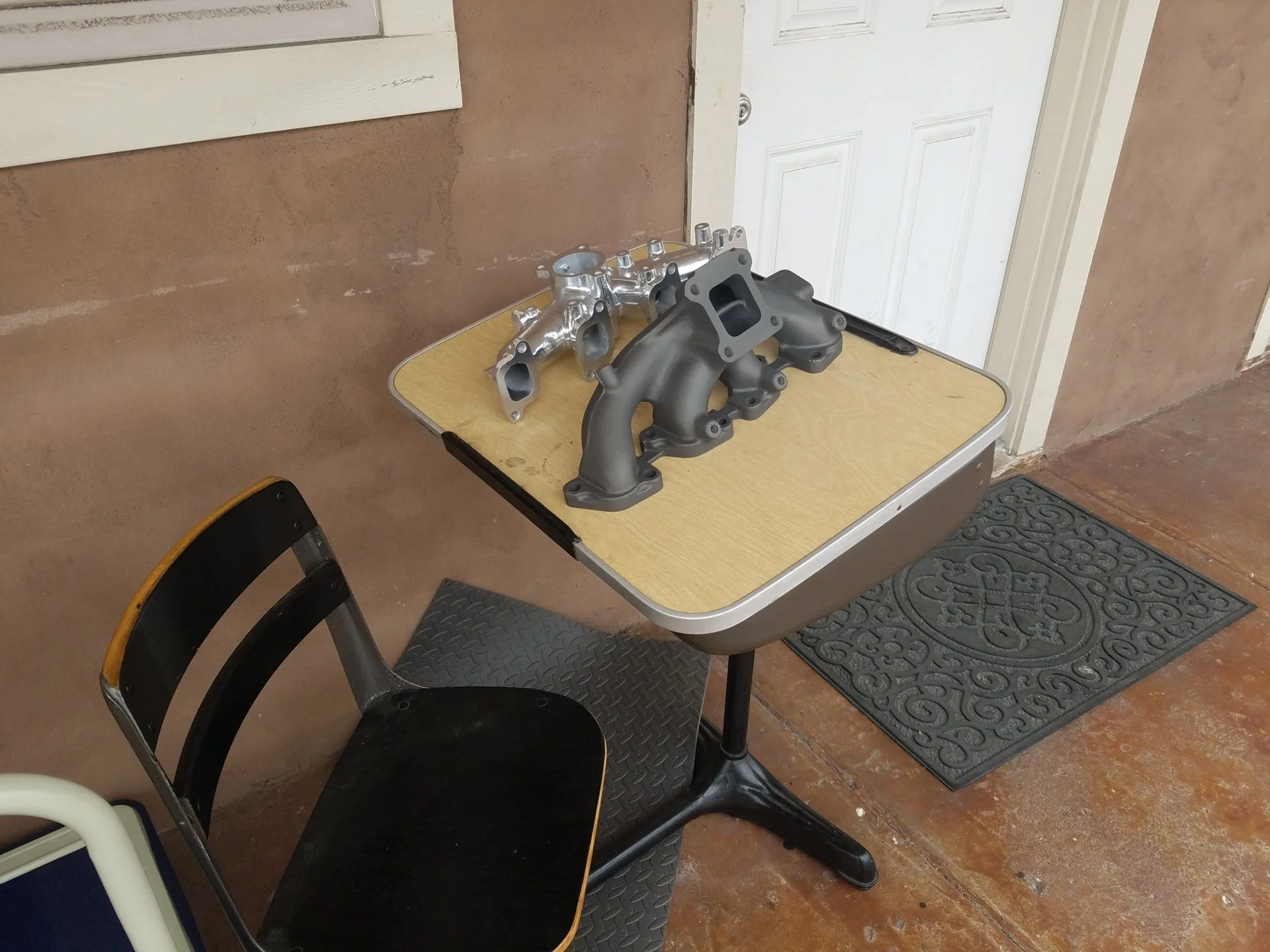

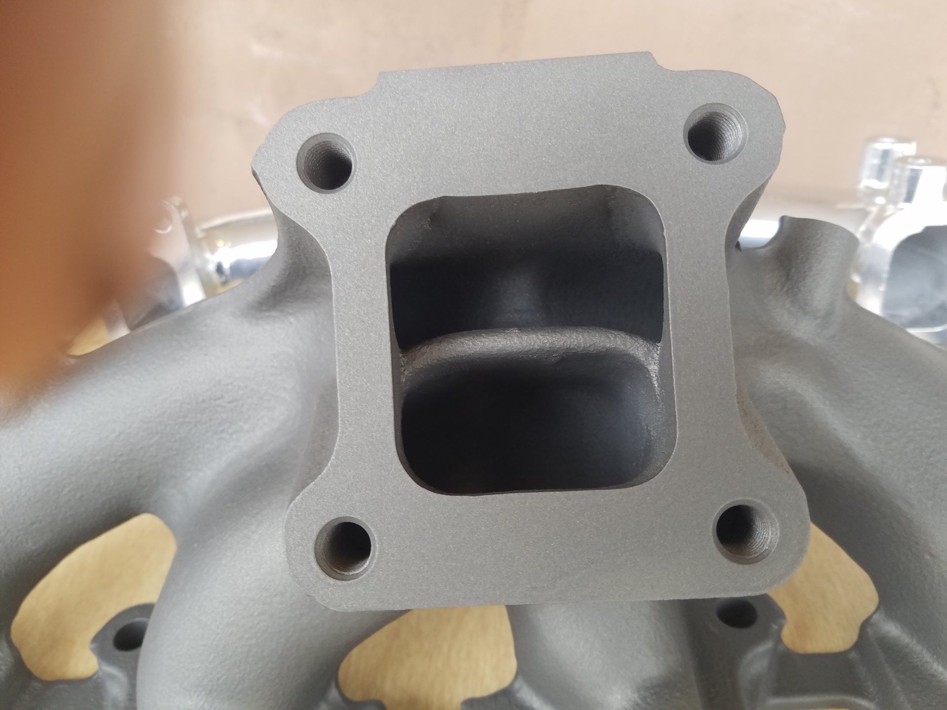

Just picked up my internally & externally ceramic coated intake & exhaust manifolds.. CAPS in Fresno. Had my turbo & top mount intercooler.. dropped them off with Don.. ceramic coating the exhaust section of the turbo (air side came coated).. and applying a race proven heat transfer coating to the intercooler. I would have dropped of the head to coat as well but I would of had to disassemble the built up head.. oh well.... also got my Zietronix programmable ems with sensors.. with their software & my laptop I will be able to data log & change all Factory fuel & timing advance settings:) with a bosch o2 sensor, boost sensor & egt sensor.

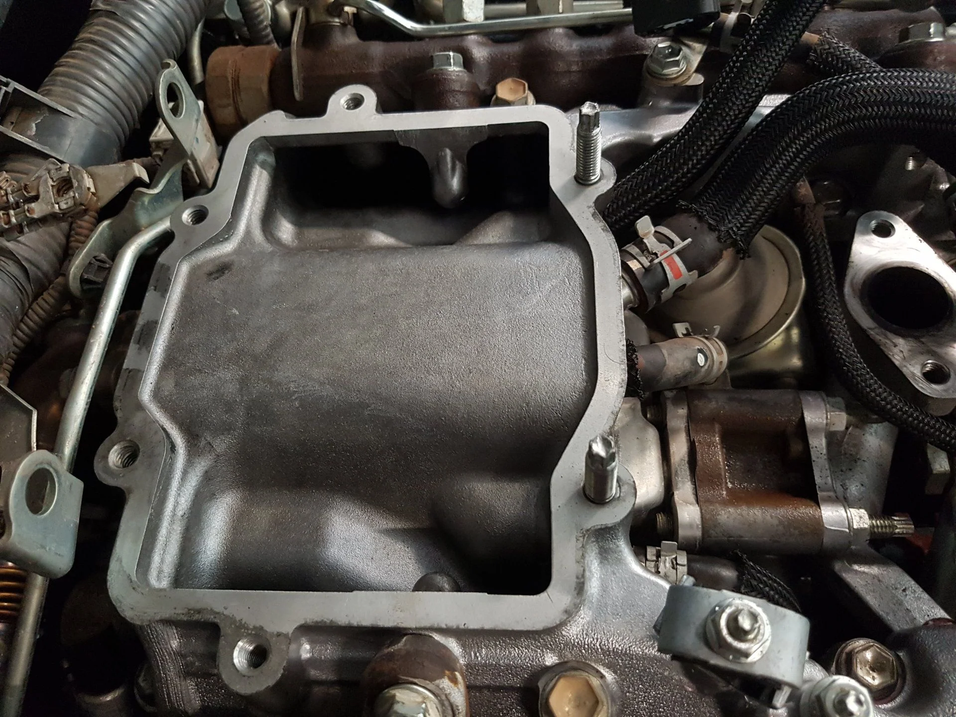

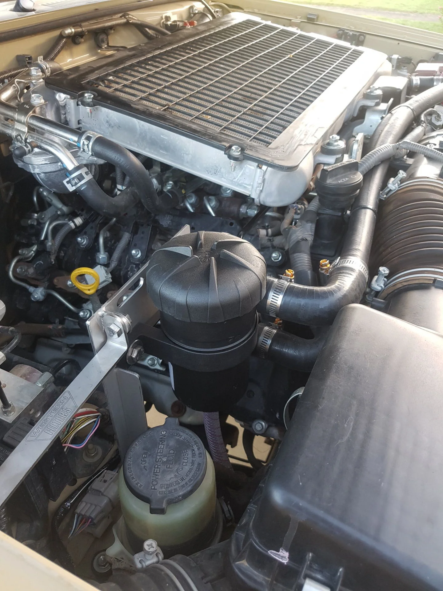

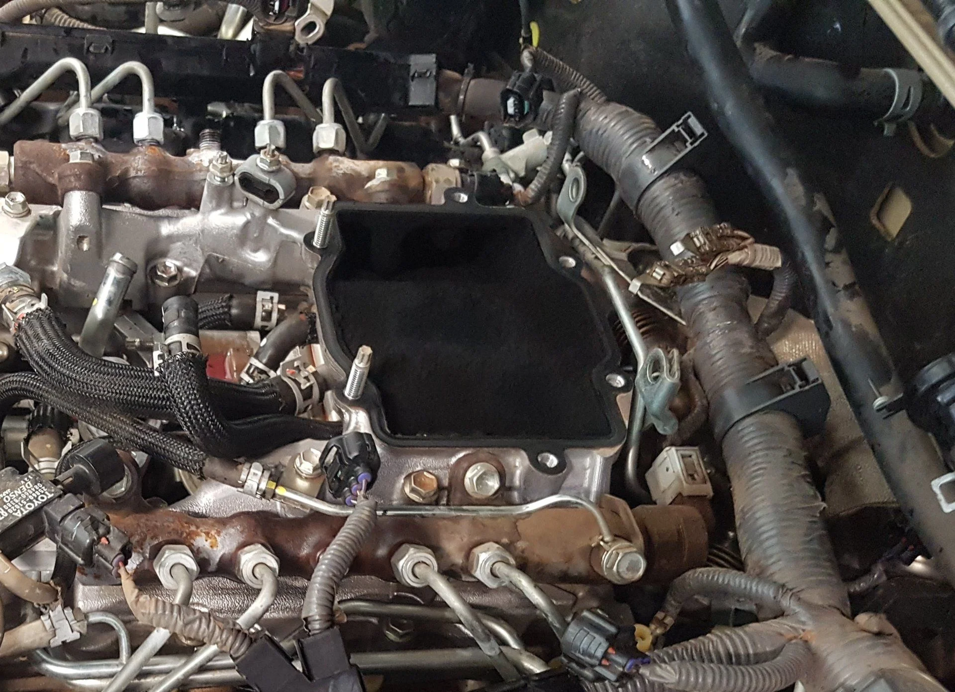

Pulled the intake to do a manifold clean. The amount of filthy black goo was unbelievable. This engine has only done 65k kms.
All nice and clean. The job took about 7hrs all up. I found a mixture of oven cleaner and degreaser to work best. Everything was pulled down to the heads.
Egr was blocked via blanking plate. Throttle body butterflies removed and a catch can also fitted to remove all oil vapour from the intake tract.
I later found that blocking the egr not only caused 3 warning lights, but also caused the engine to derate. Code was P0400 Exhaust Gas Recirculation Flow Malfunction.
Out came the blanking plate until I can get it turned off via ecu tune.

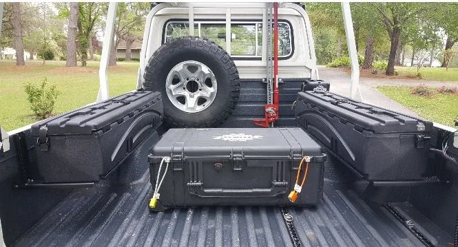

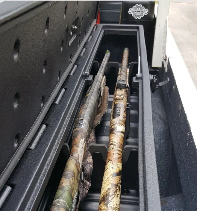

Since I plan to leave my rear bed open and unsecured for the time being I wanted some lockable storage. I also wanted storage for hunting equipment including guns and this design fit both roles. When not in use the gun rack portion is easily removable leaving a sizable storage cavity. I also wanted to leave the bulk of the rear floor space open and this design accomplished that.

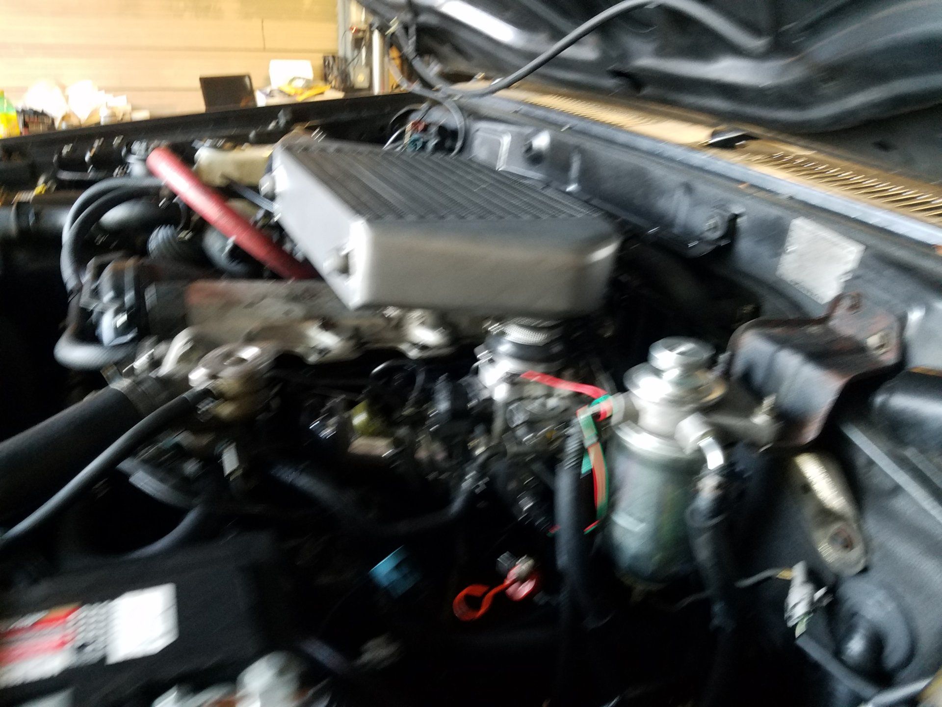

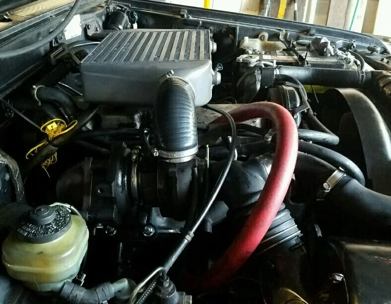

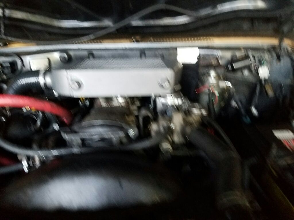

forgot to post pics of the thermal transfer top mount intercooler
& the turbo (had both the intake & exhaust housings ceramic coated

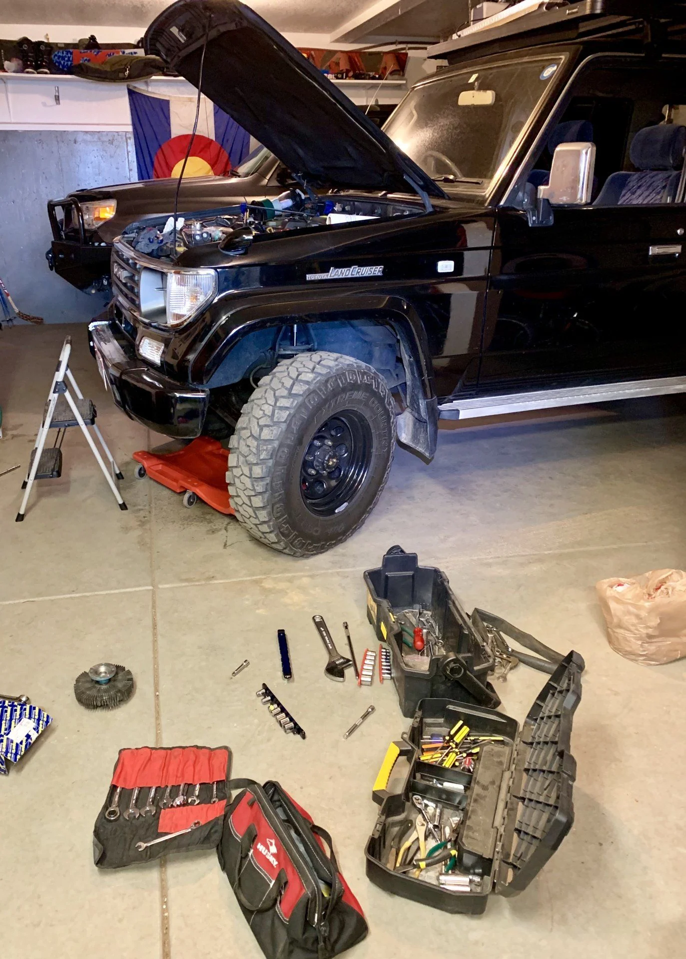

Pics of phase 2 mech mods..
tomorrow 3" exhaust & new ecm system hook up.. Friday intercooler support brackets & hood scoop.. Saturday test.. Sunday pack & Monday moving to Denver.. whoopee..

Sounds like we may need to meet up! I would love to talk to you about your Intercooler.
