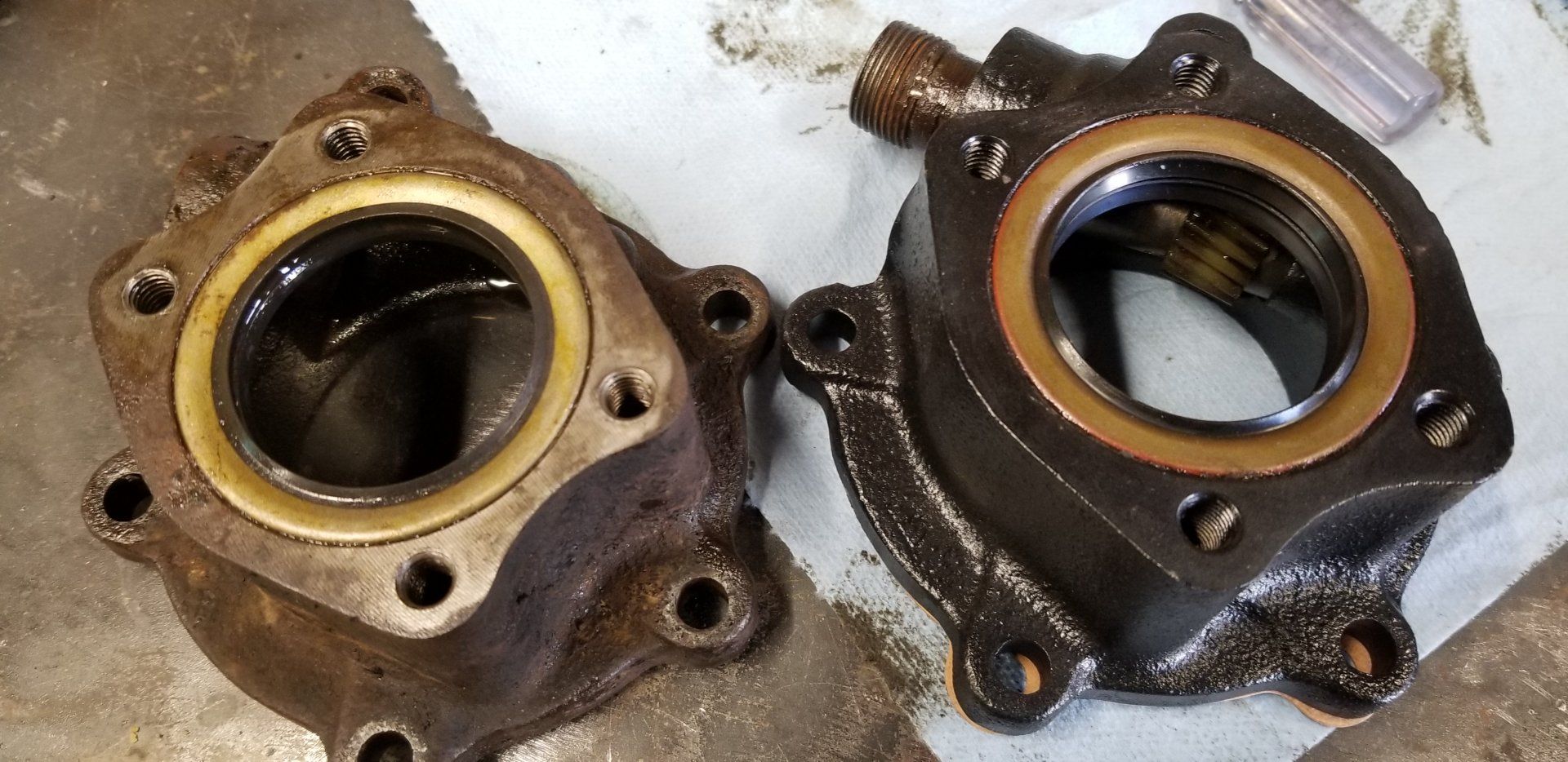

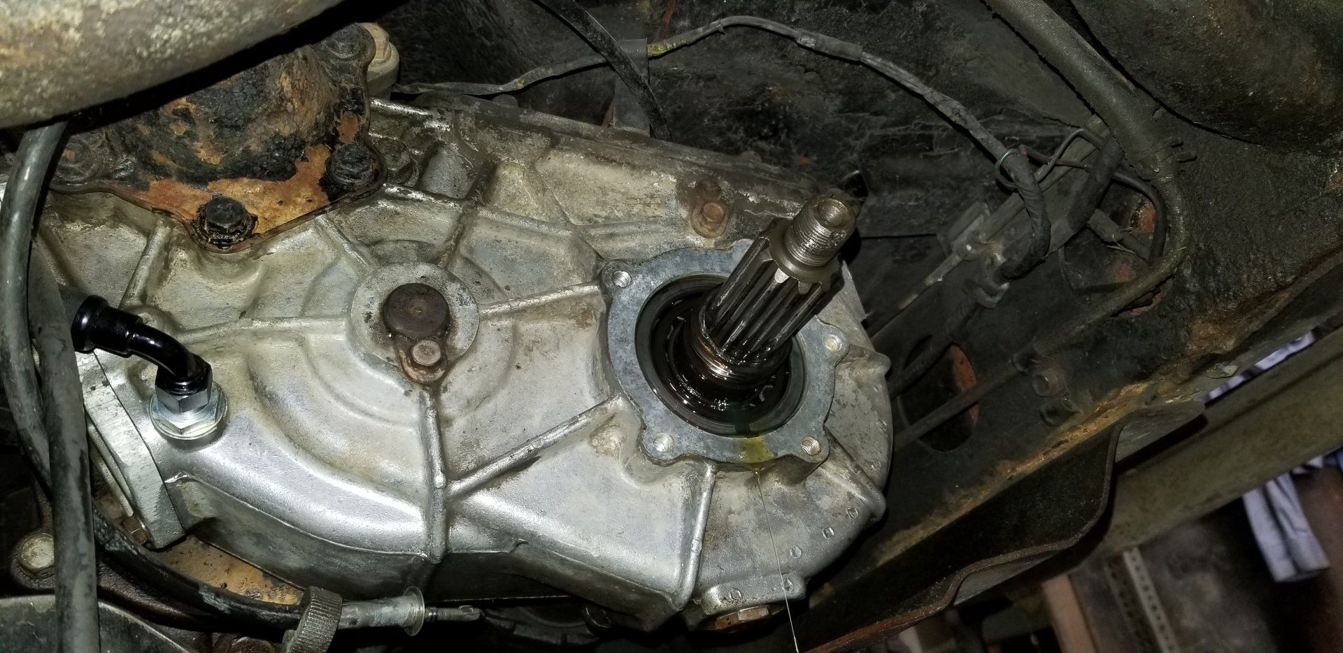

An easy one this morning....hoping to stopping its bed wetting.
Double seal bearing retainer from valley hybrids.
Last time I stopped at Ryan's shop in VA (OTRAMM) he was machining a housing for double seals. He had made a fixture to which he bolted the housing and installed in his three jaw chuck the housing was automatically centered for easy accurate boring. Cool!!!!!

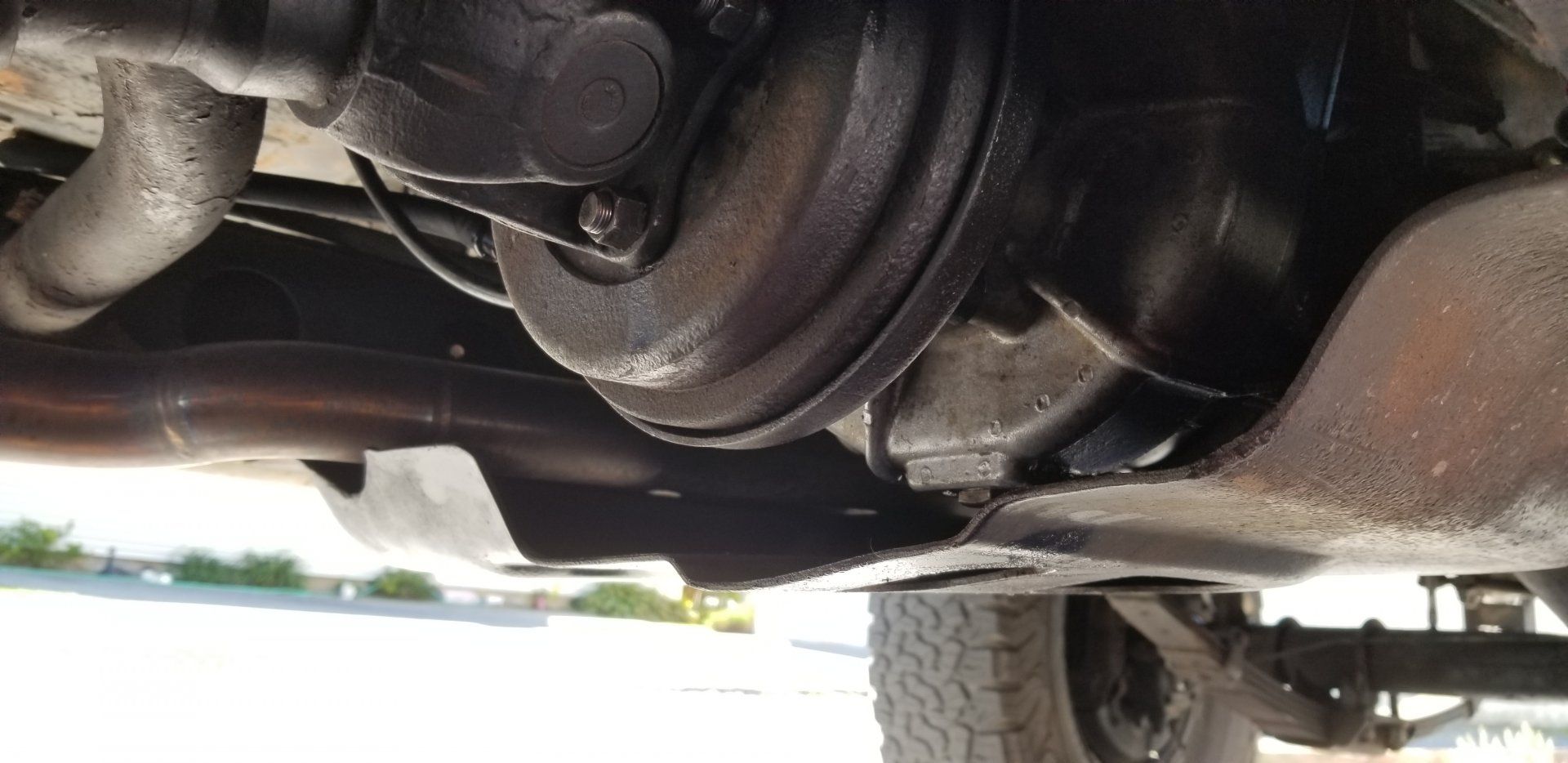

After about 50 miles this is looking quite promising .
So I’ve never (knock on wood) had the drum brake seal on my setup leak with a single seal so far. With a potential Orion build coming up - What are your thoughts on doing the double seal mod if there’s no leak with a single seal? Naturally it’s insurance but I’ve also heard the lack of lubrication at the outer seal accelerates it’s demise and starts grooving the drum brake spoke it rides on faster.
I have no experience either way just curious if you’ve heard the same and what your take is on it.
if the single isnt leaking, i wouldn't mess with it.
the double isnt really a double seal, even though it has two seals in it, it just gives you a new single seal further in, on a virgin portion of the drum.

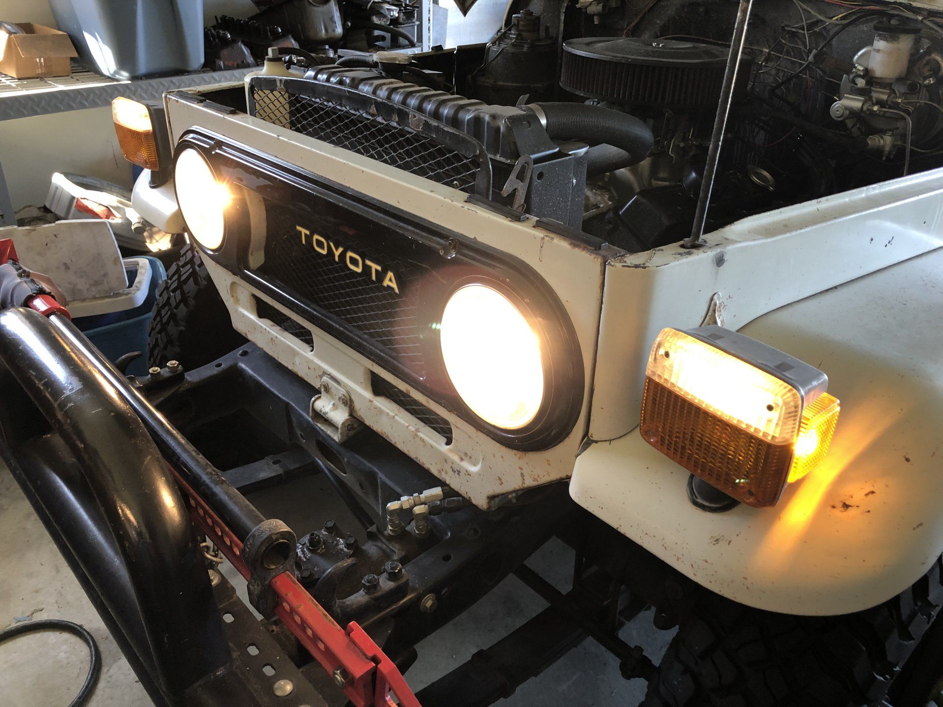

Way less exciting than @Cass007 - it appears I selected the appropriate headlight relays!
So now I have working LED dash lights, a functional speedometer/odometer, and headlights again.
Also finally got back to getting the second fender flare shaped and tacked together. Now they’re bolted together to (hopefully) keep them from warping when I lay down the final welds.

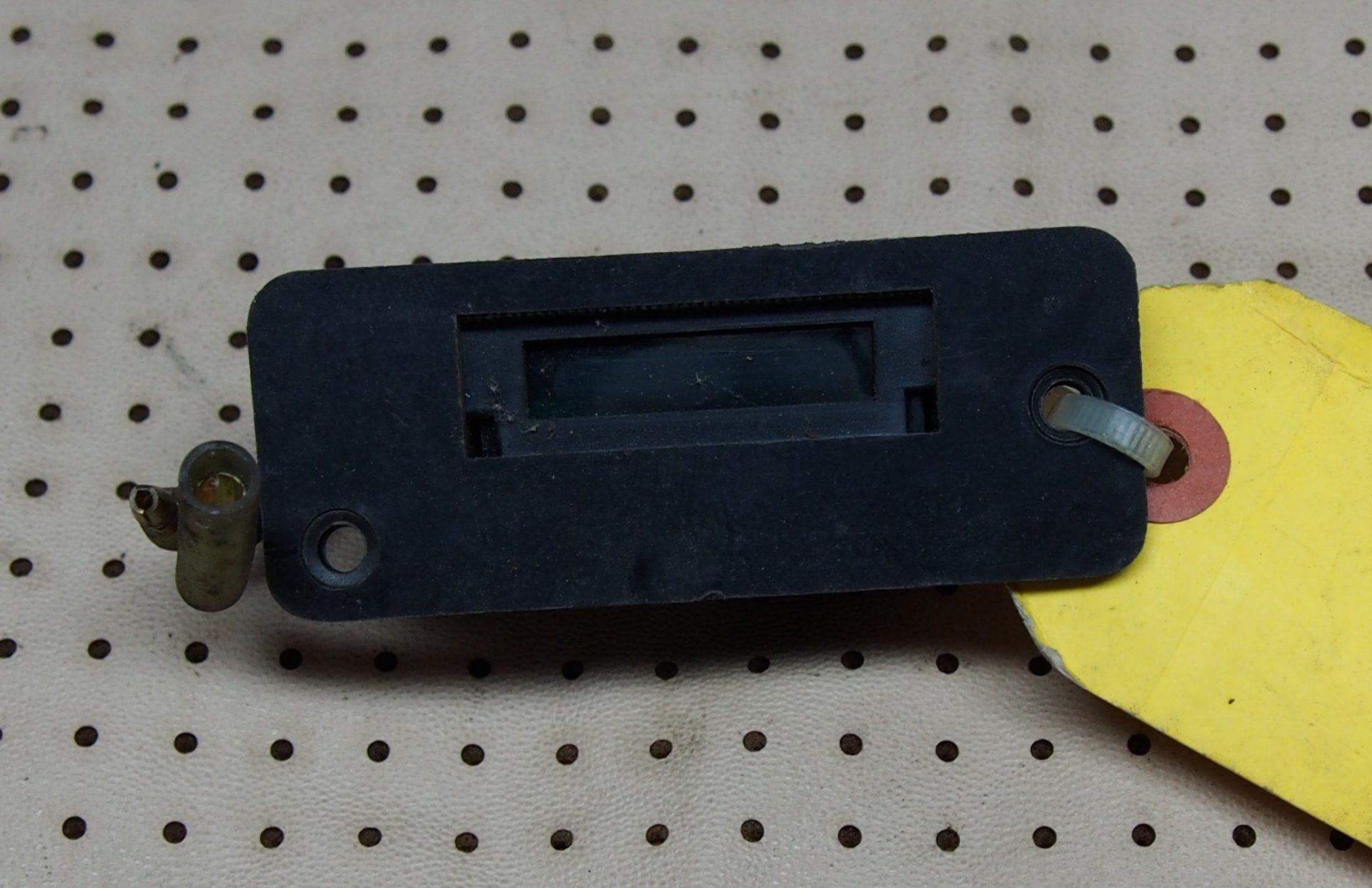

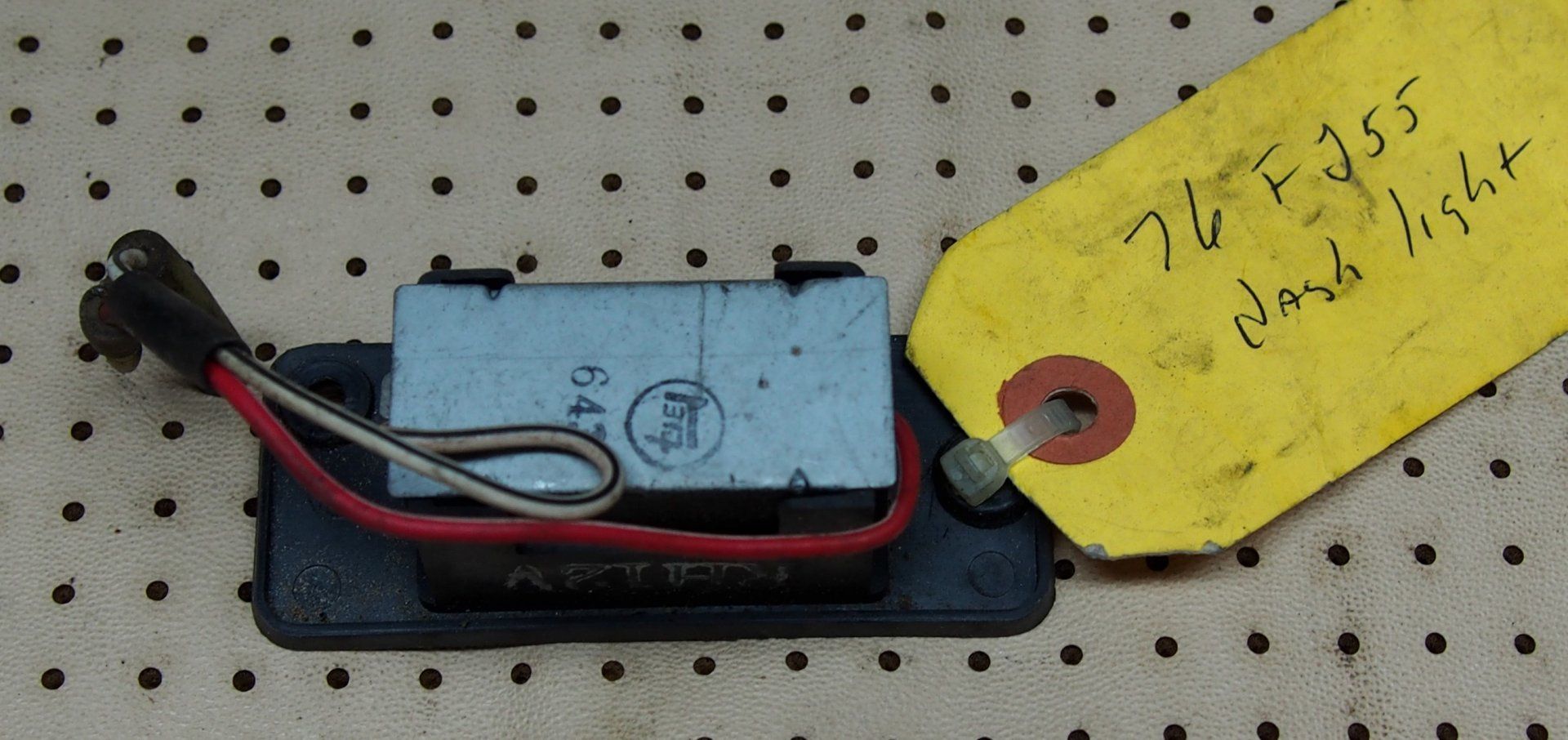

Rick will this work for you? If so send me your address and I'll mail it to you. View attachment 2441713View attachment 2441714
Looks pretty close - any chance you have the little triangular bracket it would mount on? Not sure if the FJ55 it came out of would have it or if it just mounted directly to the dash. I’m sure I could fashion up a bracket. The “stock” ship sailed on this truck a long time ago.
Out of curiosity - how does one replace the bulb in something like that?

now replace almost every other light with an LED as well.
Is there an advantage? Just longer lasting? The dash lights were super dim but I feel like the exterior lights aren’t as much of a problem. The headlights are already converted to H4’s which was a huge improvement over the super dim sealed beams.
less load on an old harness.
Much improved - now that I see it in the dark. The “dimmable” LED’s don’t play that nicely with the dimmer switch (basically have two settings - bright across 90% of the dimmer switch throw, less bright in the last 10% then off. But really I’d run these pretty much full bright all the time anyway.
