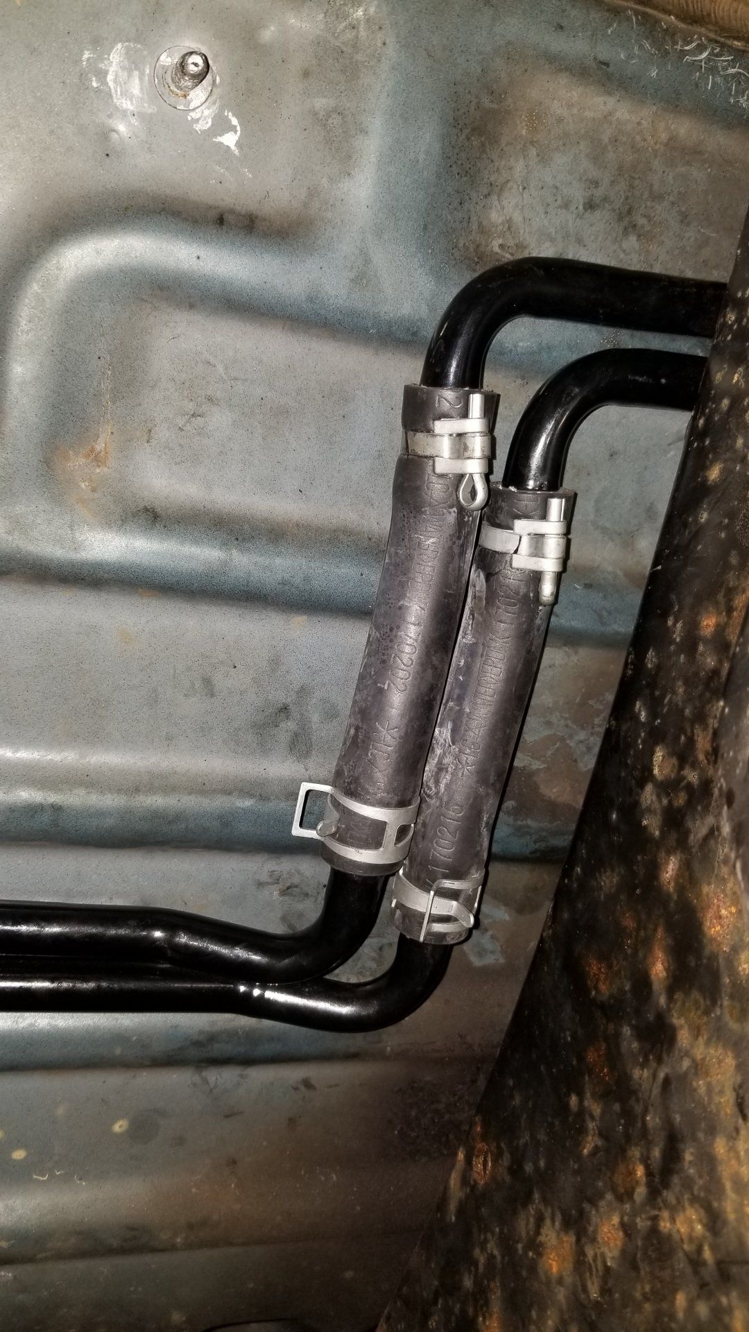

Brand new rear heater lines cut so I could replace them w/o dropping the trans. Fingers crossed this works. Cut them right at the first straight part. New clamps and nuts all around. Yes, I cleaned up the metal after the cut.
New rear line into the floor blower unit
Stock join point between the front and rear hard lines.
Where the cut was to join the top line.

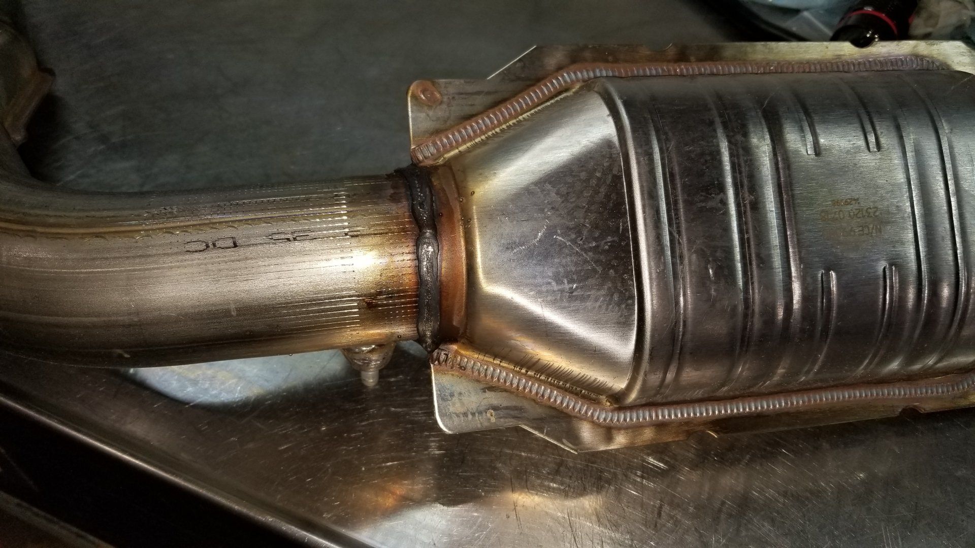

Was prepping the exhaust down pipe and went to swap studs via the recommendation of @JeepinPete and hit a snag, they are welded in. I'm just going to anti-seize the crap out of them and let an exhaust shop deal with replacing the studs as needed. I don't want to get bogged down again.

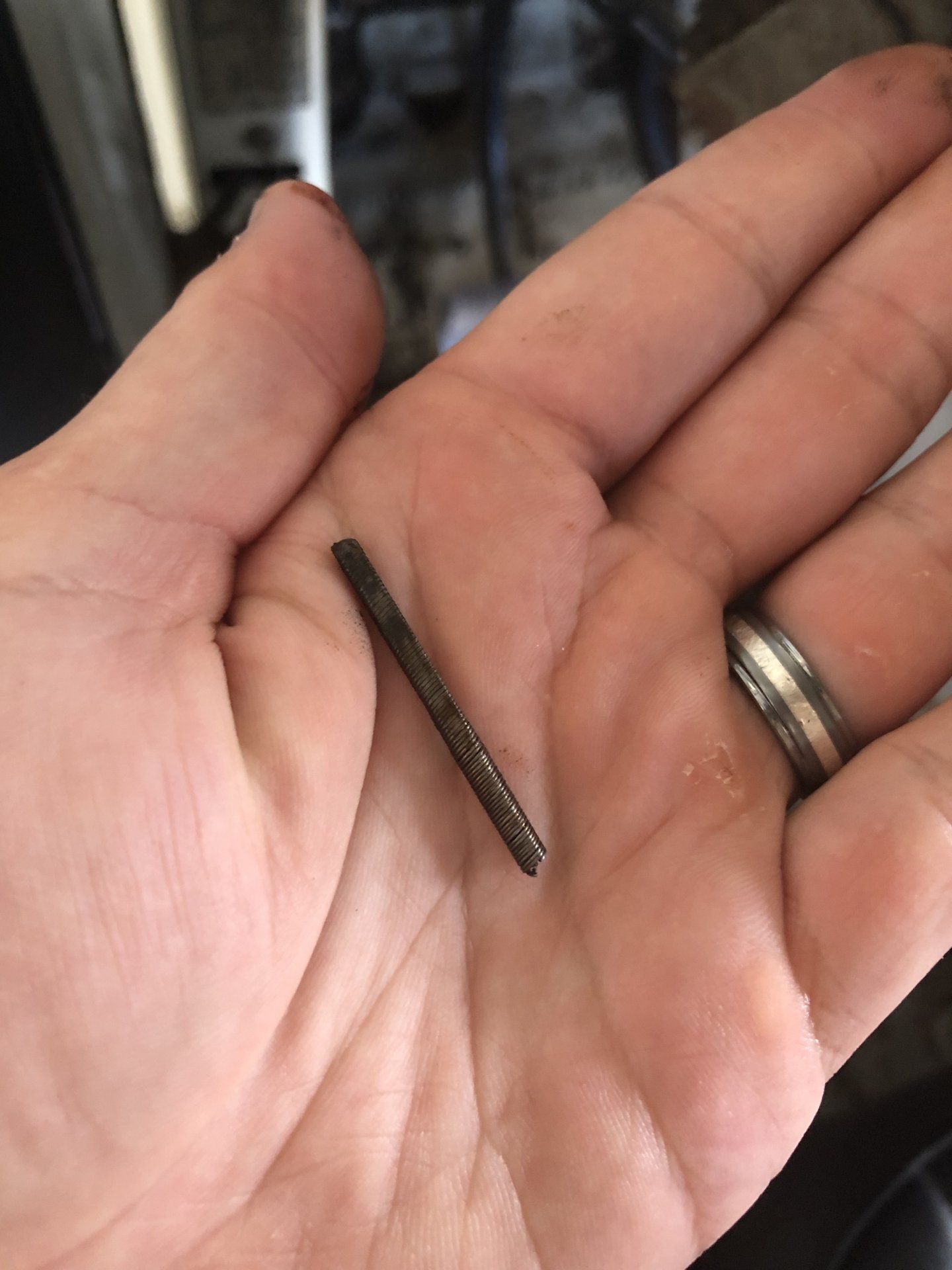

Figured out why the speedometer stopped working.
The trick is going to be routing the new speedometer cable - I’ve got the unique “speed marker” two piece cable setup that Toyota only used for a few years - to control a second odometer which would trigger the EGR light at service intervals.
My understanding is the two-piece cables are no longer available - so I’ll need to convert to a one-piece cable, made slightly more interesting by the fact that nothing is where it should be due to the V8 swap.
That said, the transfercase is actually slightly forward of where it should be - so if anything I should be dealing with some extra slack, which is probably the lesser of two evils.
Anyone have any insight as to how the one piece cables are routed? Do they still come up the passenger side and across the firewall from the transfer case or do they run right up the driver’s side?

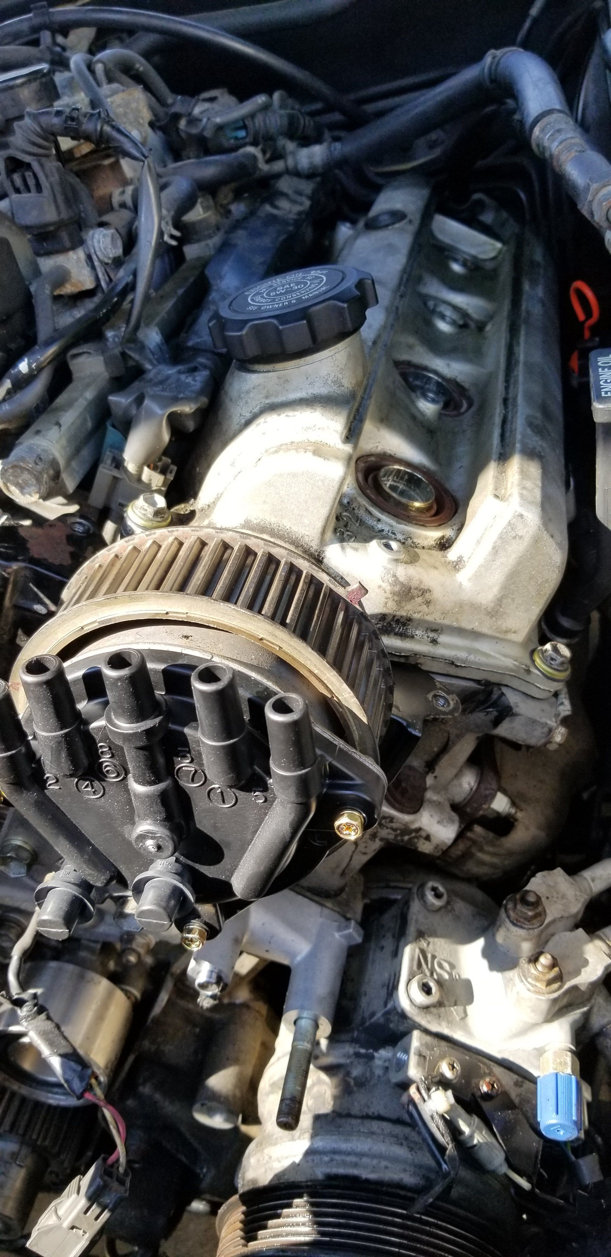

I finally got the 1UZ buttoned up:
I think I have finally fixed all the oil leaks. No new spots on the drive way or where ever I park it. The only thing I have to figure out is the thermostat housing. the Plastic elbow that comes off of it weeps ever so slightly, I'd like to figure out a fix before winter time.

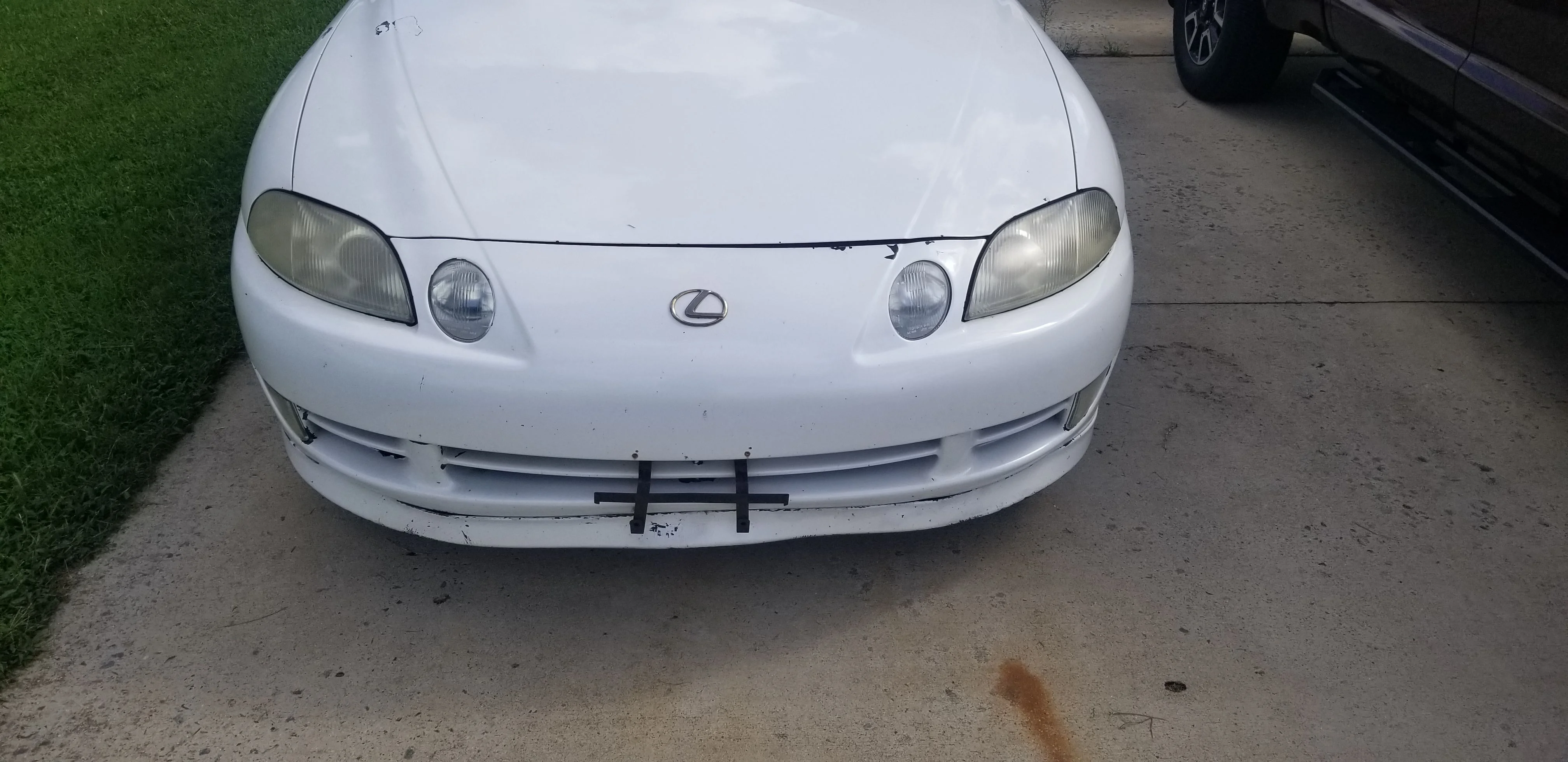

The headlights are installed as well, just need a wet sand and buff and should be good to go:

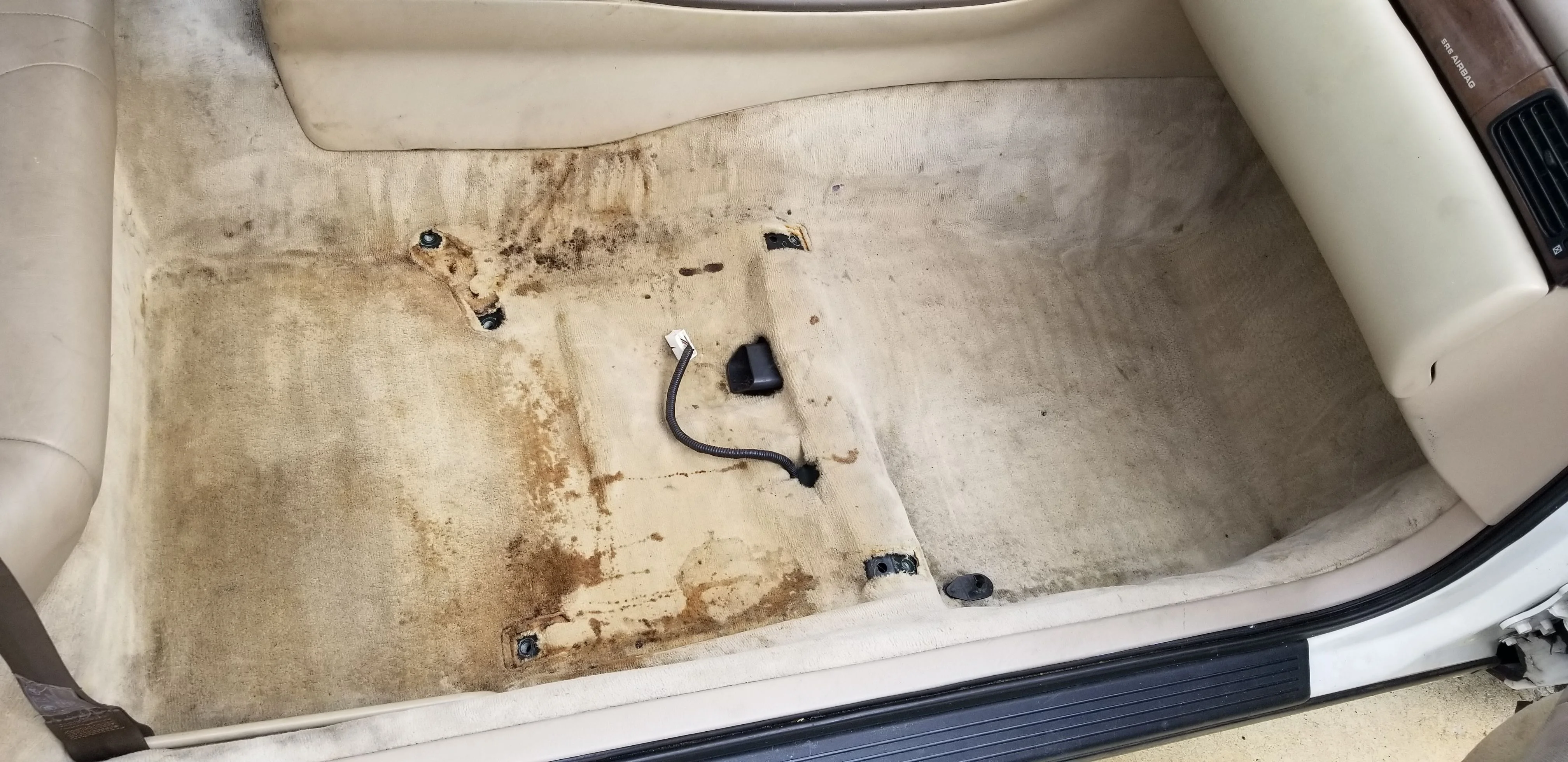

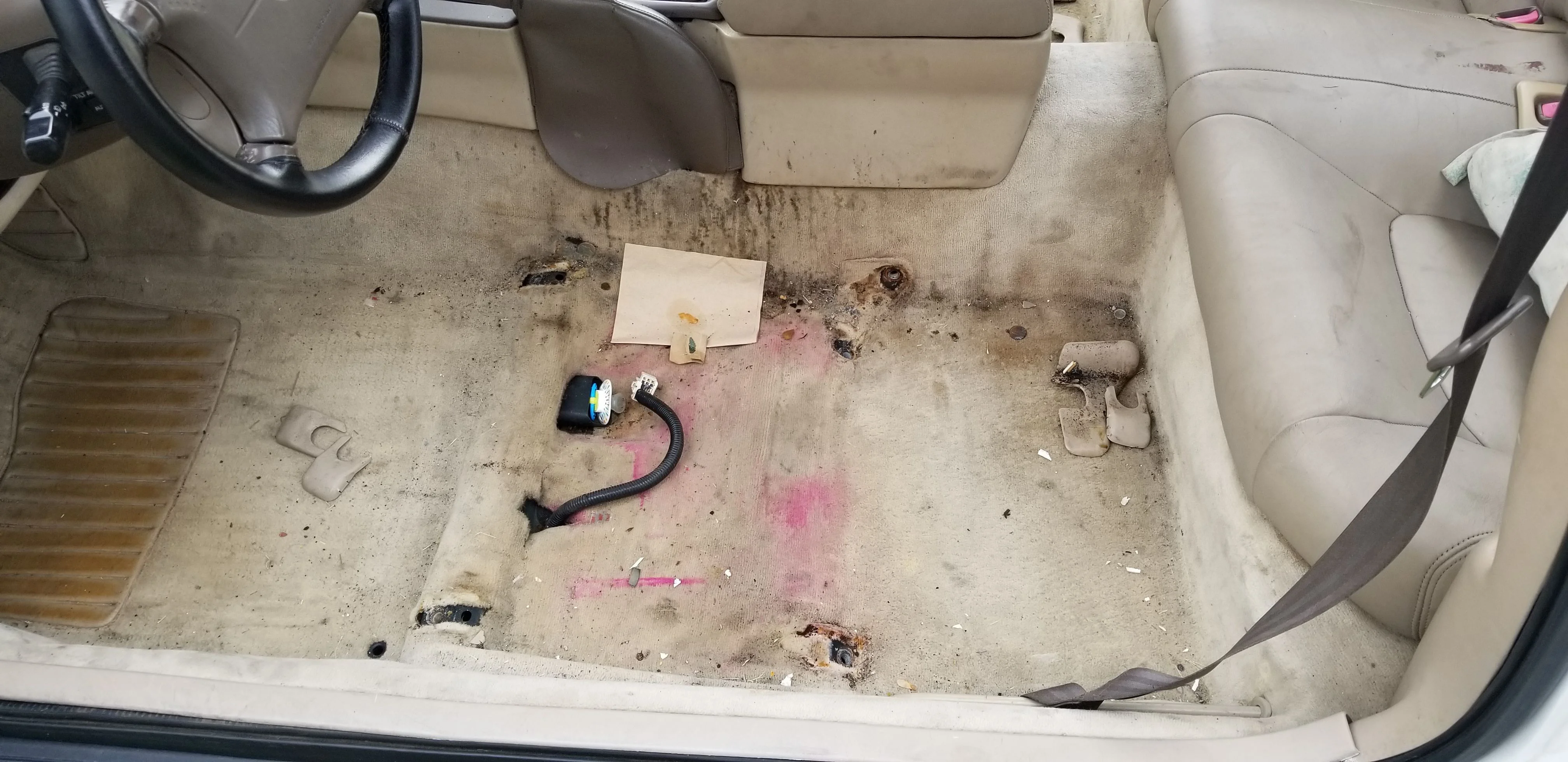

Next was some interior details. I started with removing the driver seat to replace it with the one from the junkyard and ended up removing the passenger side as well to do a little cleaning.
Before:
After:
Not perfect but a heck of a lot better, than before, and the smell has already improved inside, also installed a cabin filter which has helps as well, who knew cabin filter in a 93'

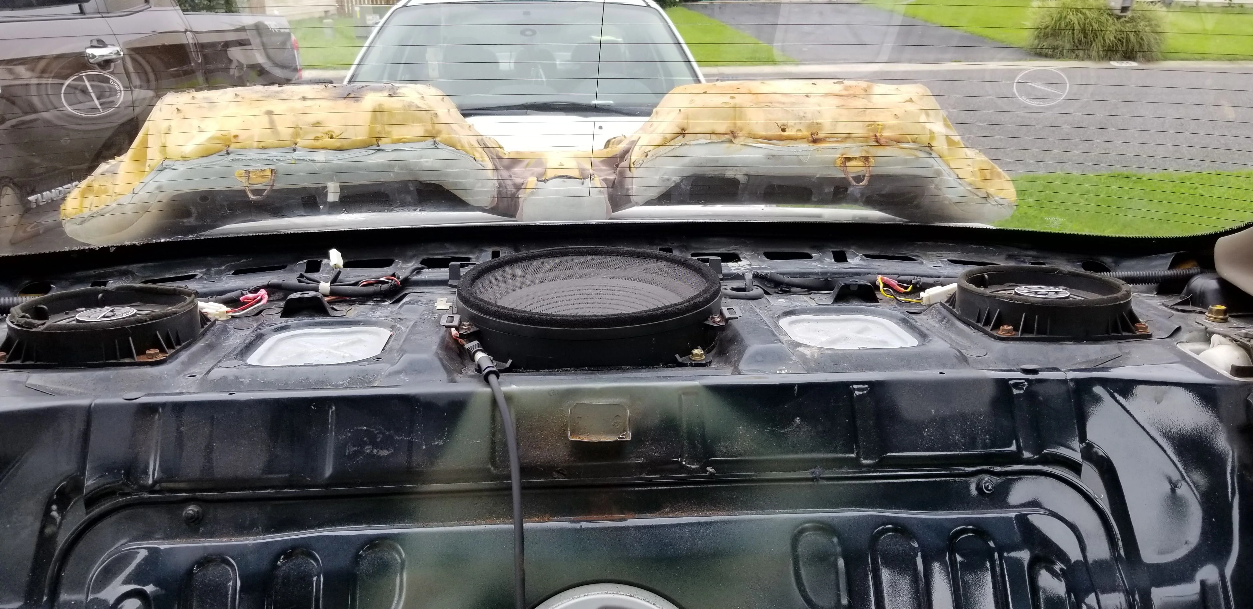

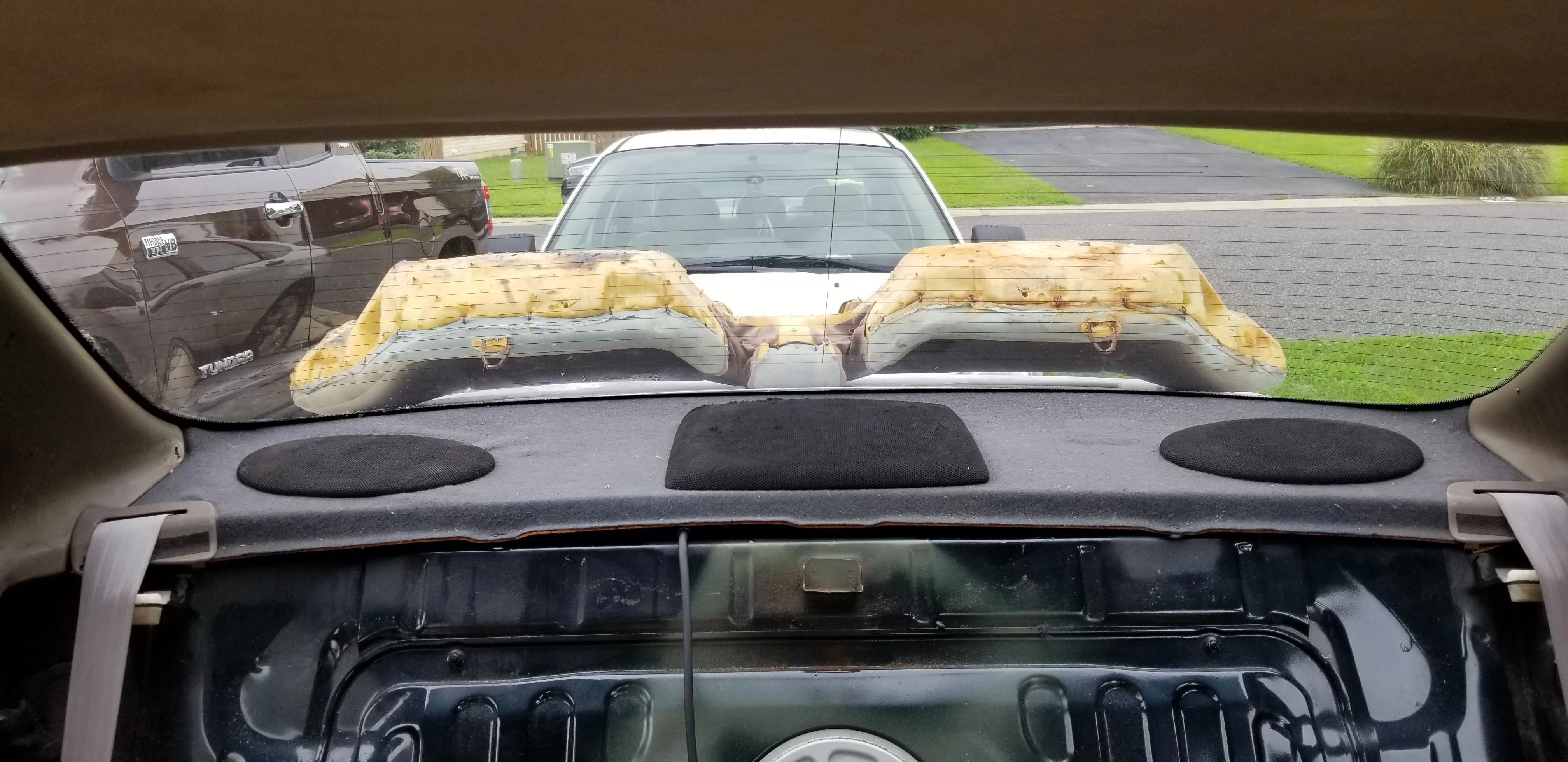

Finally to complete the interior, I installed new speakers and speaker covers on the rear deck lid. The speakers I had installed were just sheet metal screwed in and had also melted from the heat and being exposed, I got nice speakers installed in the facotry pods from the junkyard car along with the cover, clean and has decent sound again:

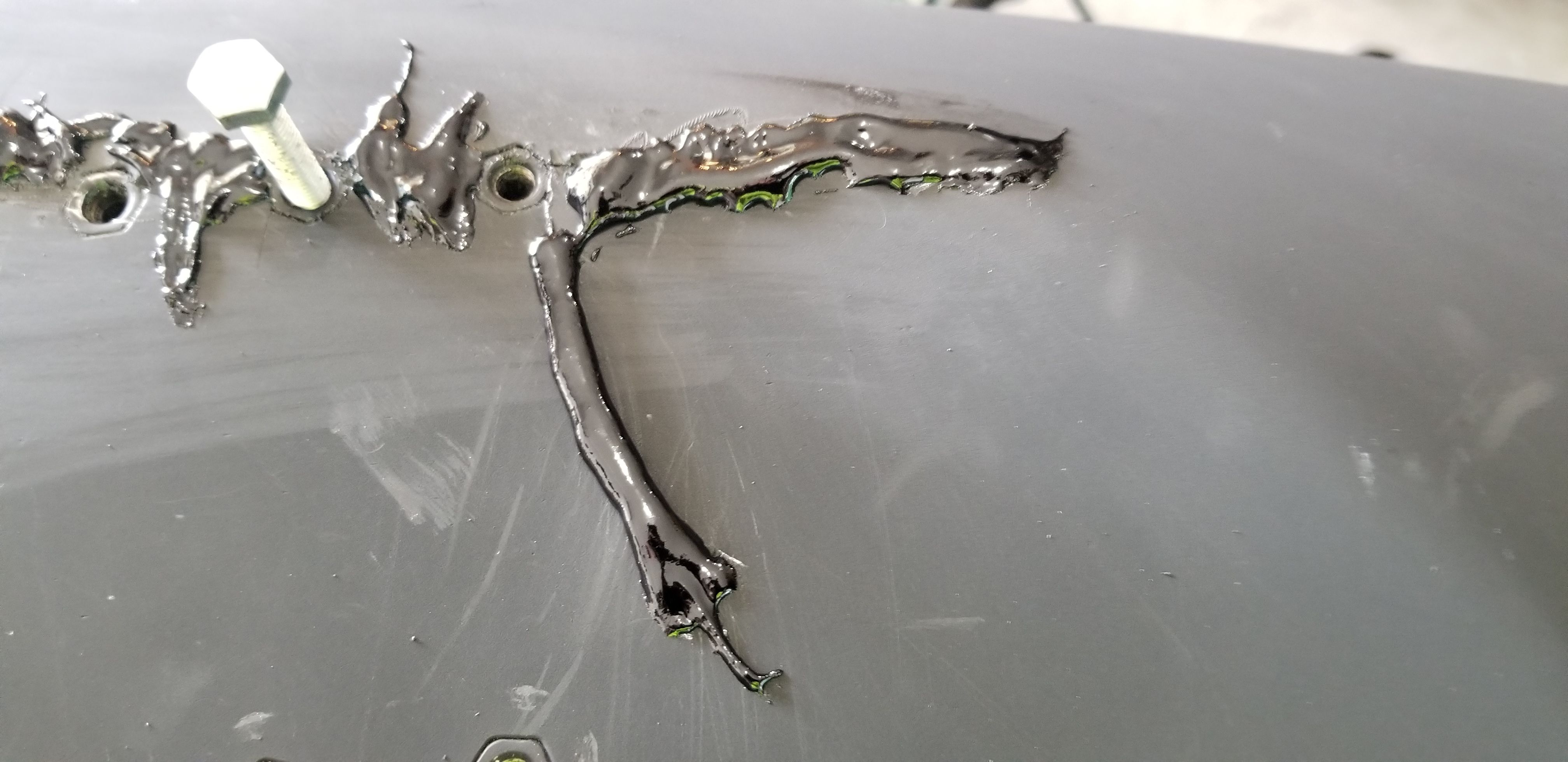

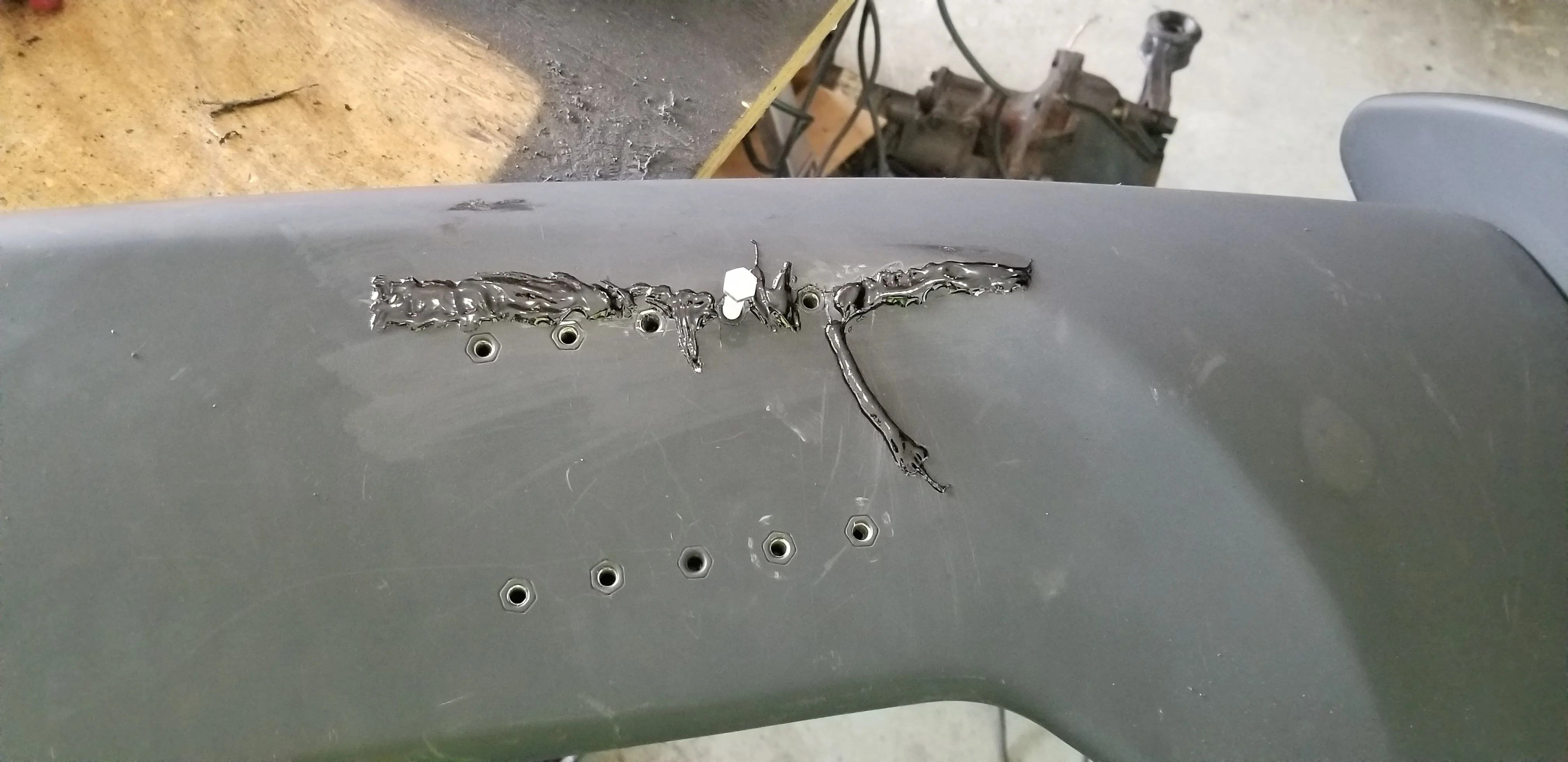

Right now I am working on the last few projects I have left for the SC and should be a decent daily. First is the eBay spoiler that got ripped out of my hands by wind at the house and cracked so I had to fix, I used a dremel to notched out the cracks and filled in with a 3M two part epoxy I have, just need to sand down and Paint and it should be good:

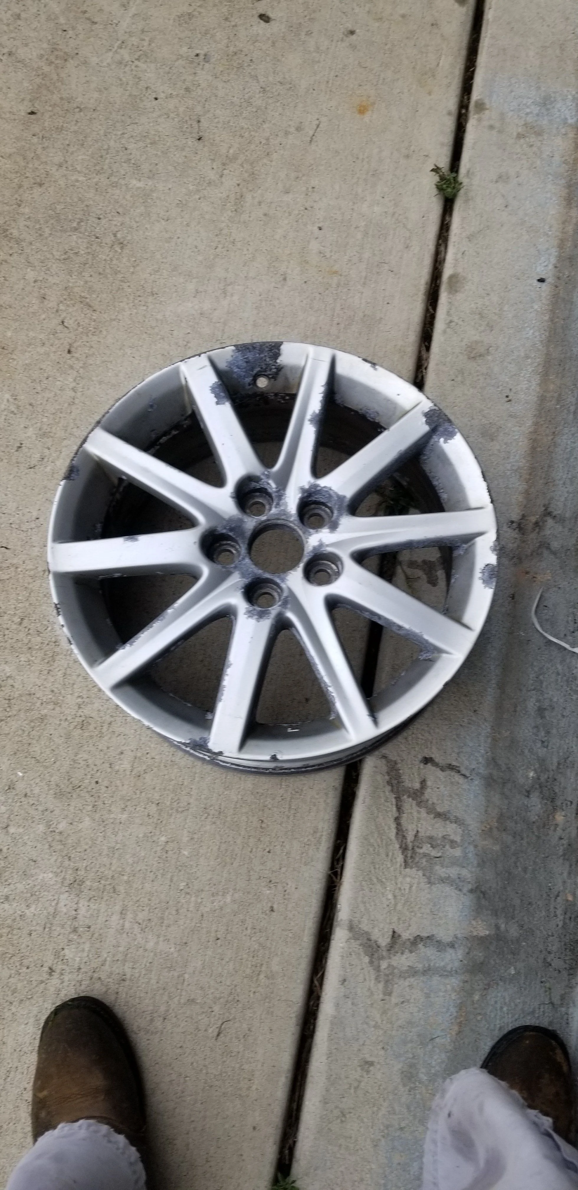

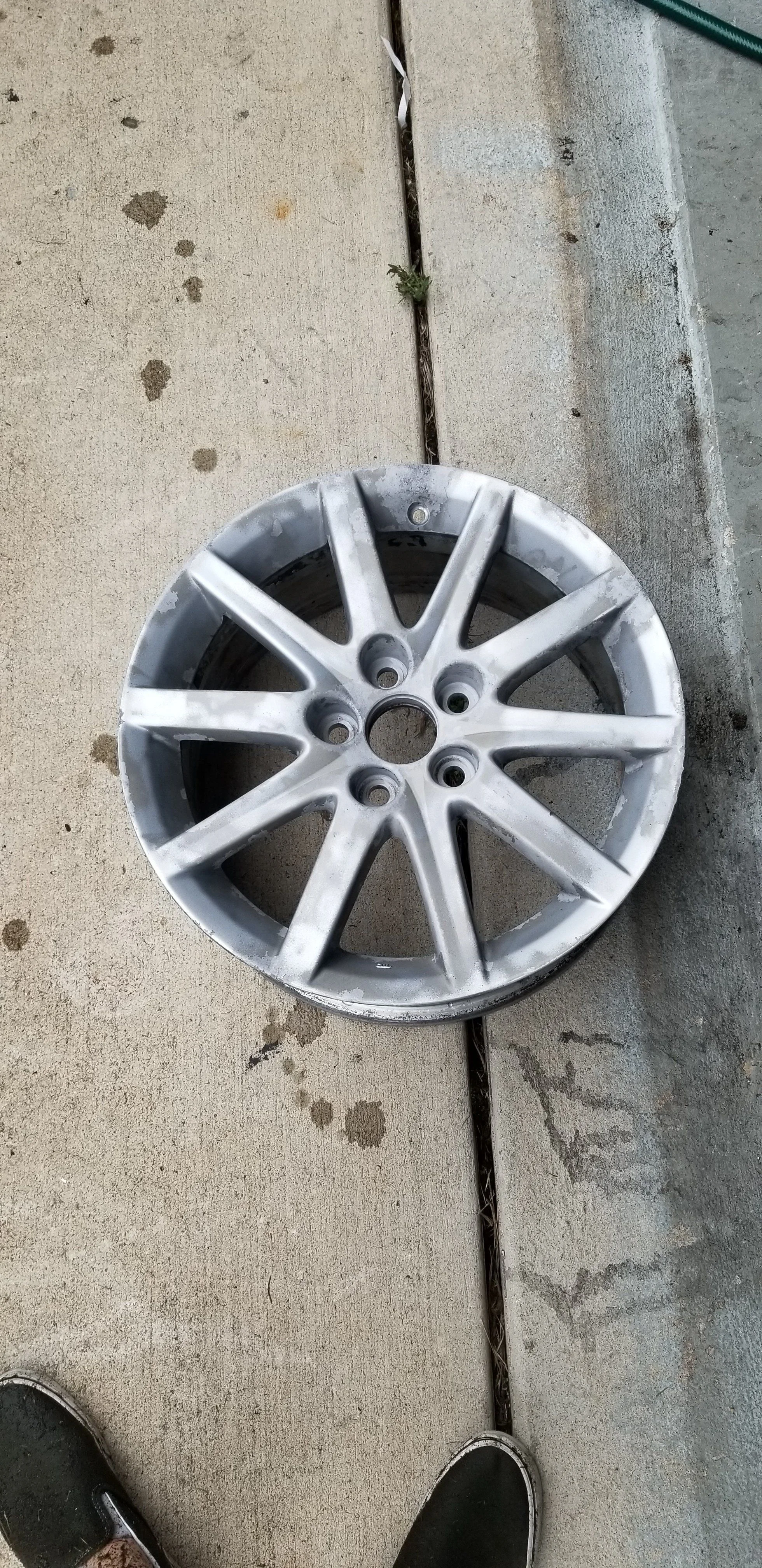

And the final touch is a newer set of wheels, the wheels on the car are bent to hell and I get a good vibe at 60 and above which makes for a not so good time driving down the highway. I scored a set of 07 GS350 wheels that needed some love. I bought one of those home water sand blast kits for the pressure washer to get the hard corrosion knocked down at least and now I can rough them up with a scotch bright pad, then some fillter primer and Paint and it should be like lipstick on a pig for the rough SC of mine:
Before:
After:
