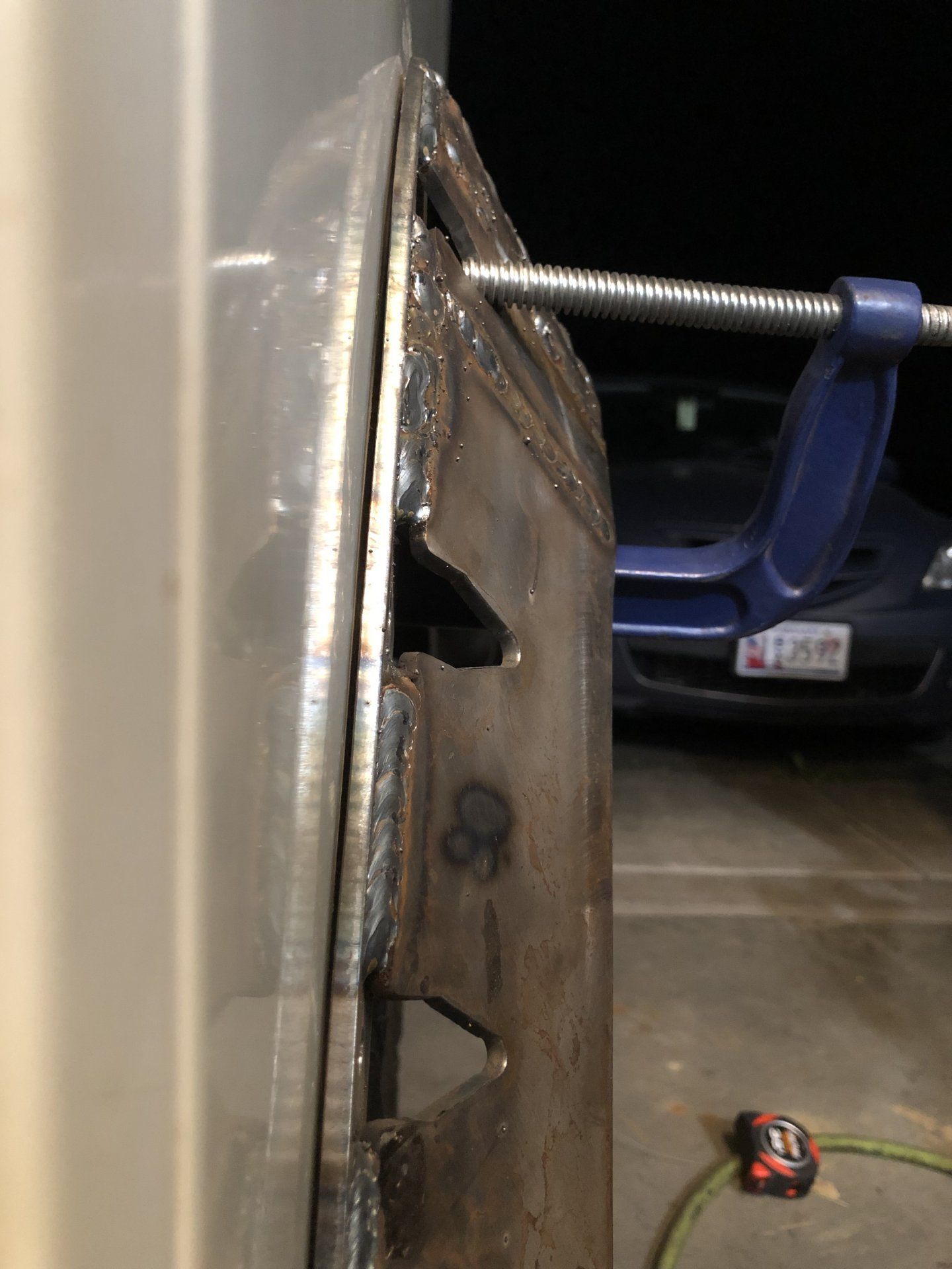

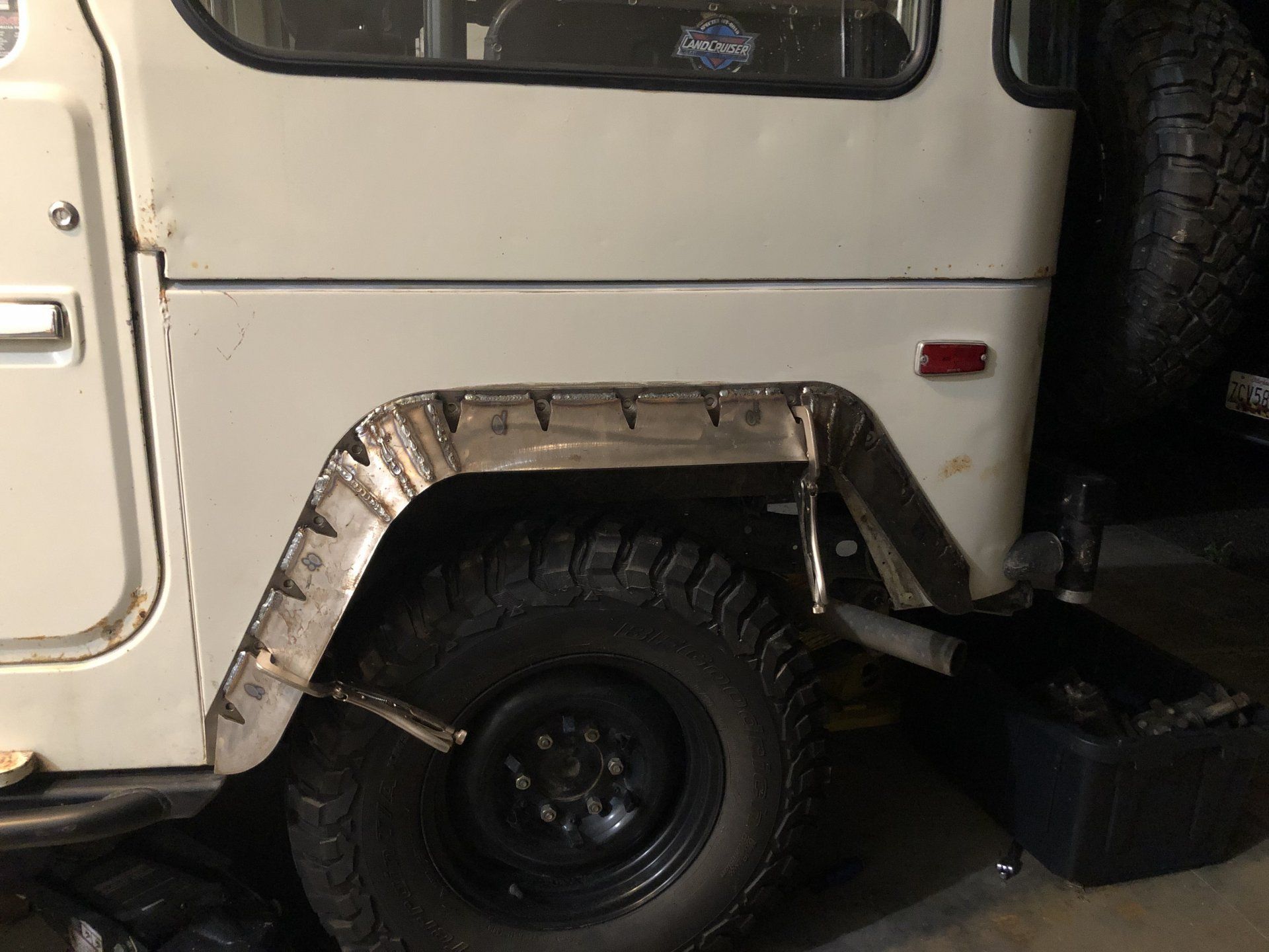

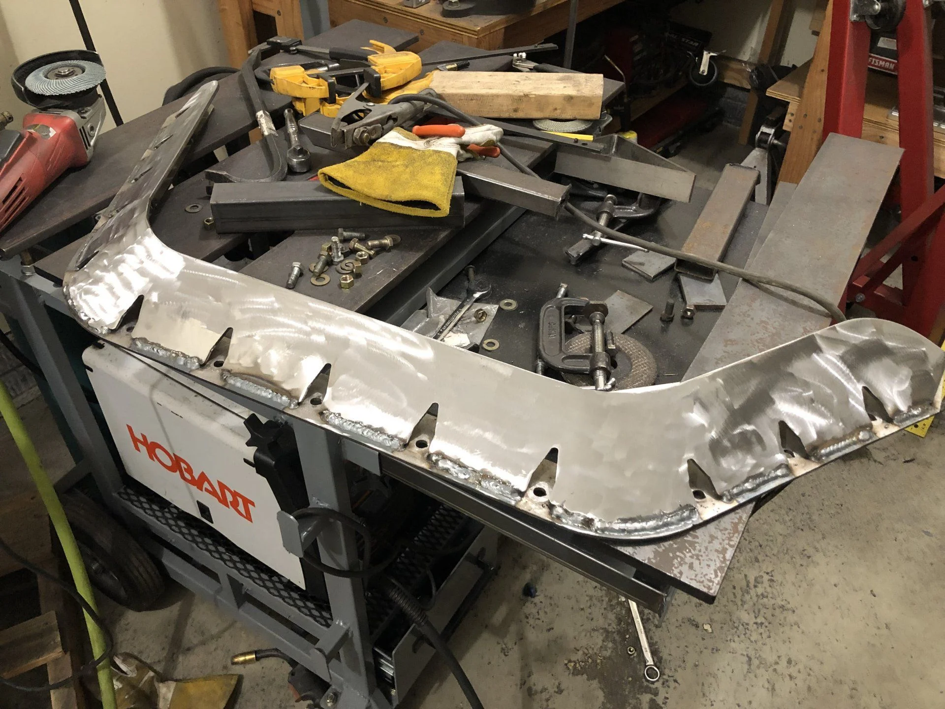

Welded up the flares tonight. Definitely amateur hour over here - some warping and potato-chipping without question but I think they’ll work. Learning a LOT about metal with these things and not all of it is fun.
Welders go easy on me I have no idea what I’m doing, and have yet to clean anything up.
Surprisingly - both flares lay flat on the floor and don’t appear warped or wobble. They seem “flat” until you clamp them to the truck.
I think what happened is the backing plate actually pulled “up” onto the weld right along the top edge despite the two flares being bolted together.
It doesn’t seem like it’s pulling out the body panels any when I clamp them flat, so I’m hoping the gaps will get taken up by the rubber fender welting.

some flap discs will hide the evi.....i mean will clean those up just fine.
100% going to flap disk the cross-welded spots. I was hoping to get the welds clean looking enough to paint over them without flap disking the hell out of them and for the most part they came out alright but there’s a few that look really crappy.

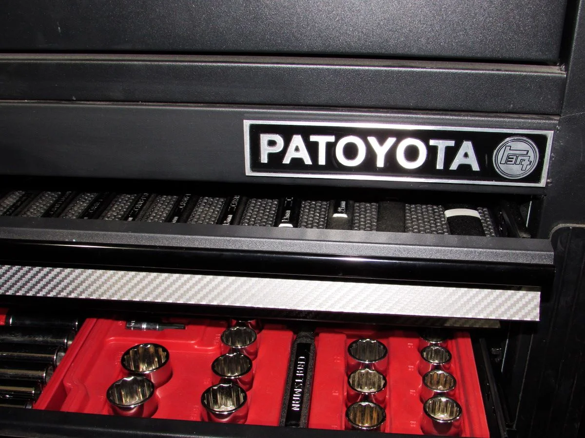

I got it mounted on my toolbox...

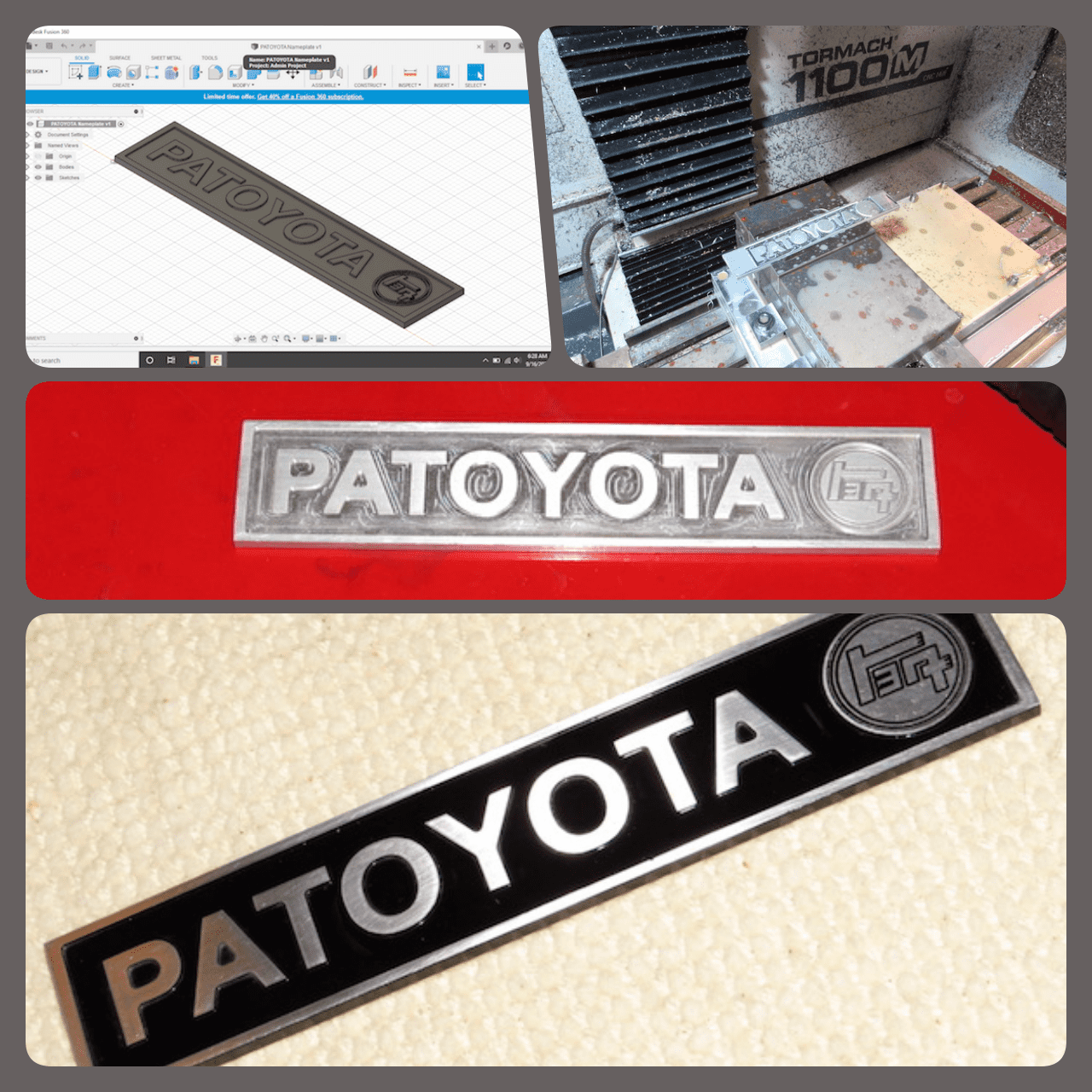

I've been slowly learning the ins and outs of CNC. Here is a nameplate that I created in Fusion360, milled on a Tormach 1100M vertical CNC mill, painted, and then polished. It turned out pretty much exactly how I wanted it to. It's about 1.5" x 7.5" for reference. It's pretty amazing to be able to draw something up and then hold the finished aluminum piece in your hand!

He's not wrong either way. The second fare looks a lot less crapped than the first one. I won't claim either are close to "good" but given that they are there to smash into trees, I'm not overly concerned with aesthetics.
