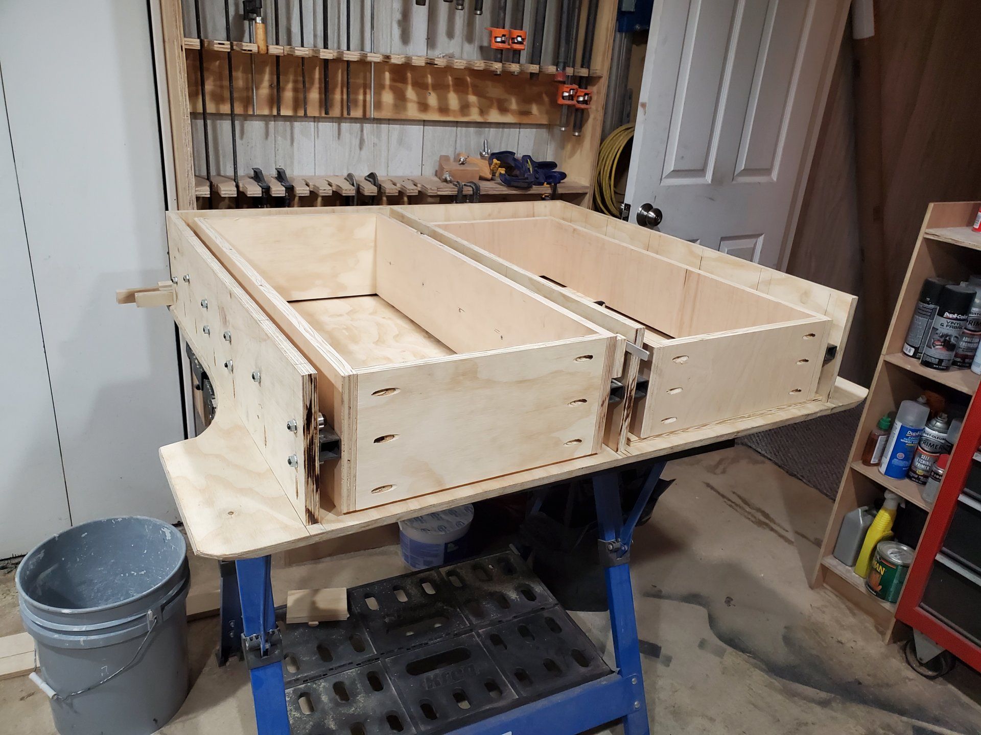

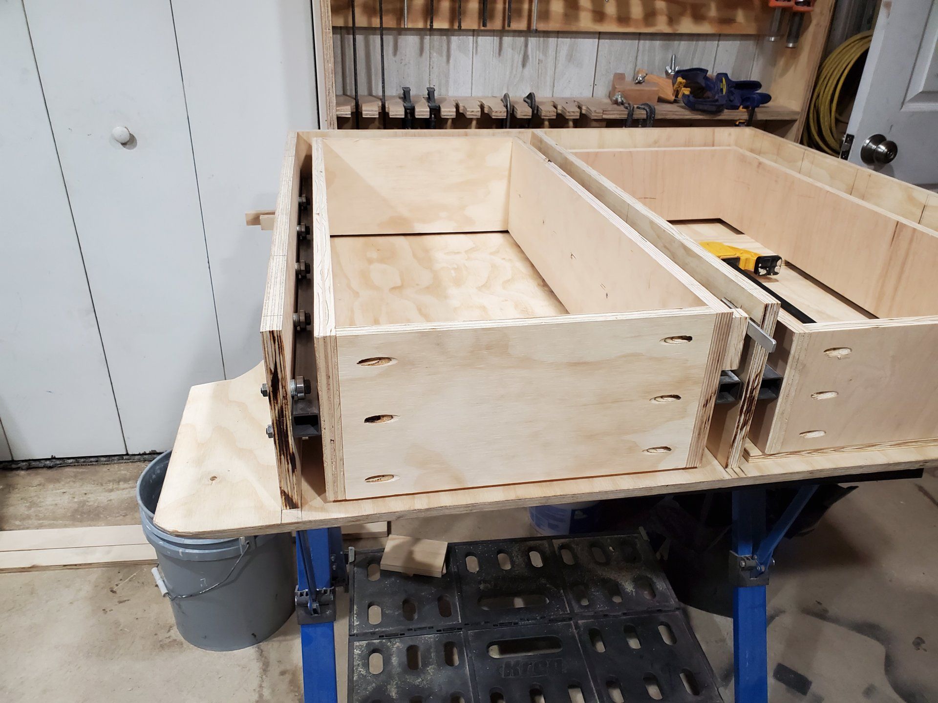

Slowly building storage for my 3rd generation 4runner. I went a cheaper route for the drawer slides using M8 bolts with a bunch of bearings that came off a couple inline skates that I had laying around and some 1" rectangle tube.
Sorry I missed the group at the breakfast but my son ended up having a separated shoulder. The drawer fronts, flush pull handles, and ready to install on the 4runner.

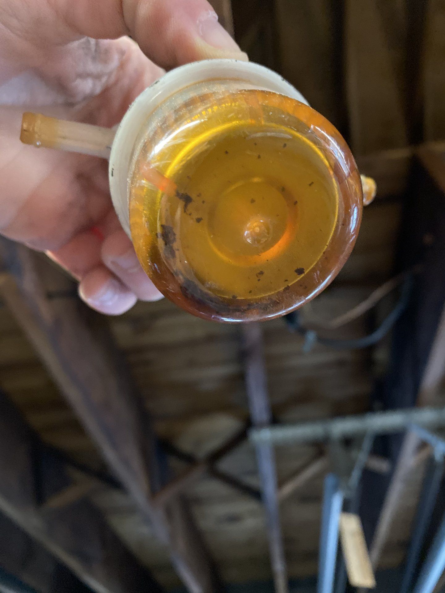

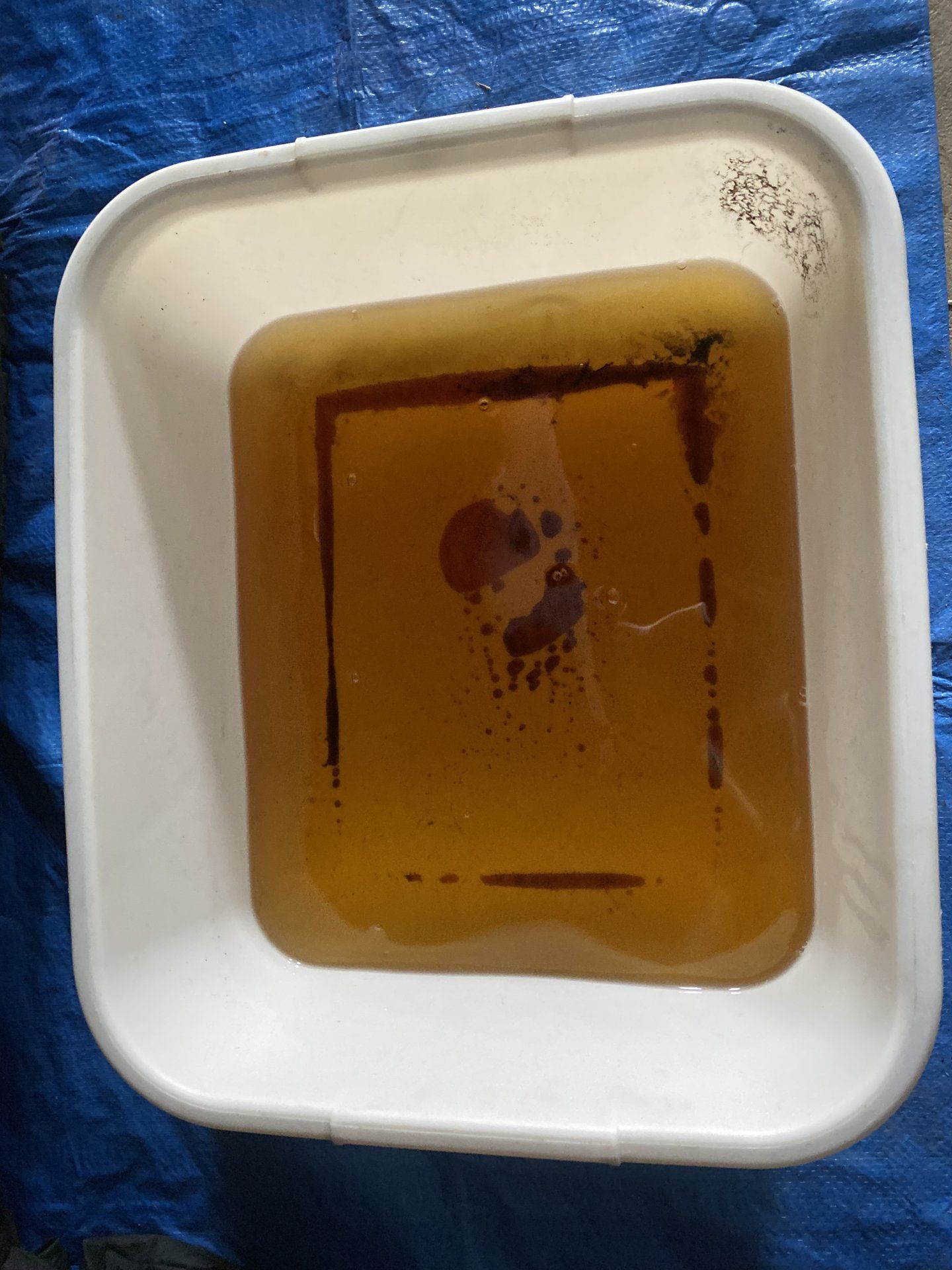

Since the truck had been sitting for at least a year, I drained the fuel and replaced the aftermarket fuel filter with OEM. Both needed it, and the fuel was about 8 gallons of varnish in the tank that looked exactly like the below. I also found out that my '85 had the gas tank recall done at Spring Hill Toyota in Mobile, AL in 1992. The filter also had tons of debris.

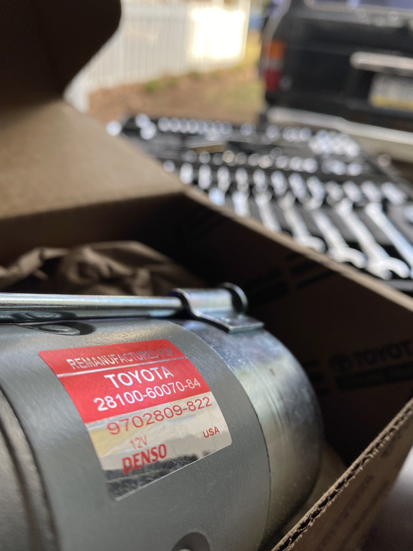

I replaced the starter with a remanned OEM, took out the old NGK and put in some denso plugs (have the wires, will be changing when I do more of an overhaul on the engine).
It turned over, we drove it once around the block, and then parked it back in the garage. It idled high, and puffed some white smoke. Plenty of research later, I know I can have nothing wrong other than some old fuel/condensation in the tank and lines, or I can have a cracked block. Right now, I'm running down the list. The weather has slowed me down a bit, but I'm hoping its just part of the engine cranking for the first time in a year+. Next up, JimC's carb clean method. Hopefully that takes care of the rough idle.
