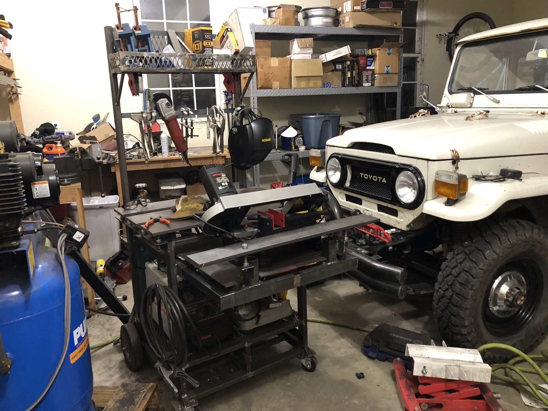

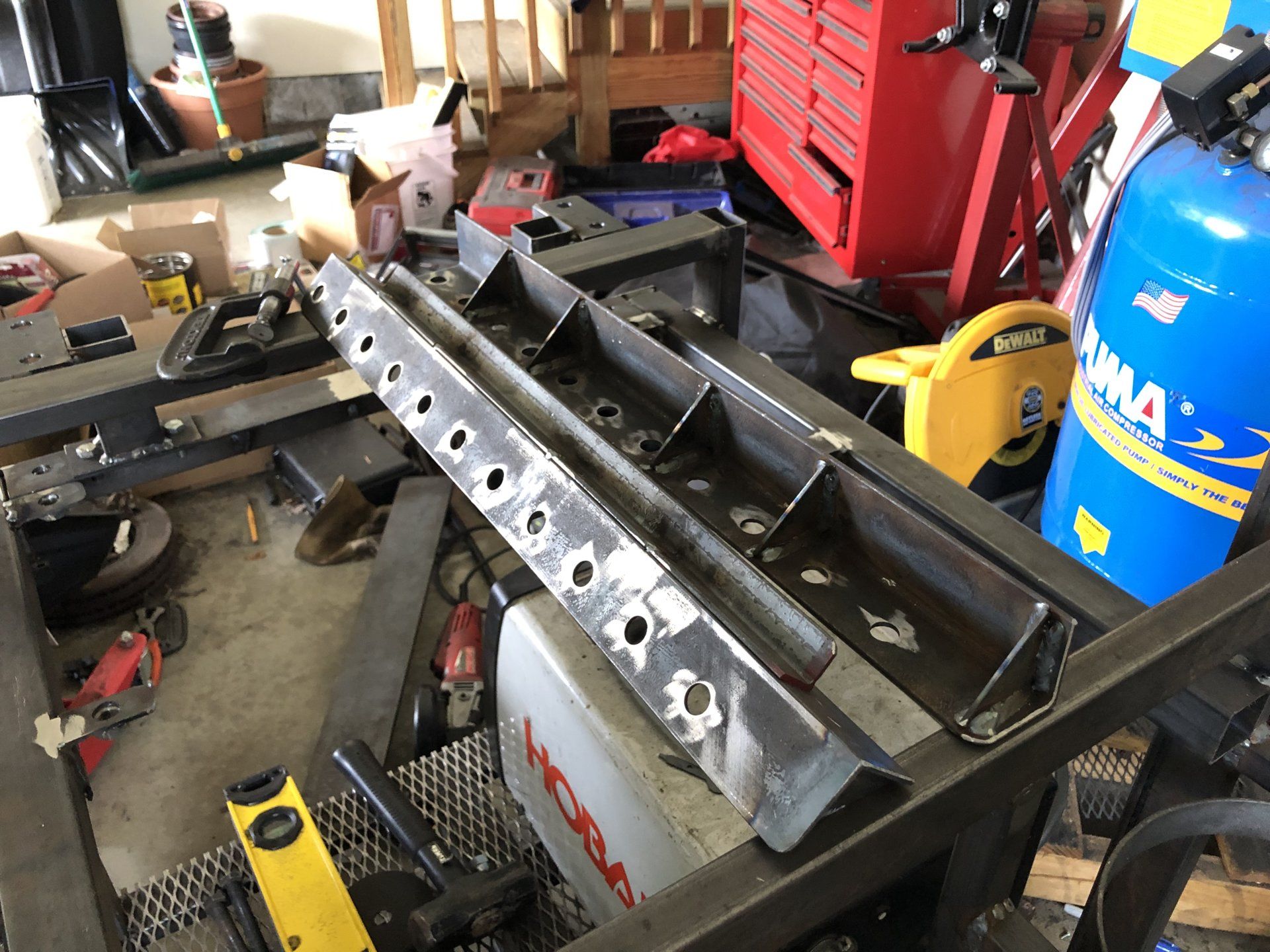

Aside from the drawers at the bottom (still need to brake the boxes) the endless fabrication station build is nearing an end. A few finishing touches and some clean up still, then paint, which will need to wait until spring.
Wrapped up the main tabletop supports:
Finished up the bottle mounts and extension cord holder on the back
Sliding and adjustable saw-table/outfeed extension is in. Confirmed I can get the table height set to fit my abrasive saw (all the way up) and band saw (all the way down). Plus, got the top supports welded in. Big improvement as I’ve been holding the top on with C-clamps for the better part of a year. Also got the helmet hanger a storage coils for the whip/ground cables on.
This has been a really fun project that took WAY longer than expected, but it is serving its purpose - the quality and consistency of my welds is getting better. Still not GREAT mind you, but I’m learning a lot about application of heat, how to avoid burn through and warpage, etc.
I also got a new toy for myself for Christmas - SO much cleaner/more precise than the abrasive saw.
Next I need to clean/purge this disaster of a garage and get back to the 40.

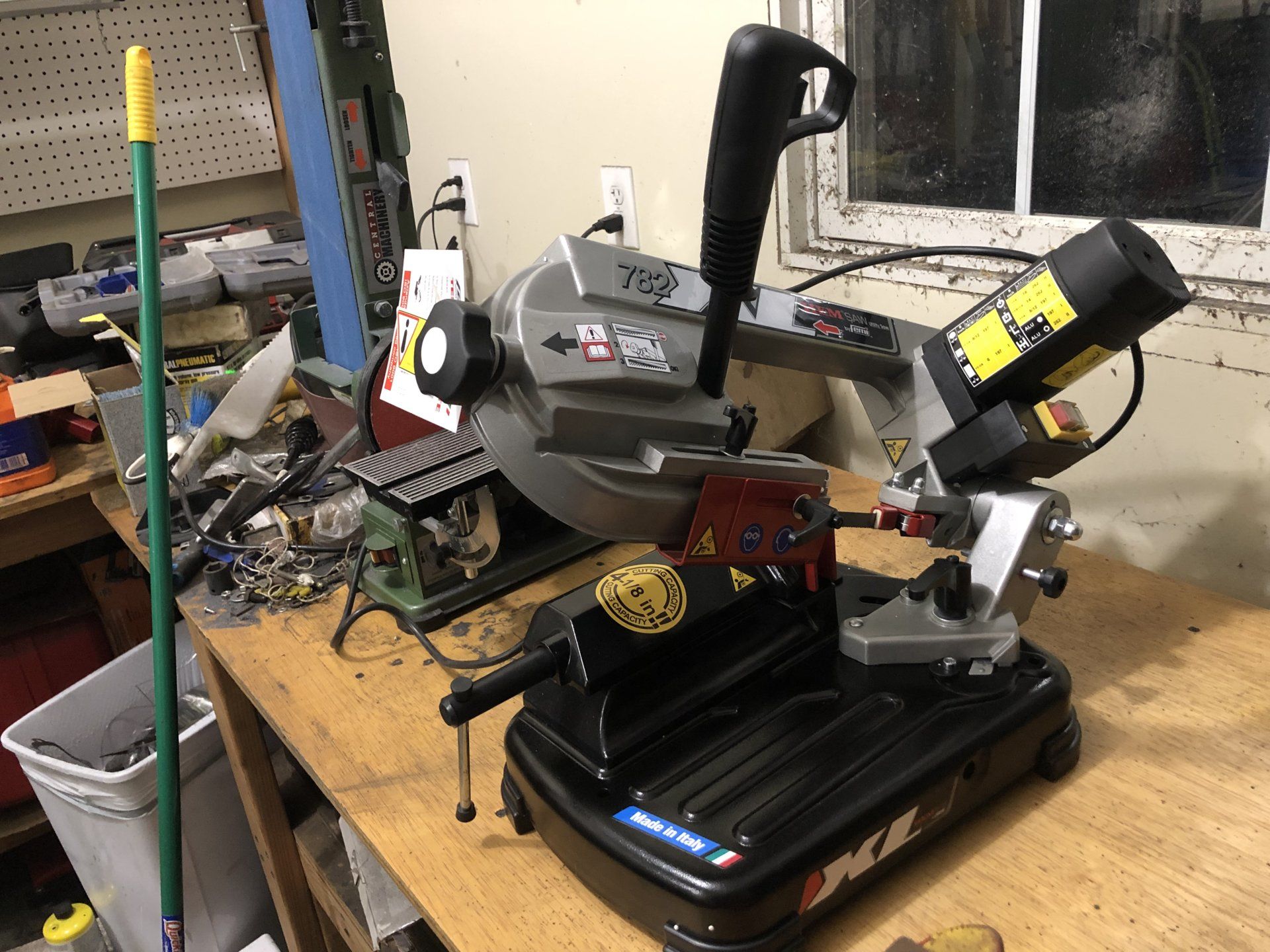

I like the looks of this. Tell me more.
It’s a mini mitering-head band saw - basically like the larger horizontal metal saws but “pocket size.” Which is about all that fits in my garage. One of the only versions I could find that wasn’t the same Chinese clone painted a different color (this one is made in Italy).
Similar to the portaband conversions out there but truly a dedicated mounted saw. Very happy with the accuracy so far. It is SLOOWWWW compared to an abrasive saw, but I don’t do this for a living. Further, I save a ton of time by getting the cut I was looking for the first time. If I did do this for a living there’s a model with automatic down-feed so you can start it cutting and walk away. Weighs in around 40-50lbs. Actually wish it was a little heavier - It’s hard to keep the saw still when mitering the head.
It also goes vertical for contour cutting:
Basically I got fed up with having the deburr every cut and fix the complete out-of-squareness generated every cut by my abrasive saw. Having to correct everything on a belt sander was getting tedious. This isn’t cheap, but damn is it effective.
