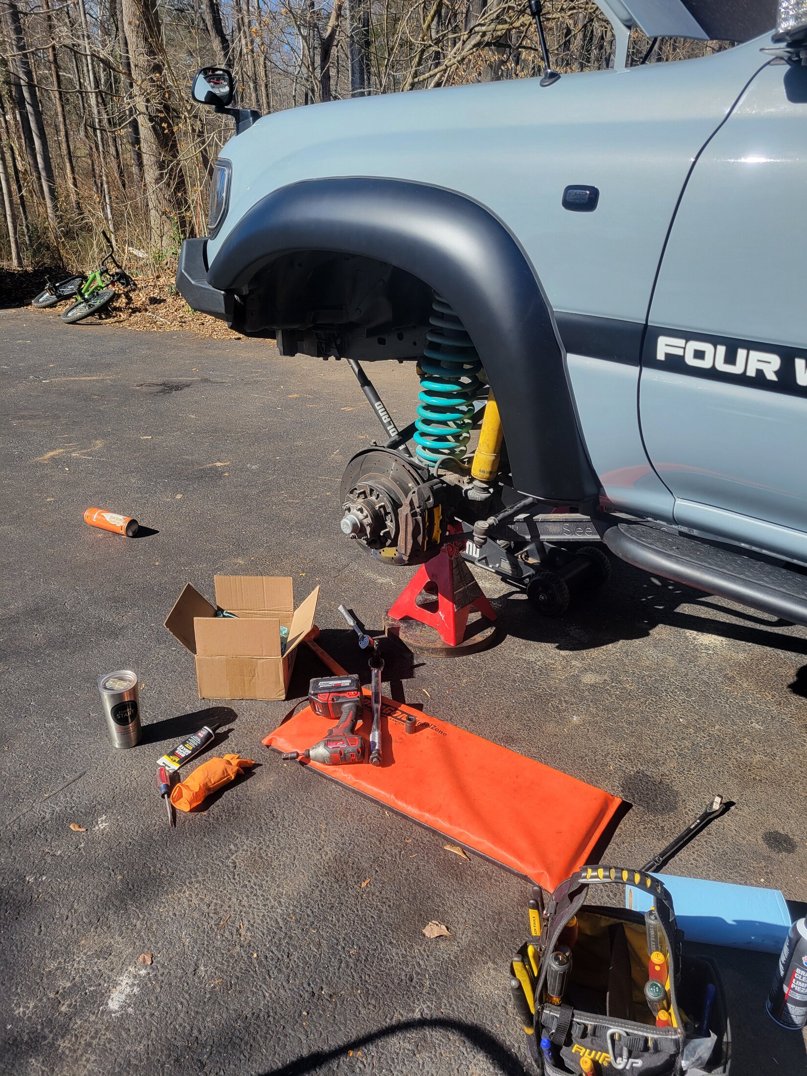

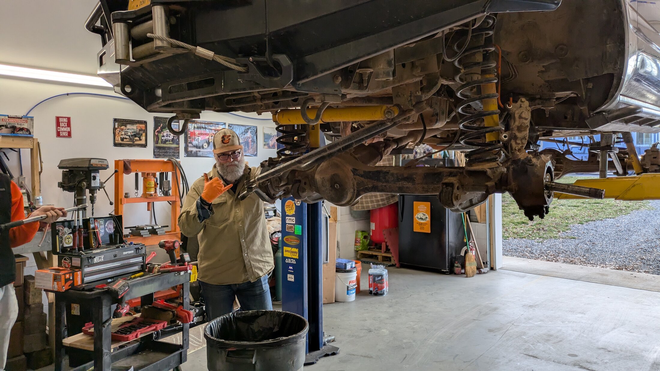

Thank you to family camper for the help today! Since Thursday, Rear bumper and swing arm install, get my power antenna working again, front brake pads, pull and grease front drive shaft, install 1/2 of my not huggers, install new front locker actuator.
Don't forget tighten up front (super loose) sway bar link!! -1 clunk/rattle in the truck lolol. Good times man one step at a time!!

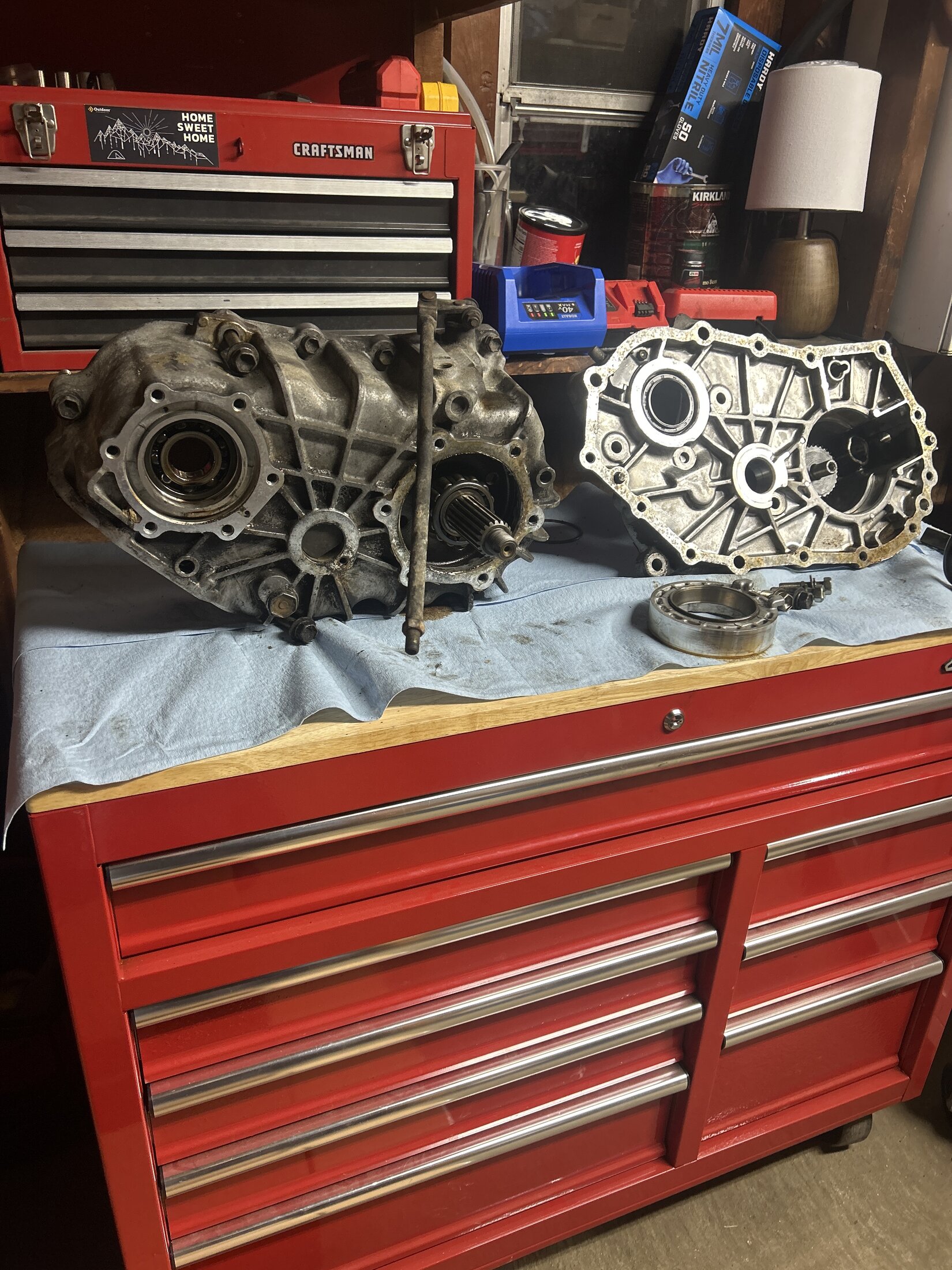

Transfer case for 62 is disassembled!! Now the harder part...
