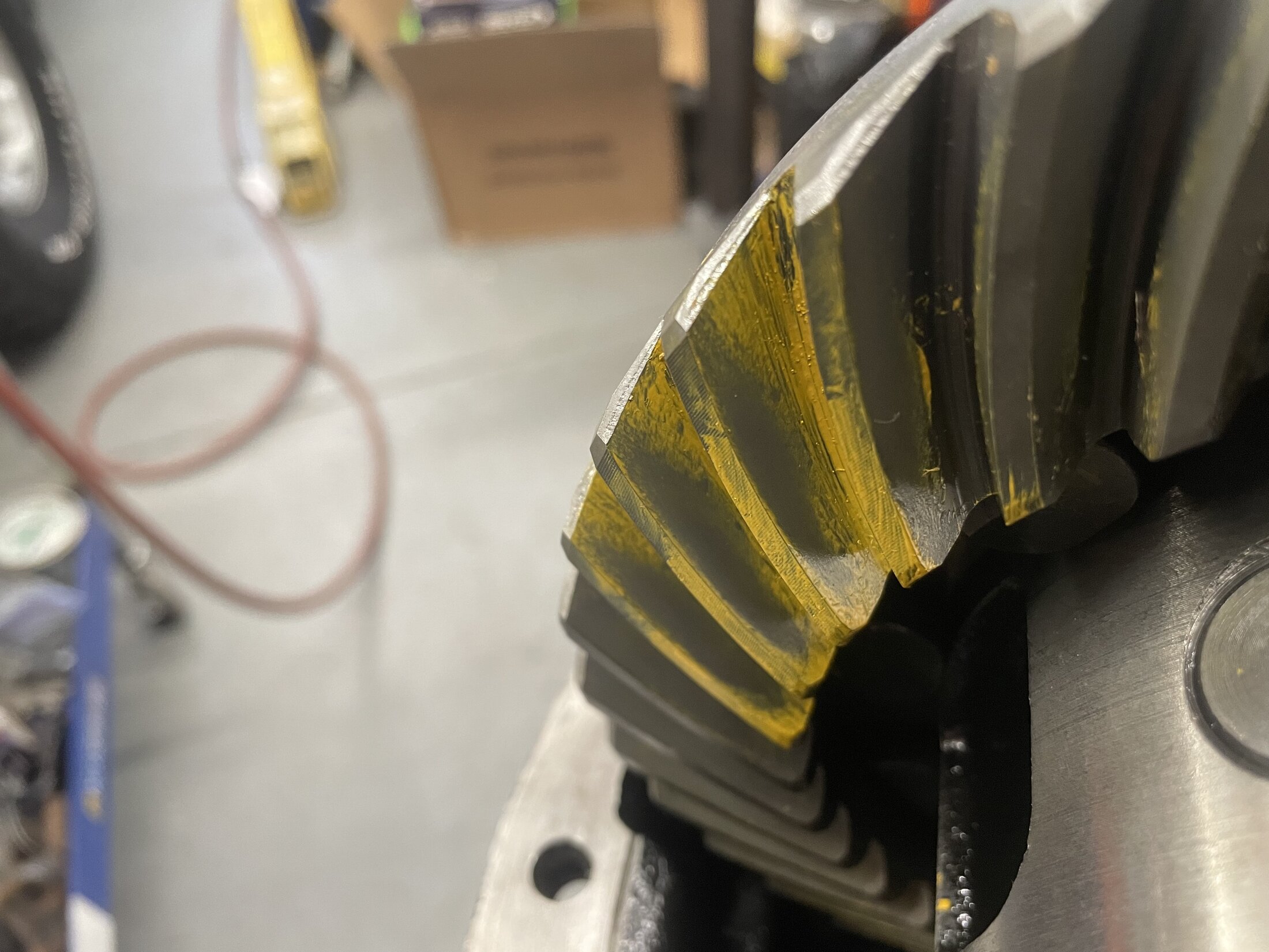

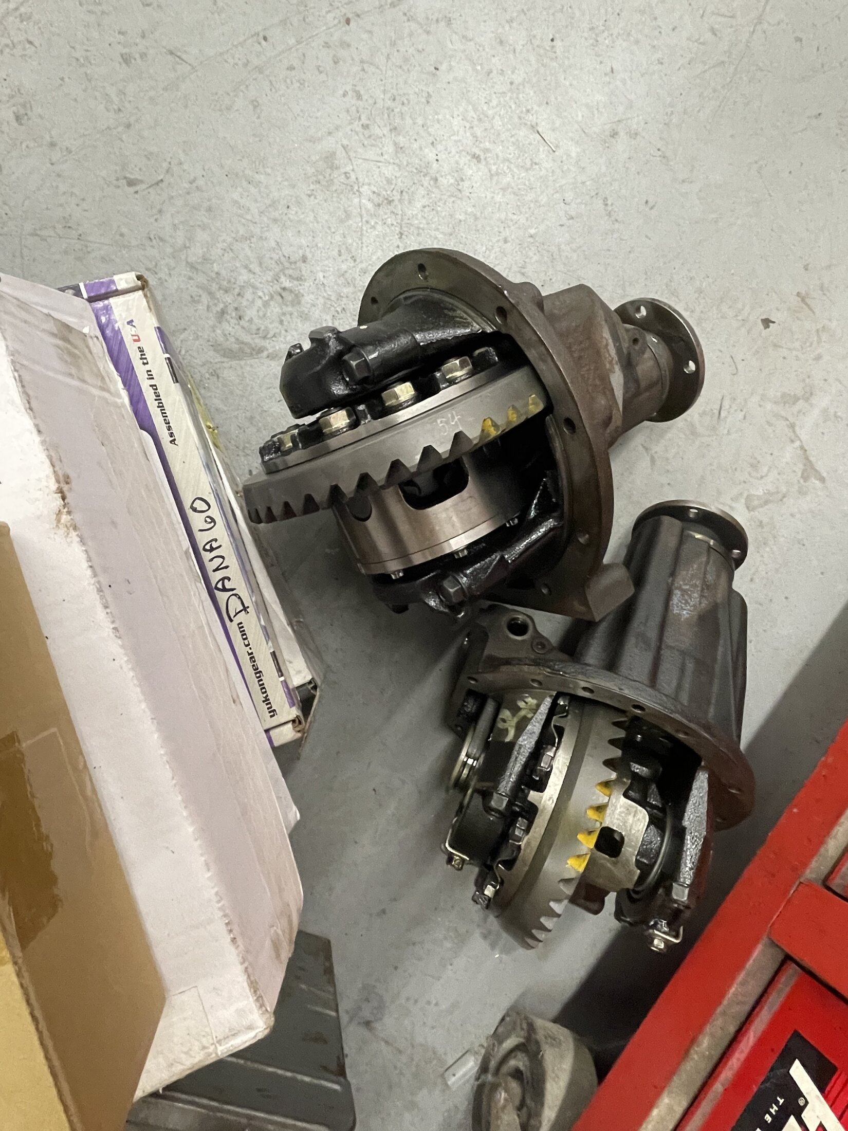

Thanks to @Beach80 for letting me borrow a 20 1.5 die to clean the threads up. Problem was the diameter was .030 smaller where it stripped the pinion nut.
I pulled it all down. Installed new ring and pinion and reset everything. Pinion shim stayed the same but backlash moved two shim numbers, about .006..
Pattern looks good. Toyota crush sleeve worked perfect! Both 3rds are ready to install @davidp14 .
