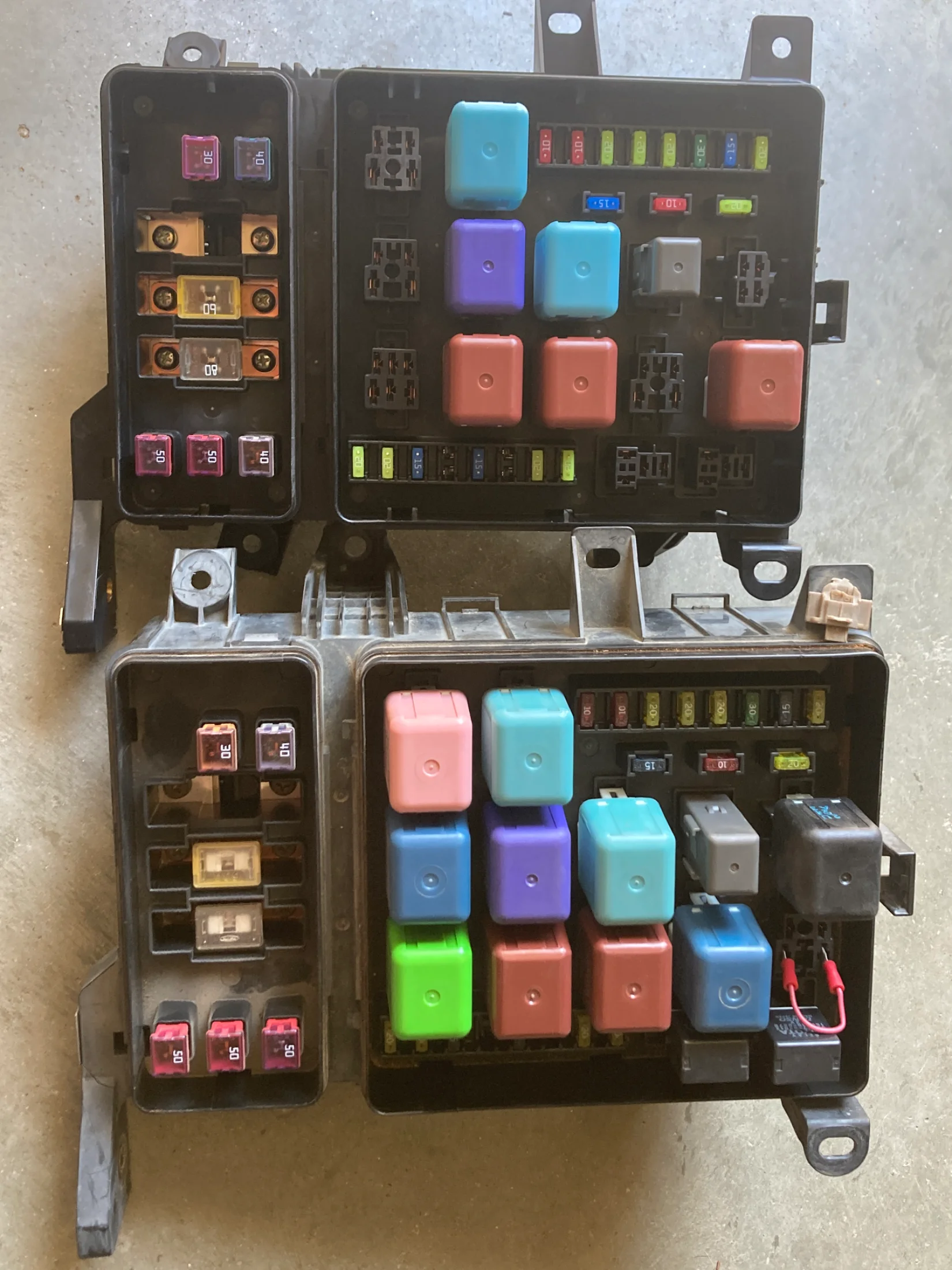

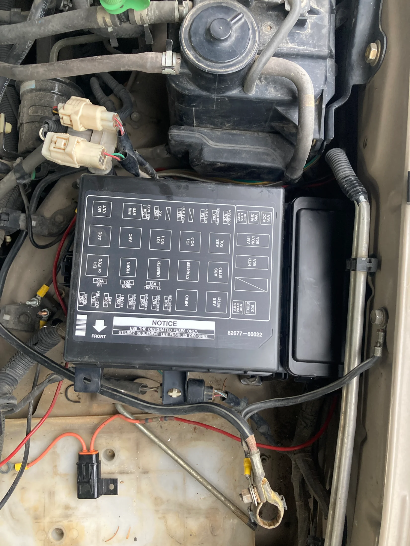

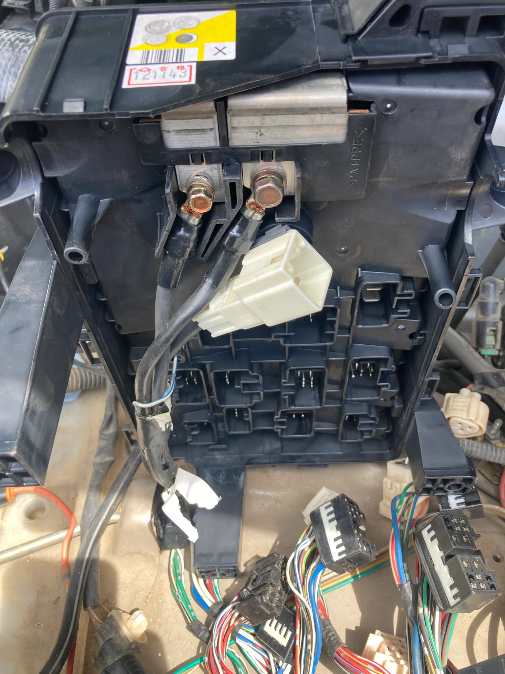

I was having the “crank, no-start” that would be remedied by pulling the EFI relay and spreading the legs.
So time for a new fuse block:
