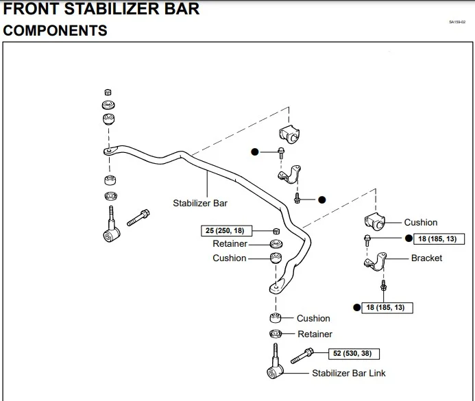

I gathered up all the parts to do front and rear sway bar links.
I didn't see any good threads that spelled out the Toyota p/n's for doing this job.
I think I will start a separate thread so folks can find it easier than if it were buried in here.
I take it back, there are a few good threads for replacing sway bar links and P/Ns:
So I don't think there is any need for a new thread.
Sway bar end links are done!
That was probably one of the easy tasks on the Flexus!
I hit the threads with some Kroil a few times before the job and this job is in the bag.
