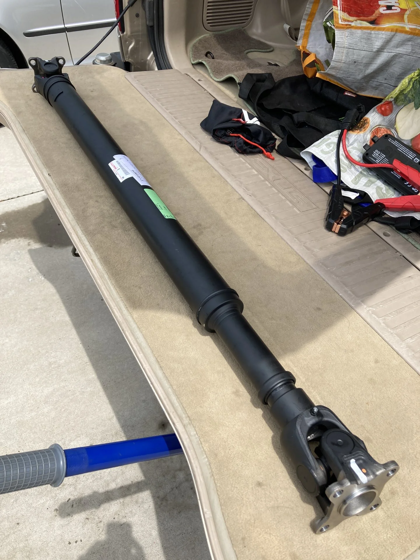

The rear u-joint on the rear shaft on our LX makes a squeak-squeak noise when the :princess: backs out of the garage.
I thought about sending it out to the local driveline repair shop, but then I heard they will use Spicer joints vs. Toyota to rebuild.
Then I called our friendly neighborhood Toyota parts counter and got a quote for $450 for a new rear shaft. Ugh. That was more than I was hoping to pay.
Thoughts?
There is some play in the splined section as well. LX has ~213k miles.
Can you not provide the OEM joint for the shop to install?
I can, and I thought that might run me $250 for the work + $140 for the u-joints = $390, which is getting close to new.
Wow, I was mistaken! Local repair = $410 w/ their u-joints. If I bring my own joints, they charge $390, plus the $140 for Toyota u-joints.
Guess I am calling the parts counter back!

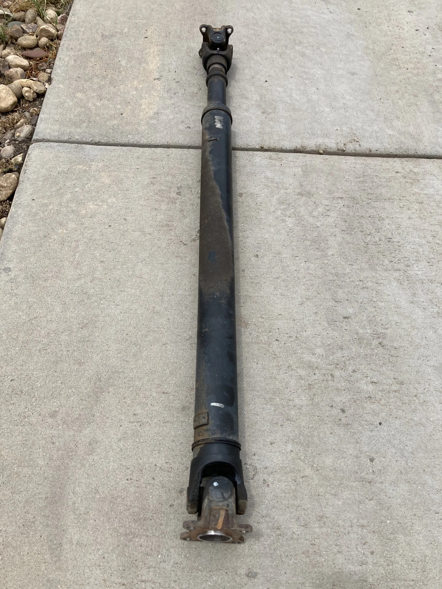

I have a friend interested in the old shaft for re-build as he dented his.
