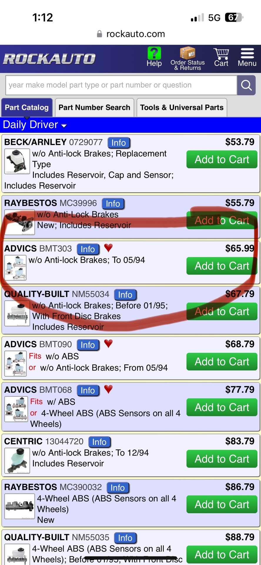

Because nothing sux worse than an open ended repair threads. But it was 💯 the master cylinder. I now have the strongest brakes outta all seven 80s I have owned over the years. I thought my other 95 80 had some good brakes. With the new master it also feels more level under braking. Before I had a lot of nose dive going on. I wonder if my rears have been weak for a while. So the fronts were doing all the heavy lifting. Also would explain the very short life of my front pads.
Nice going dude, thx for the follow through. Looks like you got yours from Rockauto for $58.
Yep and it fit perfectly. It did not come with the threaded plugs for bench bleeding. I picked up a universal kit from NAPA for ten bucks. It had the plugs with nipples to run hose the hose into the reservoir. So it’s a one step bleed process.

If one deleted their ABS/LSPV could they get away with ordering a new MC for a vehicle W/O ABS like the one pictured? Would this be the recommended brand next to a Toyota branded unit? The rebuild kit cost as much as this MC
