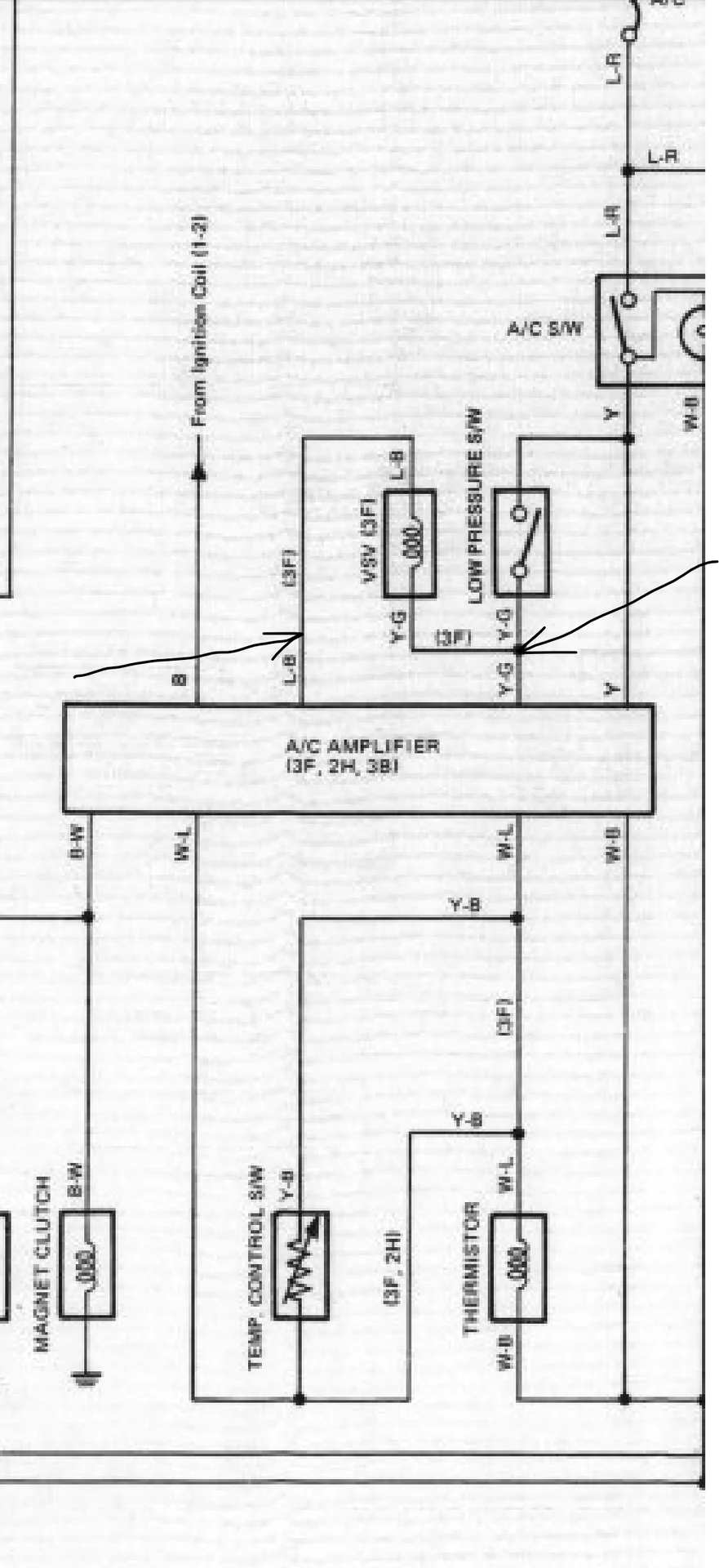

So I replaced all of Mudhorn's AC parts that touch refrigerant last summer but never got the idle up to work. I had increased the idle to trigger the AC clutch and adjusted the RPM potentiometer to prevent any rapid cycling. I jumped back into this summer and what I found is that I have 12V on both the Blue / black and Yellow / Green wires which power the VSV that increases idle. Presently I have the VSV unplugged and I get that voltage on both wires at the VSV plug and at the AC amp connector as one would expect. Obviously, the Blue / Black should be ground switching so I should see a voltage delta between that and the Y-G. Likely, I just have a bad AC amp but I thought I'd see if anyone had ran into this issue and possibly fixed it.

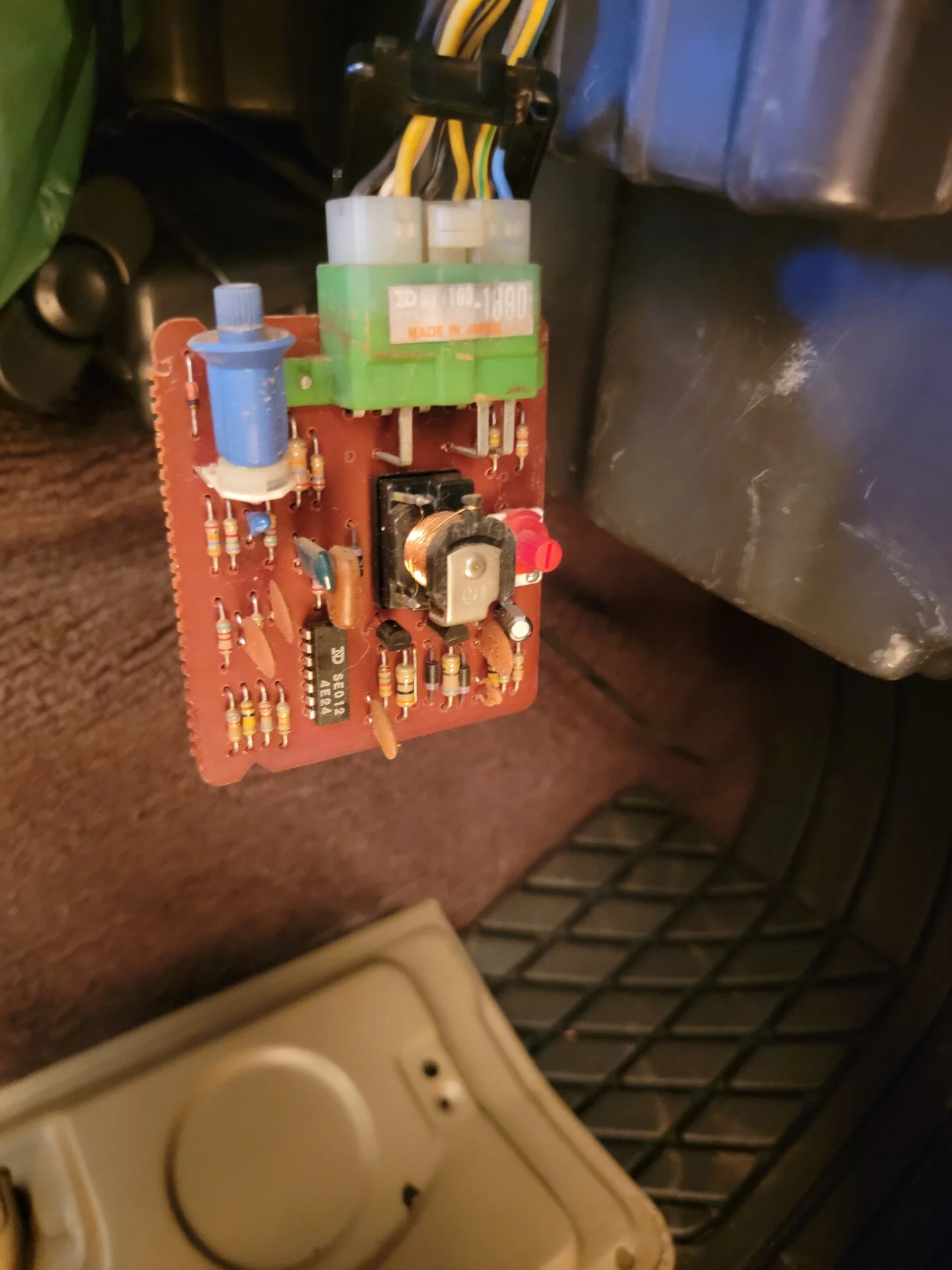

Well luck struck out of the blue, my buddy had one in a parts rig, I installed it and it all works like it should. I set the AC idle up speed to 1k and the vents feel colder.
Interesting, though the part numbers are the same the connectors are different colors. The green connector is the newer to the truck one. I guess something on the old part must have fried.

There is a flyback diode on the collector of the transistor that switches the idle up VSV to protect it when the VSV coil discharges. Could be it is leaky causing you to see +12 on pin 4.

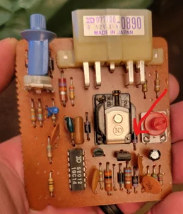

Is it this diode?
Frank
I keep a pile of 1n4007 diodes in stock to replace these. I would need to check my file on these to verify which diode it is on the board. I will get back to you.

So, all I'd need to do is replace the component shown, and my AC wouldn't cause the revs to run up so crazy?!
Assuming that diode is bad, and it seems to be on mine, it prevented the idle up function from operating at all as there was equal voltage on the VSV + and -. As a result the VSV would not trigger and send vacuum to the dash pot to increase the idle.

It is the one below it
