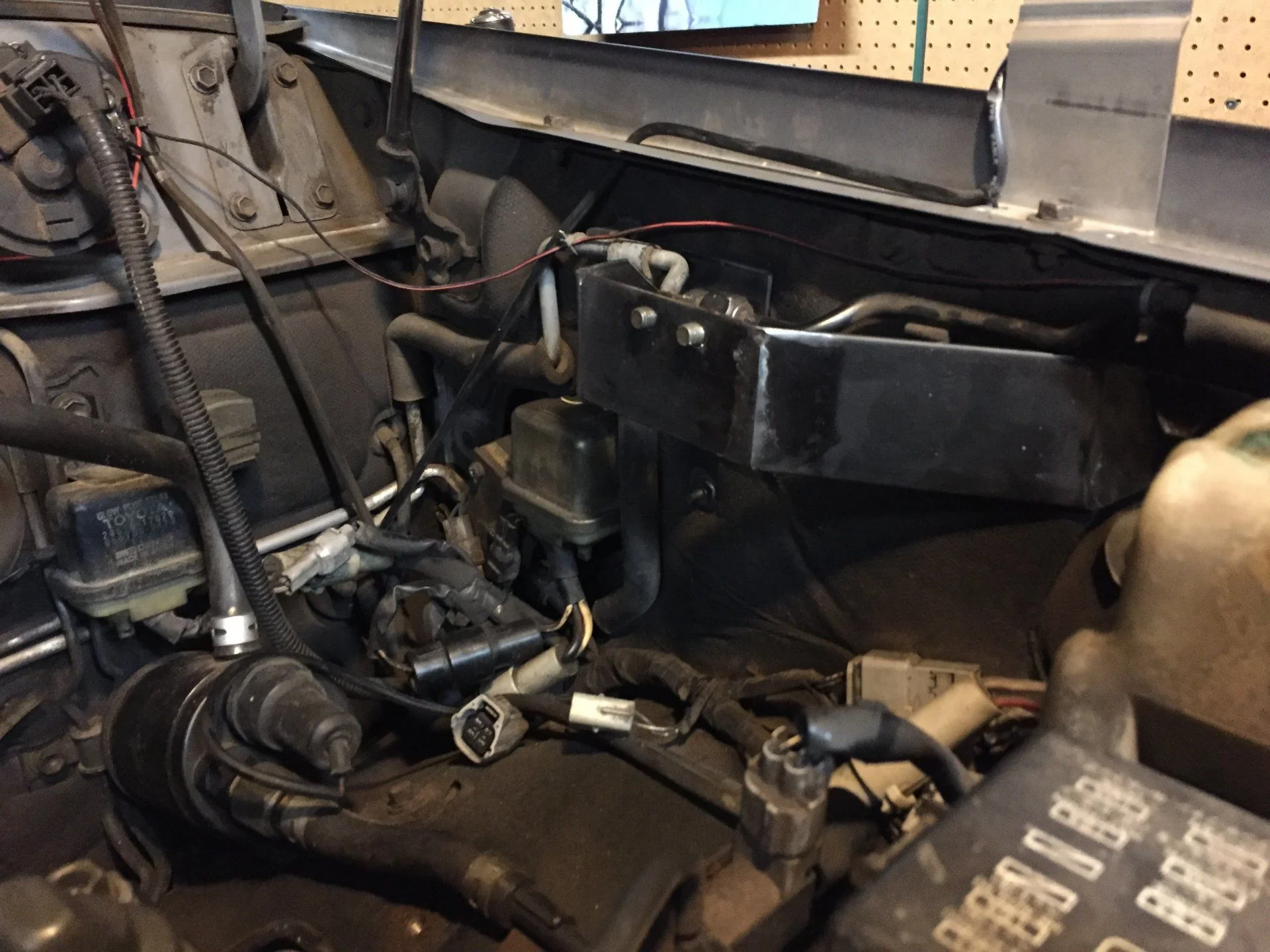

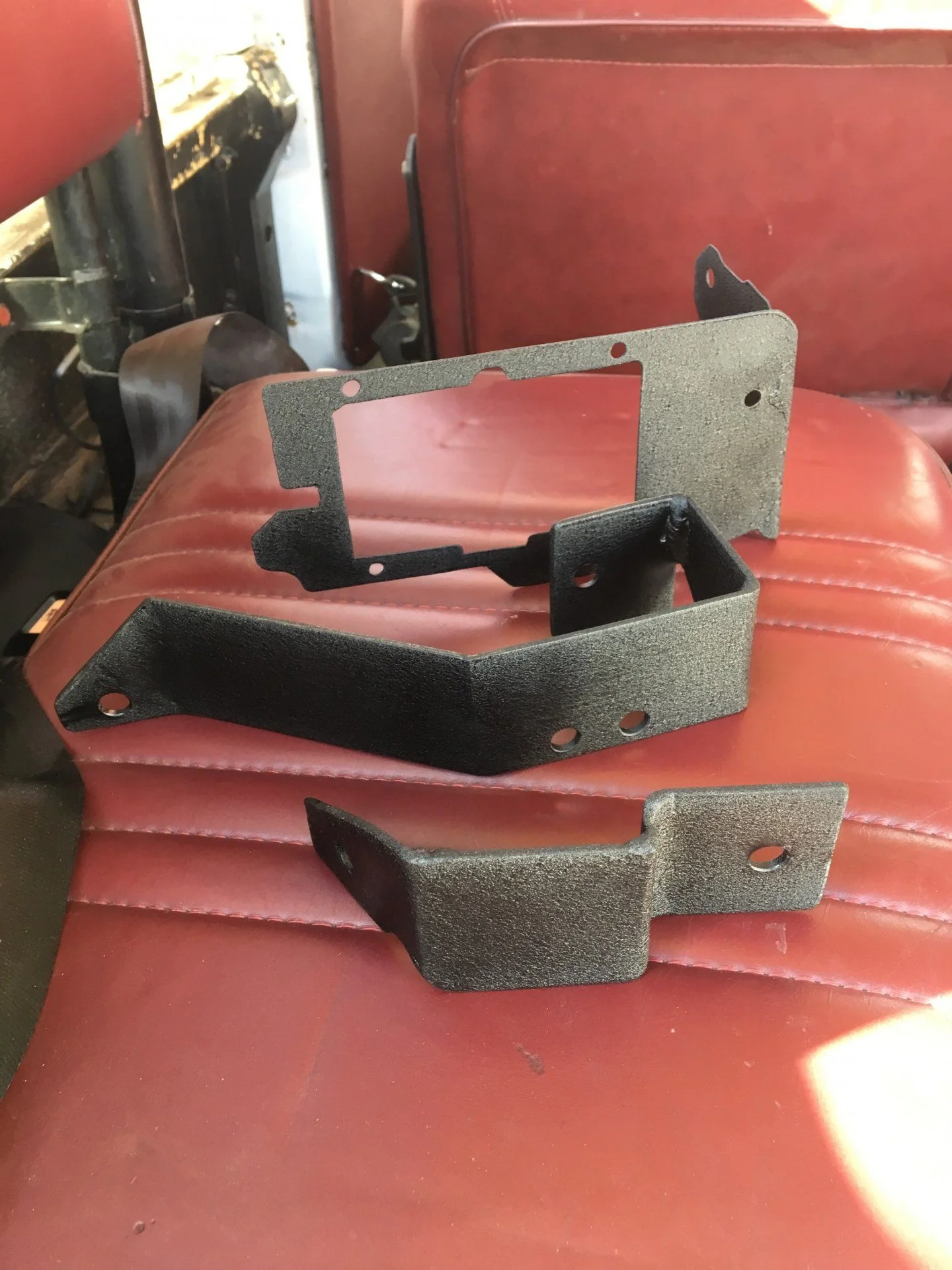

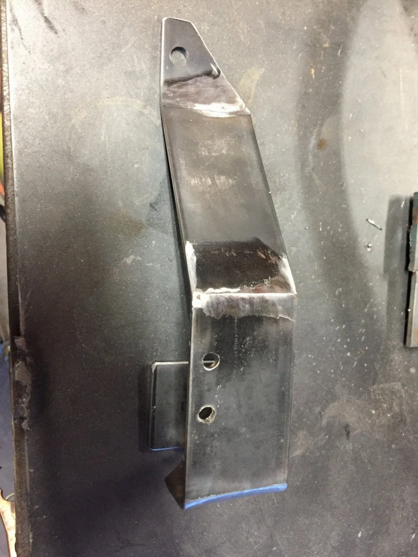

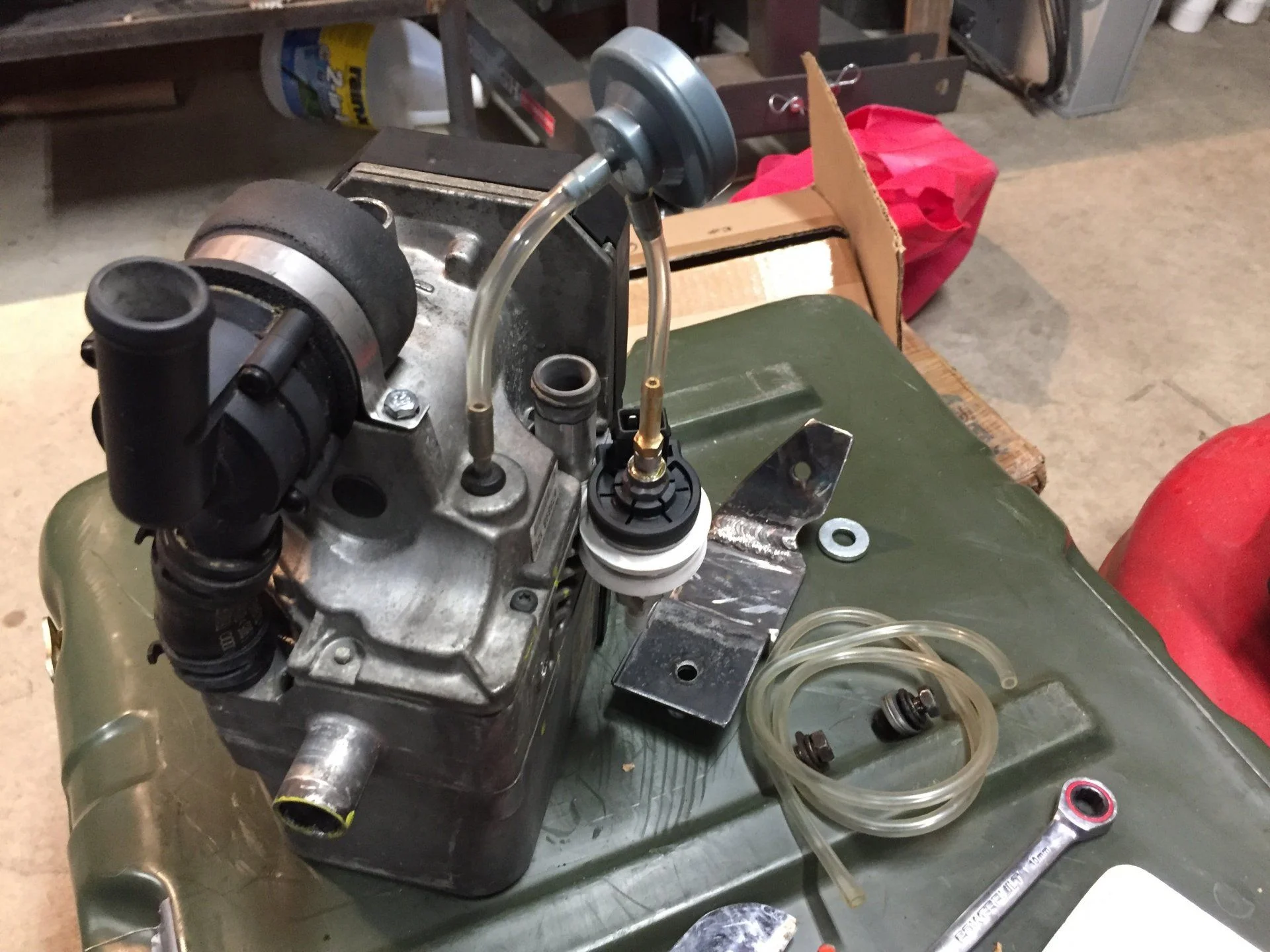

I made brackets that attach only to stock mounting points - no drilling. I also tapped the Webasto body for M8 bolts.

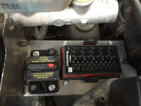

My engine was becoming a mess of wires so I also opted to install a bussmann to power the unit. Wires were connected with weatherpacks.
Had all the brackets powder coated.

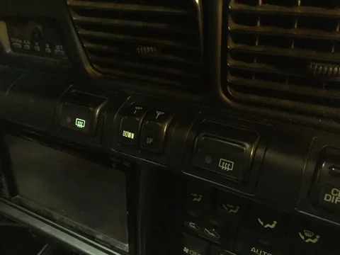

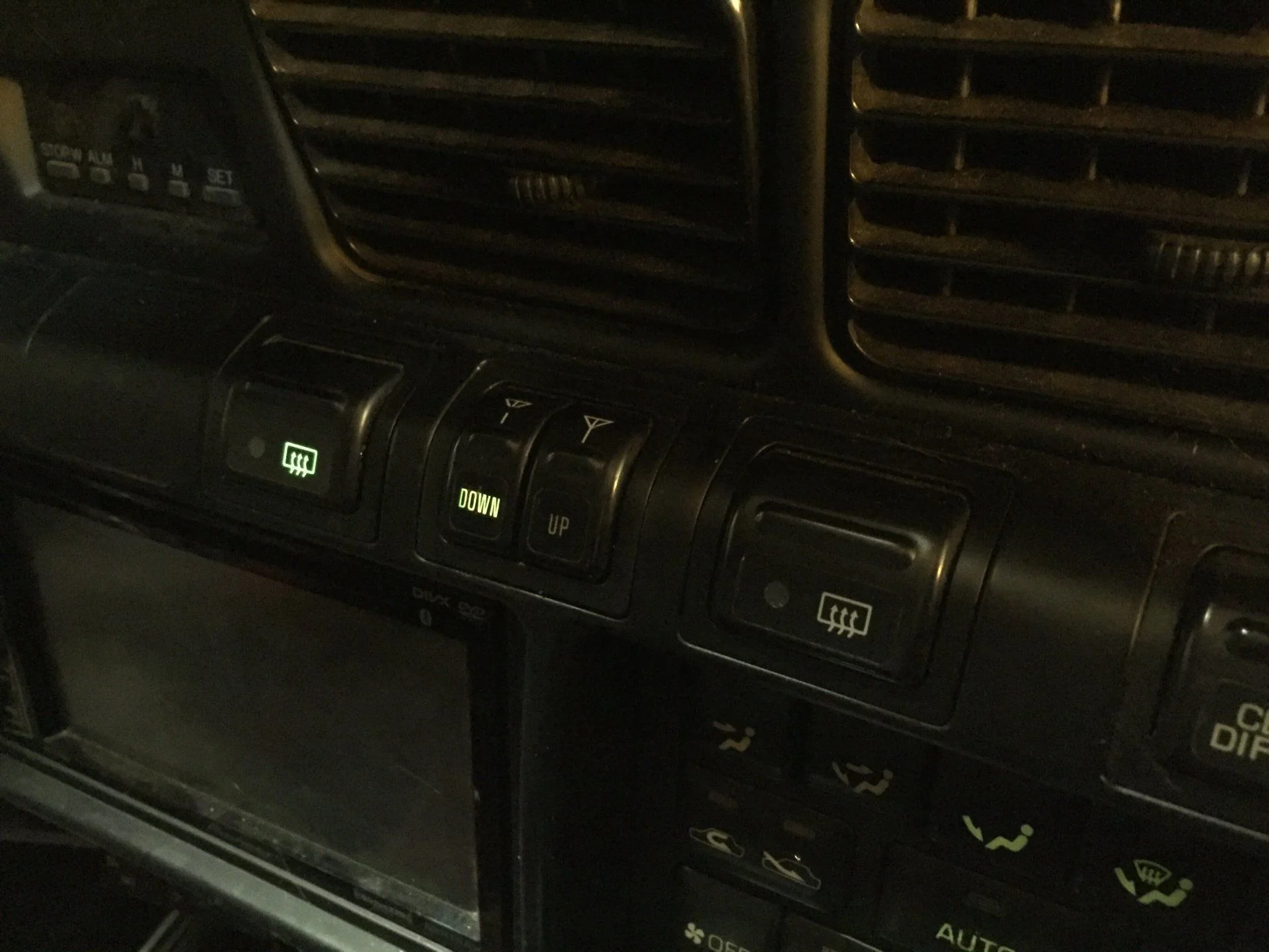

Installed a Toyota defrost toggle in one of the blanks, and wired it up (its the one with the working backlight). Still waiting for this so I can wire it all in to the remote entry system:

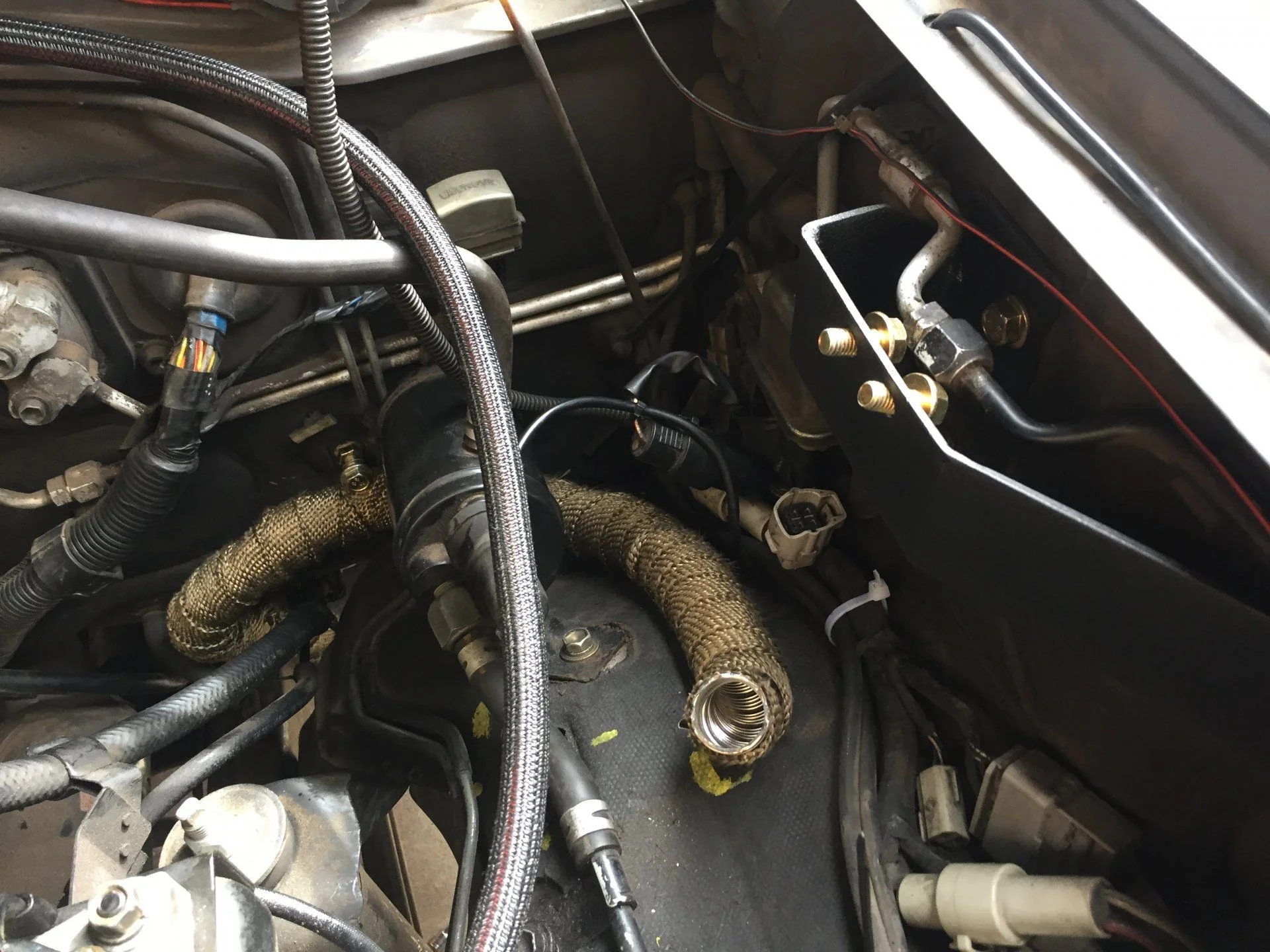

And heres the exhaust routing:

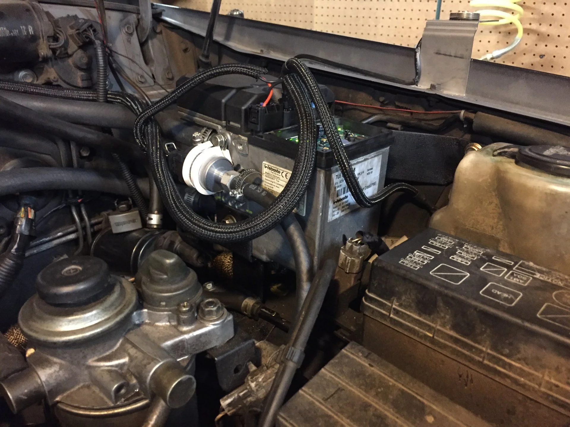

Here' everything together (although much cleaner now that I routed all the wiring).

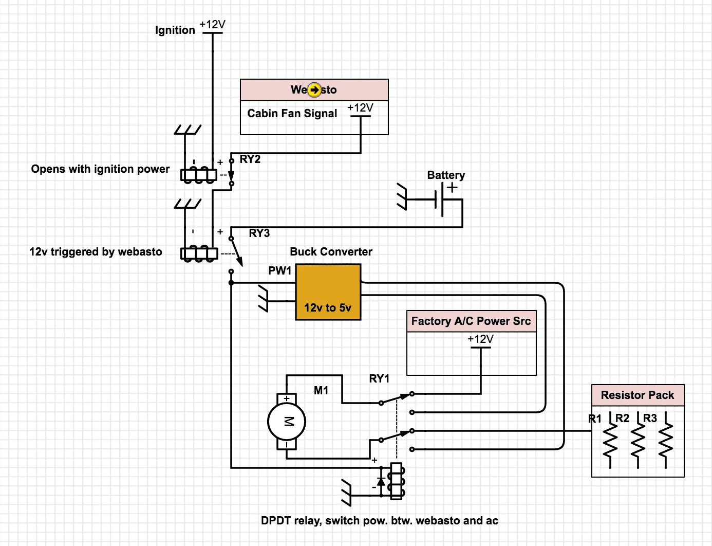

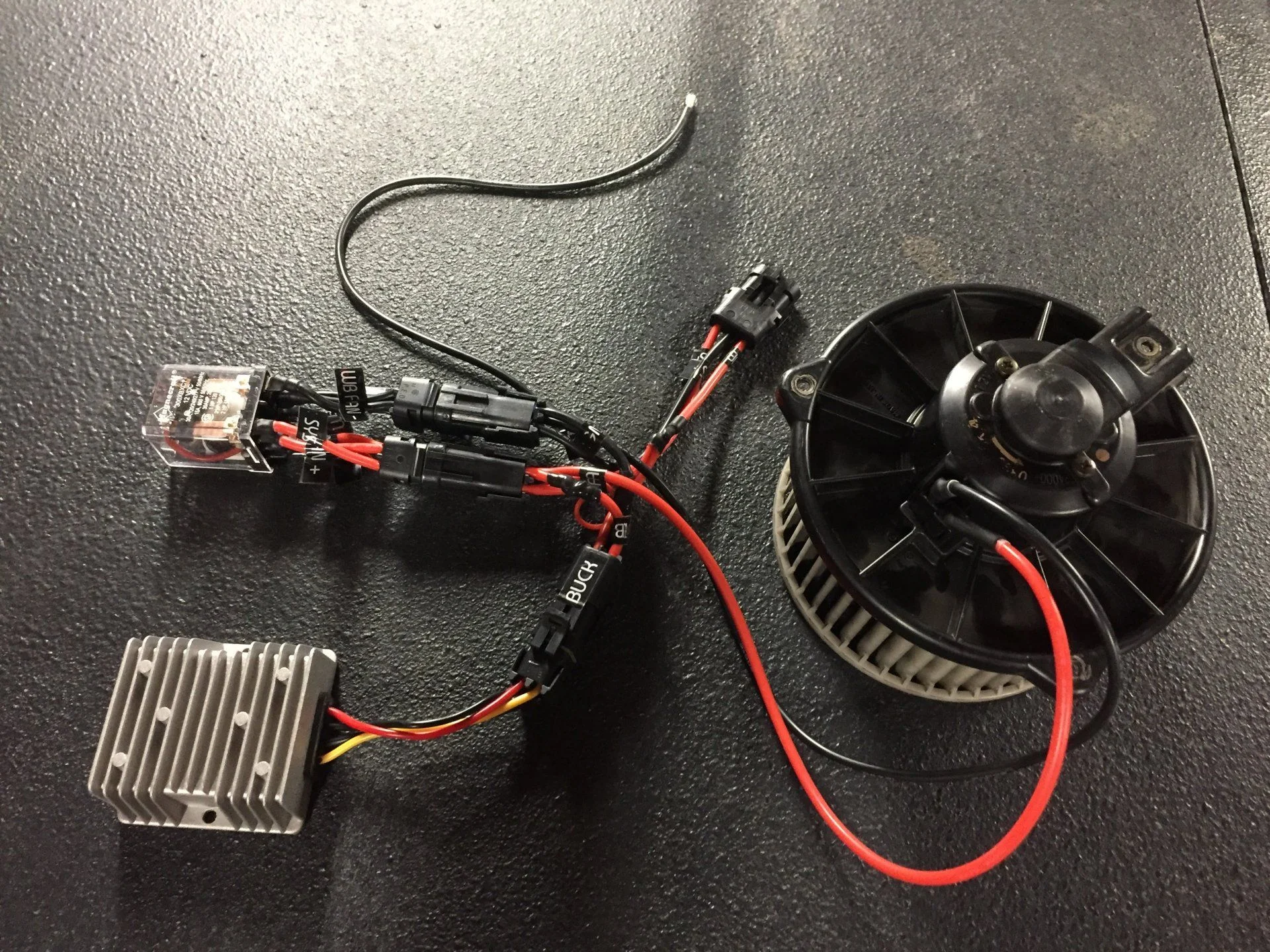

In the meantime, I'm trying to figure out how I can connect it to a blower fan. Hoping I can apply positive voltage and bypass any relays in the climate control system.
Ok, having some problems getting the blower fan to work. Thought I'd cross link my thread here, in case one of you smart diesel guys might know what's going on. Basically it is popping 30A fuses when I try to apply direct power to the fan.
Operating blower motors without keys/ignition on
Blower shouldn't pop 30a fuses unless your wired backwards. Try applying power to the switch or resister coil.
@Pacer I don't think its a polarity issue since the fan works fine when connected directly to the battery. I would much rather use a low amp signal to trigger the switch as you said. I'll admit I'm not all that great at reading the Toyota electrical schematics or electrical engineering in general, so I'm opting to isolate the fan with a dpdt relay. Pretty sure that will work fine, but if anyone knows where I can tap into the Toyota switch I'd be all ears, as that would be ideal.

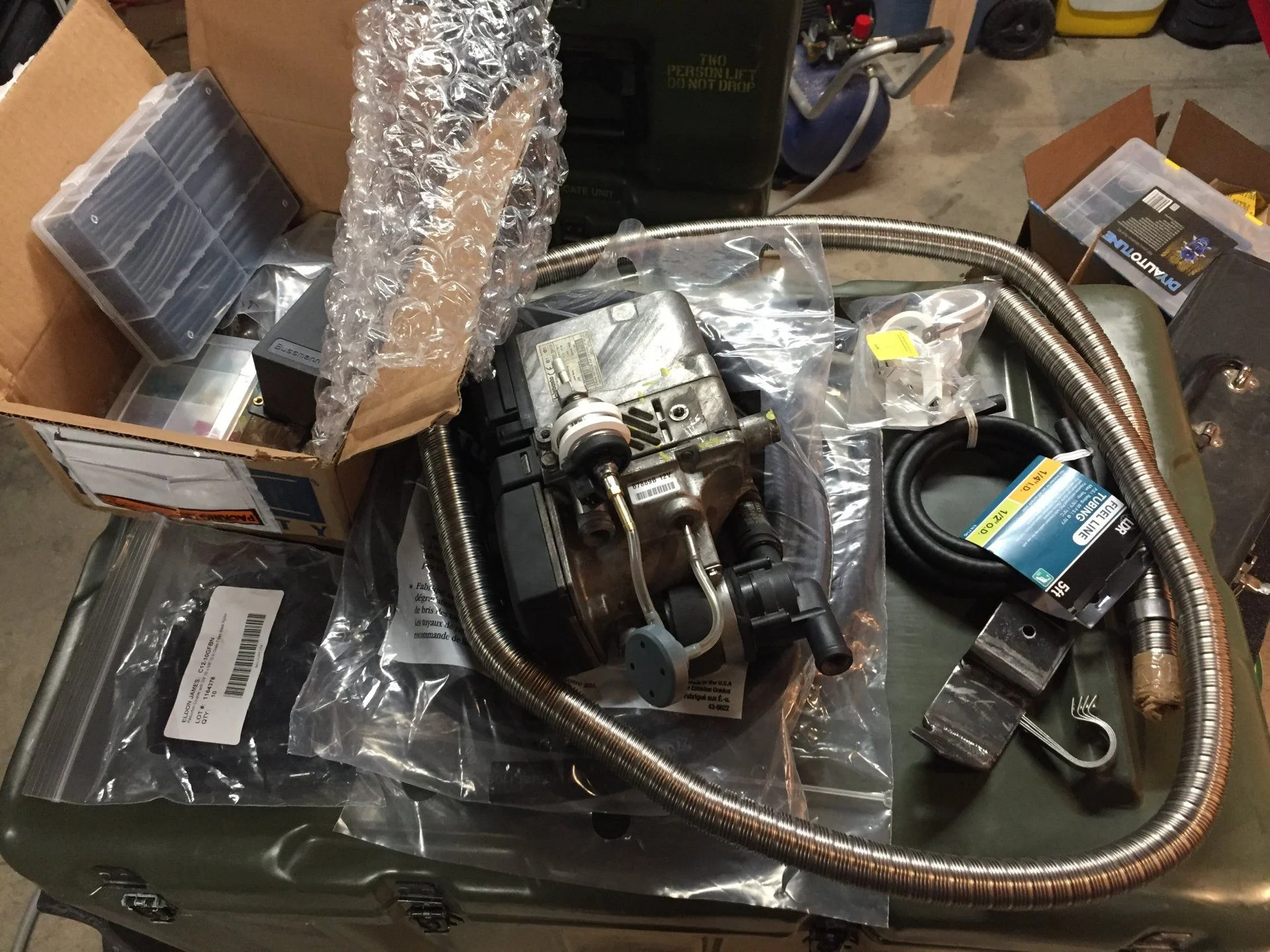

Got my hands on a brand new thermo top unit locally for 700$. The guy was nice enough to trow in a used Air Top 2000st with all the bits needed for free!!

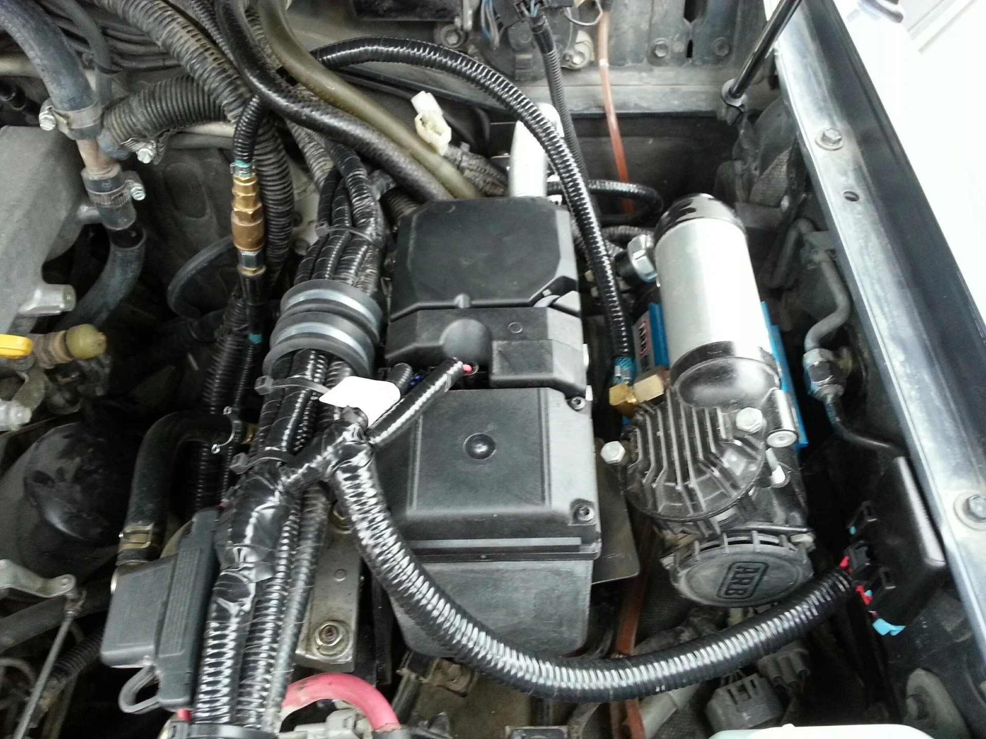

The challenge for me was the previously installed ARB compressor in the location that everyone installs theirs. I was trying to avoid having to relocate it and all the plumbing and wiring that comes with it.
By slightly adjusting the angle of the compressor and the air outlet, I managed to squeeze the Webasto between the fuel filter and the compressor.

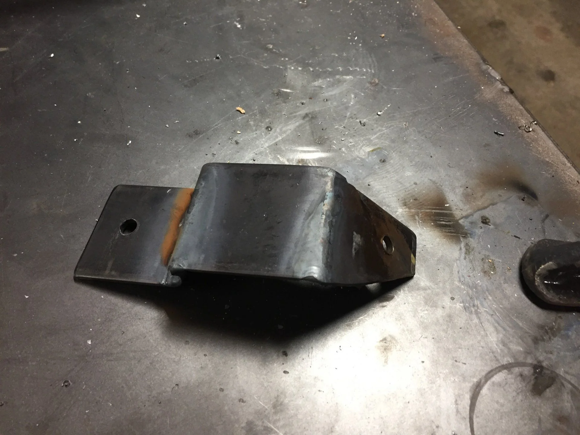

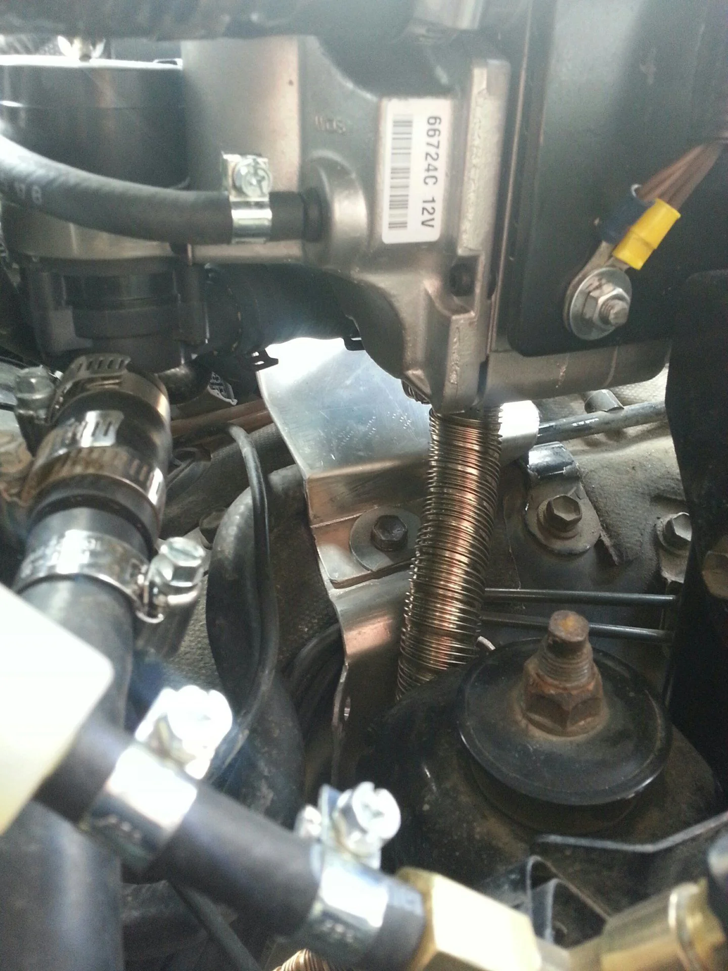

I welded a simple piece of 3/16 steel to the fuel filter bracket
I also bent a couple chunks of 1/8 aluminum plate to create heat deflectors the protect vacuum and brake lines from exhaust heat. looks terrible, but it is invisible when the heater is in place.
