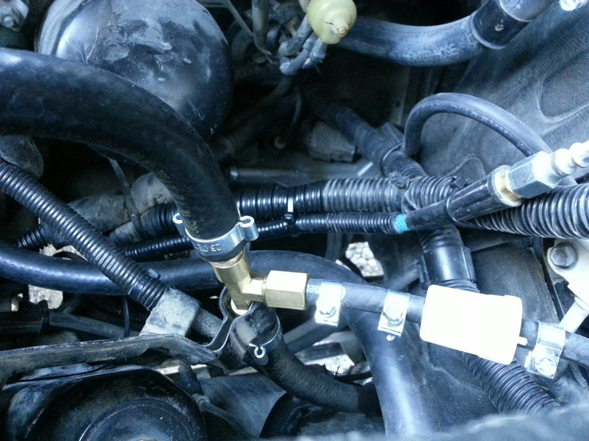

I Tee'd into the factory fuel line for ease of installation and so far it works flawlessly. Contrary to what is mentioned in a previous post, the barb fitting size for the factory fuel line is not 3/8" but 1/2" and the barb fitting for the Webasto fuel line is not 1/4" but 3//16".

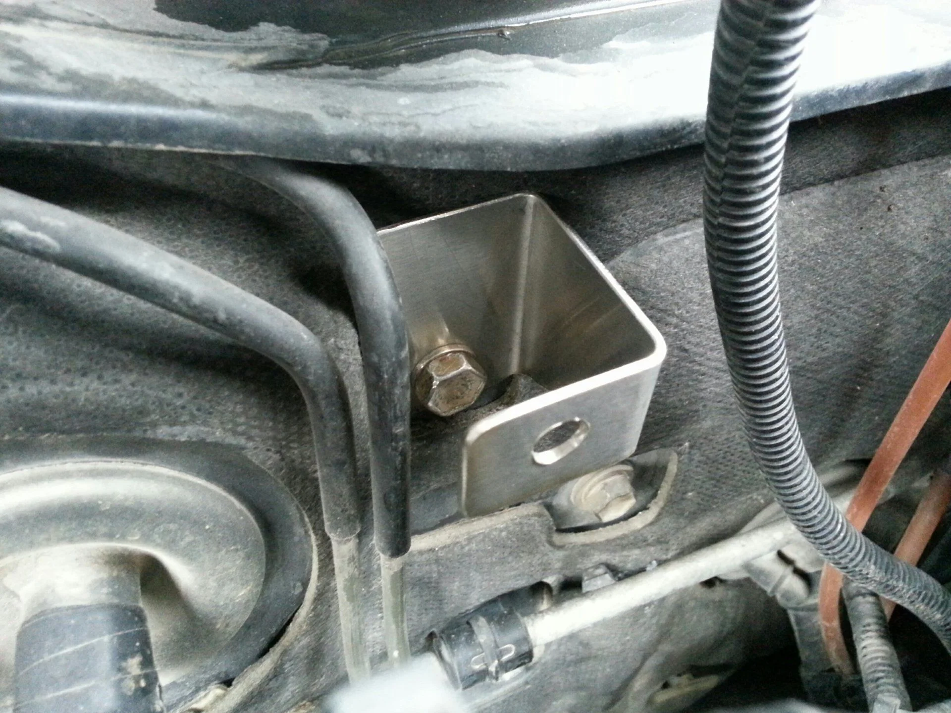

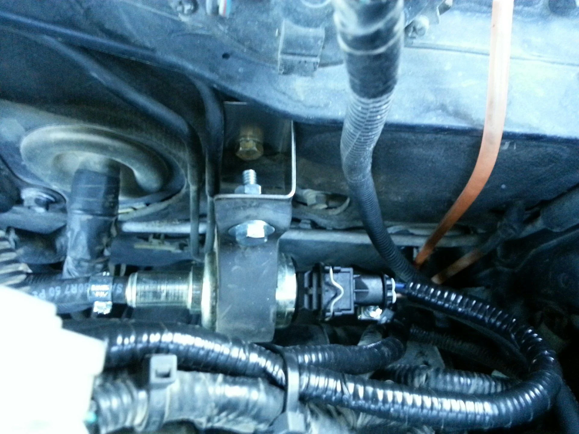

Due to the lack of space beside the heater, I mounted the fuel pump on the fire wall, using existing threaded hole.

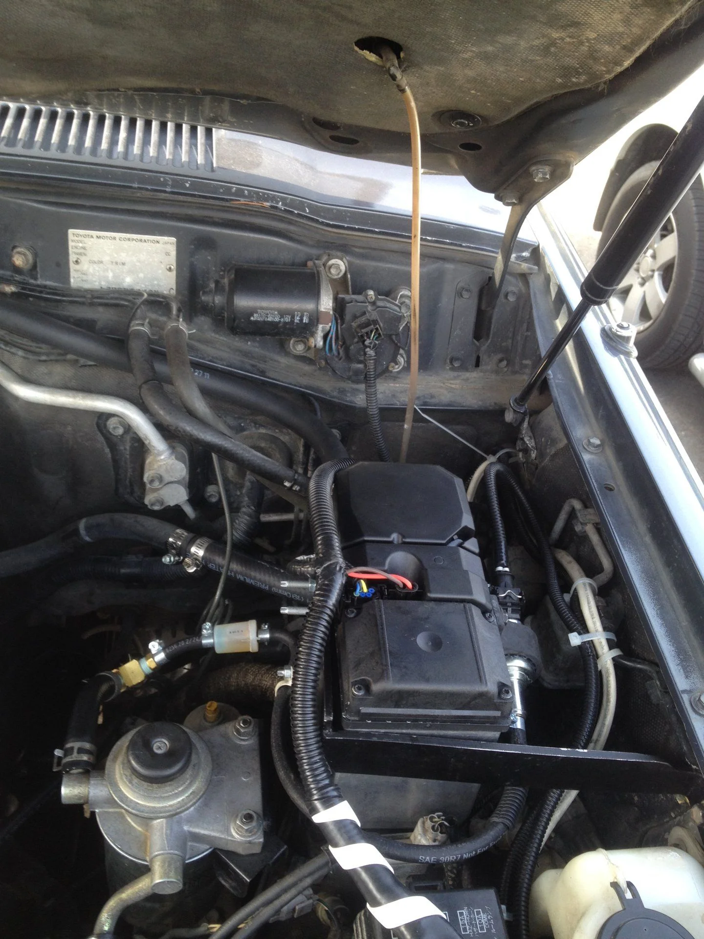

The exaust is fastened via stainless zip tie thru holes in the heat shield and a S.S. bracket on the inside of the fender.
I used the 7 day timer to operate the unit and mounted it under the factory diff locker switch.

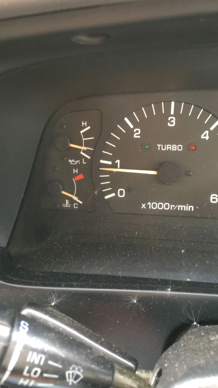

I have installed the webasto Thermo Top C in my HDJ81. Thanks to the information here the install was fairly straightforward. Heater is working, however I’m not really satisfied with the efficiency. Current temperatures at night are around -2C to -5C and in the morning after 1 hour runtime the cluster gauge needle is just a bit above the C line.
It certainly makes a difference with the cold start, however I was expecting to have operating temperature after one hour runtime especially at these mild outside temperatures.

2. The temp needle drops a good 30-35% once I fire up the engine. I can’t logically explain why.

2. It's not hot enough to open the thermostat is my guess, once the engine starts the thermostat opens and the cold coolant from the radiator is mixed in

According to that document, these things max out at 77C on the high setting, which I don't think will be enough to open the t-stat, so that's not supposed to happen, you'll never achieve full operating temp.
It's close to full operating temp. I think it opens the thermostat enough to circulate through the rad, when I first did it (a few years ago now) I recall checking things over with an IR temp gun and the entire coolant system was warmed with just the Webasto.

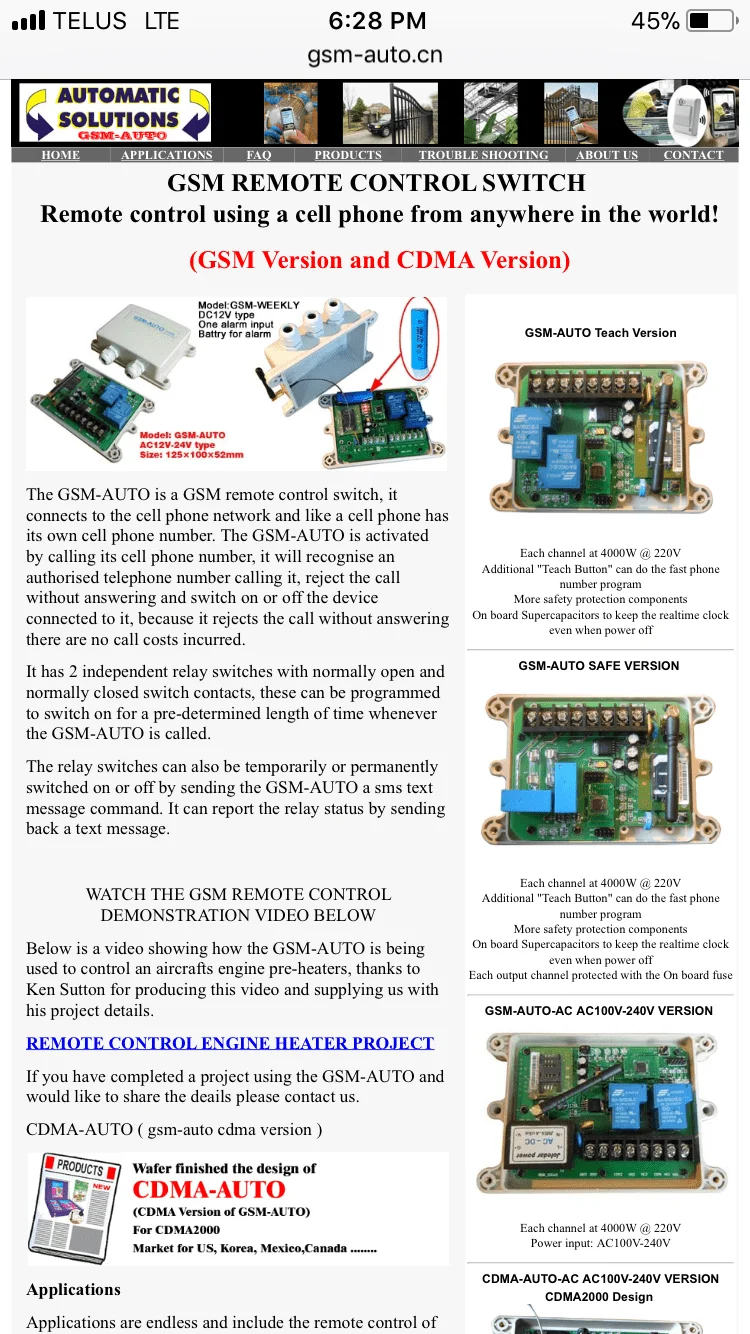

anyone running something like this ...
i’m looking to set something like this up but most of these run off gsm sim cards and in canada there’s only one network that carries one and it has crap coverage. i need a cdma one. just looking to see if anyone has experience with how well it might work
