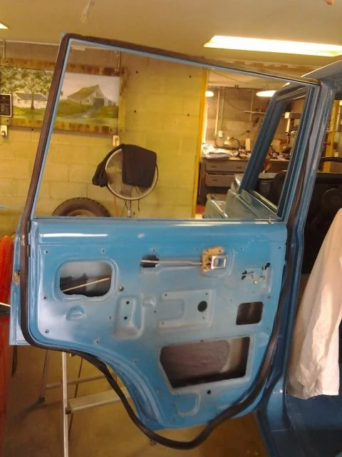

I've got to get pics, but the doors are now all done with 75 series door seals (pre '99) i also did the rear barn door seals using leftover 60 series door seal and a 55 door seal. I had one 55 door seal that was still soft but broken in sections but i've stuck it on and made it work. Could have easily done it with another 75 series seal as well. All seals are really tight and you have to give the door a good slam for them to shut properly. The seals don't rub on the latch so they shouldn't wear down over the years. I also replaced the seals on the windows in the barn doors. The seals i had were ok but i ruined 2 of them while trying to put them back in. They were too brittle and the rope just sliced through them. I'll get some pics of the progress tonight as well as the 75 series door seal part no's
