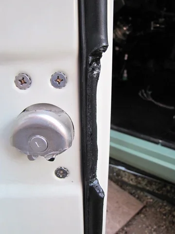

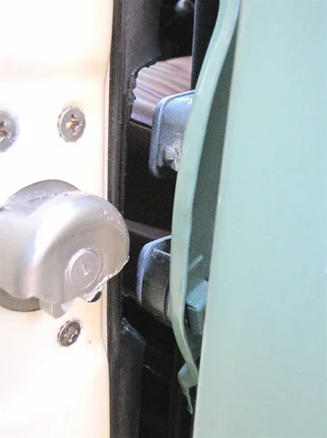

Scrapdaddy, I used OEM glass that came with the doors. Is the OEM thinner than the cut glass? It seems to be close to 1/4" thick and I definitely had the same problem as you did. I'll try and take pictures of the cut area around the door strike. It isn't as clean as I would have liked. I'm thinking about gluing some smaller pieces back in place to close up the now exposed ends of the weatherstrip.
Hmmn… I use a glass guy here for large shower doors and enclosures. He told me they cut and hone the glass and then run it through an oven to temper it. I'll have to ask him if 1/4" thick glass is too thin for him to temper. He was going to be my go to guy if ever I needed replacement glass.
Here you go Scrapdaddy. Like I said, it's a bit crude of a trim job, but it's better than the door strike eventually tearing apart the door seal.
