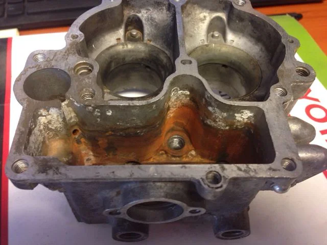

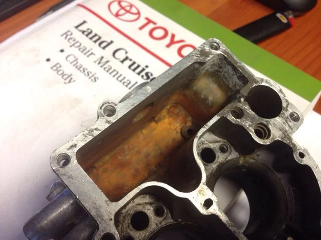

Now the carb body is a different story. Granted it was only in there for a couple of hours, before I did a rinse and scrub. Is that rust in the bowl going to come out with carb dip? Do I need to completely get it out?

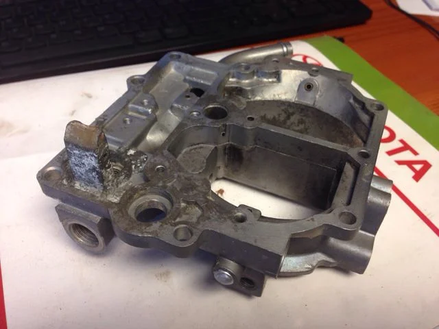

Also, found the missing pump inlet ball. It's still down there rusted and pretty well stuck. I tried compressed air and scraping around the edges of it, but it's seated solid. Any idea of how to get it out? If I can't get it out or if the rust is an issue, then this rebuild may get shelved until I find another suitable replacement.
Gasoline with ethanol is a pretty strong solvent, so if the parts are not clean there is a risk that running fuel through it will "clean" it, loosening crud in hidden places.
That bowl is pretty rough. It might be easier, and for peace of mind, to use a better starter carb off ebay or the classifieds.

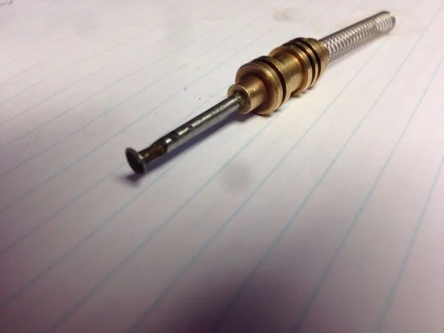

For what it's worth, I was able to dislodge my stuck inlet ball by grasping a sewing needle with forceps and working it around in there. I've heard though that if you reuse a stuck ball, it's likely to get stuck again.

So, after about another 2 days of dipping and scrubbing the carb bowl, it looks like a lost cause, since the pump inlet ball has found its final resting place and isn't leaving there anytime soon. Plus, the rust isn't much better and I'm not putting a rusty bowl into this rebuild.

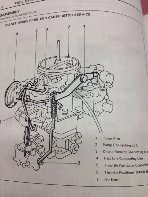

I checked my junk box and I don't have the arm that connects the accelerator pump arm to the throttle linkage. I have most of the other parts for an April 1978 carb, including the three main castings.
When I tear the later carb apart on wed this week, I'll see how that one looks. If it's in sad shape too, you'll have some utz flying your way!
Do you have a picture or drawing of what this arm/linkage looks like? I have a '79 parts carb that still has some things on it, if I have one, bmorefj40 can have it for the ride cost.
Skip
I'll find a pic of the linkage and post it up

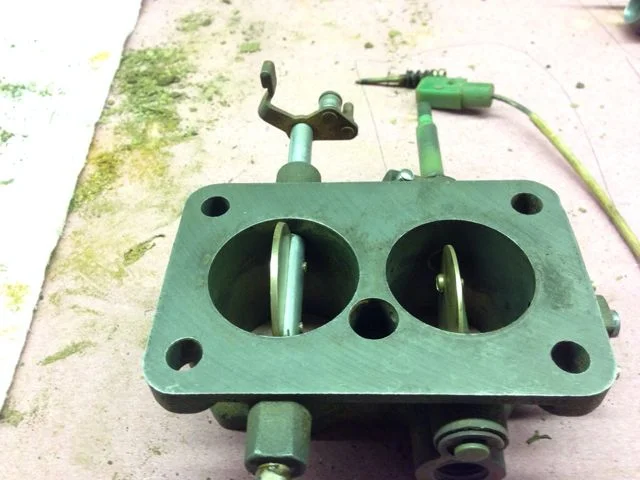

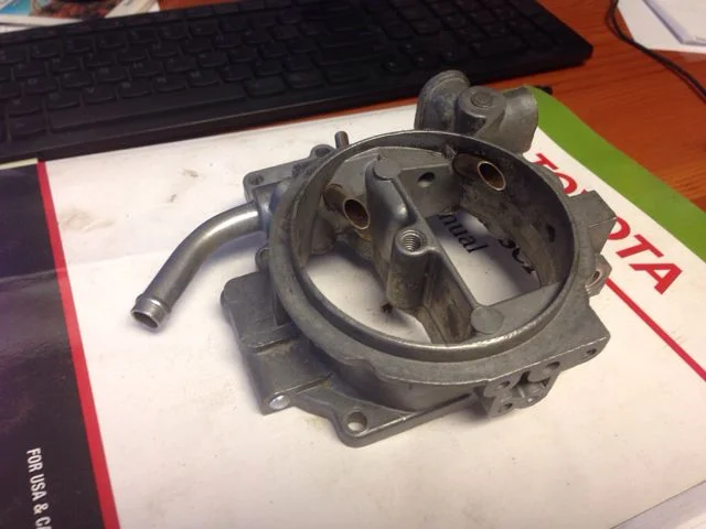

On a side note, the butterfly assembly came out better than I hoped. If you go back to post #25, you can see the before shot. Put it back in for one more dip just to dissolve anything I may have knocked loose while blowing out the passage ways.
Here's the after. Took some steel wool to fix up the minor pitting, but I put water in it and held the assemblies closed as well as the ports and it didn't leak so I think it's saved. What are you guys putting on the cast iron portion after soaking to keep it from rusting? Paint, clear, oil?
