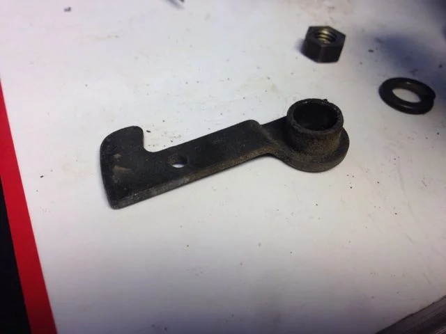

It has the #1 (pump arm) on it, but #2 is missing (pump connecting link). The pump arm is shaped different than what is in the diagram, guess that's what Jim was talking about. Sorry I couldn't help ya...good luck, I'm sure someone has to have one, as many of these carbs have been switched for Webers.
Thanks for looking. I put up a WTB in the classifieds. I could probably get the jet from almost anyone, but the pump connecting link is going to take some time to track down, but since that is the last part to be assembled, I'm not too worried about finding it this minute. Hope to start reassembling today!

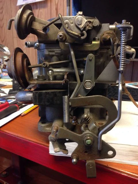

Ugghhh. I think i'm ready to throw in the towel on this one. Been trying throughout the day whenever I had a few minutes to get the linkages correct, but I think this might be too 'bastardized' to work properly. So, I started out with using the carb body from the 80-87, since mine was rusted beyond salvation. That swap was pretty straight forward. The reassembly of the carb also went together without too much fuss, but the linkages are driving me crazy.
1. I was missing the plate with the ball joint on it that connects to the linkage for the gas pedal and the linkage for the pump connecting arm. So, I swapped in one from one of the other carbs I had. Not a big deal and was able to connect the pump arm again. But this change also forced me to swap out the throttle positioner connecting link and fast idle connecting link. Looks like it should work, but having someone reassure me would be great.
2.My original choke shaft was very bent and so I had to swap out the choke shaft from another carb. the clocking of the end plate on the linkage end was close, but still a few degrees off. To compensate for this, I used the choke breaker from the other carb and it linkage. Seems to work through the range of motion and some vac on the breaker will pull the choke back open. So, I think that is ok.
3. The other issue that this caused was that the previous choke breaker had two linkage points instead of one (one for the choke breaker and the other linkage went to the throttle positioner. The new(er) choke breaker only has one point of engagement, so that forces me to also use the older choke breaker as well to connect straight to the throttle positioner. Therefore, I have 2 vac devices, one to actuate the choke breaker, and the other to actuate the throttle positioner, would that work?
I'm not afraid Frankenstein this carb together, but I want to make sure that I can still use this set up reliably. Or have I gone too far off the beaten path and its now time waive the white flag, buy a trollhole carb that will work with my existing cable linkage, and call it a day?

eureka! Well, I think taking a step away for a little bit and coming back to it helped me. plus staring at the link that pinhead posted made me realize a few things. I was able to get another choke shaft from one of the carbs loaned to me for the jets. (I'll owe him some beers for poaching that part) That solved the linkage issues for the choke breaker and throttle positioner. Next, I realized that I was missing parts from the original linkage which is why I turned to getting parts from the other carb. But it was just one part in particular, the hammer shaped piece. I tried getting it from the other carb but it wouldn't fit (too big of a bushing on it), so then I swapped over the whole assembly which got me into a bigger mess. I went back to the original configuration and borrowed yet another piece from the loaned carb. this was about an 1/8" too small, but some washers next to it took up the slack and I think I finally have a reassembled carb! just need to put the retaining clips on and then check tolerances of the openings of the primary and secondary and set base adjustments per FSM.

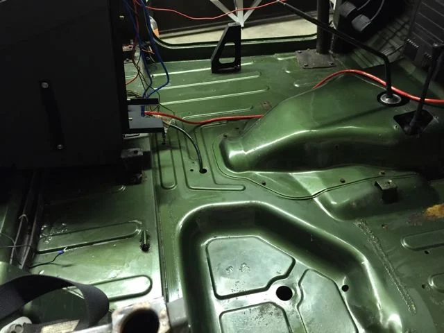

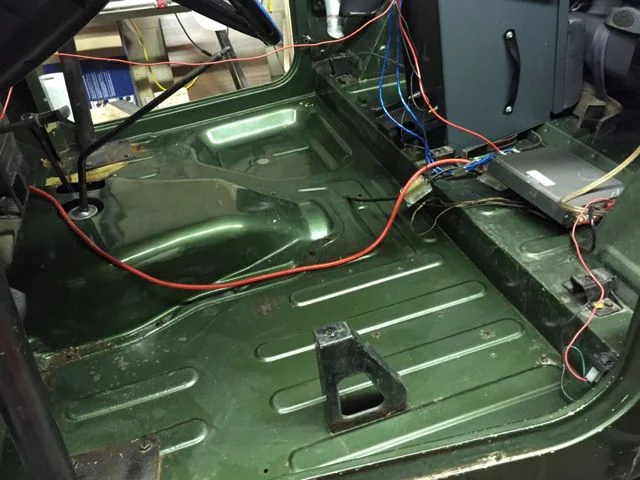

Issue #1. Remove old seats to access fuel tank. Sounds simple, but the PO thought it would be a good idea to weld aftermarket seat rails to stock brackets, and then weld the stock brackets to the seat posts and mounts. Carefully using a grinding wheel, I was able to cut out one seat at a time, then grind off all the old bracket to salvage the seat posts and mounts that connect to the body. Then I was able to rip out all the old carpet and give the body a good scrubbing, since it hasn't been done in the 10 years that I've owned it.
Issue #2. Remove old tank- easy. But then I had to replace all the rubber lines along the way to the fuel pump and install a return line that didn't exist, plus install the evap system with all the required hoses. Also, needed to modify the retaining straps since they were too short. (guess the originals were mod'ed for the poly tank and I had to make a bracket to lengthen them)

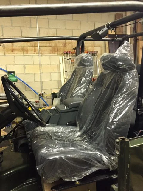

Issue #3. Old seats are now toast, so I replaced with new bestop trailmax II front seats to match the rear bench I put in previously. Had to fabricate new mounts to attach to the original seat brackets. This wasn't too bad, just a lot of trial and error to get everything to play nice and not interfere with new stock tank and my sub box under the driver seat. Then the obligatory, "while I'm in there", to prep and paint all the old brackets, replace some hardware, and redo the wiring for all the accessories like the cd player, amp, speakers, lights, etc...

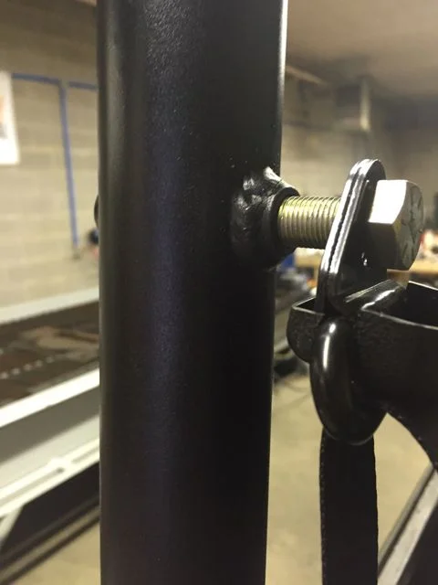

Added four 3pt seat belts and cleaned up some more wiring. Then touched up the paint on the back half of the roll cage.
