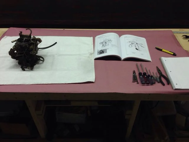

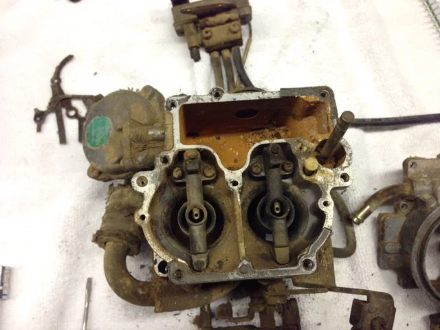

Well, instead of just staring at these carbs in front of me, I decided to jump right in and tear one apart to see just how tough it would be to get apart and see how complicated it would be to put back together. I chose to do the 21100-61024 since that would most likely be the one I would use, plus it was in way worse shape and may help someone else later on if they are trying to figure out if they're carb is salvageable. If I can save this one, which looks like it came out of the bottom of a lake, then anything is possible. Overall, it was easier than I thought to take apart (we'll see how reassembly goes...)
Here's a list of my concerns. If anyone knows that some of these would be a deal breaker for a rebuild, please chime in.
1. Pump Connecting Link Missing- That was step 1 in the FSM, so I didn't get off to a good start. Both carbs were missing this part
2. Float had a metal bracket around it that I didn't see in the FSM and it was heavily rusted and looks pretty bad (don't know if I could reassemble without this).
3.Power Piston was almost unrecognizable compared to the FSM
4.Choke valve Plate screws broke off. both of the heads pretty much fell off as soon as I touched them with the tip of the screw driver

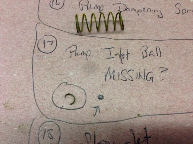

5. Pump inlet ball and clip were non-existent. However, that area was heavily covered in debris and rust so the ball may still be done there. After I dip it, I may find it hiding down there. I found what looked to be the remains of the clip. It looked like a "c" instead of a "G"
6. AAP- didn't have one. Is that necessary for a non-smog 75 2F? Also, that means I didn't have the aap check ball either
7.Secondary Diaphragm was toast, so I would need that for a rebuild.

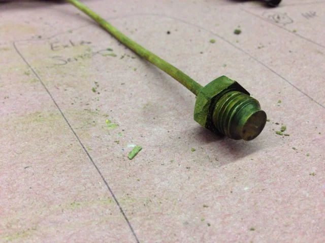

8. An extra sensor near the base was there. I don't know what it does or if I need it going forward
9.Jets are shot and I can't tell what size is in there. Had a really hard time getting one out and it got mangled, so I would need to order new ones
10. RUST- its everywhere inside this thing. Even with my organization system that adds some extra time to the teardown, I really had a tough time with almost each and every screw. Probably took me two hours to take it apart and label everything. I think if I didn't have to fight so much with it, would have been way under an hour.

61024 is federal, low altitude 1978 2F.
61142 is 85-87 USA FJ60.
Neither one is a bolt-in on a F engine. F aircleaner won't seal on top, fuel line entry is different, 61024 has fuel return, 61142 has different choke cable end...
