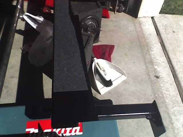

was bored so i made some sliders over the weekend, just gotta weld em on. i used some skate board grip tape for traction when they get wet, looks really nice, ill have to take some pics installed

How many mounts are you planning on fab/installing?
The near end looks like it may be stepped as in a box tube with a sheetmetal "L" metal on top. Is this accurate? If so this is a great stiffener and weight saver.
Look forward to seeing the additional pics! The skate board grip is a good idea. If you see mud allot you may wish to consider a piece of expanded metal on top where you typically place your foot. The grit will foul with mud and become slippery if you hit much wet clay or mud.

i thought about the whole mud thing and i dont really do mud. more rocks than anything. and i h8cleaningmud off my rig it gets everywhere.

Good tip on the grip tape. I was going to put some on my sliders, but mud is a way of life out here, unless you don't get out much.:beer:

few installed. they came out really nice and are bomb proof, cant wait to try them out
Hey cool set of rock sliders almost and i say it while grinding my teeth to pretty to drag across the rocks , nAAAAAA go for it. NICE JOB !!
Are you bolting them to the frame or welded on? Is that 2X4" tubing? Very clean look. Congrats!
i was going to bolt but then went with welding. dont plan on talking them off and the are strong as hell
2x4 tube
