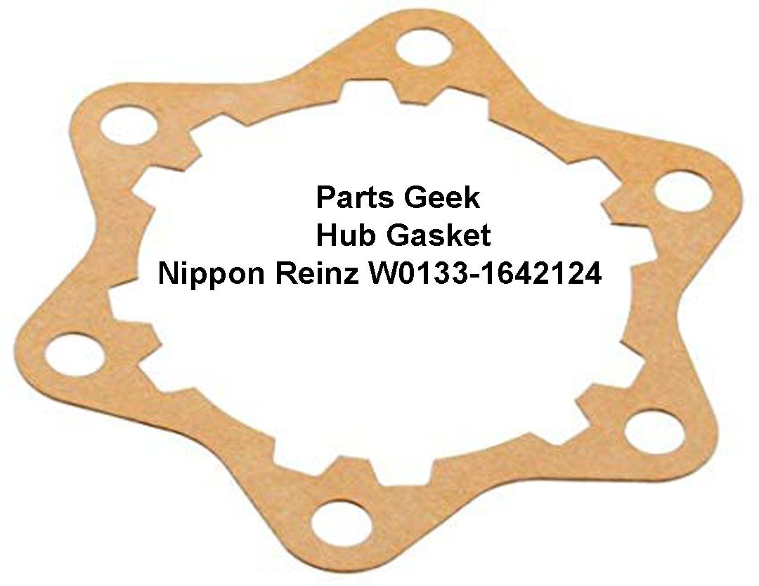

But!! In my search I found if I punch in 74 Landcruiser at Parts Geek it says this gasket fits my vehicle. It sure looks like what I need. Might try a few. $3.58 each and $11.95 shipping for two. If I knew they fit I'd get a dozen.

Spoke with Jeremy at Warn customer service. For some reason he couldn’t pull up the complete kit picture like I could. He could only pull up individual pics of the kit parts breakdown. But,,, he couldn’t pull up a pic of the one gasket I need. Uh oh! Discontiued maybe? He asked me to email him pics and he would try to track it down which I did. I went ahead anyway and ordered the Parts Geek gaskets on a chance they may work. I did find out the model # for my course spline hubs. Warn 28781.

Well the Nippon Reinz gaskets from Parts Geek just arrived and they almost fit. It’s hard to believe that Warn would make two hubs that are that close but different. I’m figuring is just a sloppy cut. I could elongate the holes inward and make them work. Quite tight in areas of the inner perimeter also and I had to force it on. May have to trim that a bit as well. Guess I’ll wait for the two from Warn to arrive and compare.

Yup, I trimmed a 32nd all around the inside perimeter and elongated/punched the holes. They'll work. But If I button them up now, then I can't check the ones coming from Warn so I'll hold off till they come. Should be soon.
