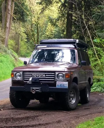

Britklr: love the look of the wide stock wheels on your 60
Anybody got a decent looking pic of a 60/62 with a 8274 mounted?
Here's mine with an 8274. I've had a few winches but really love this one.
