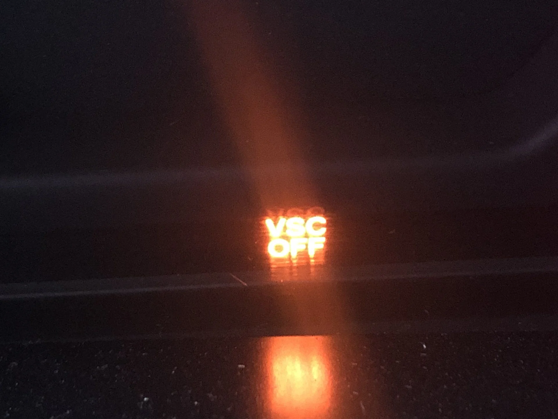

never been so happy to see a light
btw i gave myself a scare...crimping the ground wire to the ecu was such a bear i celebrated to early. as soon as i crimped i was likke yesssssss! started the car and saw brakes and abs lights. i was devastated then i remembered DUH connect the terminal to the ecu!
Now you just need to pull that bulb out.
