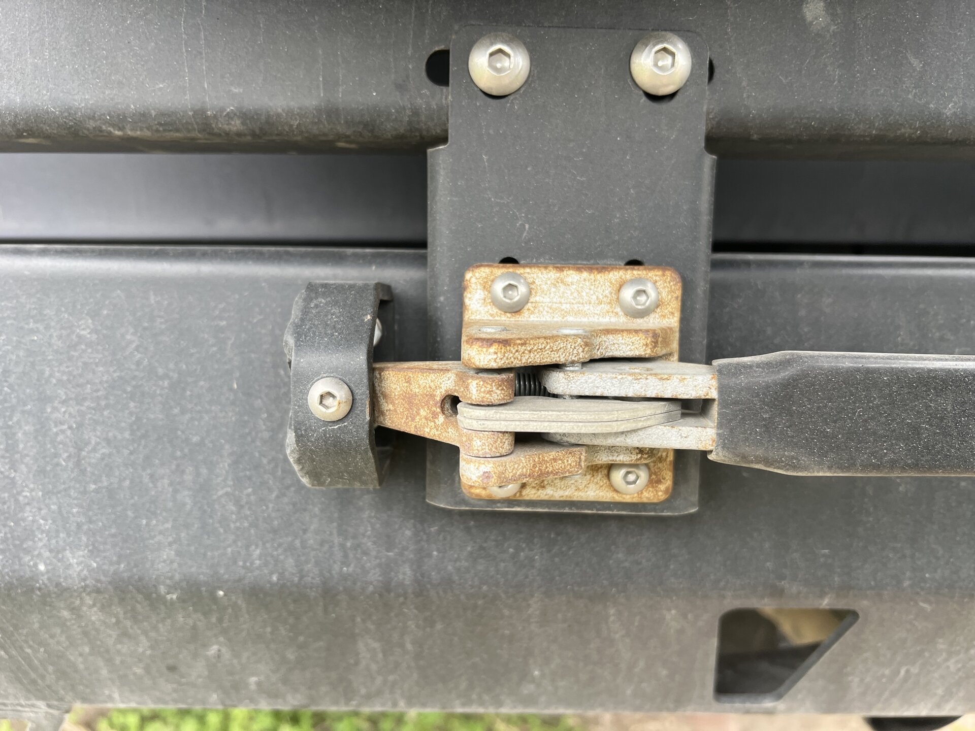

Anyone else’s latch look like this after 4 months?
Anyone else’s latch look like this after 4 months?View attachment 3265880
Proper "De-Sta Co" clamps shouldn't do it. I have de sta co clamp on my rear swing and 4 years later, just fine. You may want to swap that out for one or just juice it up with a wire brush and some WD-40.
A buddy of mine had his installed a month or so before mine and his is rusting too, but he said mine is worse. I’m gonna take it off and wire brush it when I put the passenger side carrier on.
