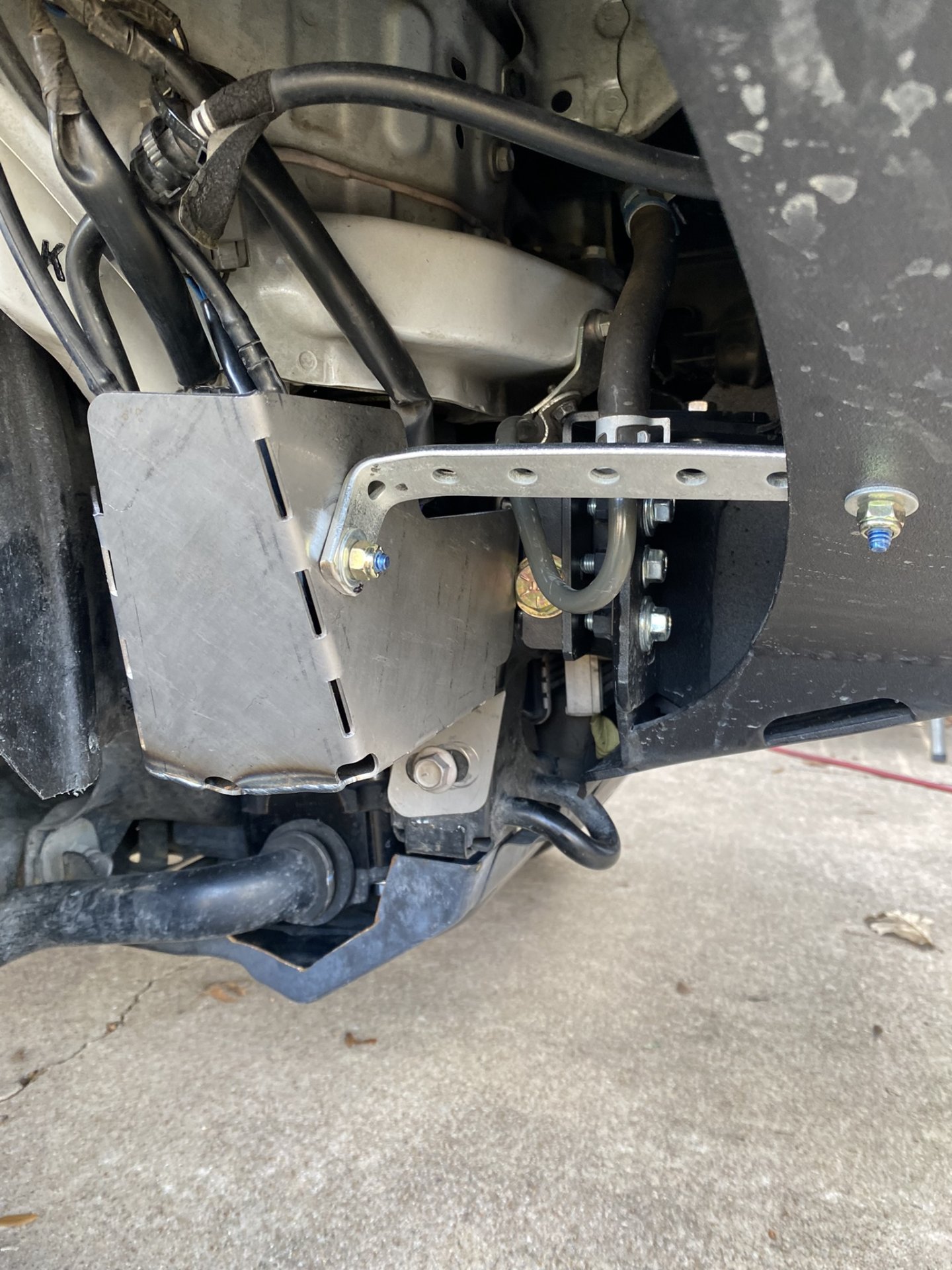

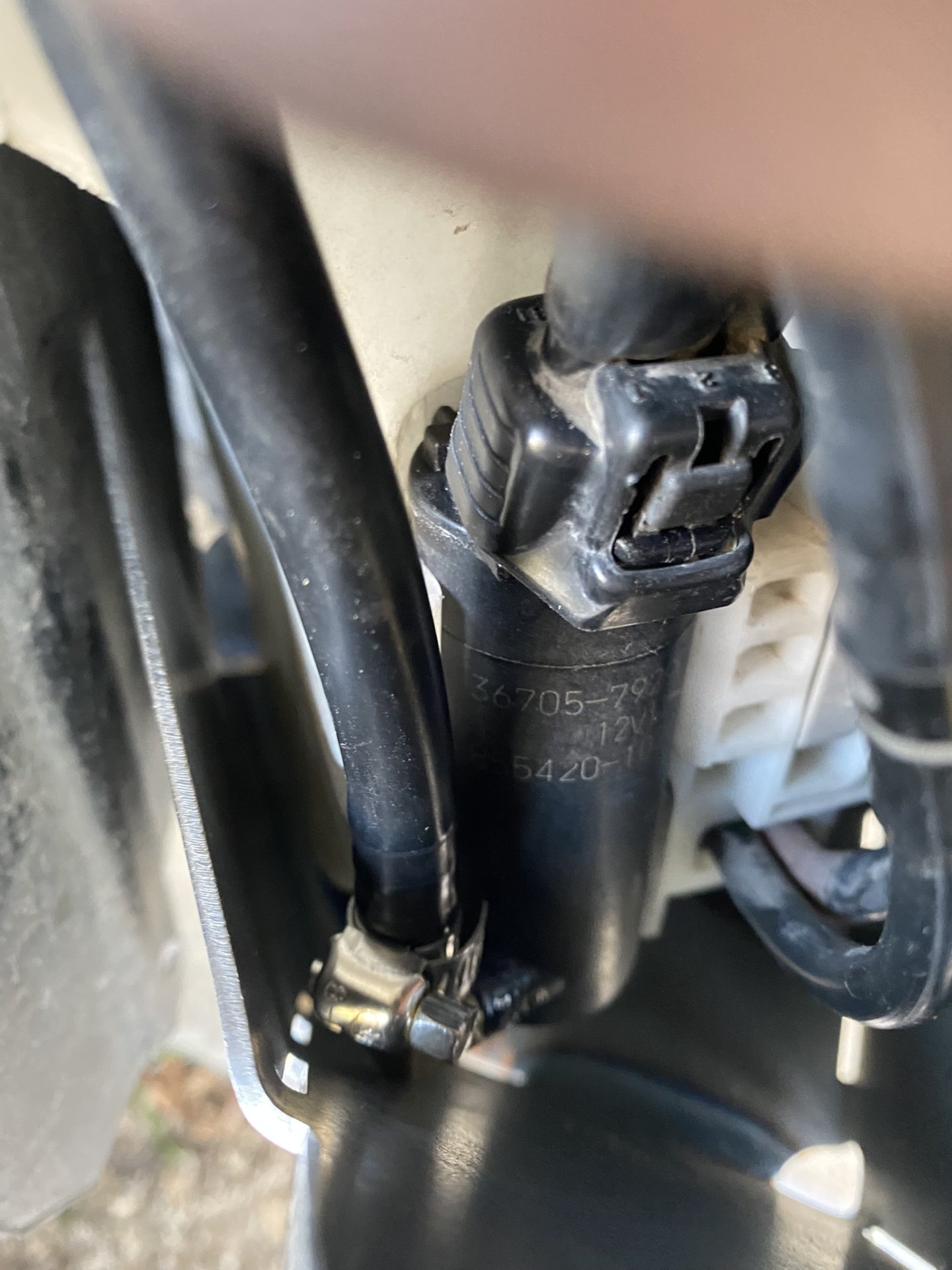

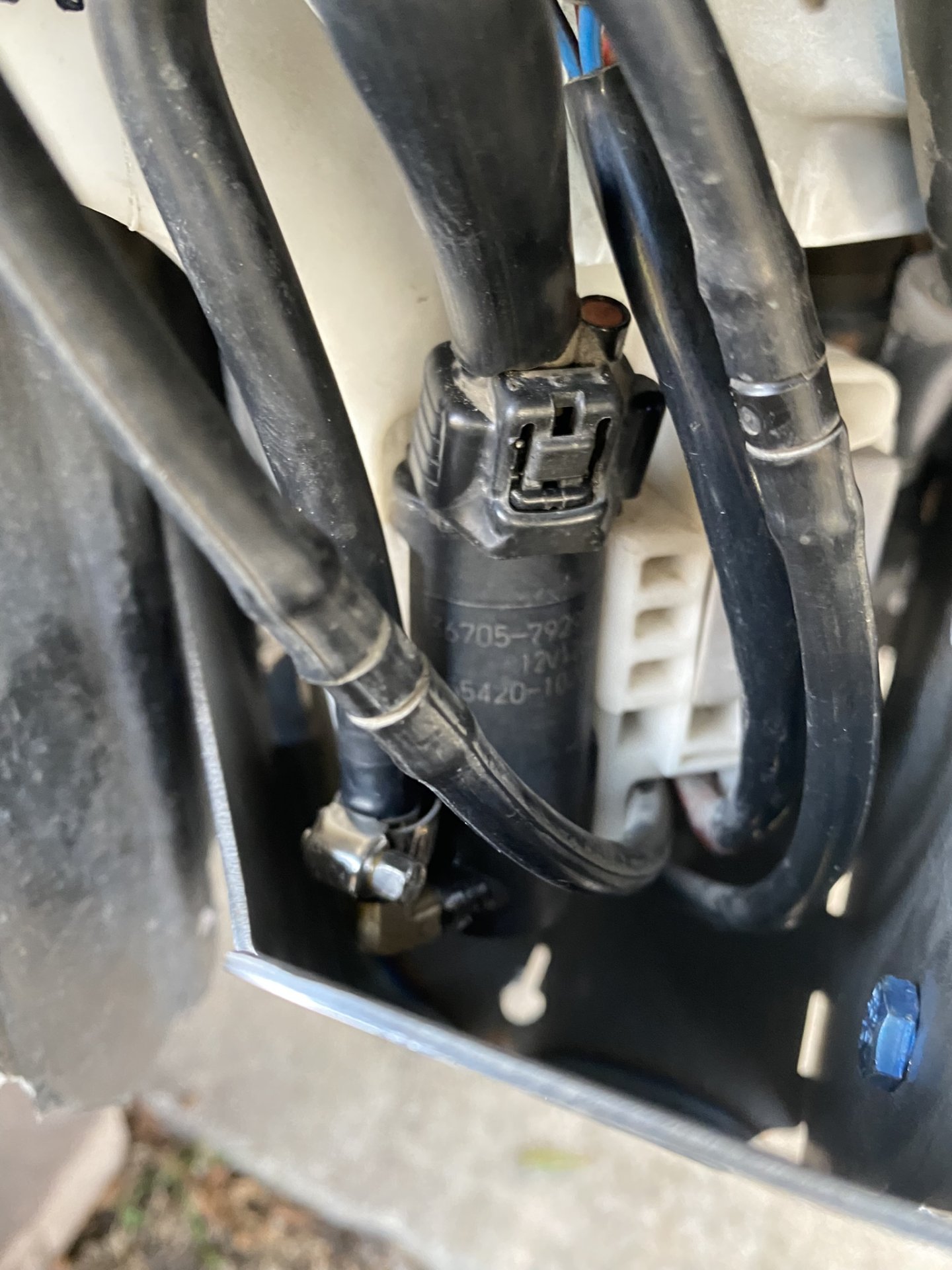

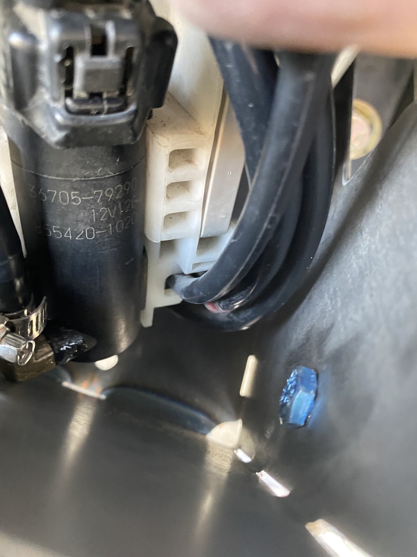

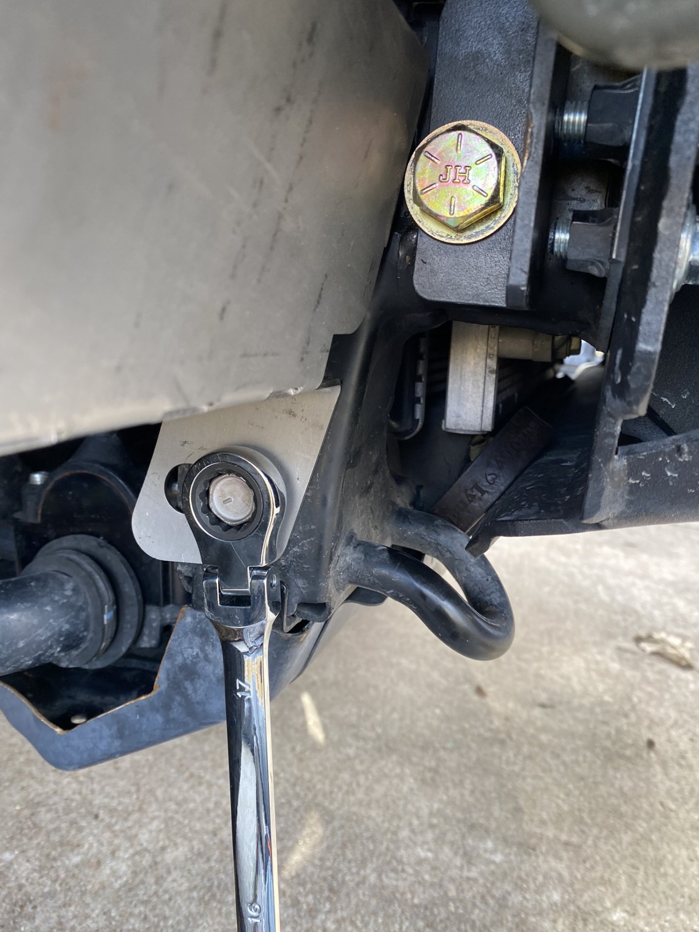

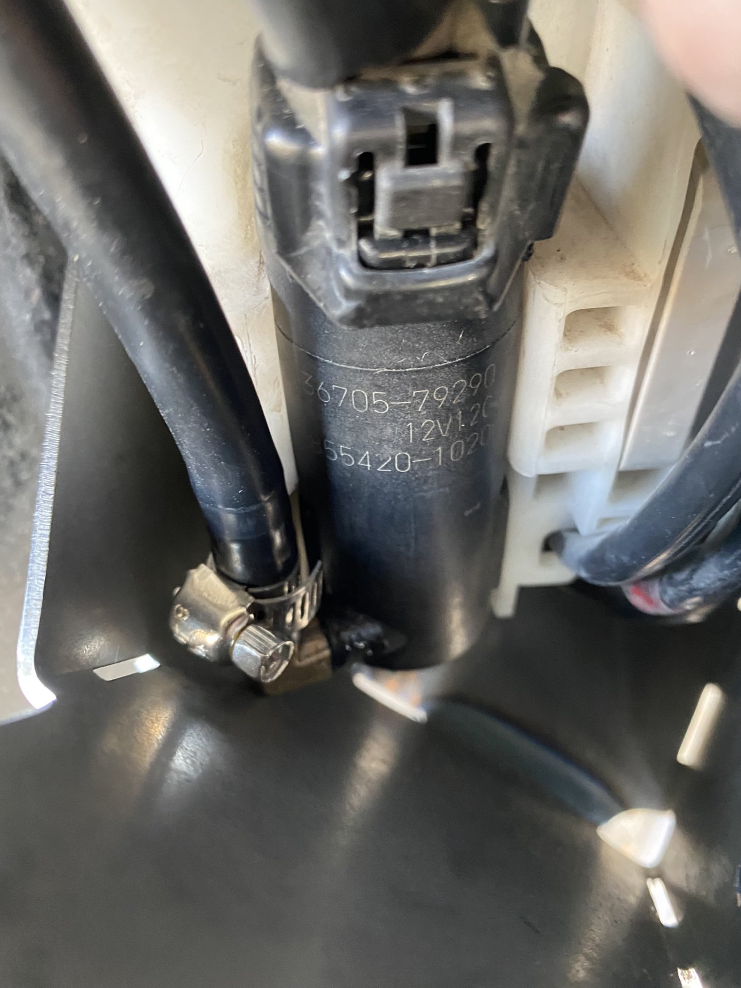

Pictures worth a thousand words. I will turn the Grade eight bolts around on final assembly. No this is not a jack lifting point by any means but it will protect the bottom of the washer tank. I did add a brace to the bumper. I had the cut one mounting tab off the C4 tank cover since the through frame 5/8 Victory4x4 bolt is in the same location .
Thanks for the detailed pics!!
Grade 8 bolts a little over kill?
I would've just gone with 316 SS button head sockets, but I absolutely agree with the nylon insert lock nuts! I use them on anything bolt to my rig. 👍
Nice work. I had the same issue on my previous 2010 FJC. I made a new ww tank for it out of a generic coolant overflow tank and mounted it up above in the engine compartment, but I suspect that would be more difficult for the GX as it has at least 3 washer pumps.
The grade 8 bolts are from parts from my race car days. They are from the early 90’s . I just love using parts left over from past builds on new projects.
My Dad sold nuts and bolts for years and he gave me those . He went to be with the Lord this year and I loved adding those bolts he gave me on this build.
Yes three pumps on the windshield washer models. The two pump models are easier to cover for sure.
